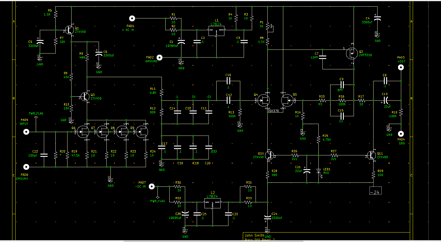

I was hoping someone here might be able to assist me with some errors i am receiving when I run the ERC check. Some errors are listed below.
I have also attached the complete error log (needed to rename to .txt)along with an archived copy of the work.
Kicad ver: 5.1.9
Schematic is of the Pass Pearl 2.
Any help would be great.
Thanks, James
***** Sheet /
ErrType(12): Different net assigned to a shared pin in another unit of the same component
@(132.08 mm, 40.64 mm): Pin ~ on U1 is connected to both Net-(C3-Pad1) and Net-(C1-Pad1)
ErrType(3): Pin connected to other pins, but not driven by any pin
@(132.08 mm, 40.64 mm): Pin ~ (Power input) of component U1 is not driven (Net 2).
@(129.54 mm, 152.40 mm): Pin ~ (Power input) of component U2 is not driven (Net 5).
@(172.72 mm, 96.52 mm): Pin ~ on Q4 is connected to both Net-(C12-Pad1) and Net-(Q10-Pad1)
The errors seem to follow Pad symbol naming values. For example at the input of R1 and R2 to U1 you have a symbol Pad1 +Dc in and another symbol +vdc at the same junction point, kicad errors are indicating you have two nodes of different functions connected to each other, best thing to do is delete one of the symbols.
The same error also exists on the gnd pin of U1 where you have a symbol GND and another symbol labelled Pad2 ground connected to the same node, you'll need to delete one of the symbols, keeping the GND symbol would be preferable.
The same types of errors are at U2 Vin, the input Pad5 / Pad6 and Pad4.
I made some amendments to your schematic as an example of the changes you can refer to.
Indiglo,
Thank you very much for your time. I will download this information and see what you changed.
The other thing I just found was that the components need pin numbers; at least according to one page I ran across. I will see if I can find that in the manual.
This is my first time with this type of software and figured I would hit a few bumps somewhere.
Thanks again, James
I suspect its because of the footprint being used. Kicad has standard footprints you may want to use those instead. For example the jfets are probably TO92, select the appropriate jfet footprint symbol from the kicad library that matches the pinout of the real jfet, if you make a pinout error because of a wrong footprint in the schematic it will carry over into the pcb layout.
Ended up changing the footprints of Q4-9 and Regulators 1 and 2; and now it is running fine.

Aim65,
Thank you, I did not catch that error.
I just realized (been sick the past couple of days); that I had left any G-S-D symbols in the schematic. My intention for this was just to basically copy Wayne's schematic but make some changes to some capacitors to have some boards made up for myself.
Since I have purchased the boards from Pass years ago I wanted to try some different caps which have different physical footprints than the original design; which in turn lead me to download and try out this software. Hopefully if anyone was going to make their own PCB's they would go straight to the source for the data.
