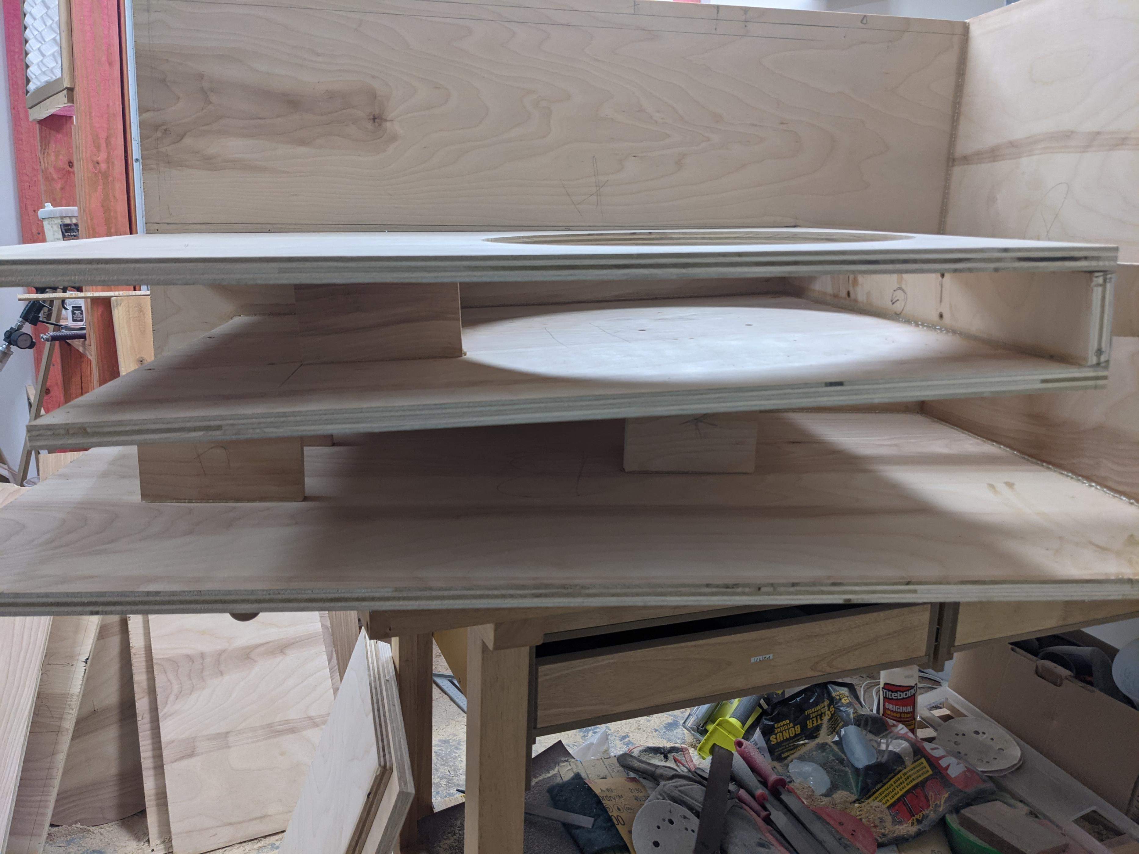

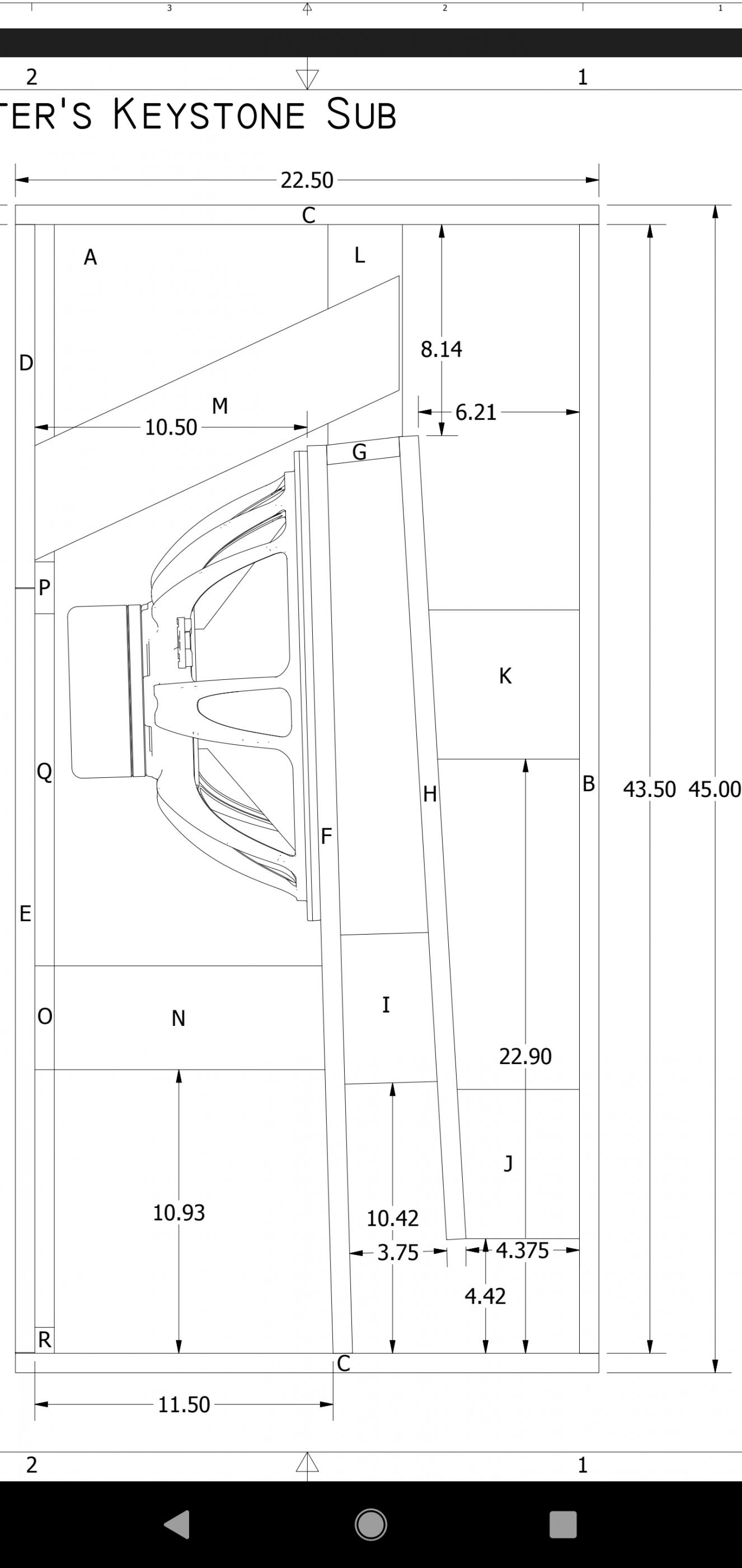

The problem is that if you put the bottom and top on the sides you end up with an 1.5" taller cabinet and then internal measurements don't match up.
The pic of the cabinet side cut away view shows the sides being 43.5". After cutting the sides to 43.5" tall all of the internal measurements work out exactly perfect now.
Singtall,The problem is that if you put the bottom and top on the sides you end up with an 1.5" taller cabinet and then internal measurements don't match up.
If you cut the sides to 43.5" rather than 45", you will have to make the top and bottom pieces oversize to make up for the shortage.
The the sides of the cabinet are 45" tall, screwed to the top, bottom, back and front from the sides, as in the plans.

did you see the plan pic I posted on post 1363? It's not showing it the way you explained it. clearly C board sits on top of the A board. Maybe the plan was modified at some point? I would think that it would make sense to put the top board physically on top of all of the boards for strength reasons. either way it can work. I just wanted to make everyone aware of what I was seeing in the plans just in case anyone else ran into problems like I did.

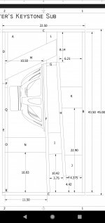

Thought the photo in #1365 showing the side part "A" screwed into the top and bottom parts "C" would help you to understand the cabinet design.1)did you see the plan pic I posted on post 1363?
2)clearly C board sits on top of the A board.
3)Maybe the plan was modified at some point?
4)I would think that it would make sense to put the top board physically on top of all of the boards for strength reasons.
1) Yes.
2) Not in the plan you posted, which shows part "A" to be 45", the full height of the cabinet.
3) There have been some corrections made to the plans, but the "A" side dimensions have always been 45" x 22.5", and top and bottom parts "C" have always been 25" x 22.5".
4)If you change the plans by reducing the side panel height by 1.5", you will then have to increase the width of the top and bottom panels from 25" to 26.5". Your change won't make the cabinet any stronger, but will make it more difficult to build.
My brain got stuck on stupid. My apologies. My wife looked at the plan and set me straight. Lol. Thanks for your patience. Even though I may be able to salvage the cabinet I'm working on, it may be a pain to build. I'm gonna start on the other one and see what scraps I have left to fix the first one. Worse case I'm buying more wood.

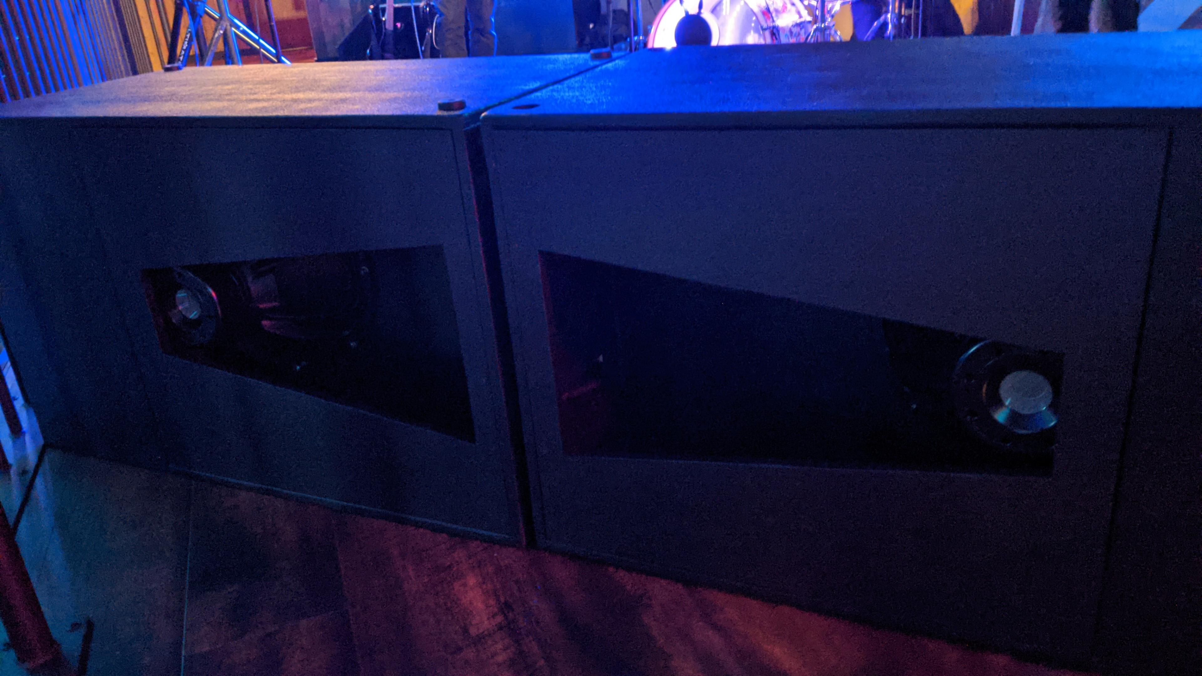

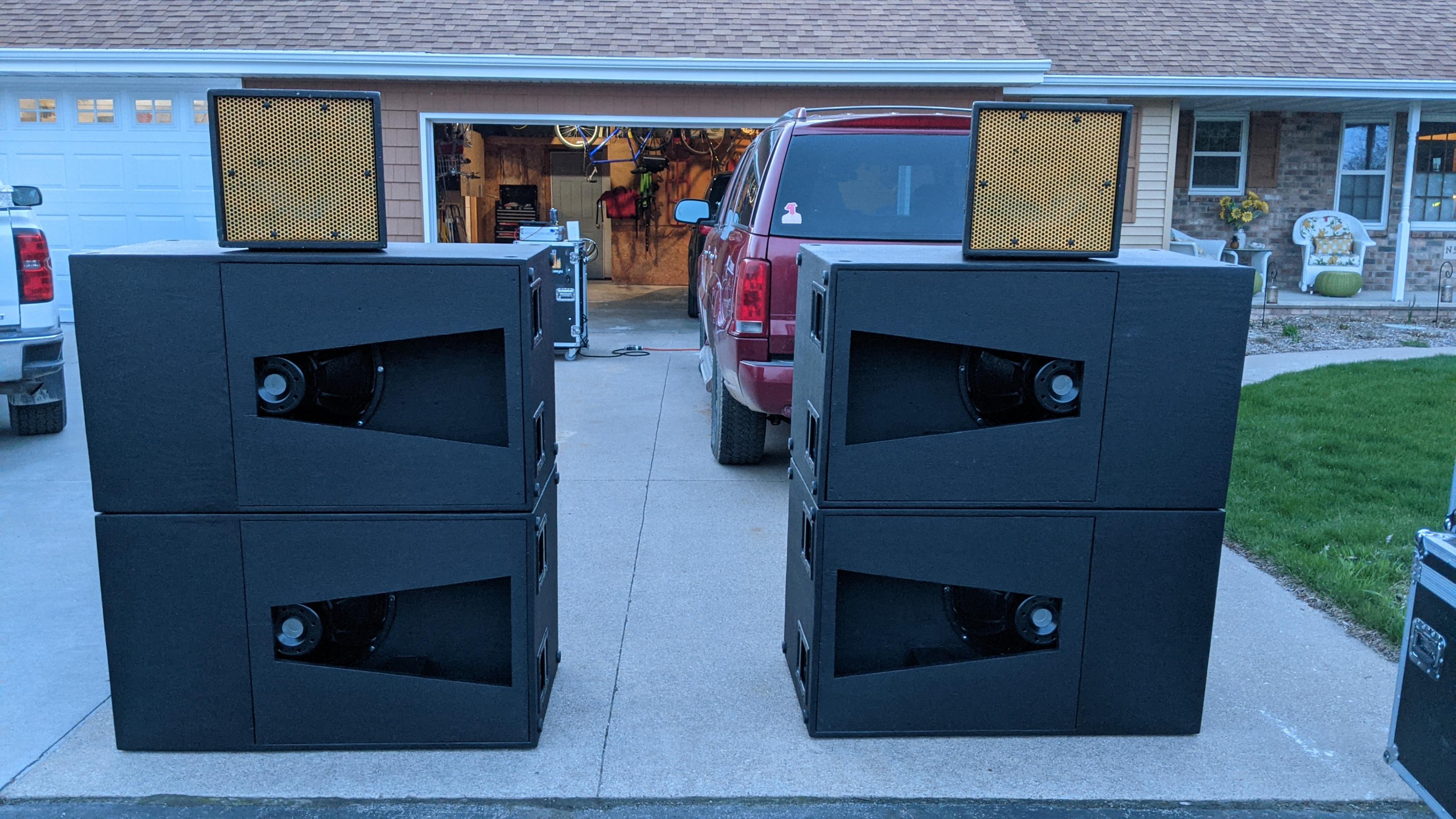

I just finished up my build on these. My buddy had all the tools, so we built in his garage. Funny story - he accidentally shaved off 5/8" on the first cut for the sides.. hah. So we took that off of the large part of the horn near the exit. They still perform so so so well. These are incredible.
I'm running a show right now for a pop rock band at a local club and it's ridiculous how much output these have. I was previously running five Yamaha DXS15 subs with the center canceling bass towards stage and I honestly think One replaces the four that were pointed forward before. These are incredibly directional and I no longer have to set up a reverse sub. We built four, but I'm only using two tonight with a QSC PLD 4.5 bridged A+B and C+D. I'm hardly hitting the meter and they're rocking for about a hundred people.
The depth, clarity, and overall tonal quality is outstanding. Using B&C 18sw115 8-ohm drivers and we ended up using 3/4" Marine Grade Plywood because Baltic Birch had a 5-week wait time. I highly recommend this wood if you're not able to get Baltic Birch.

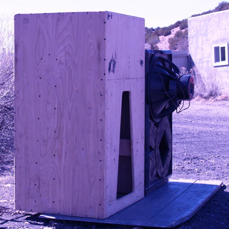

Martin,The cabinet in the photo behind the Keystone looks like an interesting experiment - what's going on there?
That photo was taken while testing to determine how the Keystone sub compared to a bass reflex, also linked in post #1:
Tapped Horn Vs. Bass Reflex Case Study
Short story: One Keystone sub using the BC18SW115-4 has the equivalent output of two bass reflex cabinets with the same Fb, the pair using more occupied volume, weight, materials, two drivers and twice the power.
The test box was a solidly braced 1" MDF cabinet that originally housed a JBL 15", 10", 4" diaphragm high mid, and slot tweeter, weighed over 200 pounds with drivers.
Glad I never had to lift that thing when it was loaded !

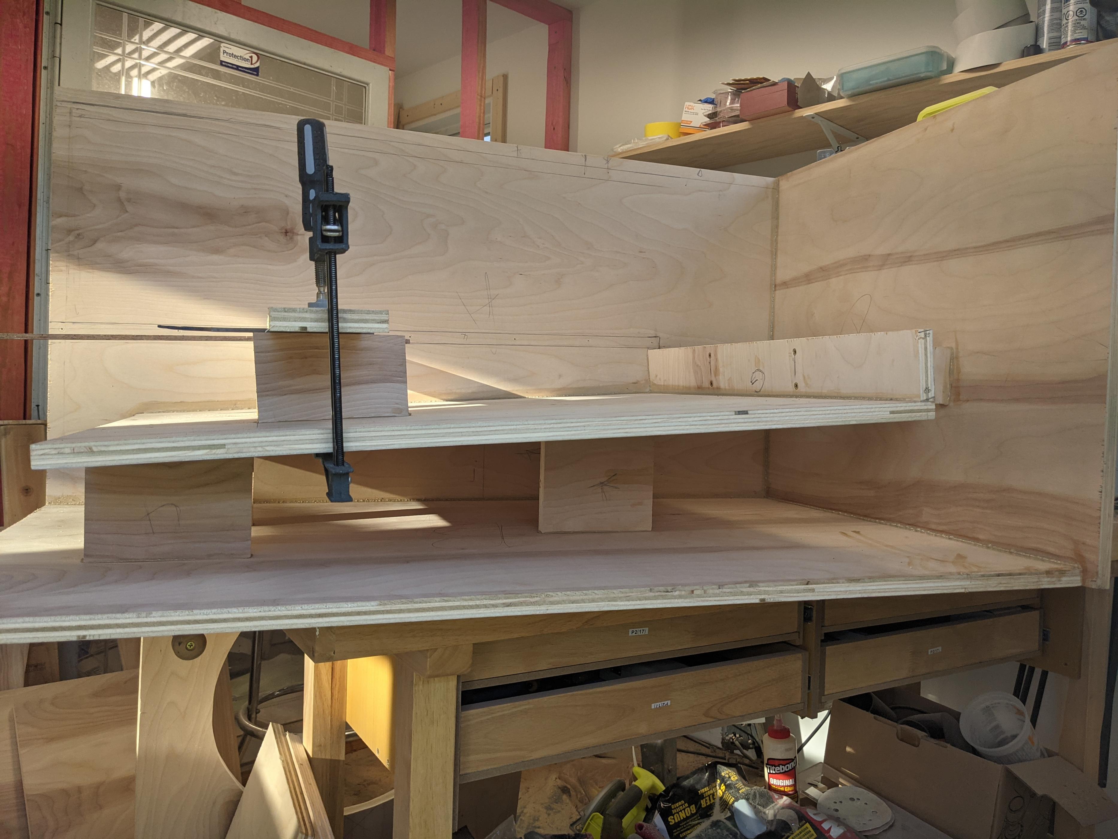

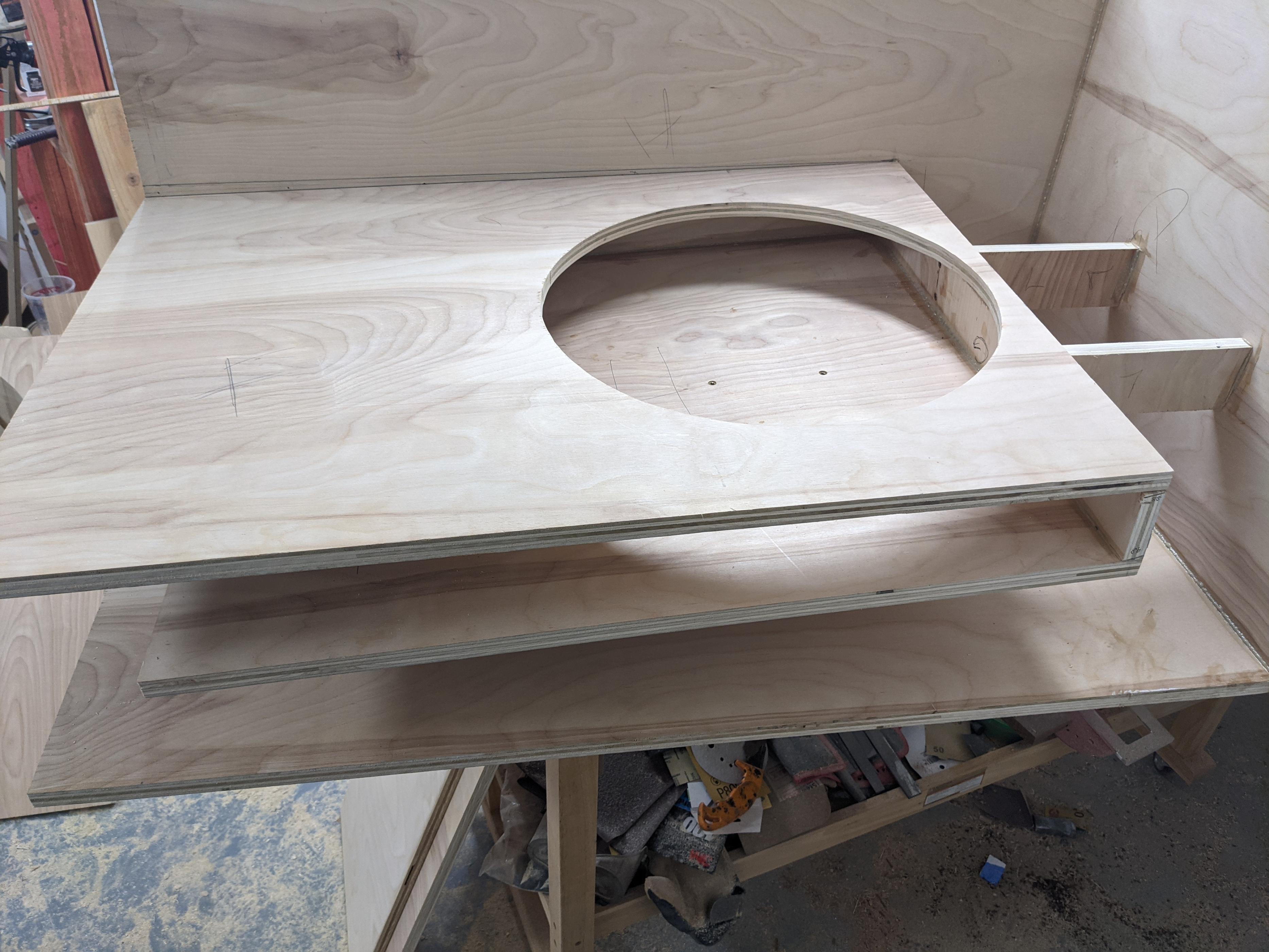

After some mishaps I ended up having a couple boards to use for top and bottom to complete the mess up cabinet. I was able to glue up a couple pieces and it's looking better now. Had to get my wife out there to double check everything and help me hold it in place while putting screws in. I'm getting plenty of squeeze out on the adhesive so I feel pretty good about not having issues once it's all together. I was going to install the speaker board but I'm going to wait until Tuesday when the speaker comes in to make sure the hole is cut perfect. Thanks again for the tips guys.

Which top cabinets are you running with the subs? I was thinking about building the syntripps but I'm having second thoughts since my building skills are a bit lacking.

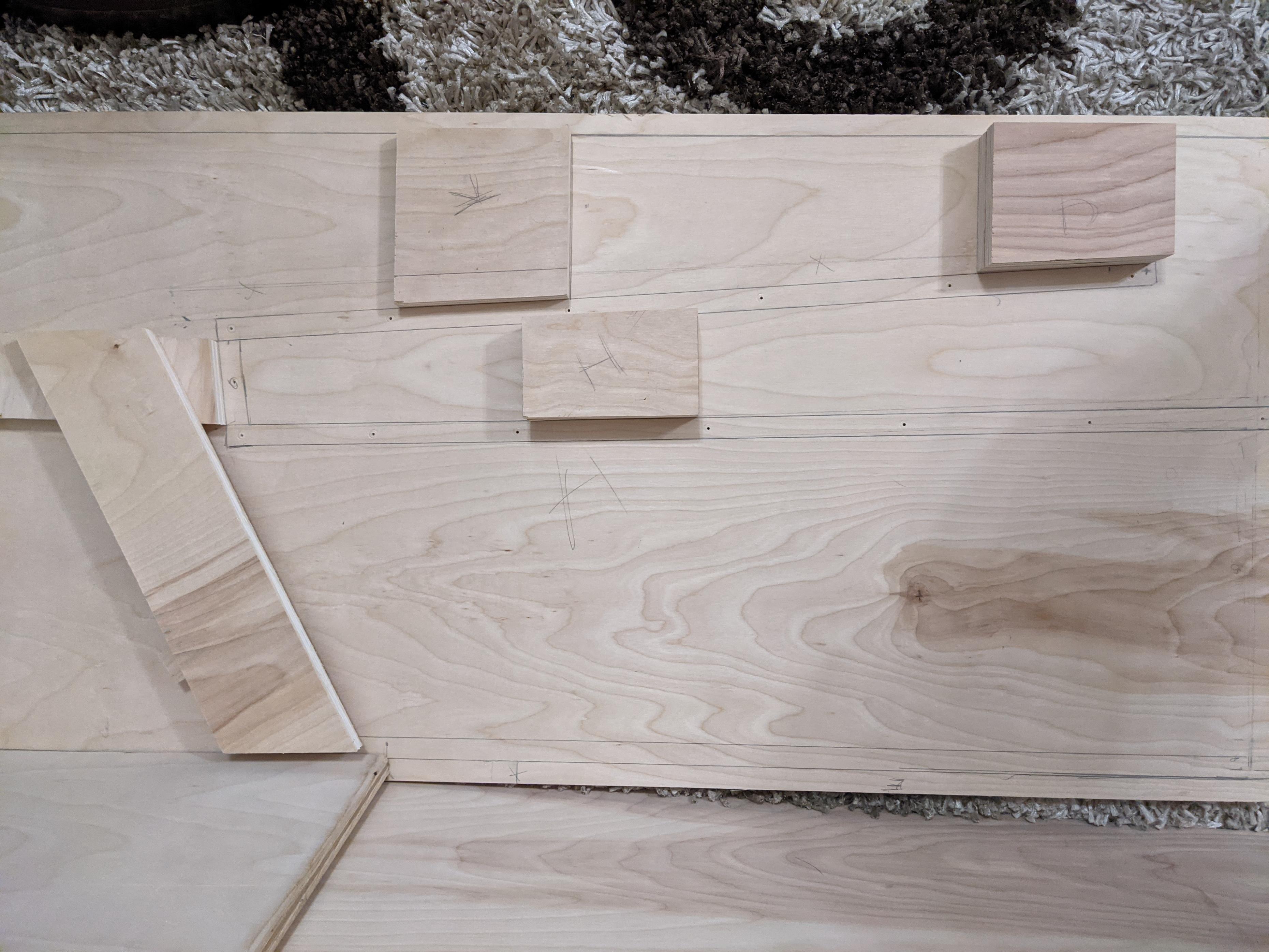

After allowing some dry time I laid the speaker board in it's place just to have a look and it appears I measured something wrong when I laid out the side board measurements. The board is a little further back into the box than I projected. From inside the back of that board to the front of the next one the measurement is right, so go figure. Pics posted just in case someone spots an error.
