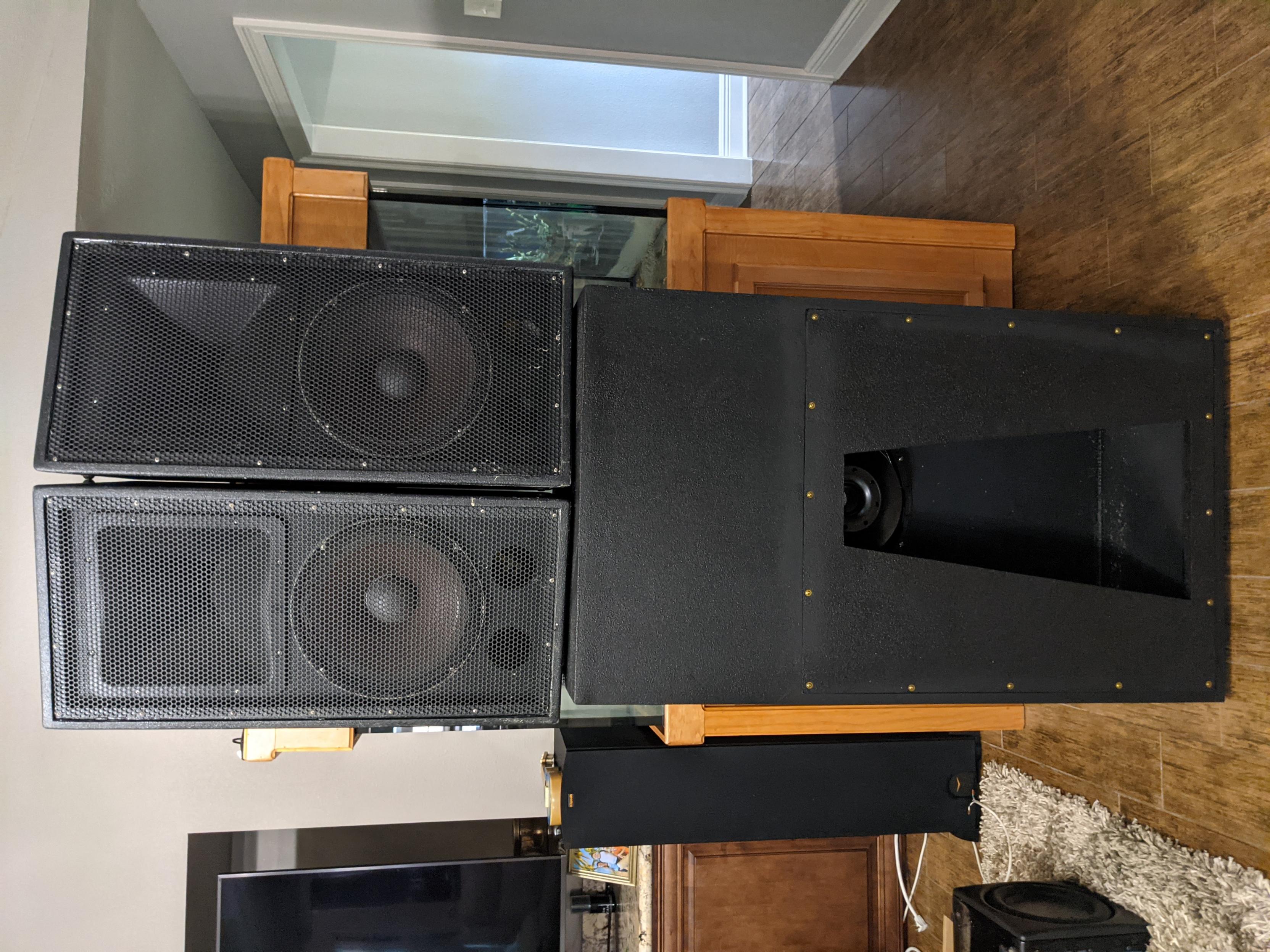

My dumb *** decided to do a quick test in my living room. I put about 300-400 watts into the cabinet and had stuff in the kitchen rattling. Lol. No way to bring it up in volume without something in the house rattling. I think the cabinet is solid. The other issue I had was the tops trying to walk off the sub. It almost happened but my friend grabbed the cabinet just in time. The JBL AM series cabinets have no rubber feet, only metal screws sticking out so no grip. I'm gonna try either rubber feet or a rubber mat. The stack height is right at 7' tall, so I think it will work for some small clubs as is. I thought about mounting the top cabs on poles attached to the sub, but Art warns against it and it would be a little difficult to get both cabinets on poles and still be close together or allow for splay. I'll have to do a little research on the latter.
More testing tomorrow outside my house, but so far so good.
I think I settled on 5ms delay on the tops and the top cabinets are set back so that the speakers are roughly on top of the sub speaker.
I advised to not use the Keystone sub with a pole mounted speaker above unless attached to a plinth (platform) with a ratchet strap.The JBL AM series cabinets have no rubber feet, only metal screws sticking out so no grip. I'm gonna try either rubber feet or a rubber mat. The stack height is right at 7' tall, so I think it will work for some small clubs as is. I thought about mounting the top cabs on poles attached to the sub, but Art warns against it and it would be a little difficult to get both cabinets on poles and still be close together or allow for splay.
Rubber feet still "walk", unless the top cabinet(s) feet fit securely into receiver holes on the sub they also should be ratchet strapped to the sub to avoid movement.
7' tall for the top cabinet puts their mid/high at standing head height, which will tend to deafen those in front, attenuating the mid/highs for those that are not.

I'm about to test outside with a thick rubber mat on top of the sub to see if that will help the walking. if not. I will be making a notch for the top cabs rubber feet to fit in. how deep should the notches be?
would it be ok to use a board between the sub and tops with rails on either side to keep both cabs in place? thinking maybe a board a little wider than the sub with 3/4" edge around it to keep it fitted to the sub on all sides, then place the tops on the board and glue in the same type of edge that goes around the tops keeping them from going in any direction. probably over thinking it and should just notch for runner feet.

1) About 1/3 the distance to the farthest audience position would be a good height. Get them up as high as possible, point them down at the audience.1)what's a good height for top cabinets?
2)I'm about to test outside with a thick rubber mat on top of the sub to see if that will help the walking.
3) I will be making a notch for the top cabs rubber feet to fit in. how deep should the notches be?
4)would it be ok to use a board between the sub and tops with rails on either side to keep both cabs in place?
2) It would slow the walking speed.
3) The divots should be near the compressed depth of the feet.
4) Yes, and you could also put ratchet strap alignment holes or depressions in it.

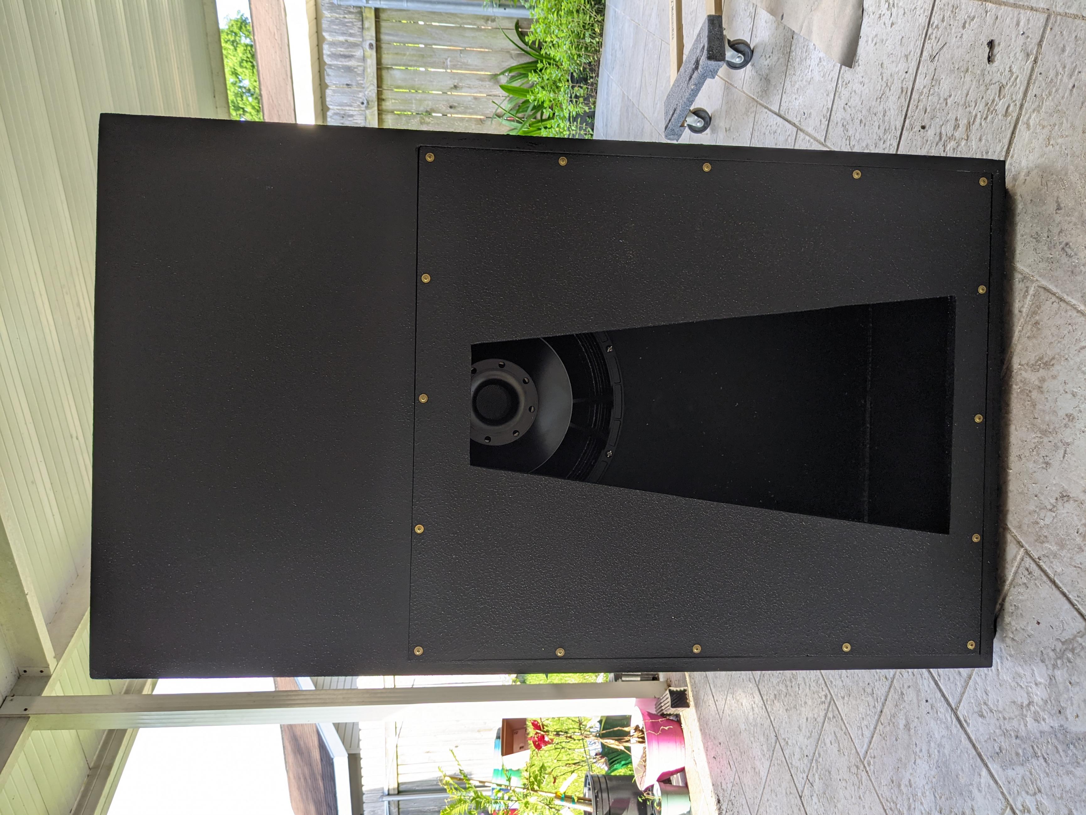

Outside testing complete. Wow does this sub kick! Driverack did it's auto eq thing and the resulting eq curve had minimal eq applied. And all I had was one side of a behringer inuke3000 powering it. Right below amp clipping the speaker was barely moving. I think I need a bigger amp!
I bought a $25 workout mat from home Depot which I cut to place on top the sub. The mat is very thick and rough actually. I can't imagine rubbing any body part on this without losing skin. I played music at high volume for about an hour and the tops never moved.

apparently the amp I was using only put out 800 watts per side at 4 ohms. I'm going to have to bridge it to get more, then it will put out 3000 watts into 4 ohms. ordering another amp today.
again, Art did an amazing job designing this speaker cabinet!

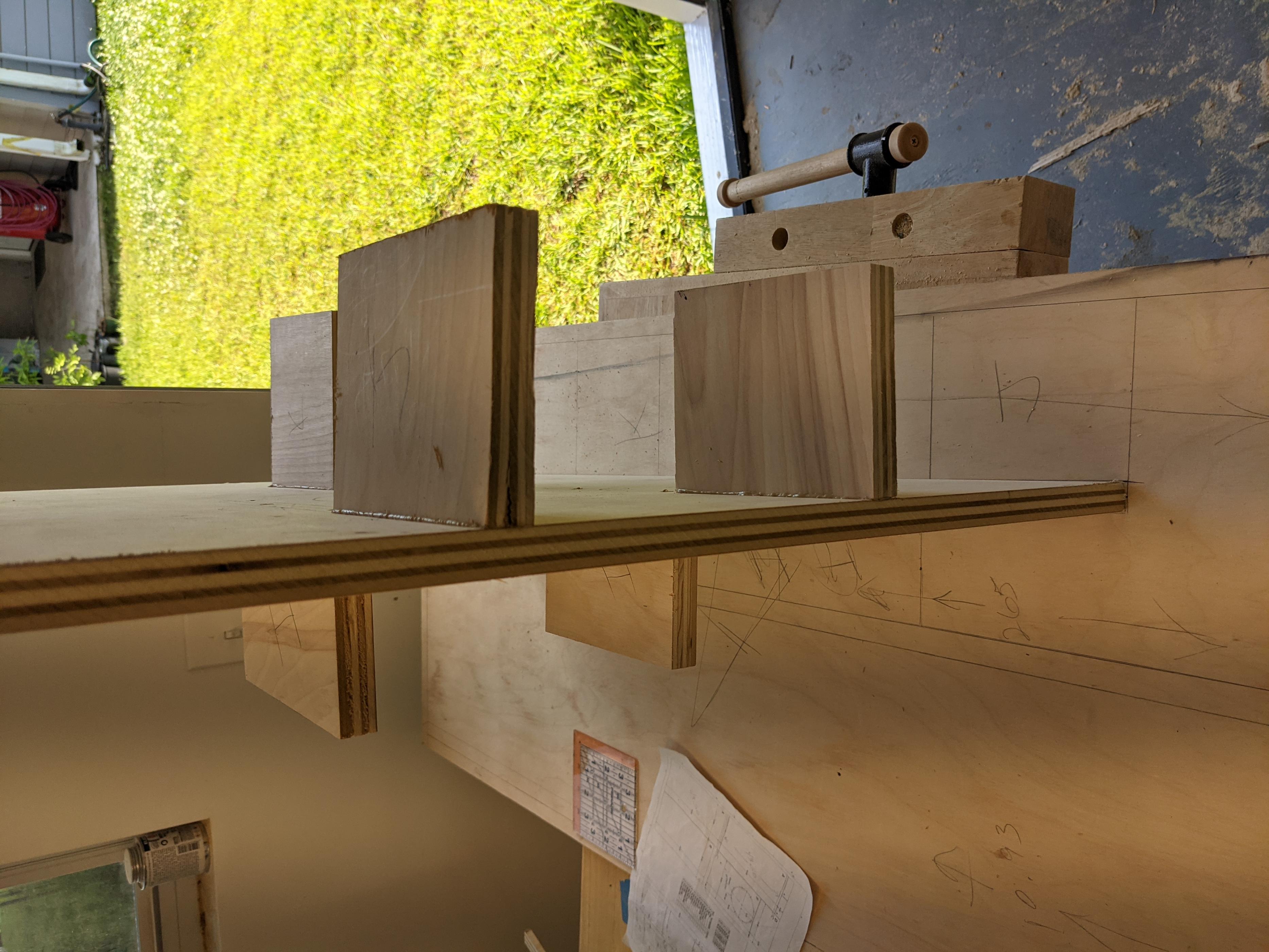

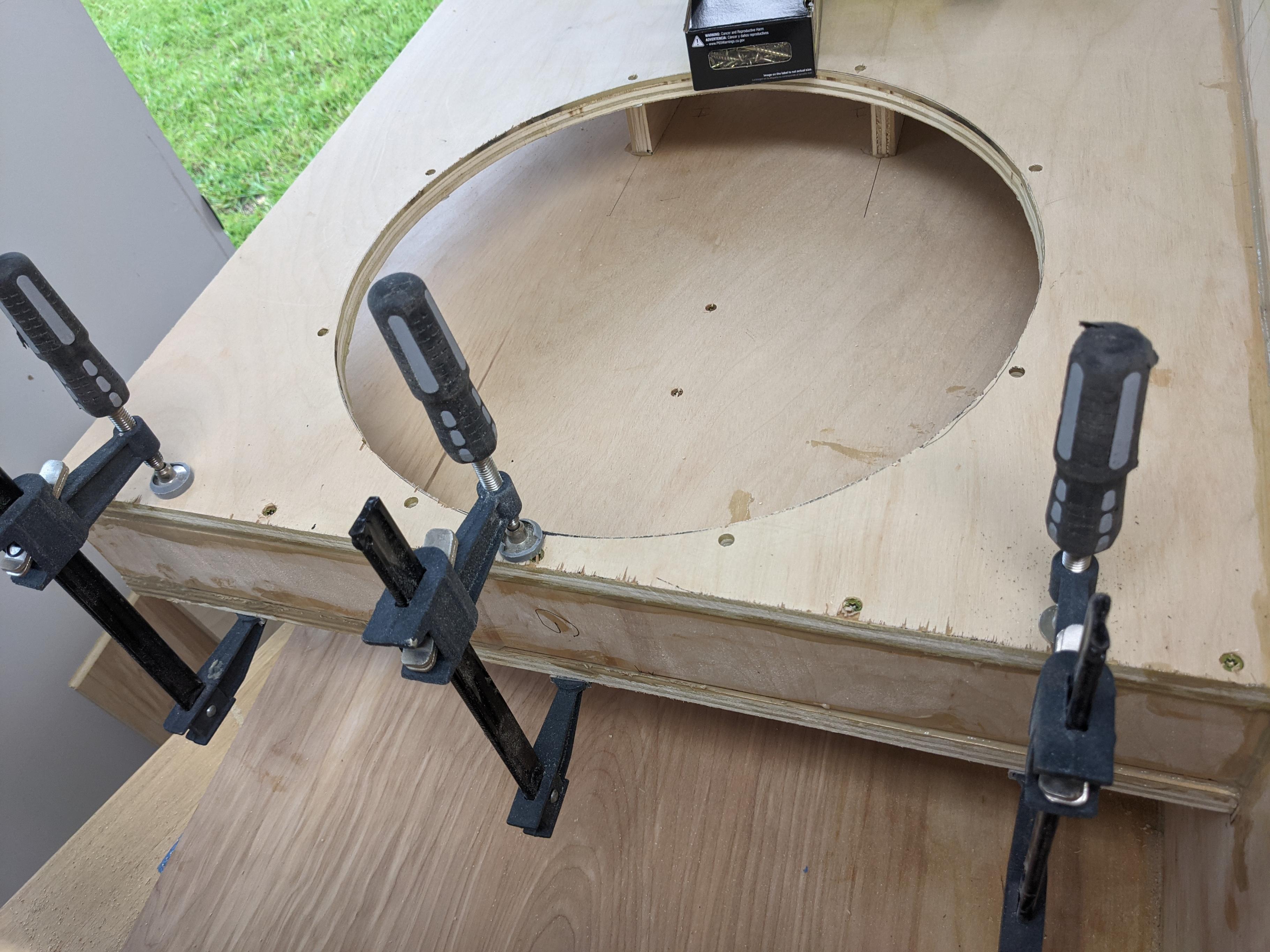

Just about done with the second cabinet. Still a little tricky, but I got it done. Filled all the holes with Bondo now I just need to sand and put on the duratex. Got another power amp coming in Friday so I can't wait to test these things out with full power.

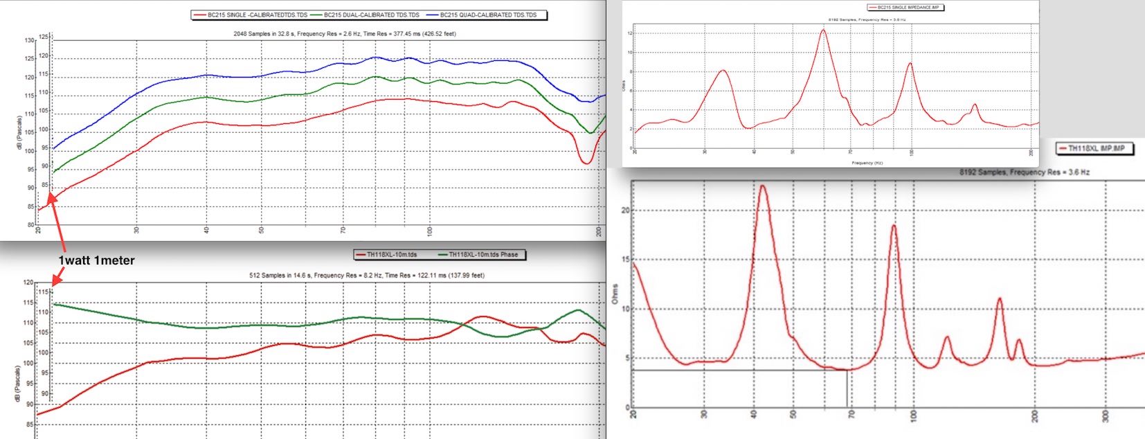

Someone told me that the keystone subs compare favorably to the Danley XL 18" subs. I haven't heard the Danley subs but I see that the box size is pretty close. Anybody care to comment on how far off they are?
The DSL TH118XL impedance/excursion minimas are about 4Hz lower than the Keystone, it appears to have around 3-4dB more output at 30 Hz, though similar above.The gig is outdoors on a the back of a 18 wheeler truck bed. My first thought was to put both keystones laying down on the ground in front of the trailer and put the other subs and top cabinets on either side of the stage.

After much wailing and gnashing of teeth, I have of late been thinking that my sensitivity rating for the Keystone is understated by 3 to 6dB.

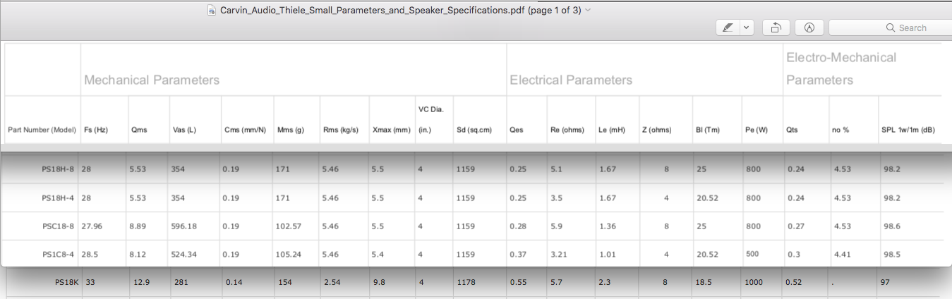

Couldn't find any listing for dual 18" Carvin "trx3212" subs.
The Carvin dual 18" TRx2218B use 800w 5.5mm Xmax drivers.
The Carvin dual 18" TRx3218 spec sheet lists 1000w 9.75mm Xmax drivers.
I'd expect either of those of those dual 18" subs to have similar sensitivity as your BC 18TBW100-4 loaded Keystones.
The 18TBW100 has 12mm Xmax (14mm Xvar) so should be capable of more clean LF output than a pair of TRx2218B. One Keystone/two TRx2218B.
If you get the TRx3218, the Keystone should still have a bit more output, probably between a 2/2.4 to 2/3 ratio, two Keystone/three TRx3218.
