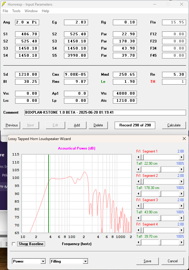

I sim'd at 149v with a small amount of EQ to smooth.
And yes I still have and use the SS15s. Same as before 6x6 cardioid end fire setup.

I have 2 Krakens and amp to push 4 of them with headroom.

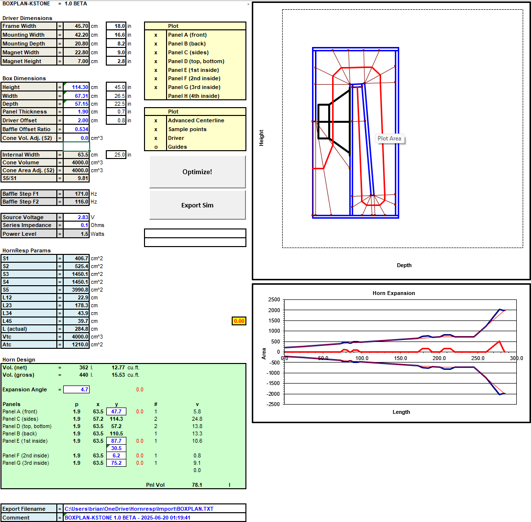

Just need to upscale the design. No time as of yet. (if someone wants to do that with the pervious attached HR file...)

The impedance minima at 31 Hz is 3.94 ohms, over 5600 watts into a 2000 watt rated driver is a bit optimistic, especially with nearly a 4/1 compression ratio.

Expect to go through quite a few mouth opening dimensions, shapes and locations before finding one that works similar to the sim response.I have 2 Krakens and amp to push 4 of them with headroom.
