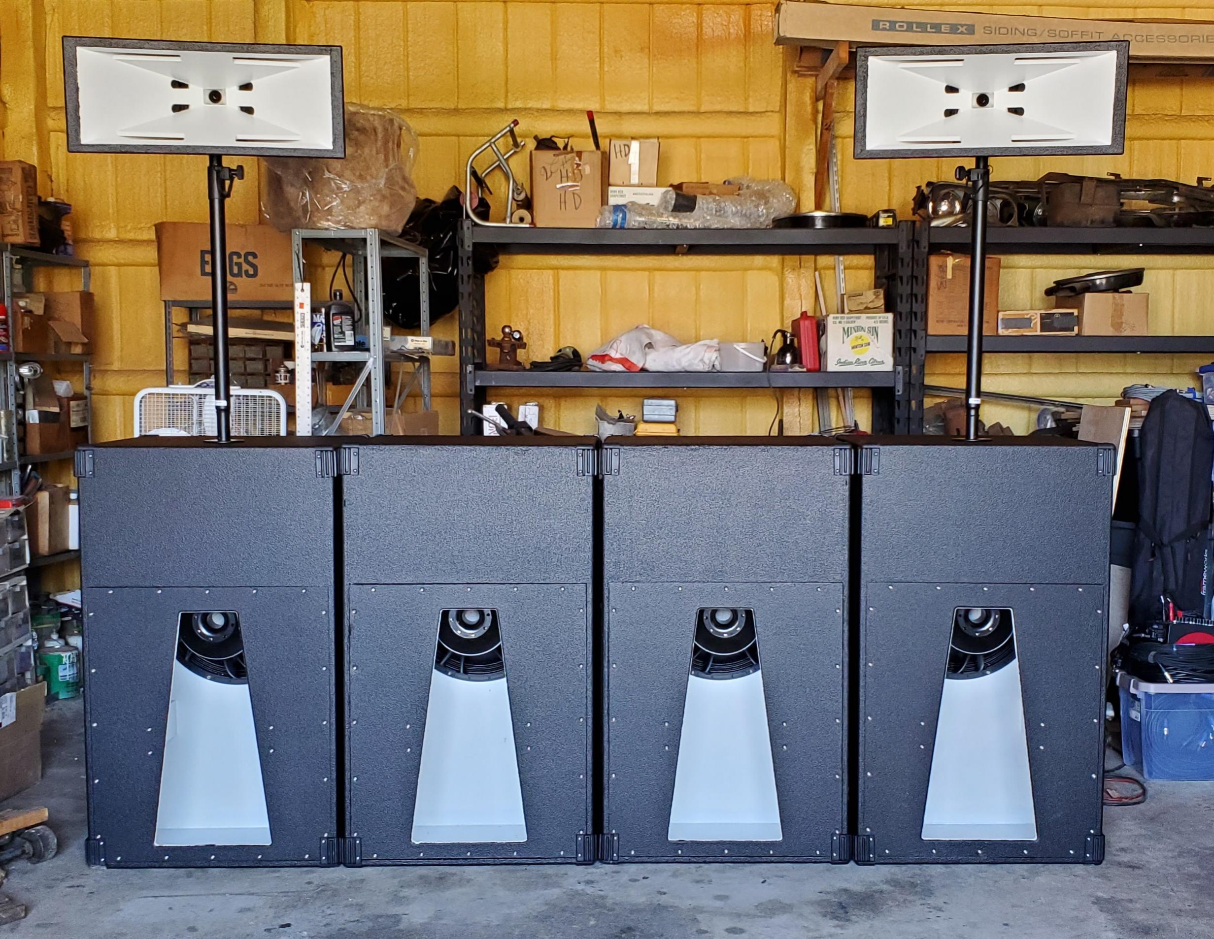

Nice rig! @samdeboneff

NICE setup with the synergy horns!
