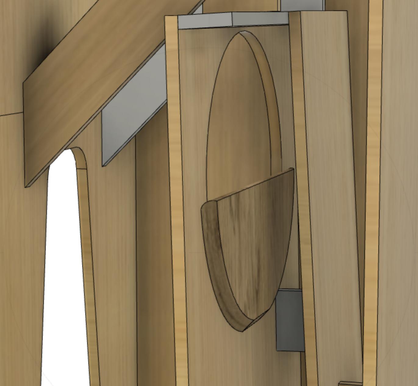

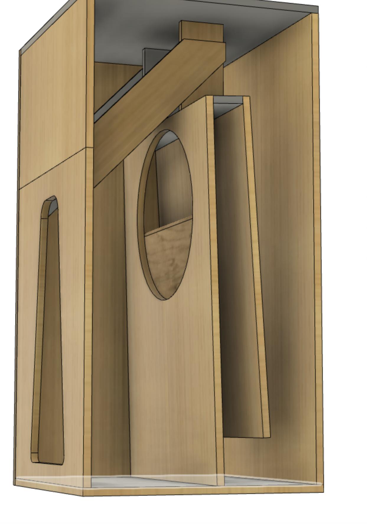

Hi Art,
wonderful thread, been following for a while now..
Just drafting up the CAD work at the moment to see how things fit..
May i ask, is there any benefit in increasing the compression stage at the beginning of the horn, Be it a piece of wood across the entry hole on the baffle?
I just have a gut instinct with keeping the compression high and steering the entry point all the way to the very beginning of the horn? Probably a silly experiment....

1)May i ask, is there any benefit in increasing the compression stage at the beginning of the horn, Be it a piece of wood across the entry hole on the baffle?
2)Also got my hands on 4 18SW115s, are you able to attach the 3d file so i can work with it..
1) Does not look beneficial to me, but no harm in trying an A/B test.
2) I don't have any 3d files.

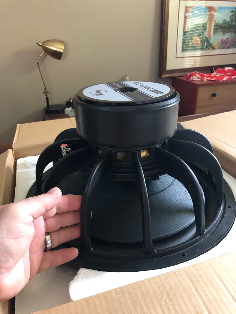

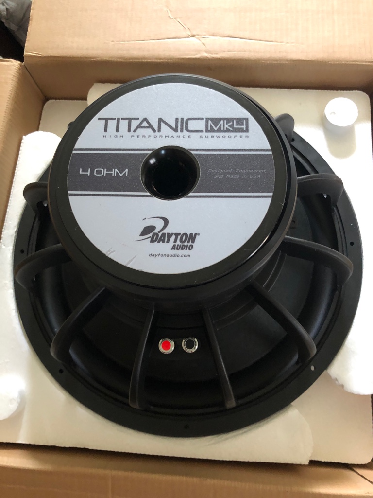

Would the keystone work for the Dayton audio 15” titanic mk4 sub driver 4 ohms single coil. And if so. What’s the size of box or even better. A link to a cut sheet and build plans.
Hi Carl,
The external dimensions are 45" tall, 26.5" wide, 22.5" deep.
You can find links to the plans in the original posts, as well as links to Hornresp simulations, which would allow you to input your driver's TS parameters and see how they compare to other drivers.
Art

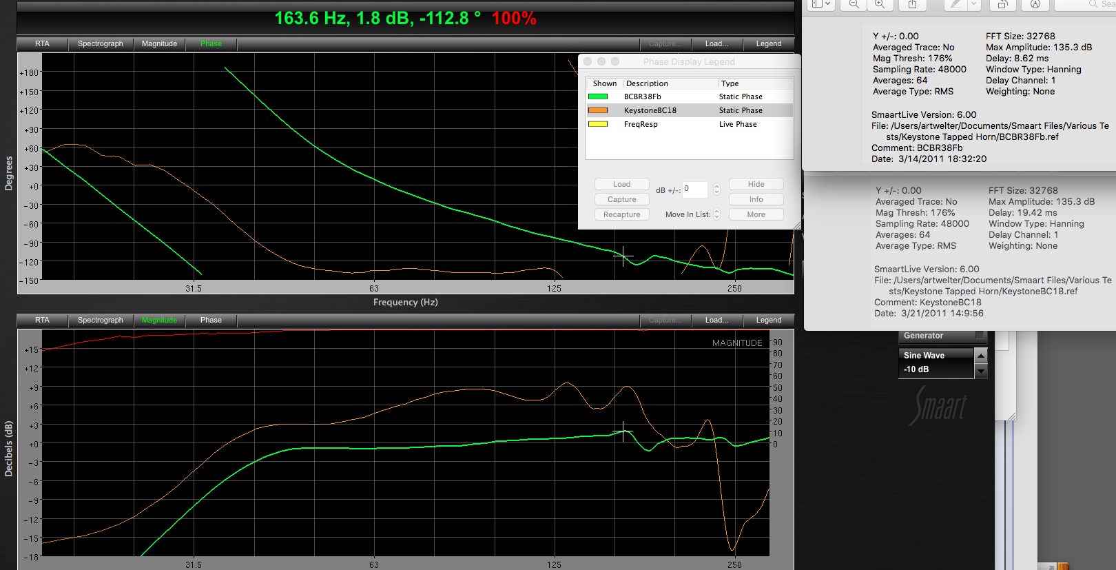

1)..I'm using the ported dual 15" well above the resonant frequency (~1 octave?), the ports act just like a solid wall and don't allow any air through, so it effectively is a direct radiator from >80 Hz (Fb 40 Hz). You do make a good point I'm going to play around with a variety of filters this weekend using SMAART.
2)I think that the plate would serve but are there any other considerations other than screwing in (bolting on?) a cover plate? I'm also scratching my head as to how the extension is lower with a smaller opening, perhaps you can share your thoughts on this?
1) The phase transition from bass reflex (BR) to "solid wall" is gradual, as you can see in the example below of a 38Fb BR compared to the Keystone TH. At 160 Hz, there is around 10.8ms time of flight difference between the two, but the phase difference varies by around 240 degrees over the passband from 38 Hz to 160 Hz.
2)Aesthetic, structural and tuning are about it on the list of considerations.
The answer to your "head scratcher" is probably along the continuum between "tapped horn", "transmission line" and BP6 ;).
Art
