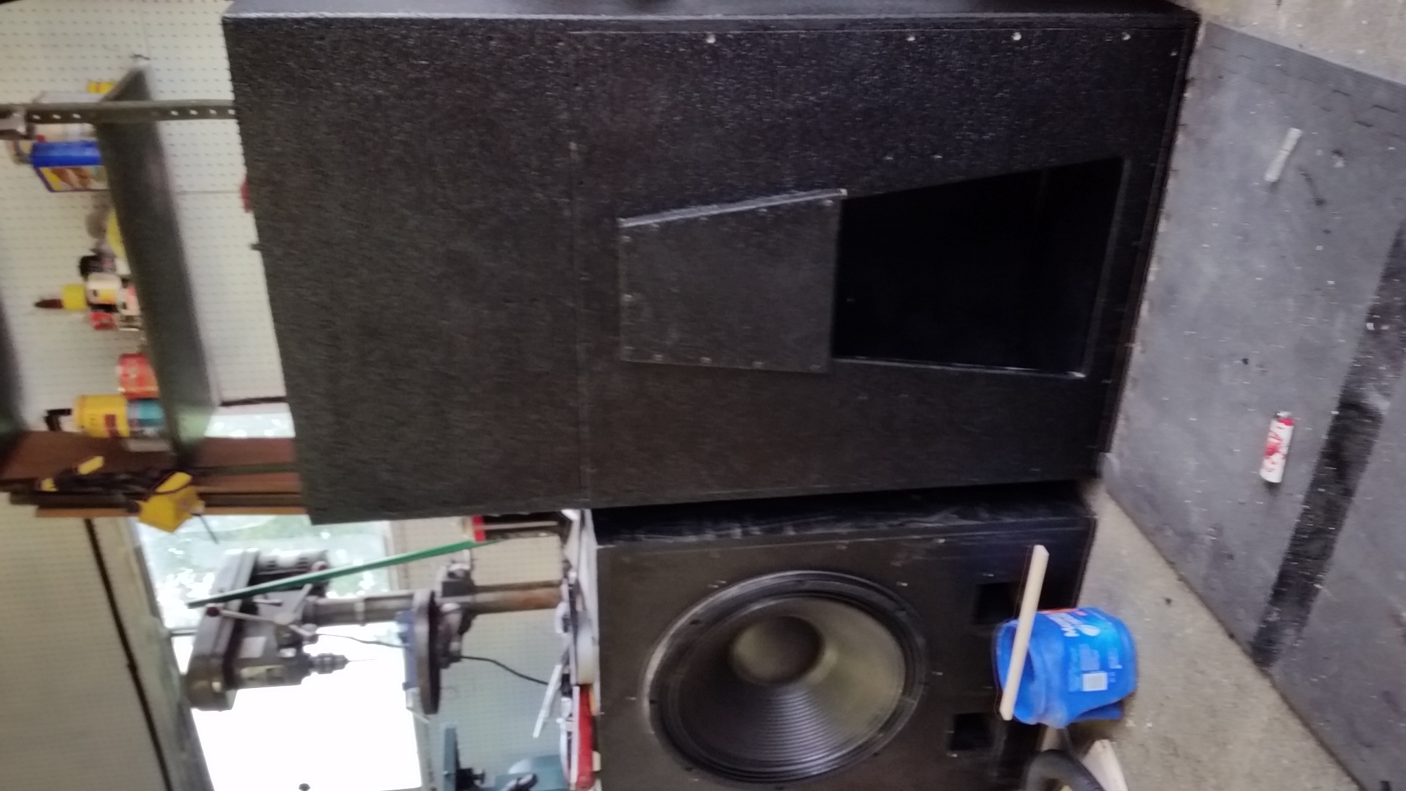

But I did find the culprit for the mistake (see pic)

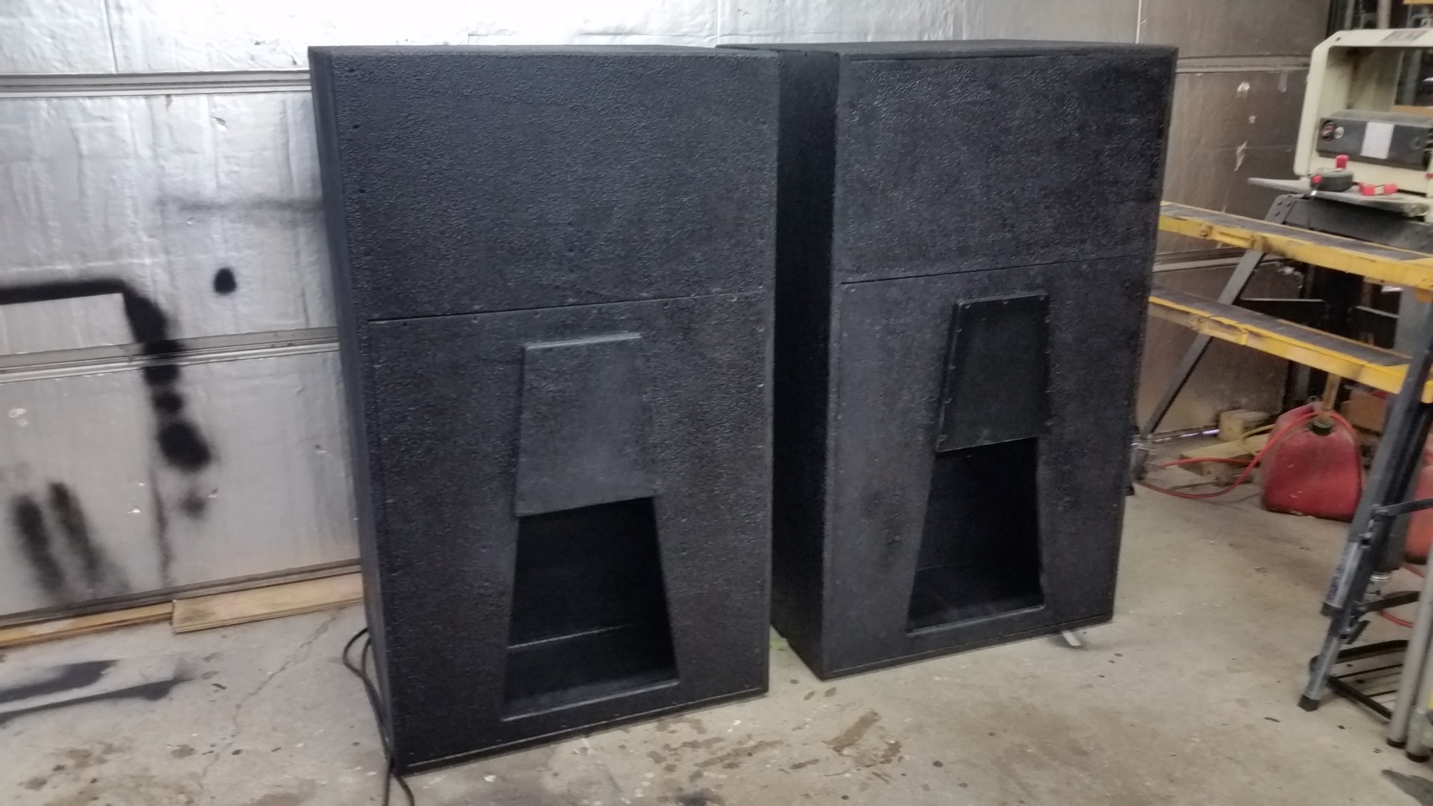

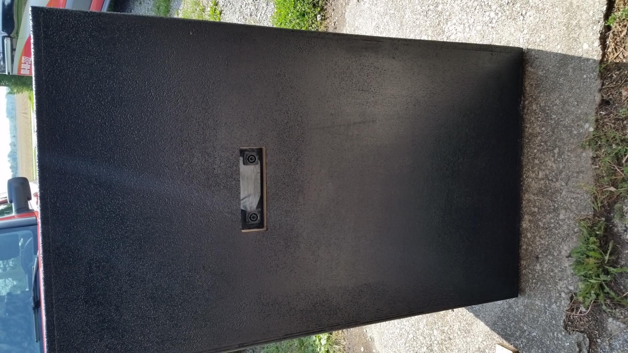

Couple pics here, really like this Herculiner polyurethane paint, tuff stuff!
