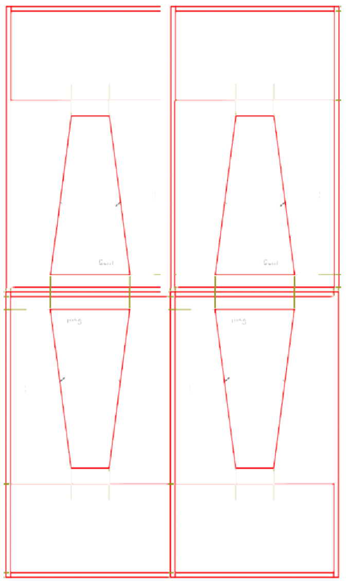

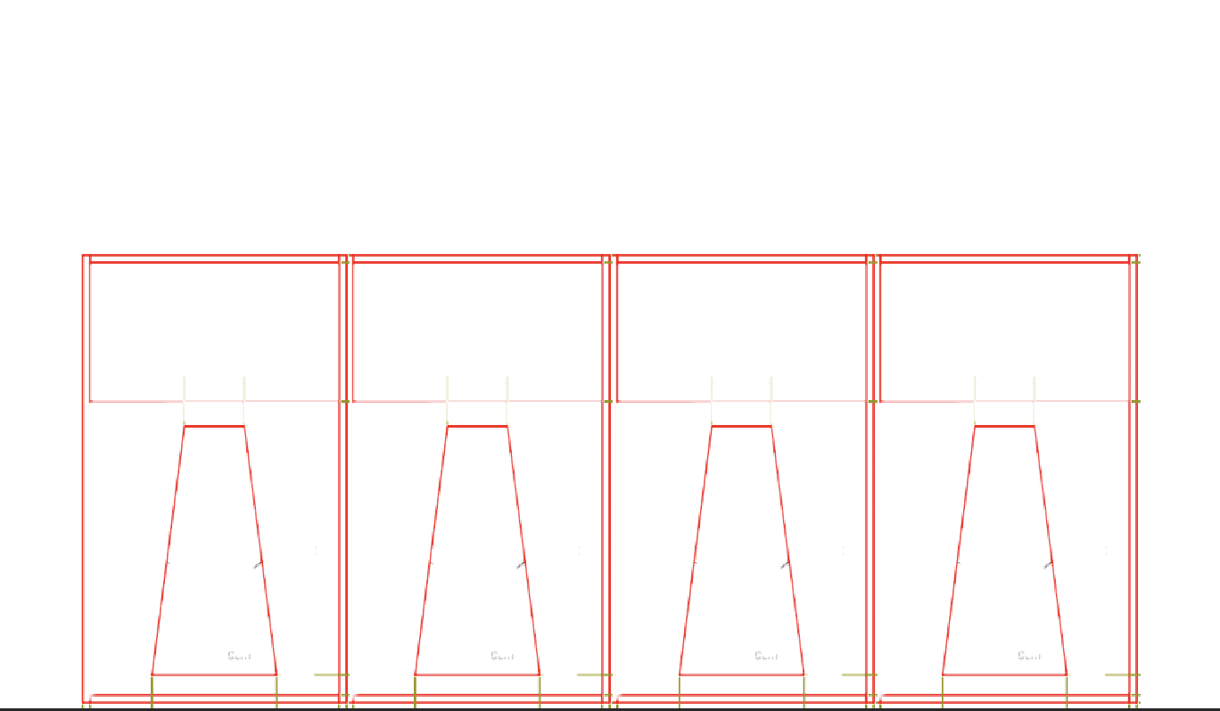

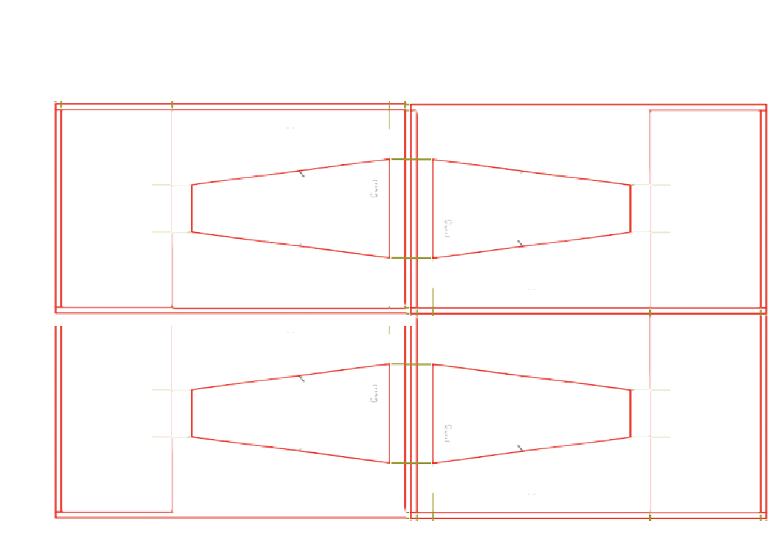

Either stack will work. Variations in the pattern in the upper response will occur, the "side by side" will have more narrow horizontal pattern than a single, the 2x2 will be slightly less narrow than the 4x1 horizontally, and more narrow vertically.
The image below would result in a more uniform pattern than either of the above, wider horizontally, and more narrow vertical. It would also be the easiest configuration to employ 4'x8' "Barn Doors" either side, increasing output by around 3 dB, like doubling amp power with no thermal compression or distortion.
Art
Art
Tonefarm,
Art
Art, I've tried one on top of each other (2 x vertical) with large barn doors, when I find the photos I'll post them. Very impressive with the barn doors but quite directional, in fact too directional for a small near field event - at 50 -80 meters, well that was ideal.
I'll be experimenting soon with 2 x 2 horizontally on their sides. I'll report back.
cheers
Martin

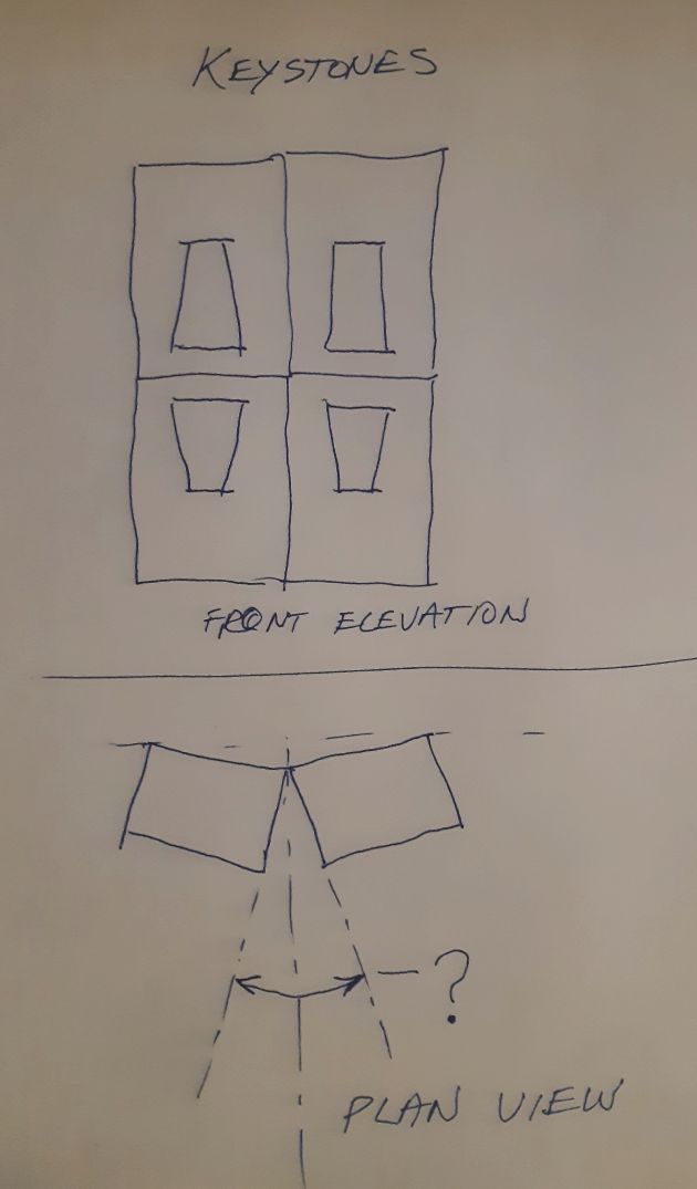

[/ATTACH][QUOTE3 dB, like doubling amp power with no thermal compression or distortion.
Art[/QUOTE]
regarding coverage - depending on the upper Xover Freq - Splaying the cabs in as in my drawing would be beneficial if the upper Xover is > 100 Hz.
cheers
Martin
Art[/QUOTE]
cheers
Martin
Art
regarding coverage - depending on the upper Xover Freq - Splaying the cabs as in my drawing would be beneficial if the upper Xover is > 100 Hz.
cheers
Martin[/QUOTE]
