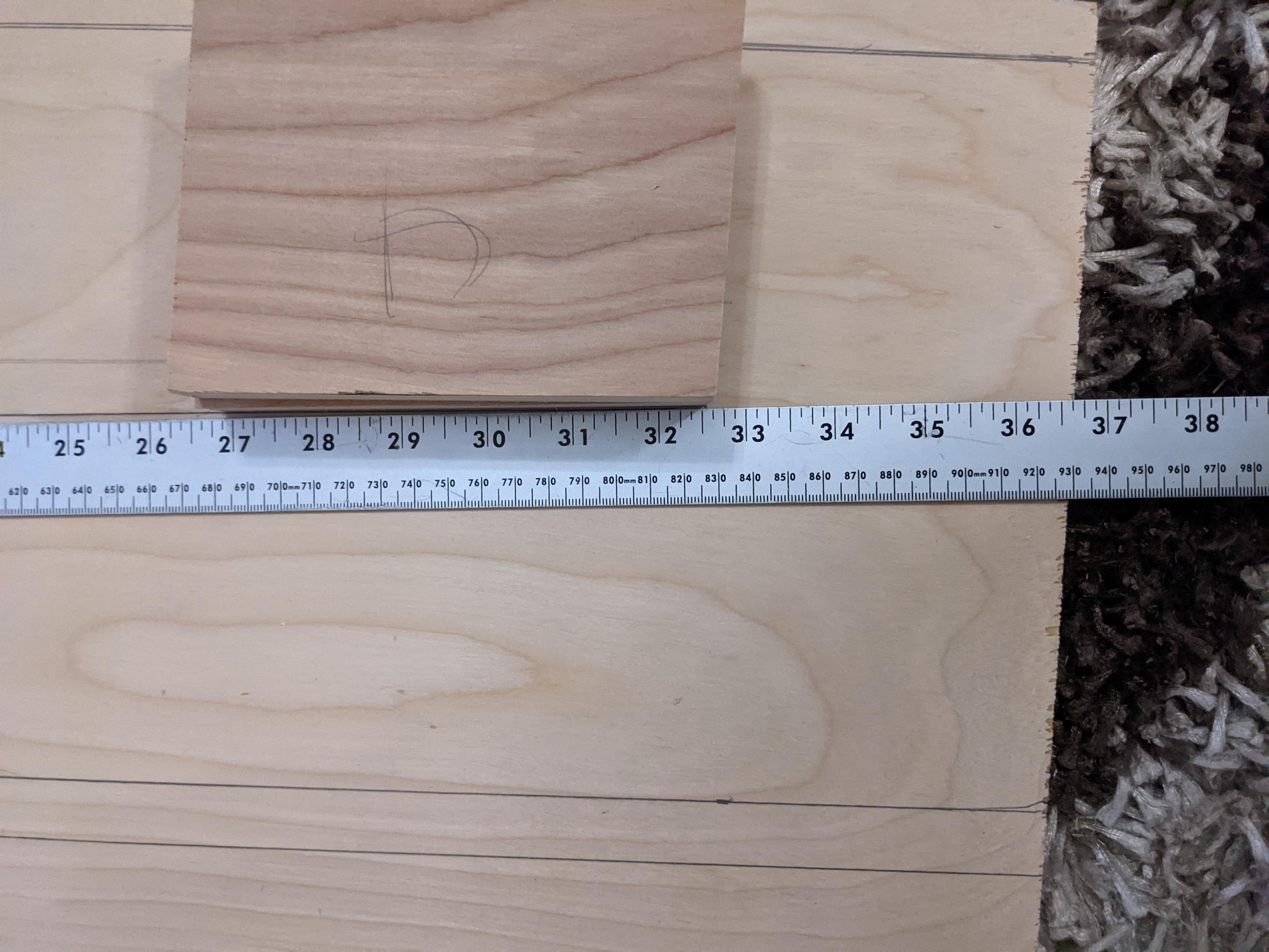

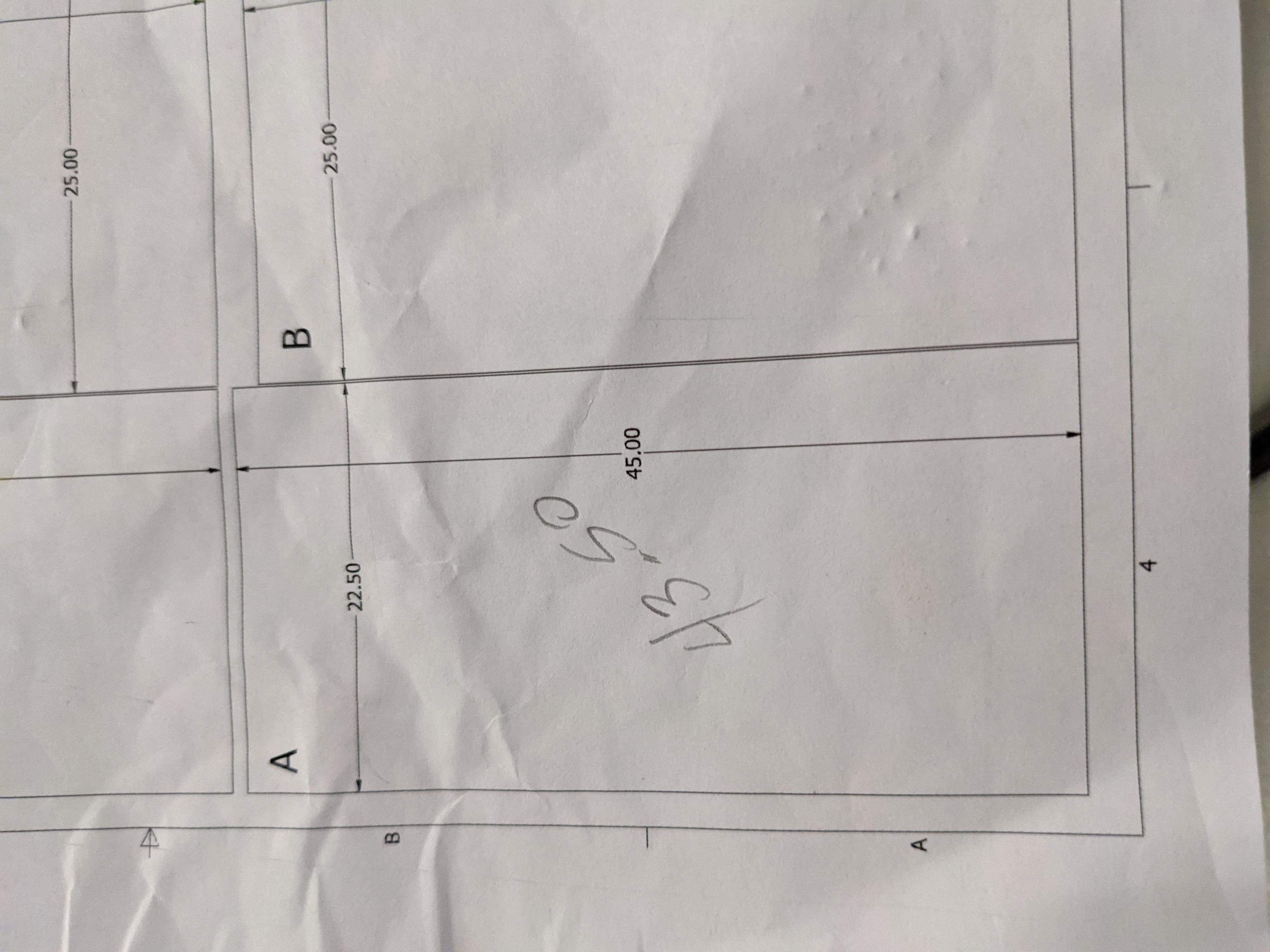

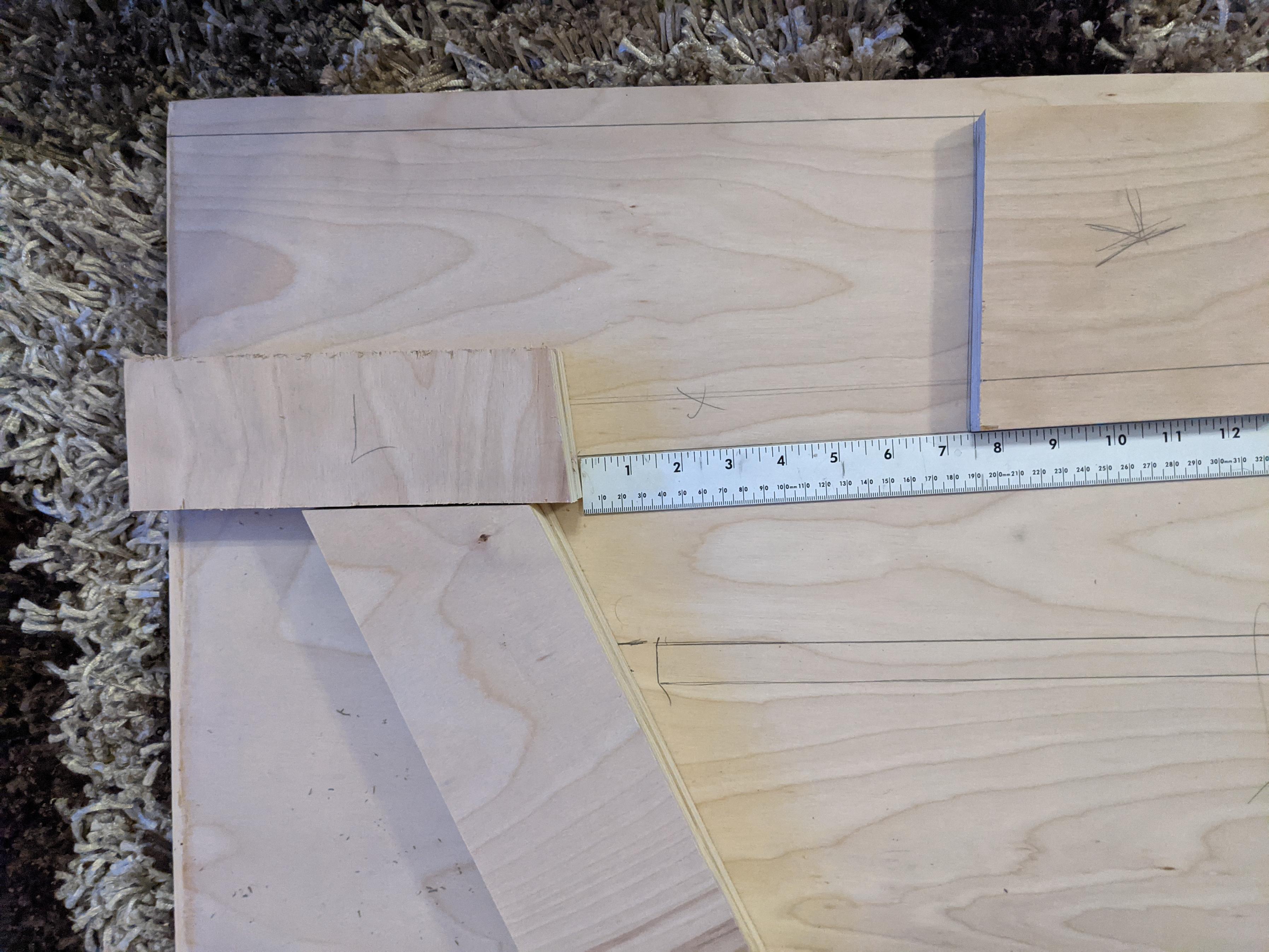

I just cut some boards for my first Keystone subwoofer! I'm working it old school with no table saw, just cordless handsaw. taking my time getting the boards cut square and perfect as possible. I just realized that I have no way to measure the exact angles specified so back to home depot I go to get more tools and a little more wood. Somehow I thought someone said it takes a sheet and a half per cabinet so I only bought 3 sheets for 4 cabinets. after looking at the drawing I need another sheet. lol.
You should be able to calculate angles from drawings somehow... not that i know how but google will tell you(I do like my angle finder tool). These boxs are pretty simple to build and you should still be able to have an excelent outcome with out flash tools. Best of luck.

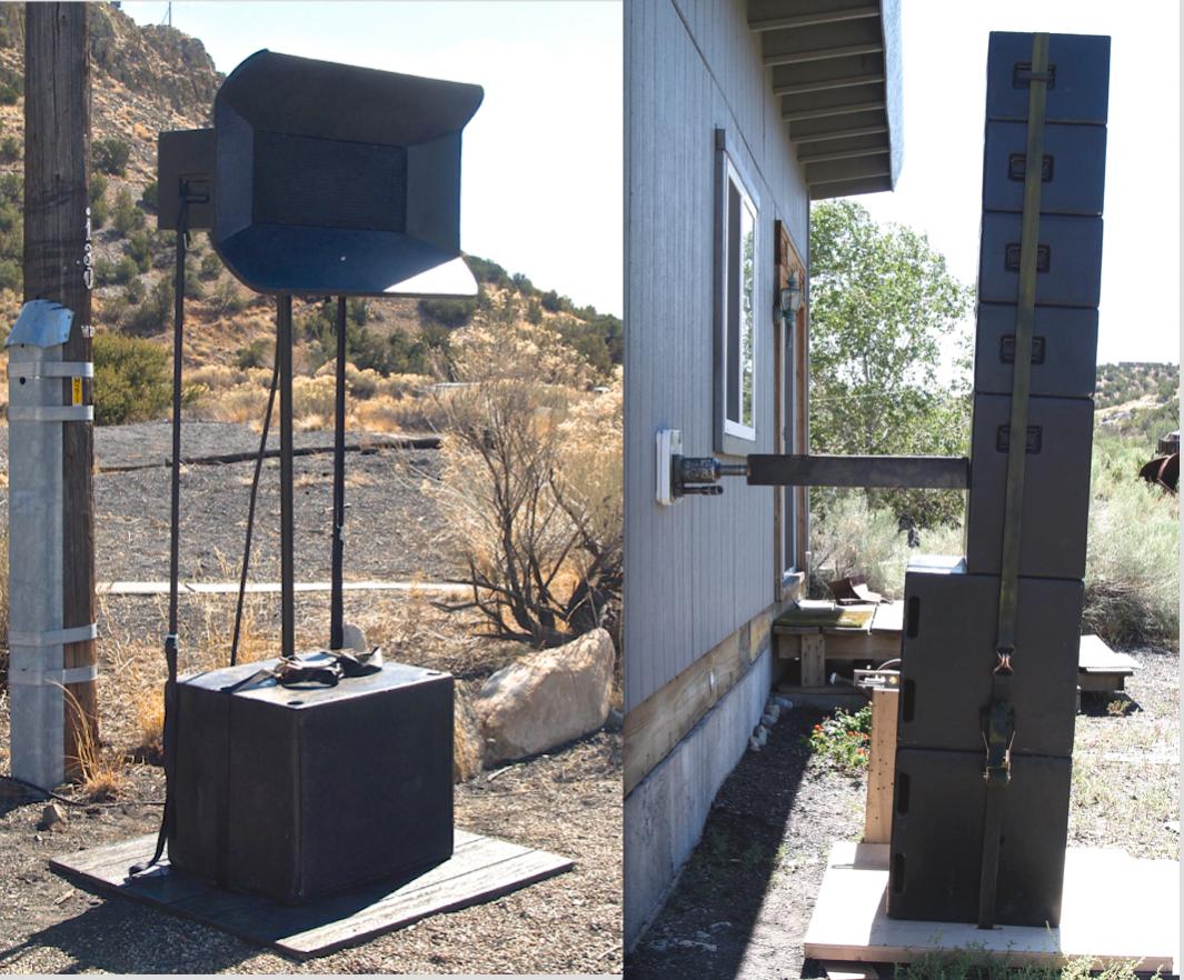

Casters on the bottom of a cabinet used as a base for a supported speaker are unsafe. Wind loads or crowd bumps will rotate the casters inward, reducing the base size considerably.
At only 22.5" x 26" base size, I would not advise using the Keystone sub with a pole mounted speaker above unless attached to a plinth (platform) with a ratchet strap.
The plinths in the photo below are 45" x 45", the cabinets the same base size as the Keystone.
Two layers of 10mm (.357") LP SmartSide panel siding material laminated together work great for plinth material, very strong, and rot and insect proof.
