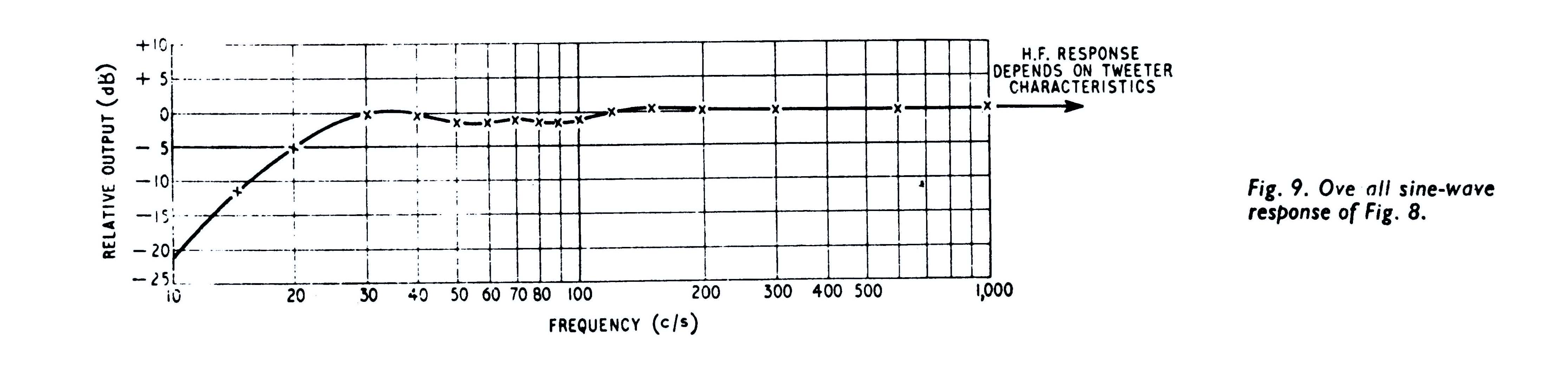

I have posted my Bailey line impedance and response curves earlier. May I see the result of your Martin King box that also have a single peak impedance, go down to 30 Hz at 6 dB/octave? 😉

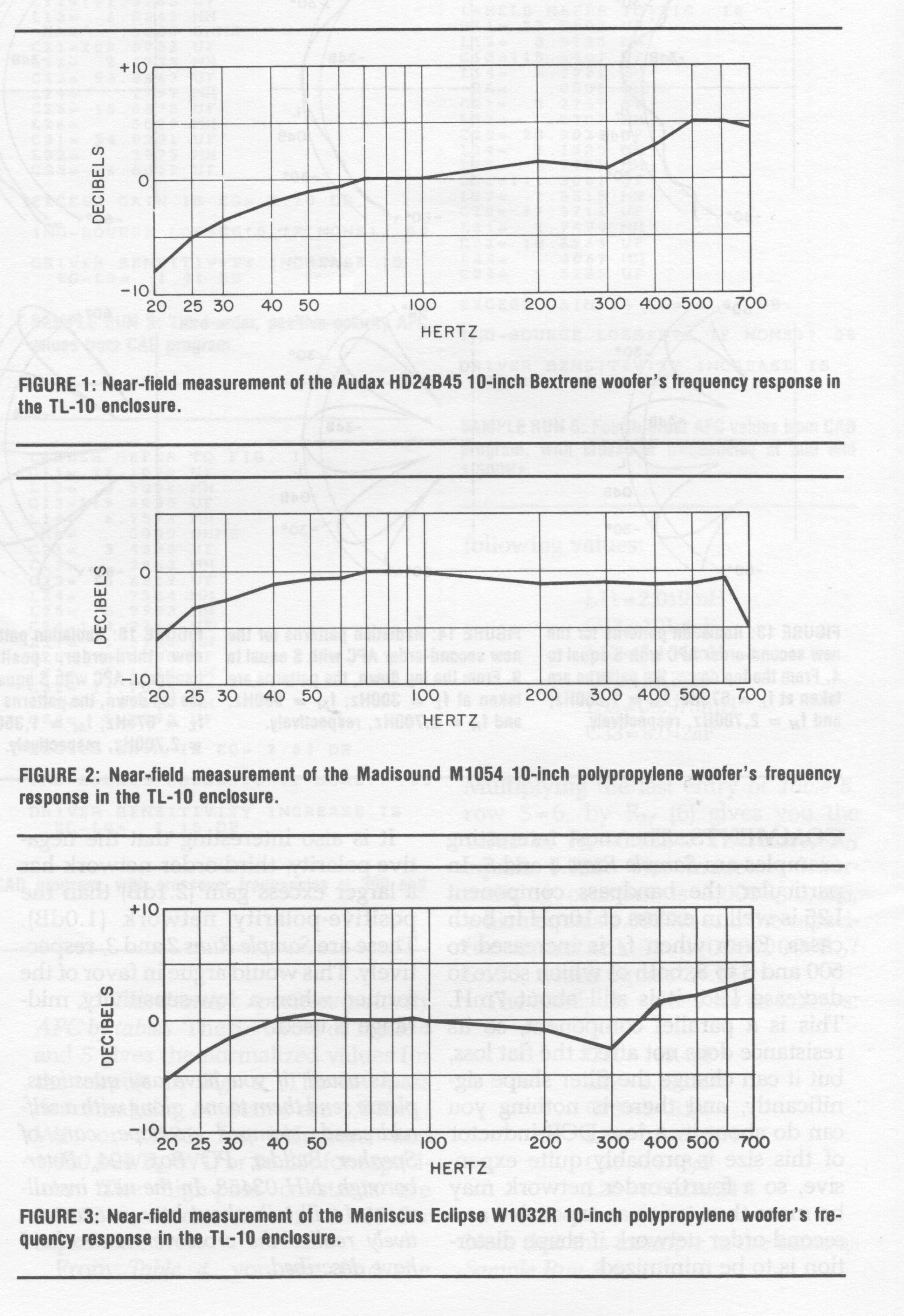

Below are some other examples of the Bailey lines. The first figure is Bailey's and the second picture are published by Gary A.Galo in Speaker Builder.
To be able to measure that low you would need a sizable anechic chamber…
dave
You are right. You see that my measurement stopped at 50 Hz because the reading below that were unreliable. I could hear the Bailey TL go much lower than that and estimate the -6 dB point to be around 30 Hz.
I did the response measurement using near field mikes at a large size empty lab, but not an anechic chamber. It was a poor man's version of D.B. Keele's nearfield technique. I was able to do it when I was a graduate student.

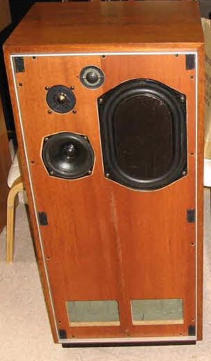

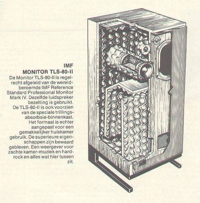

Keilau, you must just speak your truth and ignore the rudeness. Anyone who spends a lot of time here must be some sort of social misfit in my opinion. 😀
But, TBH, I have yet to hear a transmission line that excites me. The IMF TLS-80 with a KEF B139 was one of the dullest speakers I have ever heard.
No dynamics or presence whatsoever. It always sounded like it was playing in the next room. :down:
