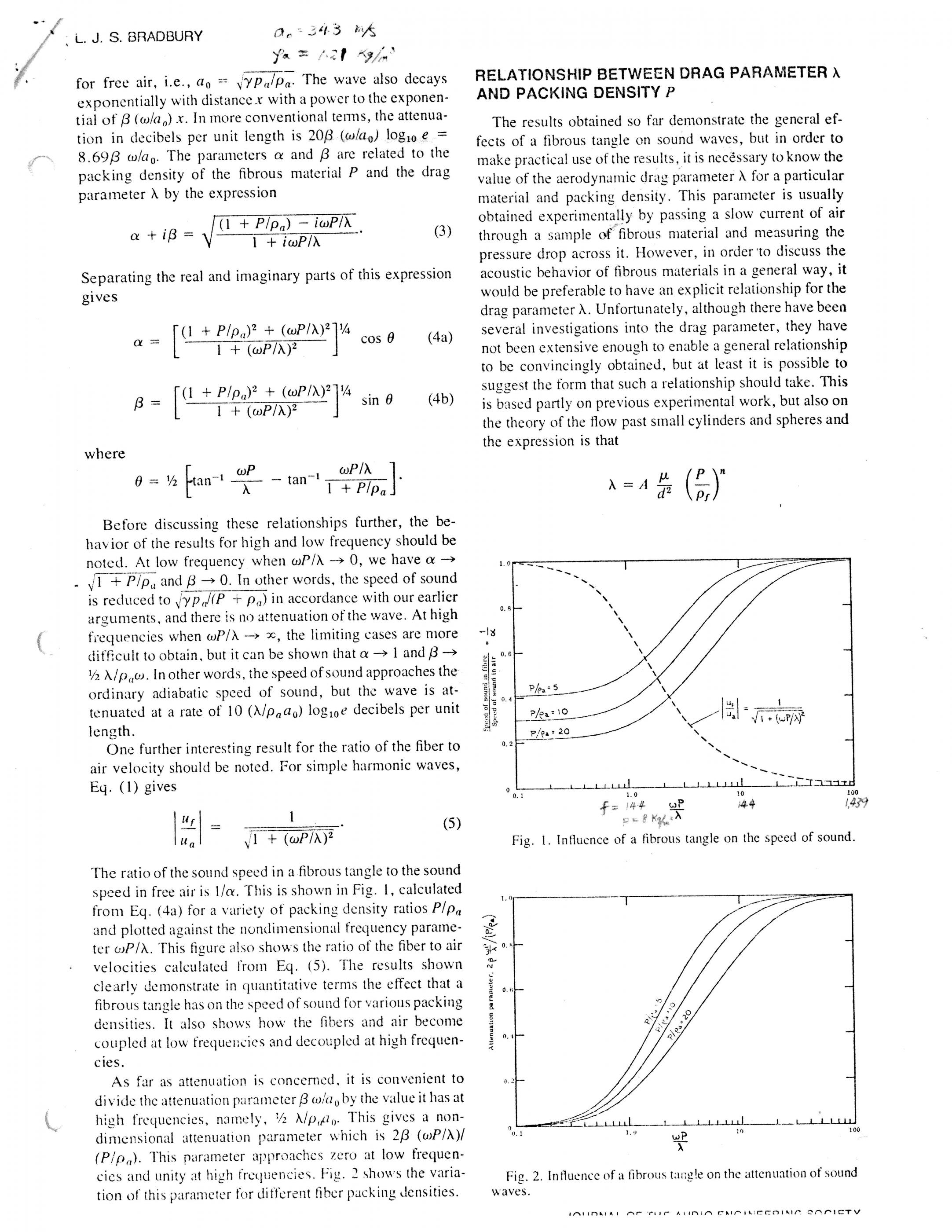

Arthur Bailey and Leslie Bradbury provided very high quality test data in their articles. If those are not real physics, I don't know what it is. If you do not agree with with Bailey that the front and back waves in his tube are "in phase" (half wave) and the calculation of Bradbury's, show us yours.
If Bradbury's analysis and test data do not convince you that every type of fiber works differently in the TL tube, nothing else would. I am against anyone who changed Bradbury's equation to do misleading calculation that makes no sense to real physics. They never provided any test data to validate their calculation like Bradbury did.

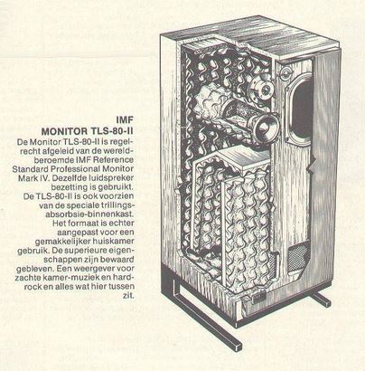

Correct me if I'm wrong, but a highly damped and labarynthine enclosure like the IMF TLS-80 must add a lot of delay with a long path for the bottom end at least. That dimpled foam must be a goodish idea for sheer resistiveness to airflow though.
I suppose we have various grades of transmission line, stretching from the IMF type through the quarter wave transmission line to the long reflex. Much the same thing according to Planet10.
They all have deep bass in spades. TBH, I get a bit confused about a floor pointing quarter wave or reflex, and a forward pointing IMF type.

It is unfortunate that the Bradbury paper is copy righted by Journal of Audio Engineer's Society and each download by non-member will cost $25. Below is the page of the Bradbury paper where a typo of the equation occurred.
Bradbury showed the computation results of air speed reduction and sound pressure attenuation in Figures 1 and 2. You will not get the numbers in these figures until you correct the size typo in equation 4. Once you do, bingo.
Because Bradbury presented his early calculation in parametric form, it may have caused additional confusion to the readers as I can see from comments by Martin King and Planet10. Instead of frequency, the early calculation was ploted using a wave number parameter, including packing density and drag coefficient. For a long fiber wool filling of 0.5 lb/cuft, you can get the frequency valve by multiplying the parameter (omega x P/lambda) by 14.4. From the Figure 1, you can see that the air speed is reduced by 1/2 at around 25 Hz. The actual reduction is a non-linear function of frequency. That makes the 2 meter Bailey tube a half wave length one at 25 Hz. Because the tube did not stretch in real physical length, it may be hard for some reader to accept calling a 2 meter tube half wave. From the attenuation plot in Figure 2, you can see that long fiber wool will present a very reactive loading to the woofer driver.
All the above results show that a long fiber wool reacts with sound wave very differently compared to other fibers. Bradbury did not include polyester in his analysis. I suspect that he knew that polyester had little reduction of air speed and poor attenuation in upper mid bass.
Because of these effect, it is technically correct for Martin King and Planet10 to call the polyester fill TL tube quarter wave and treat it as a resonance vented tube. Their design is based on completely different physics than the Bailey approach. It is just confusing to call both transmission line.
The fiber stuffing inside a closed box works differently again. The effect is mostly thermodynamics. Ken Kantor of the NHT fame did a fairly thorough research on various fiber while he was at AR.

No, not all transmission line are created the same. If you build the Bailey transmission line, yes, "transmission line is actually a quite shallow rolloff, whereas reflex is steep. So transmission line is quite fast and dynamic".
George gpapag showed the impedance curves in post #21. I showed mine, both impedance and response curves, in post #22. In post #43, I showed the response curve from Bailey and several by Gary Galo. You can see they all have "quite shallow rolloff". Yes, the Bailey style transmission line are all "quite fast and dynamic" based on my listening test and others.
The above mentioned description does not necessary apply to those who build with a "quarter wave" plan. From what I can find on the net, those typically have the steeper rolloff of the bass reflex and a pronounced second bump in the impedance curve. Which one sounds better is NOT the discussion here, just their difference in measurable parameters.
