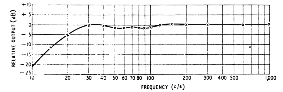

First, the FR published in Bailey's article:
On 1st approximation the roll-off is 12 dB/octave… 34 Hz at the start of the roll-off, down an estimated 24 dB at 8 Hz, 2 octaves lower. If we take the -3dB point as the knee of the filter (22 Hz) we can see it is down about 18 dB at 11 Hz.
A side-effect of this observation is that if keilau's line has a 1st order roll-off it is not a Bailey line.
