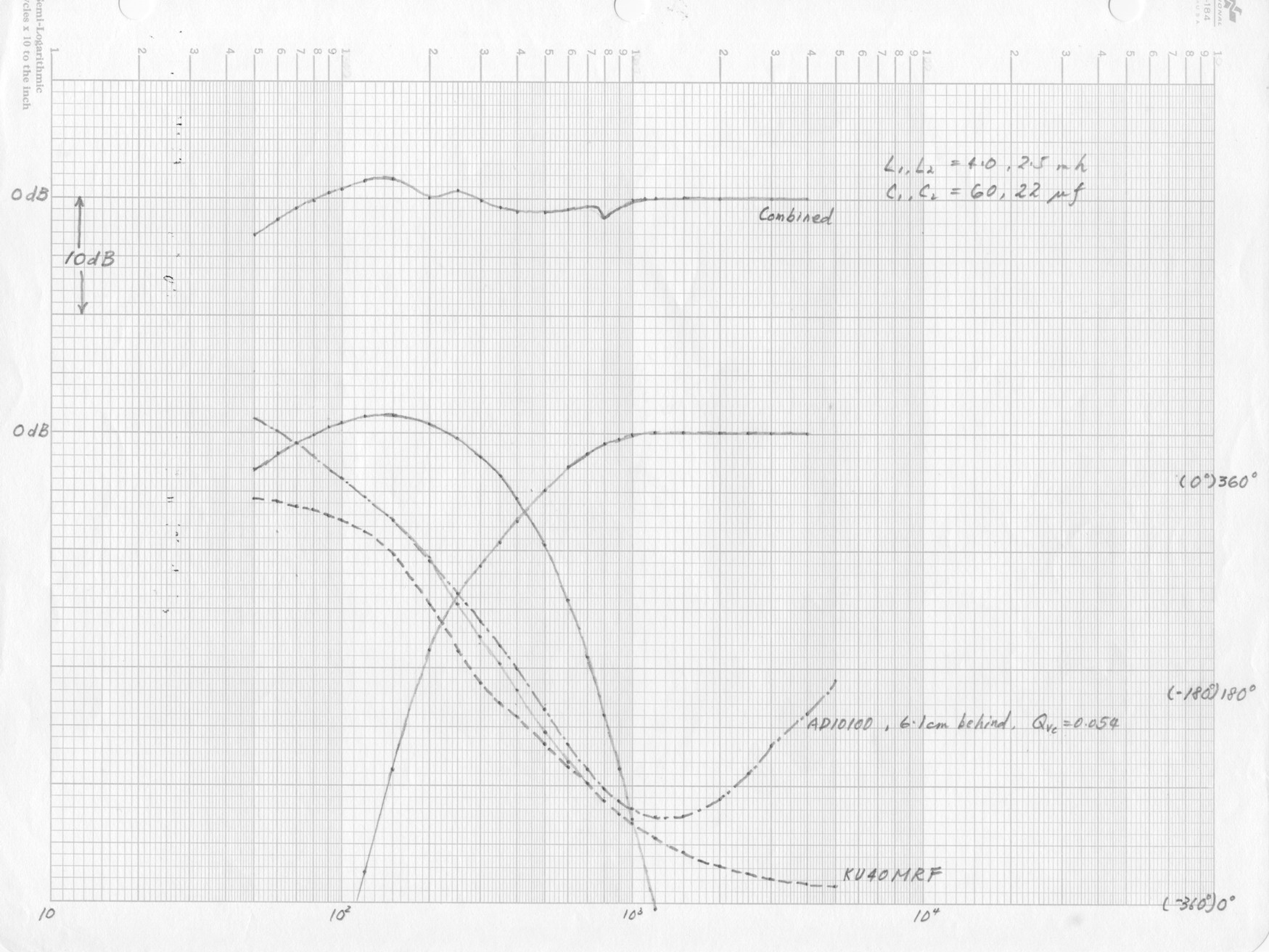

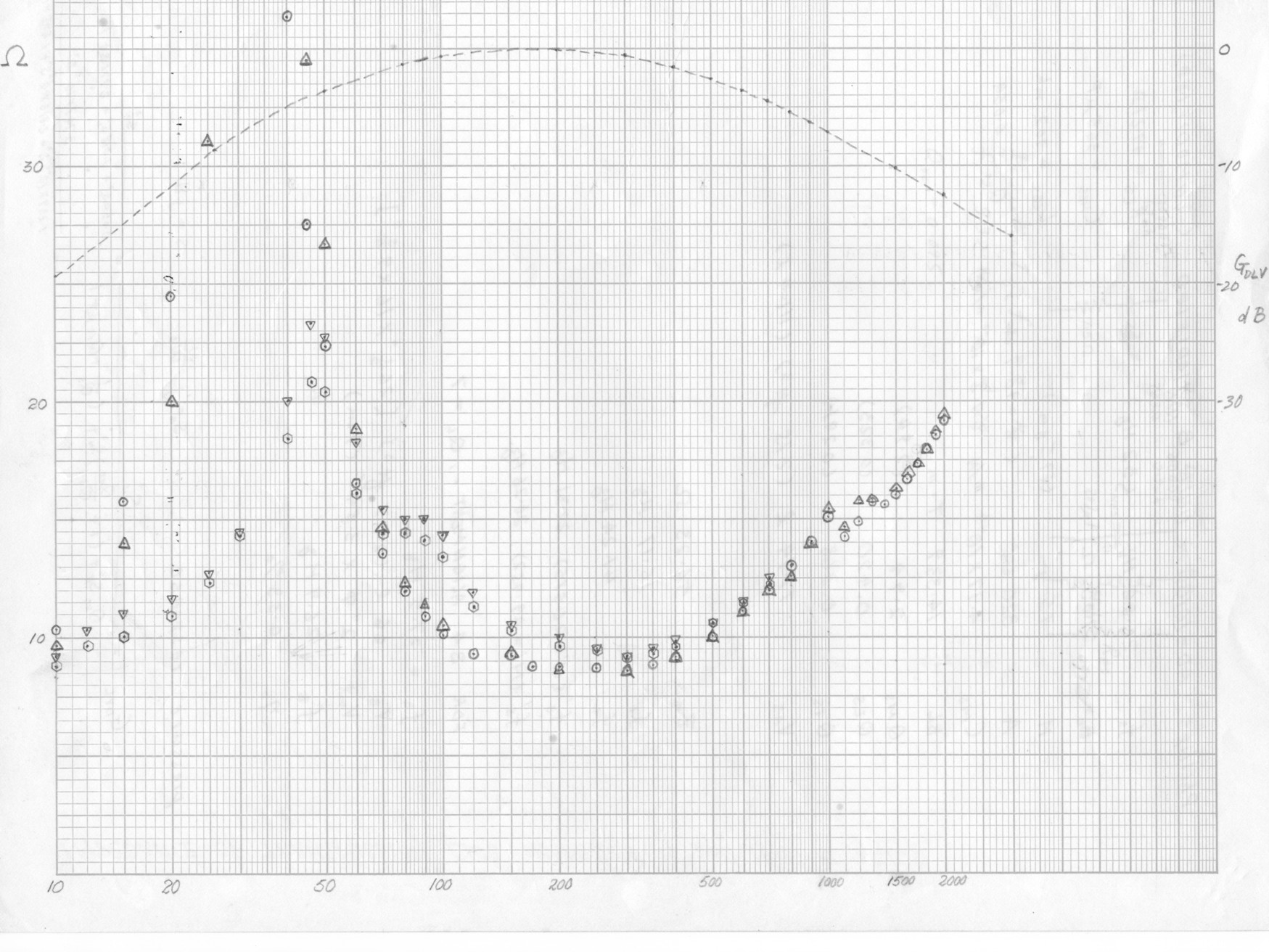

Hi, George, thank you for the post. After so many days, I almost thought that I was the only person on this forum who ever built and measure a Bailey TL enclosure and stuffed it with long fiber wool.
I built the same triangular design as you did when I was a graduate student a long time ago. I could not afford the KEF B139 and used a Philips AD10100 instead. My measurements are shown below, impedance and response. On the impedance plot, the circles and up-triangle are free air and the hexgon and down-triangle are inside enclosure. (Sorry about the chartsmanship. It was long before the PC computer time.) Also like your results, the woofer resonance peak is much reduced from 67 ohms to 25 ohms (compared to free air) and moved up in frequency, from 32 Hz to 46 Hz.
Both of our measurement definitely show no second resonance peak of that of a vented enclosure such as the MLTL. The long fiber wool works exactly as Arthur Bailey and Leslie Bradbury described. The bass is fast (no ringing) and extend far lower than a closed box. It sounded wonderful to me. There actually a lot of similar result that appeared in the old Speaker Builder magazine in the 80's by Gary A.Galo, Roger Sanders and Robert Spear, among others.
The AD10100 does not go as low as the B139, but still got -6 dB down at about 30 Hz. The drivers had deterioted over time, the rubber surround lost resilance. The cabinet and wool still good. I got a pair of the Peerless 850146 (CSX 257 H 10" woofer) to rebuild it. The woofer should be a drop-in replacement. Very easy, right? No, my wife will not allow it back to the listening area until I replace the wood veneer. With 2 bookshelf projects ongoing, the re-veneering may take a while. 😱 That WAF!

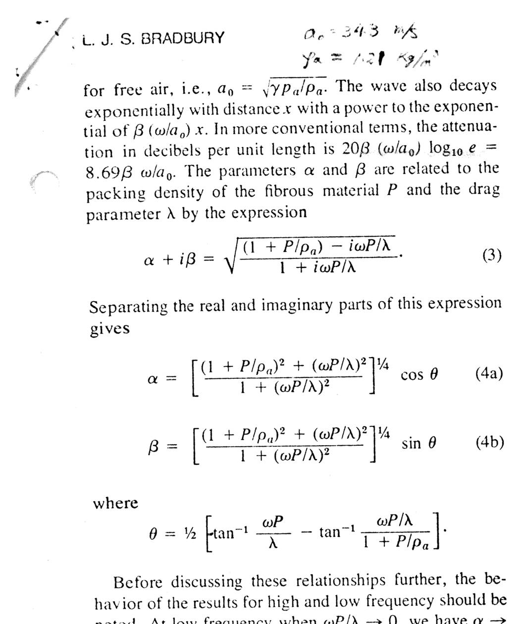

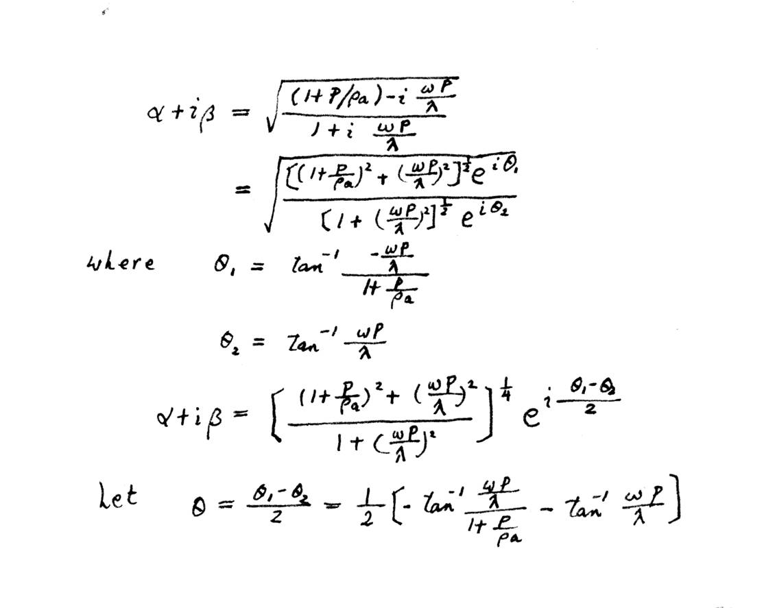

I try to explain how the Bailey TL works in layman's term. Leslie Bradbury developed one of the most elegant mathematics model for fiber filled enclosure. I tried to replicate Bradbury's calculation on a HP programmable calculator after I read the paper and found that I did not get the same numbers as he did in the paper. I found the typo when I went through the derivation of his equations and reconciled the calculation. I concluded that it was a typo made by the Journal of AES, not a mistake by Bradbury.
Through this process, I saw the beauty of Bradbury's work. The typo was a small, but critical one. In picture 1 is the original text in the AES Journal. In the definition of theta just under equation 4(b), both arctangent terms should be negative. The typo is missing the first "-" sign.
In order to perform numerical calculation, you need to convert the complex number in equation (3) into real and imaginery parts. Picture 2 shows how I duplicated Bradbury's derivation. You convert the complex numbers into polar form to do the division in equation (3). Then convert it back to real and imginery parts of equation 4(a) and 4(b) for the calculation. Very simple operation for students of linear algebra or engineering mathematics class. But the resultant equations of complex numbers are non-linear and do not lend themselves well to easy integration with vented box model using simple filter theory.
Yes, I understand that the Bailey and Bradbury works are NOT complete. They did not model how to couple the driver to the enclosure, thus, leaving the actual design as mostly empirical. The work by Bailey and Jastak (1973 Audio Amateur) filled an important gap.

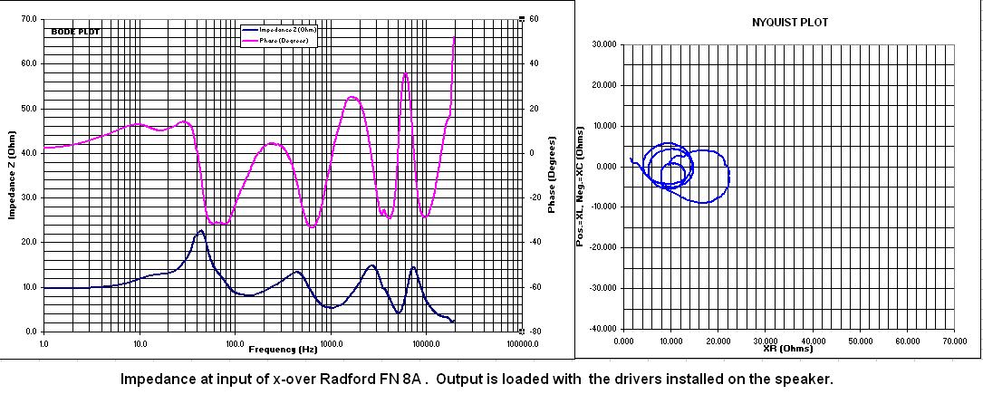

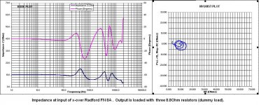

I can not contribute any thing productive to the discussion btn Kei and Dave.

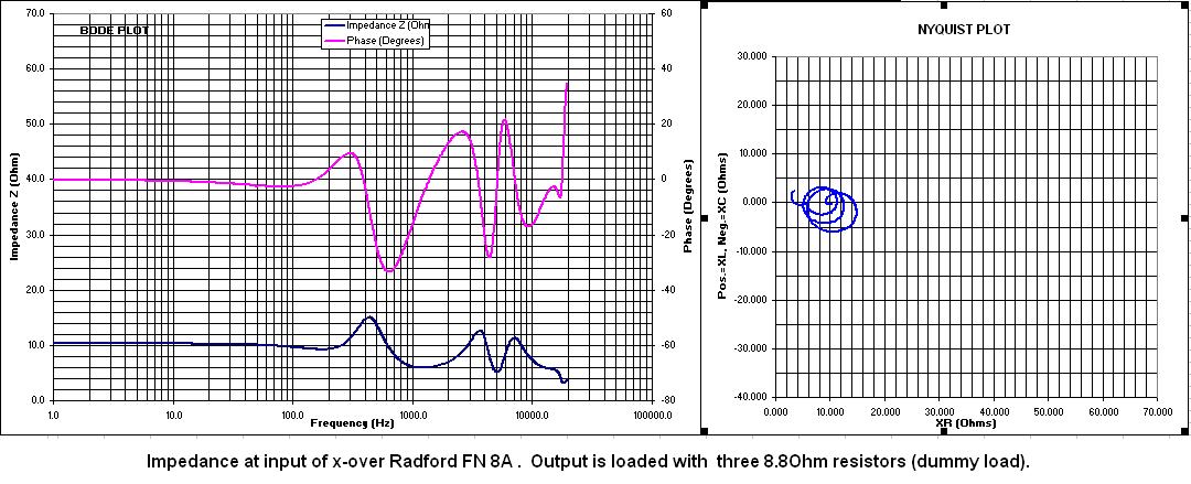

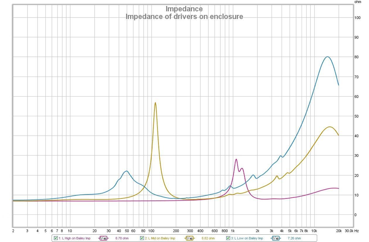

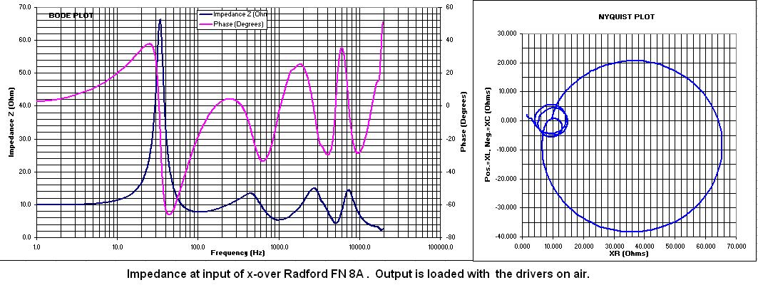

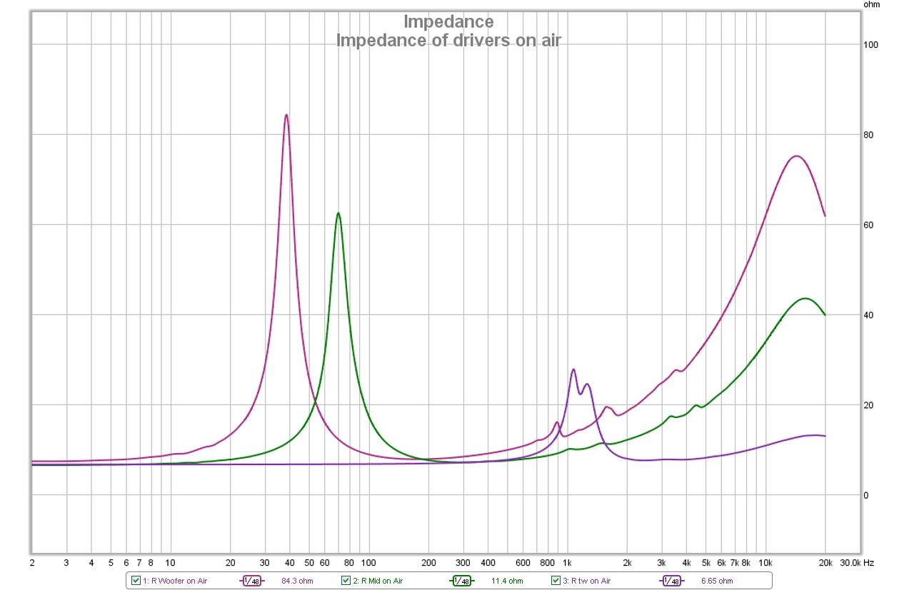

I realise now that I should have measured the impedance of the B139 on the unstaffed TL too.
Regarding the initial post of onkyponk, I would encourage him to build the triangular TL of Baily. The bass is tight with weight, very good control, cabin is relatively easy to build.
Drivers
Tweeter: KEF T27 SP1032, B0779
Midrange: KEF B110 SP1003 C2079
Woofer: KEF B139 SP1044 C1579
x-over
Radford FN 8A (air core coils)
The attachments are for you onkyponk
The only deviation from the original plans is that the midrange had it’s own closed box ~150x150x150mm with lose glass fiber stuffing.
The x-over/speakers are not a very heavy load. An amplifier with a properly sized power supply drives them well. The difference will be noticed on the control of the bass.
George

Read the measurement and analysis that Bailey and Bradbury did, particularly page 167 of Bradbury.
bradbury said:The main idea behind a labyrinth type of cabinet is that at high frequencies, the fibrous material should damp out ALL internal resonances and present a constant resistive impedance to the rear of the loudspeaker cone. At these higher frequencies the reactive impedance should be very small. However, at low frequencies bass lift is supposed to be achieved by producing sound at the open end of the labyrinth that is in phase with the sound radiating from the loudspeaker directly. The effect should occur when the wavelength of the sound in the pipe is in the region of twice of the pipe length.
I believe Bradbury's description is technically very accuracy and he had both analysis and test data to show it. If you do not agree with his analysis or data, that's fine. Bailey also emphasize that his enclosure, while a physically quarter wave long tube in free air, is an effective half wave length pipe due to reduction in air speed.
The beauty of the Bailey idea is in its non-linear nature in the bass region. The sound pressure attenuation get less and less as the frequency goes down while the reduction of sound speed increases at the same time. Bradbury quantified the properties of the fiber that would produce the Bailey TL effect and showed not every fiber were the same.
I built the Bailey box and stuffed it with 0.5 lb/cuft of long fiber wool. I measured both a 6 dB/octave response curve and significant sound pressure at the terminus. My experience is NOT unique among Bailey line builders.
