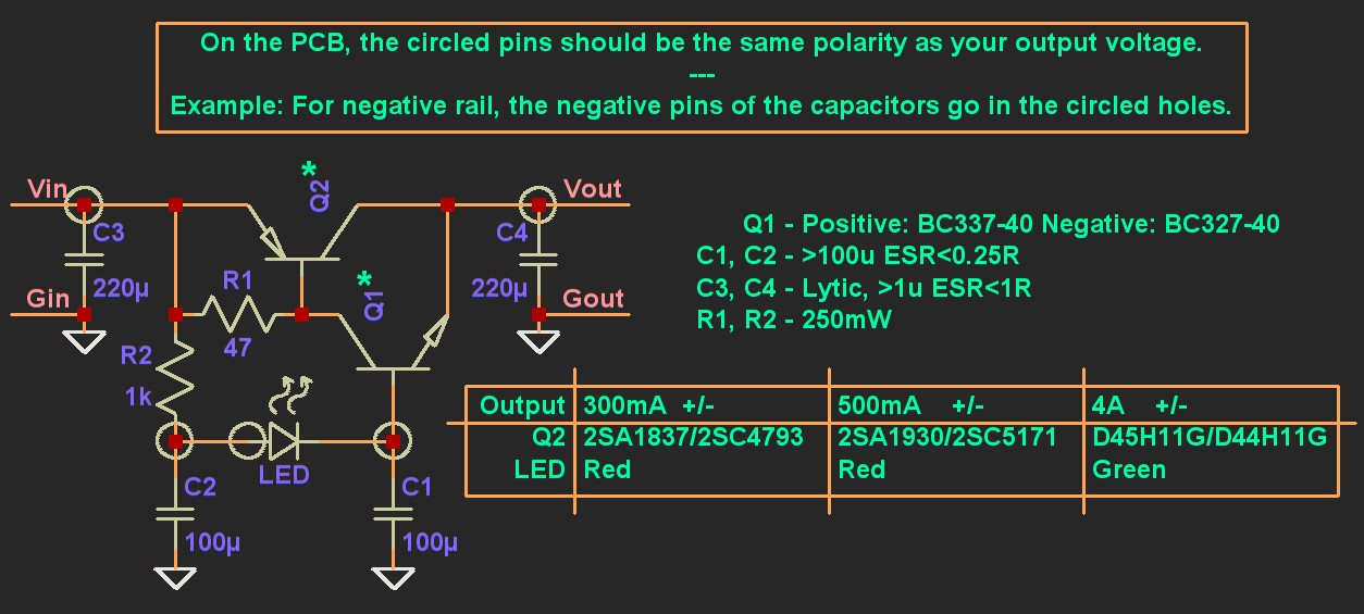

Does anybody have a proper pcb layout from the latest design for my inspiration? I like to make my own to learn these things (Target program)......
This is the current schematic that goes with the current PCB.

My boards aren't necessarily good to learn from because of the ground plane.
These boards are flawed, but they may give you an idea.
DirtyPCBs.com
Take note of the patch I described below. The connections on the board are correct, but in the wrong order in such a way that parasitics cause oscillation.
They can be made to work if you wire C1 directly from Q1's base to the ground pin of C5, and do the equivalent for the negative side.
