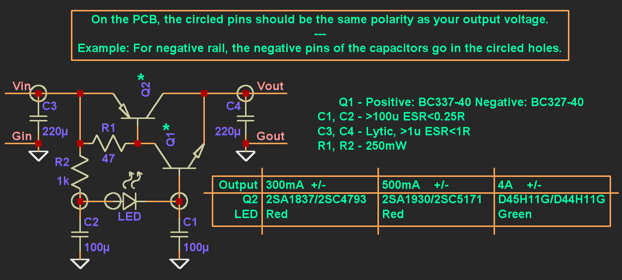

Assembled it for >50v version. Easy to work with. I just noticed that my Vdrop is little higher than in my previous builds. It is about 2.3-2.4V.
Is it normal?

Yes, that is normal. If you want lower you can replace the red LED with 3 1N4148.
EDIT: Hmm, I'm not sure. What is the voltage across the LED?
I did not measured V access it, but I see very low current is running through it during continues operation. It's blinks for 1/2 sec during start as well as my green LEDs and still show very little light after that. Greens are totally off after initial blink. Not big deal with such Vdrop for me since I have sufficient margin.

So what you have isn't exactly what's on the PCB. If you used the green LED for the stock PCB, then yes the voltage drop will be higher. That is for high current versions. For normal KM you use a red LED.
Sorry for confusion and please consider that I use Red LED for KM, but I also I use 2 Green LEDs is series and 2 UG1B for my >50V version.

As for BOM, this image covers a few different options for the board.

Can the LED be replaced with LM336, 2,5V? Specifically, this at least could be good for the higher current version. [Sorry should try first but I'm lazy in the summer
No, the resistance of the LED is actually good for the circuit. A precision or low noise reference here would not make it more precise or lower noise. The LM336 probably doesn't work well at low currents anyways.
