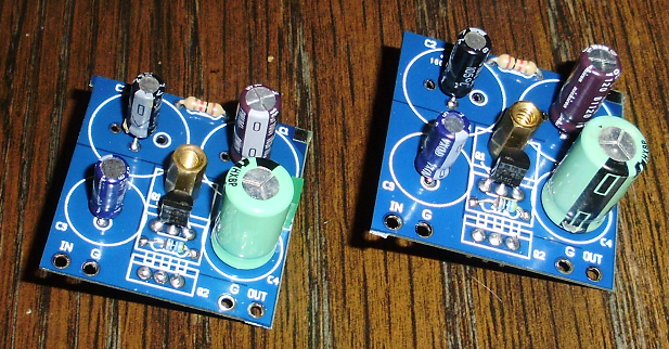

I'm just catching up on the recent activities here and understand that you've sent off the pcb design (as per post 785) for a prototype version am a bit puzzled by the missing component/networks of D3, D1+R2, D2+R8, and D4 - are they not necessary anymore or simply tacked on below the board later?
If I follow the same numbering system on the explanation page, your pcb appears to have an extra capacitor on the input with a series R (top edge) to make up a C-R-C with the C3, onto R1, C1 and the base of Q1 (bc337), yes?
So, theoretically anyway, to complete the supply, you'd just need a simple pcb with the diodes and secondary winding snubbers, yes?
Would there be any advantage to move this 'series R' down between the first cap and the C3 side of the pcb, then move the R1 into the now vacant R position and simplify the tracks to the C1 and the base of Q1?
Also, would it any advantage to reduce the ground plane to a thick track that connects the ground terminals of the extra input filtering cap (plus the C3) to the main ground plane in order to provide some extra pcb impedance to input ripple - or am I talking nonsense (again!) ....

The protection diodes never seemed to work, since the majority of accidents seemed to be direct short discharge which will probably destroy the transistors anyway. Normal PSU operation doesn't seem to cause any problem for the KM so unless you want to use it as a bench supply in the trenches, the diodes aren't really necessary.
This board doesn't have a rectifier on it so yes, you will need one. Or power it from a regulated supply like some people do.
The amount of filtering you would gain by removing the ground plane will be insignificant compared to the output inductance of the KM and the inductance of the wires you power it with.
I think the traces are already as simple as they can be. The 1k/C2 filter feeds the LED which feeds the transistor base.

Yes, as I mentioned in the original post. Don't forget the LED.
To fill the board you simply look at the circled pins. They must be the same polarity as your output voltage. So if your output voltage is positive, all the circled pins are positive. It fits terminal blocks and works up to 50V. It could also be used with D4xH11G for 2A output or so.
