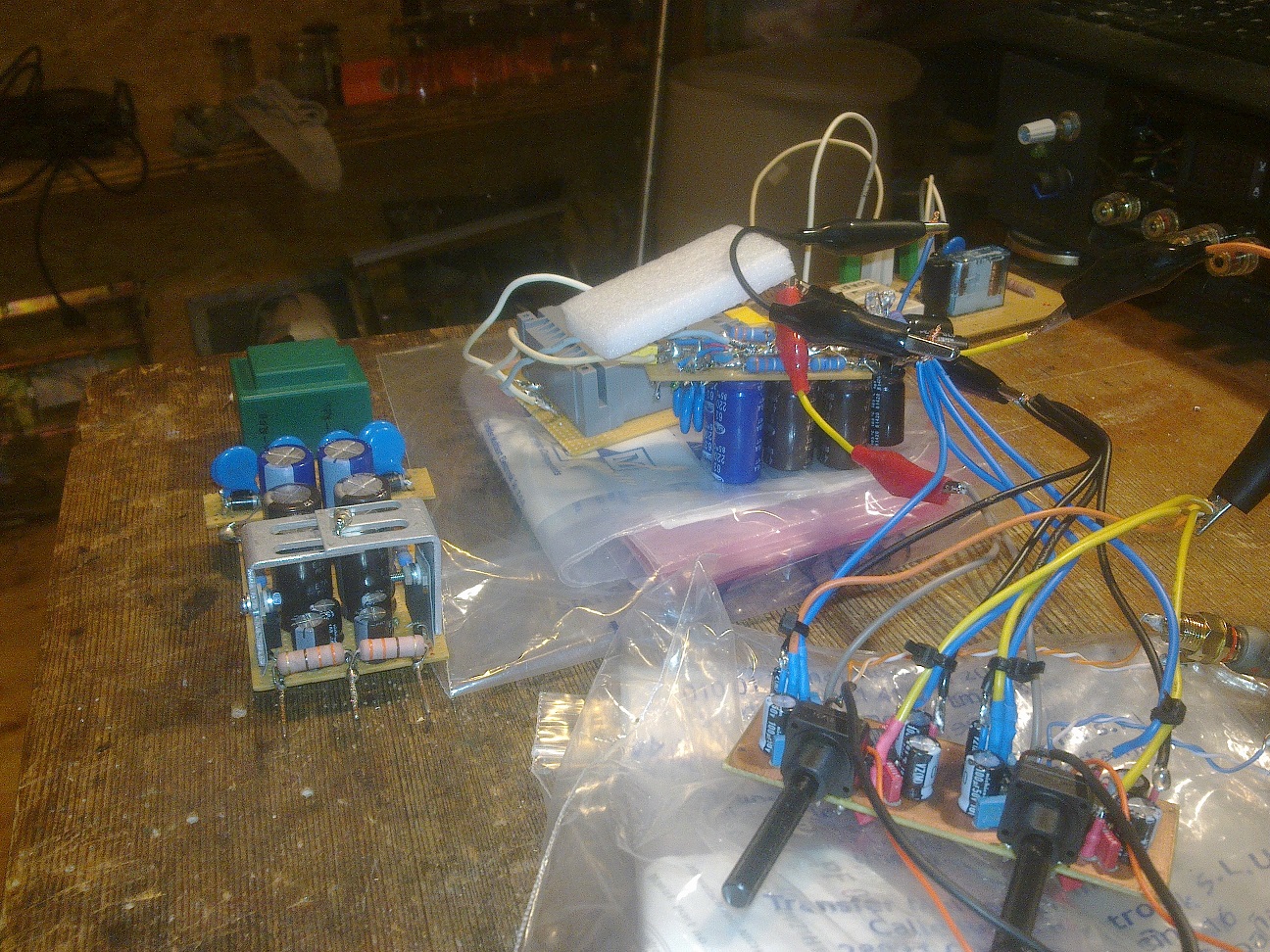

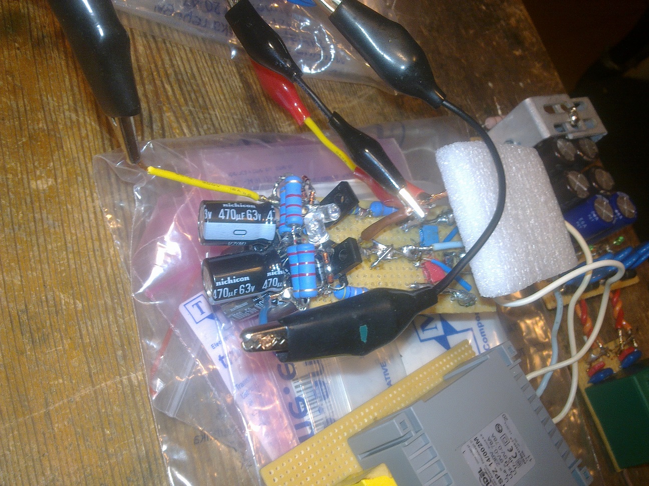

keantoken, i finally had time to test your circuit in real action.
Yesterday, i was modifying the Texas tidu34 volume control. Got it sounding just right with LM317AT+LM337AT. Using Thailand NE5532 and OPA2134 from texas.
Tidu34 controls the volume for naim NAP140 clone amplifier.
The i had an idea to try you K-multiplier:
1. Took a transformer 14VA
2. Built PSU filter with LOW ESR 470uF electrolytes.(CRCRC, R= 330mR)
3. At the last electrolyte from Filter-Bank, installed there k-multiplier.
Output before k-mult = 16V +/- VDC
Output from k.mult = 14V +-/ VDC
While soldering stuff together i was listening to LM regulator PSU.
Cut the power off Tidu34, replaced LM regulator psu with filterbank + k-mult.
Turn on and WoW, everything is sooo different... soundstage/dynamics/acoustic are completely new story lol.... how is it possible 😀
First i tought, its the filter in AC 230V line, today i removed the AC filter, sound is still same 🙂
I miss that relay switch to compare between different amps and speakers(and also switch between PSus)... i will get on it and then will tell the difference lol 😀
Some fotos:
Filter capacitors are all the same brands in LM and k-mult filter-bank.
All samwha-s, dirty cheap. Capacitance amount is also the same 2200uf + 2x 470uF.
Sound still so different 😀
