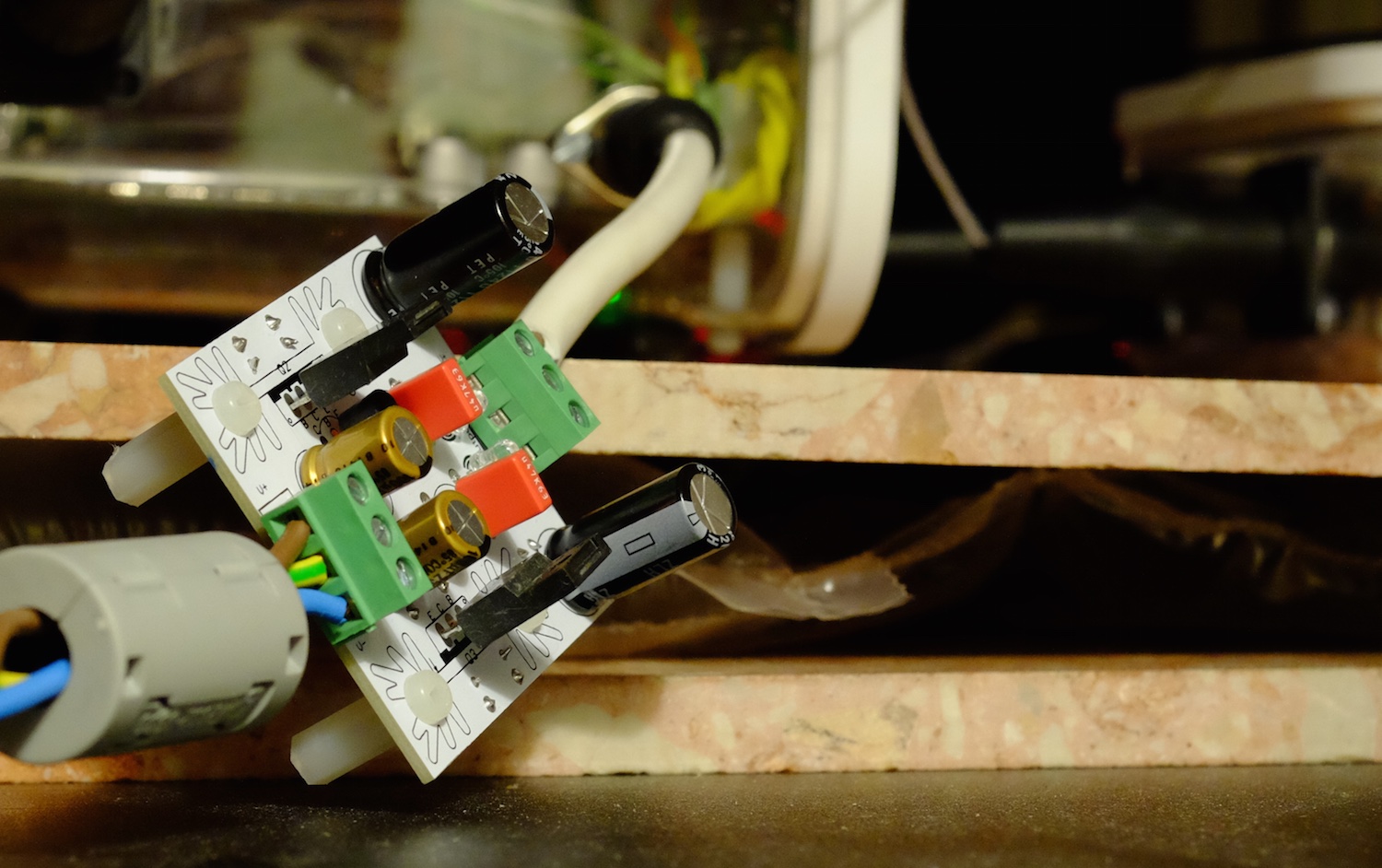

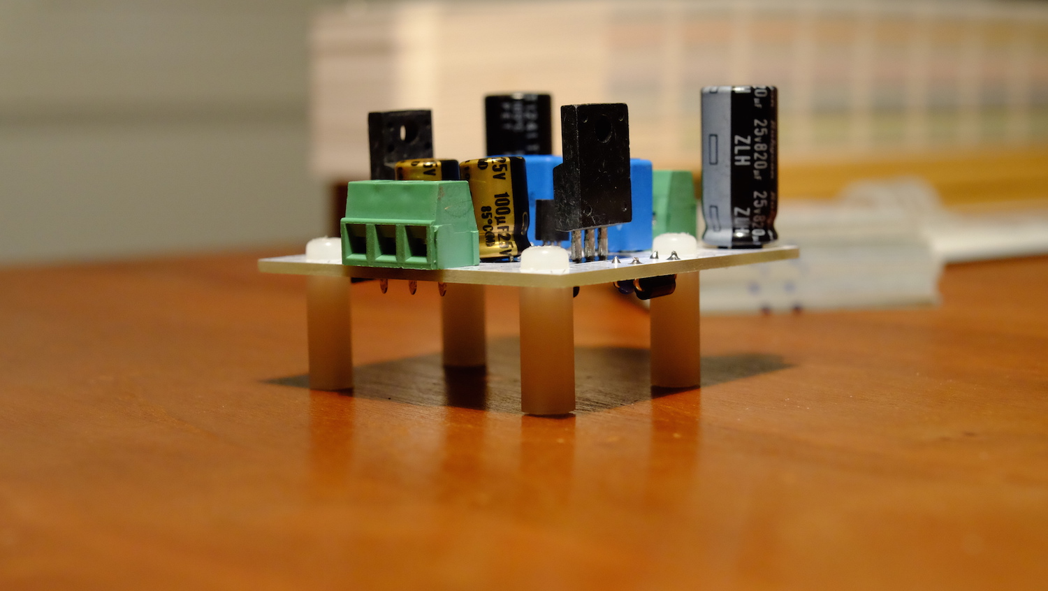

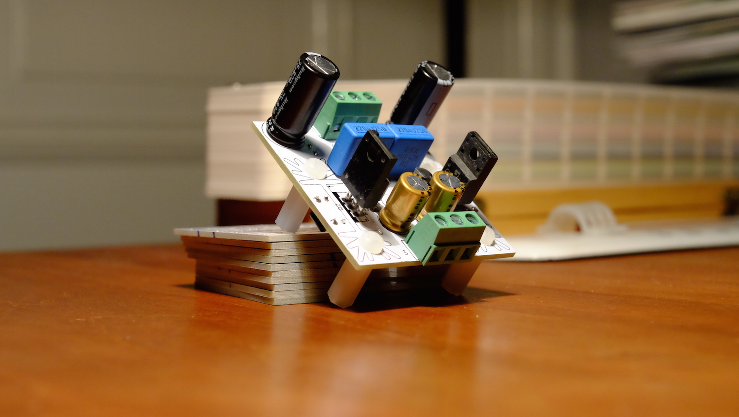

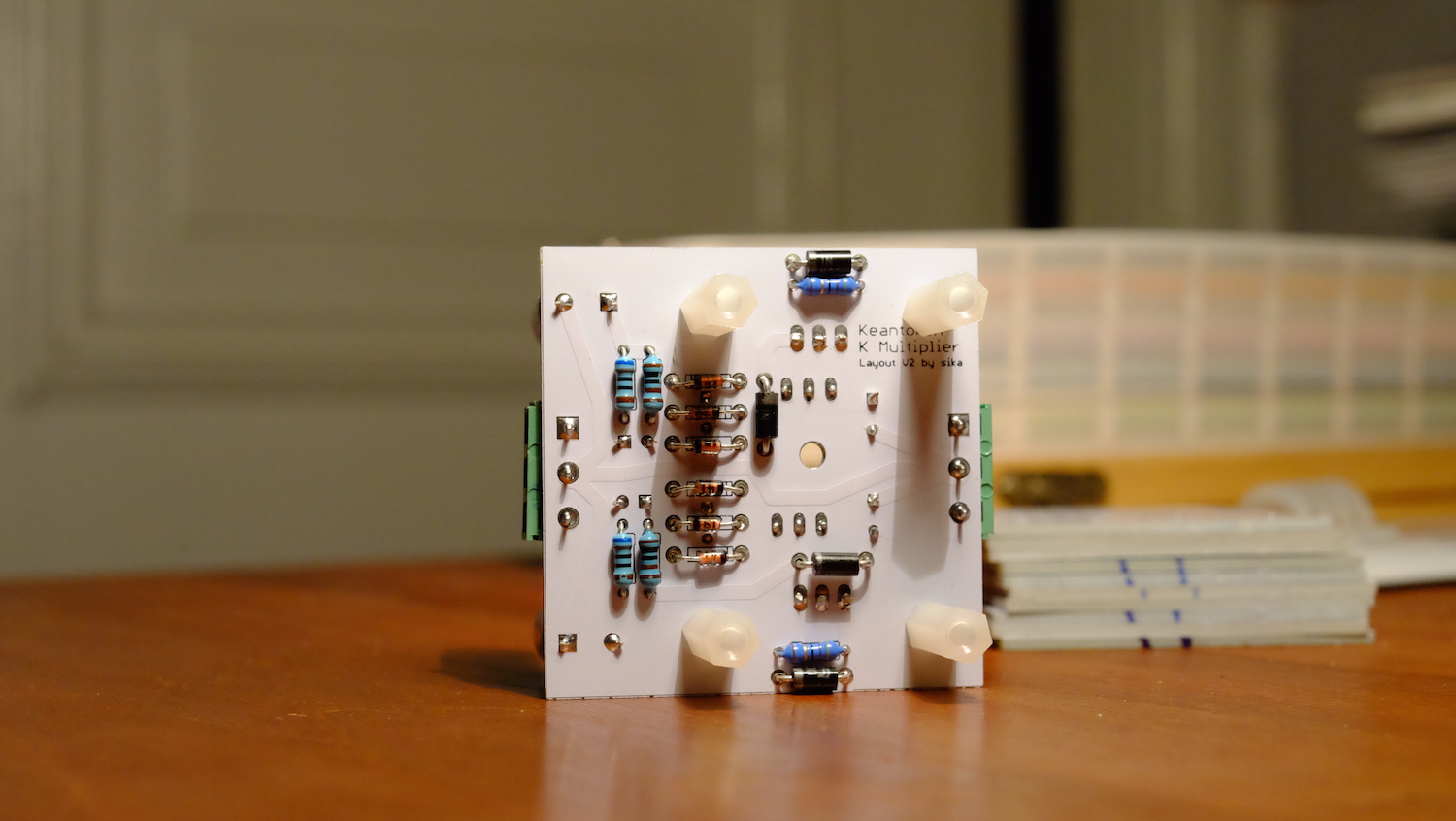

Got my K-Multy PCBs last Saturday. All 12 pieces look very nice. Can find any issue, at least via visual inspection. Yesterday assembled one and it works like champ. Sikahr, very nice Gerber work and DertyPCB made dissent PCBs. Thank you.
Alex, thanks for building board & confirming board working OK.
What's your plan to power with these boards?
I'm using this first PCB to power-up my Linkwitz filter for subwoofer. I already used these devices in Salas Raw DC for his FSP with an excellent results.
It dropped my V ripple substantially and Salas Phono with about 72 dB is very quite. Also, I used it in my J-Mo Mk II Headphone amplifier. Also with perfect result. Now I have 11 boards left and I plan to use them widely in my projects, but definitely and only when its really needed. That you for these nice PCBs.
