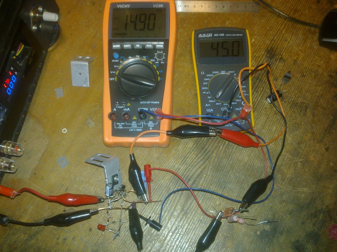

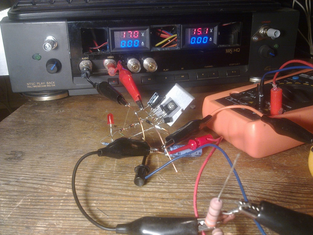

Build the positive side for prototype. Transistors used: BD138G and BC549C and 1000uF 0.06R ESR capacitor instead a 820uF.
On turn on, LED flashes once and than slowly vanishes away.
Seems it works correctly, output impedance is low due to zero voltage variations if load current is changed from 45ma to 140mA.
Voltage drop is 2.05V when the load is given, without load the drop is 1.6V.
Small meter shows current sinking from output "mA"
INPUT ~17V, output ~15V.

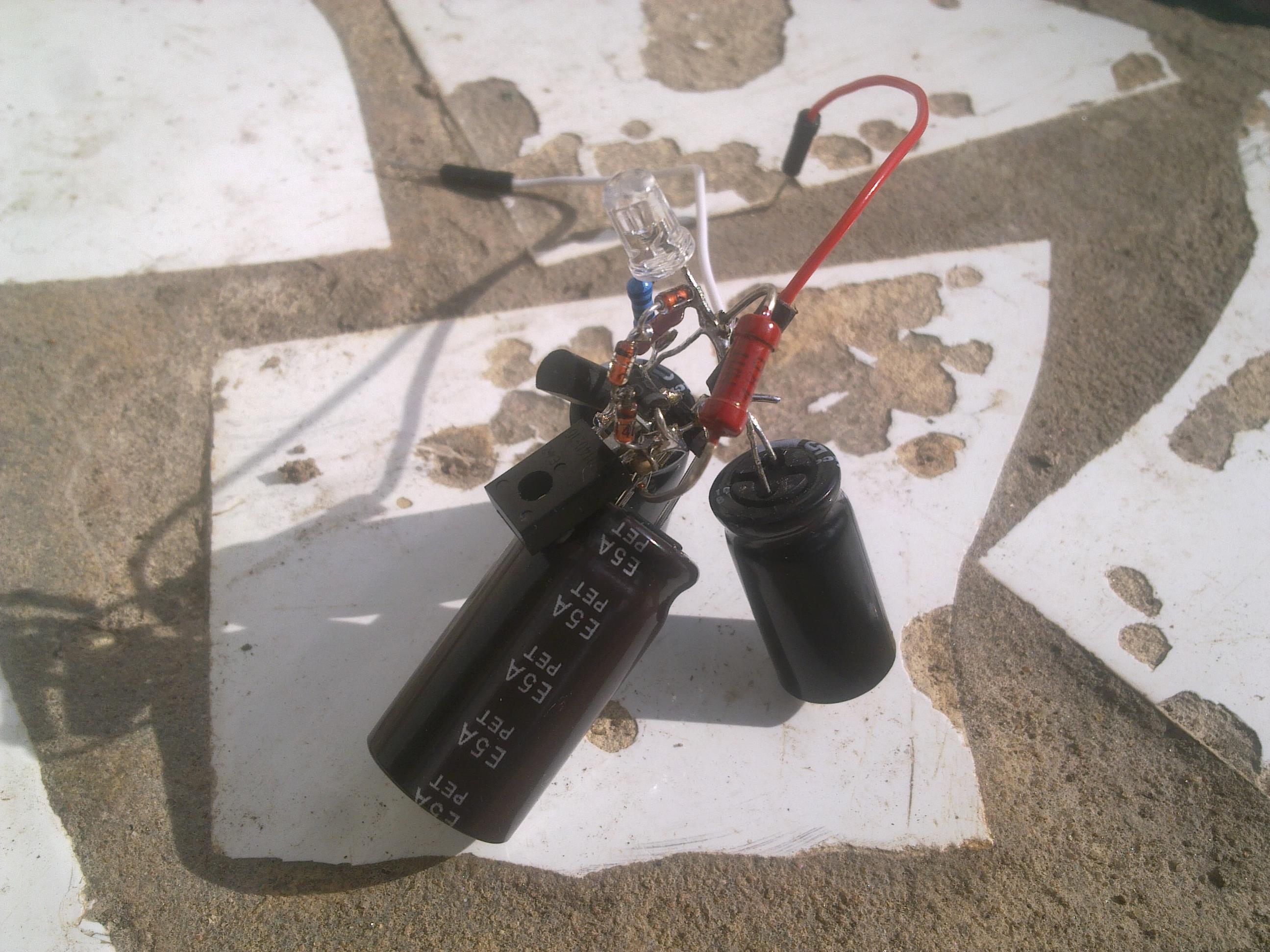

I have build another one(positive), with random 1N4148 diodes, 1000uF 200mR caps, Q1 BC337-40 PH59 and Q2 FairChild BD-140-16.
Everything is stock(default dummy load ~25mA):
across 3 1N4148 i get 1.7V drop
When working with 29.80V input, across R2(1K) i get 38mV drop.
Output - input voltage differential : 2.04V(takes a ~minute to settle down)
Applieng 160mA load to the output increases voltage drop on R2 to 43mV.
Is everything working correctly ? Going to adapt them soon in preamp psu circuits 😀

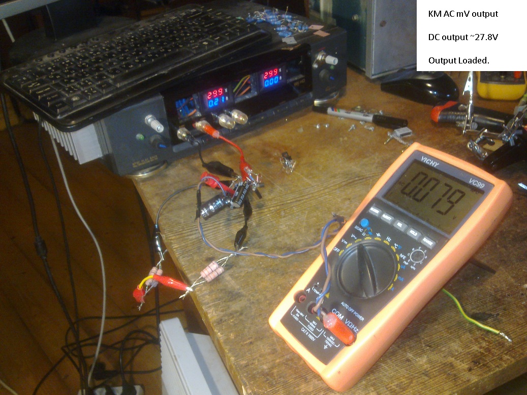

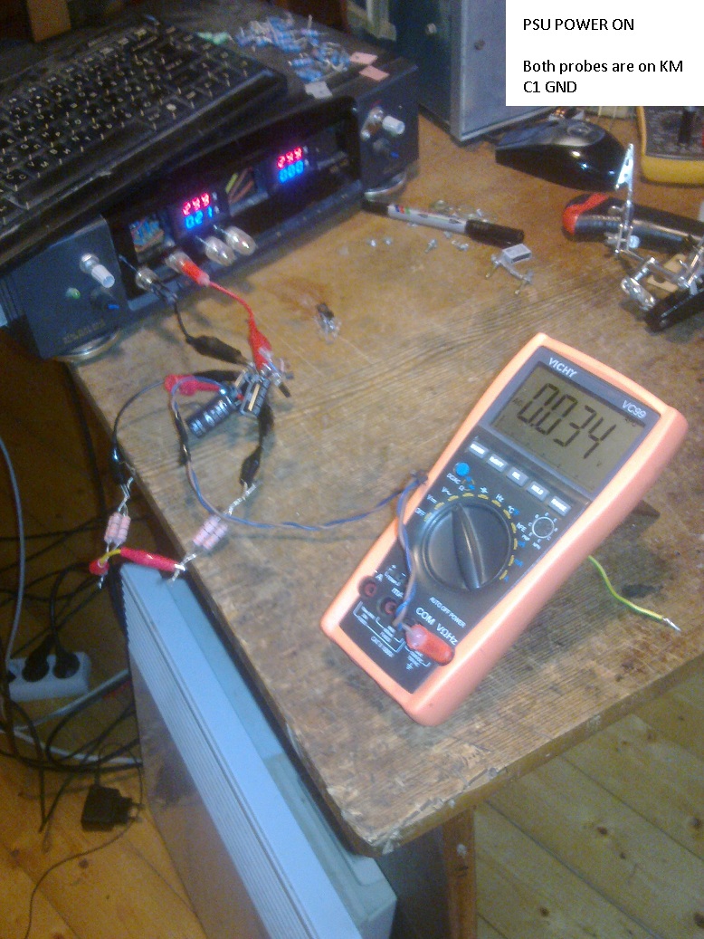

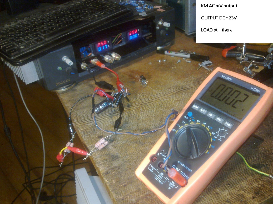

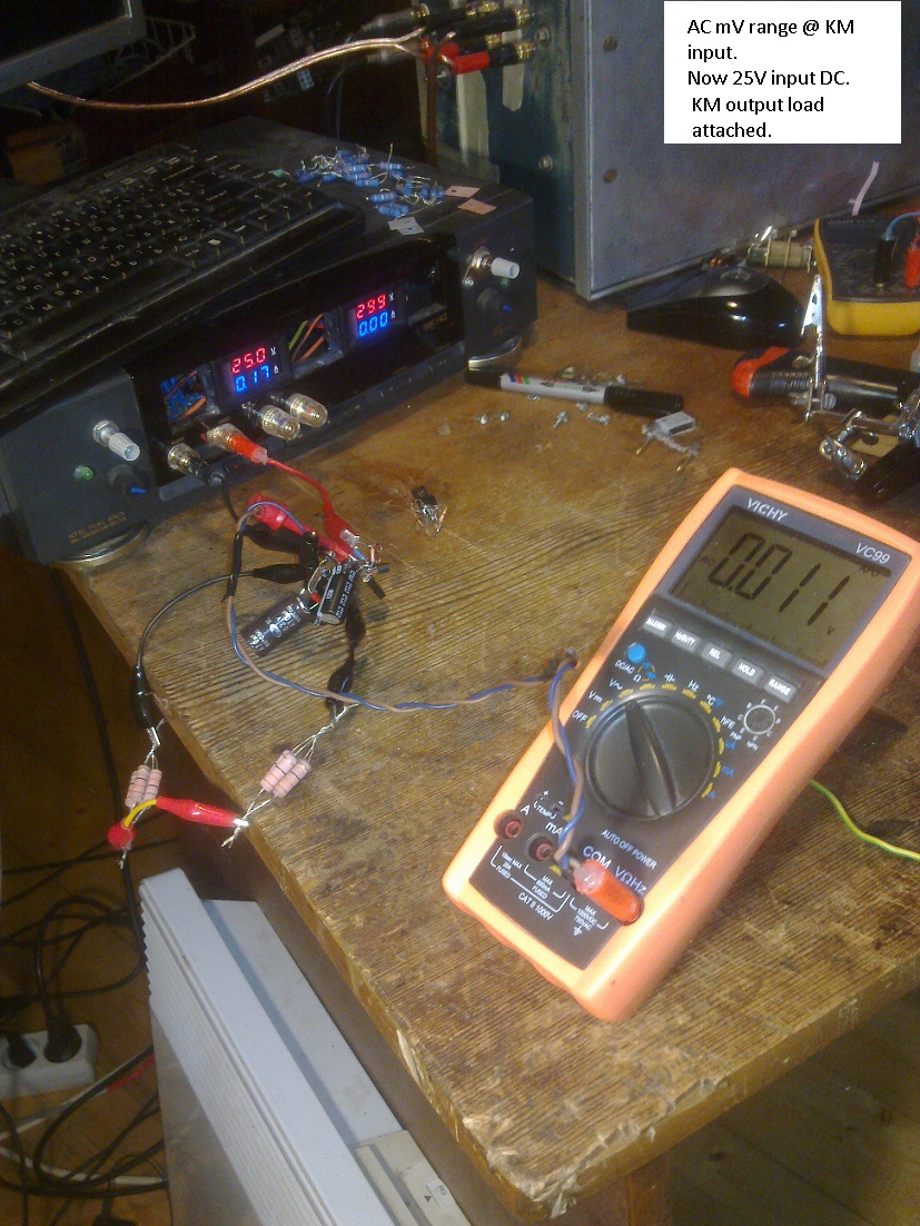

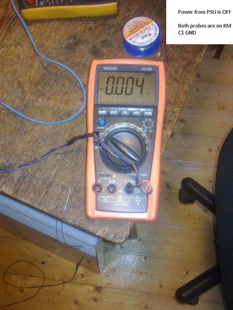

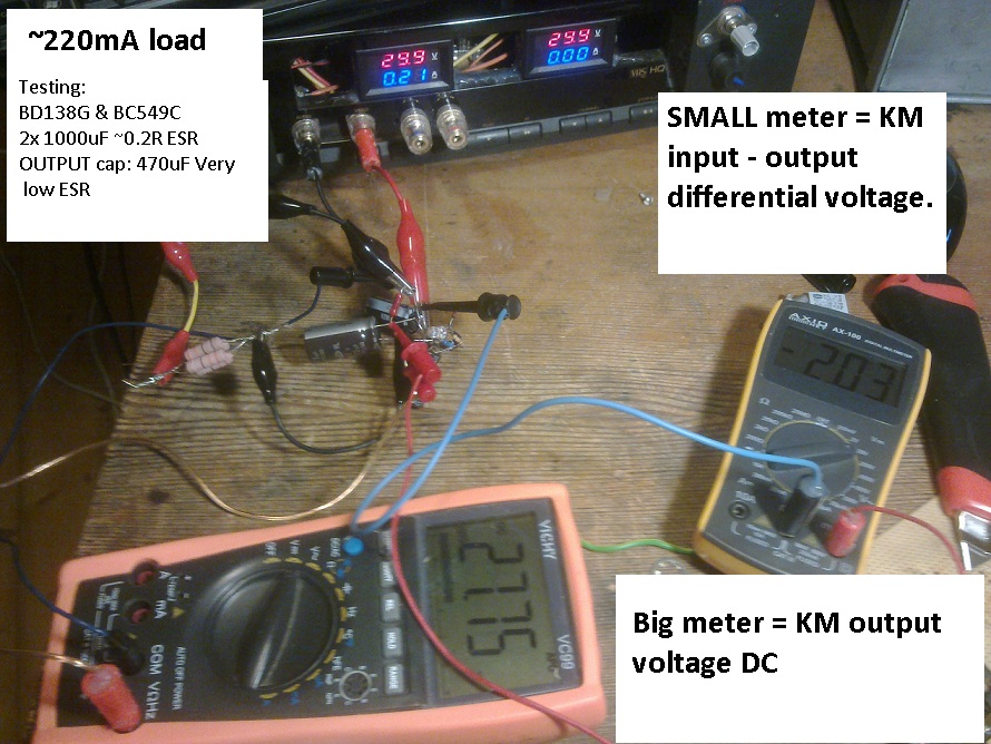

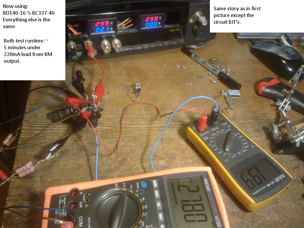

I made some measurements. All info is on the photos.
- First two pics are comparison between BD140-16 and BD138G builds.
- Rest of the pics are taken on AC mV range set to manual.
- DC measurements are accurate..
- AC measurements are questionable or not, you decide please.

The AC voltage with both probes shorted to ground should be nearly the same whether or not the PSU is on. It should be almost nothing. With this inconsistency I can't trust those measurements.
Yep, i re-checked PSU on or OFF, tried LM317 based PSU, same results(ACmV increasing when PSU turned on)
Ignore those measurements please.
While comparing BD140 and BD138G, i will go with the first BD140 builds.
First i will try them before the current regulator from apexaudio. Then i will test after the LM317AT & LM337AT psu right at preamp PSU pins.
