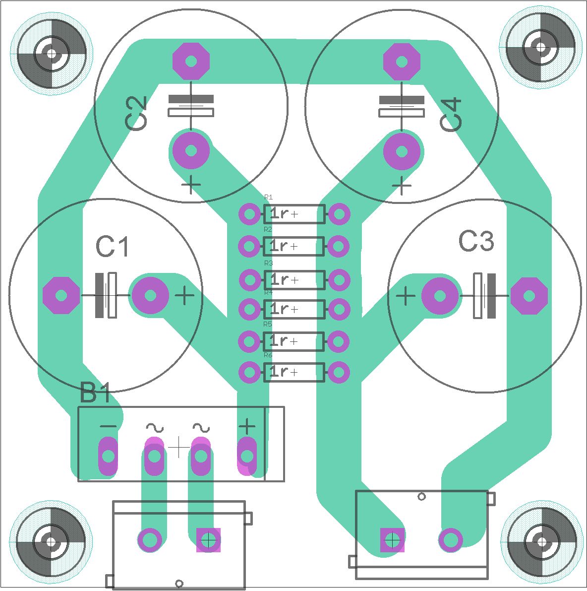

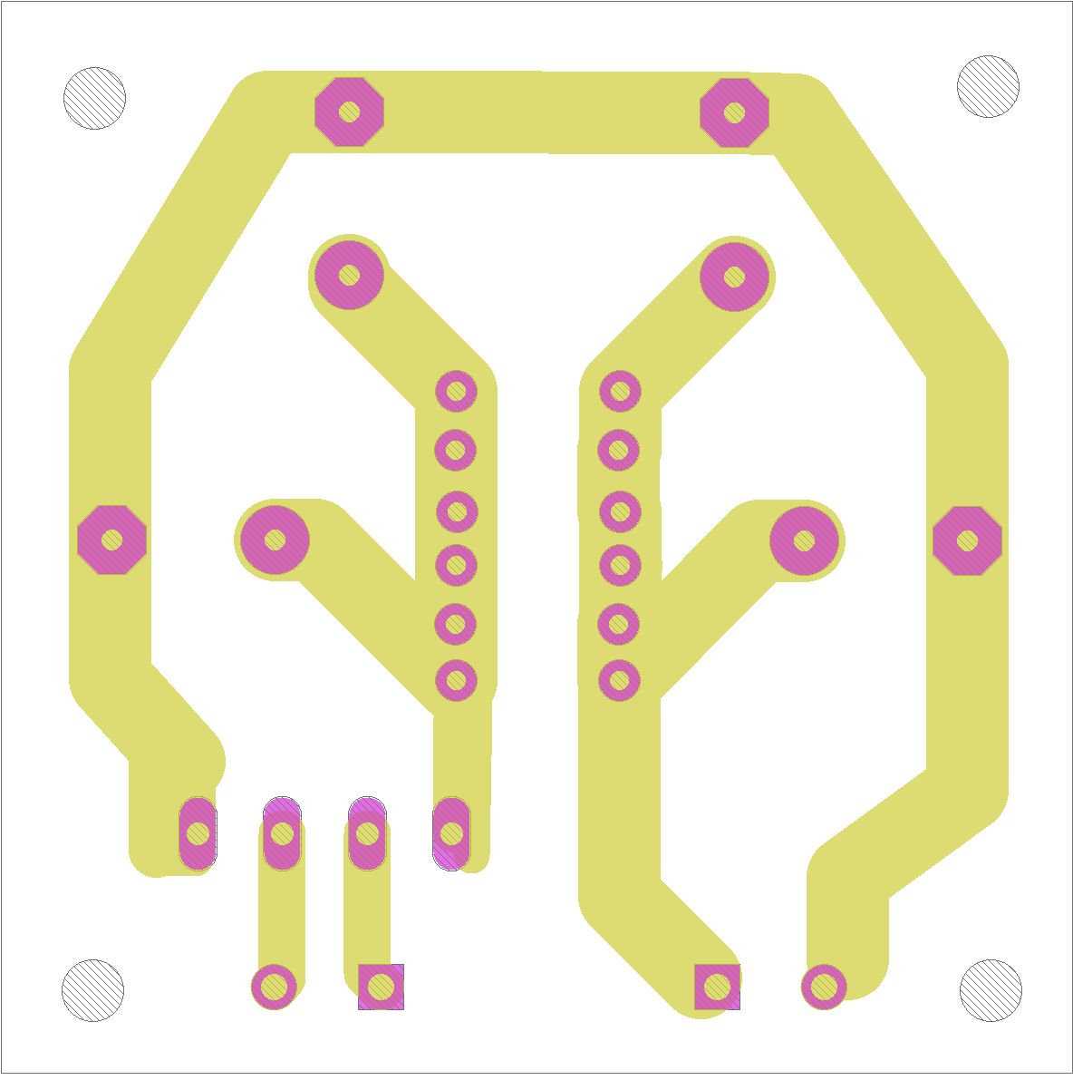

unregulated supply PCB, pi filter, needed before K mulitplier or superregulator, what do you think about layout (some parts are missing, snubers, bleeders ...)?
I tried to keep loops small.
Board is universal one positive or negative rail. Caps are 16mm diameter.
Your layout is not good.
The input to the first smoothing cap shares a link with the output from that first smoothing cap.
The OUTPUT must be on a separate trace from the INPUT to every pin on EVERY capacitor.
Follow the -ve trace, here you have separated the Input from the Output for every -ve pin.

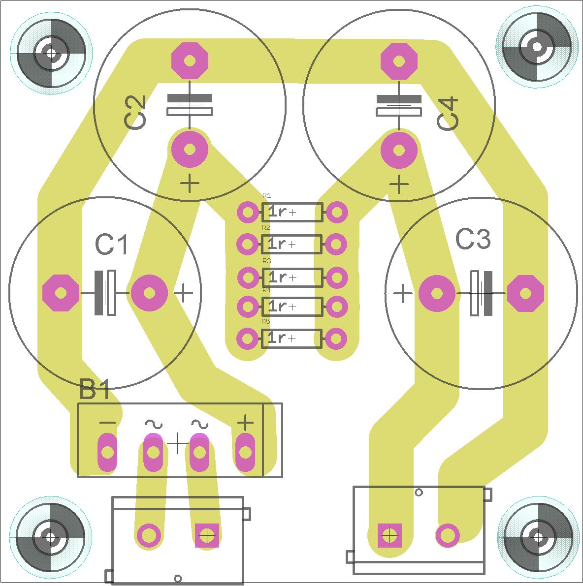

Like this? Top&bottom layers are the same.
Do you have suggestions for some additional components?

YES !!!!
now close up the loop areas.
Or use the two layer board to place one trace above/below the complementary trace.
Make the In/Out pads big enough to suit using ¼" spades that are soldered strongly on both sides of the PCB. Needs 4 extra holes compared to the terminals but preserve the pin pitch so that either spades, or terminals, can be used.
Is there room to add a snubber to the Input?
YES !!!!
1.
2.
3.
1. Can you please better explain 😱
2. ¼" spades, have some pictures?
3. I.ll try to find place, resistor and cap serial at AC? how large footprint for cap?
push the +ve trace close to the -ve trace so that the gap between the two is very small = low loop area.
"faston" are another name for spade (male) and push-on terminal (female)
quite small, try 0.1" and 0.2" pin pitch and make the 0.1" just close enough to allow a 1206 smd cap to be used between the pads.
Due to the capacitor blocking the DC and most of the 50/60Hz, the power dissipation in the resistor is very small. A standard ½W would do. The European 600mW are about the same size as ¼W and fit a 0.4" pin pitch. 0.45" is a nicer fit and saves bending the leads as close to the resistor body. Alternatively the resistor could be stood on end with a 0.1" pin pitch, but many Builders do not like this.
