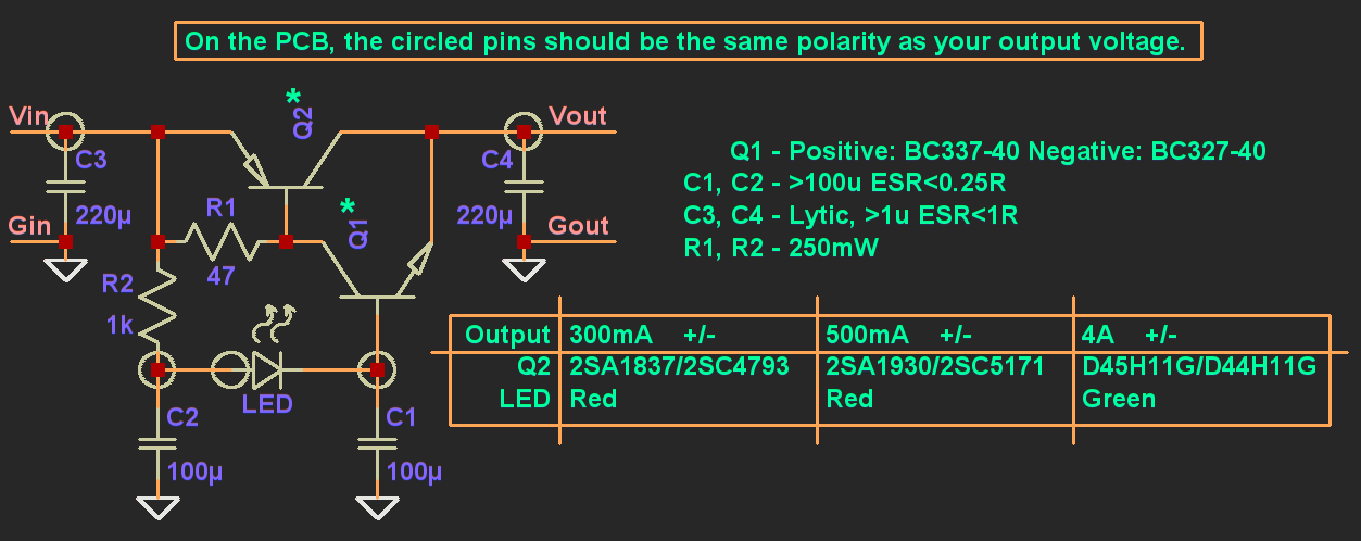

I think the VH10 should be fine. If you can't get the 2SC5171, try the 2SC4793 or D45H11.
Dear keantoken
If I want to built the 21v output 7A
Which BJT can I choose?
thanks alot
If you want to try an untested version, I can give you a schematic. There is no tested version for that much current. It would need 6 transistors, half BC337-40 and half D45H11G.

I got my PCBs today. Thank you. I see no space for any diodes. And also little curiosity about C2 and C4.
Can you please update us with latest schematics for that PCB?

Mine appear to be the same as schematic minus the diodes. He told me they don't do anything even though they were meant to be protection.
Dear Sir,
I find that the 2SC5171 is NPN but you suggest to me is the PNP
Can you suggest the NPN to me.
Is it D44H11G?

Thank you a lot for schematics with all these details. Is any benefit to add 10uF film cap (Wima) to Ele caps and if "yes or probably yes" then to which one?

A 10uF film cap would not hurt anything if you want to add one. I like the fat 5mm Wima 50V 10uF.
I have these in my home stock. Limited to 50VDC but nice small size.. What position Ele cap will be more thirsty with that decap? Input and output? Or all?

It would probably do the most good filtering at the input. It probably wouldn't help C1 and C2.
