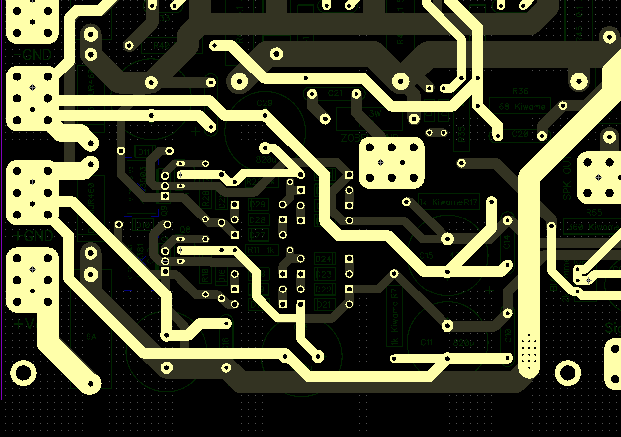

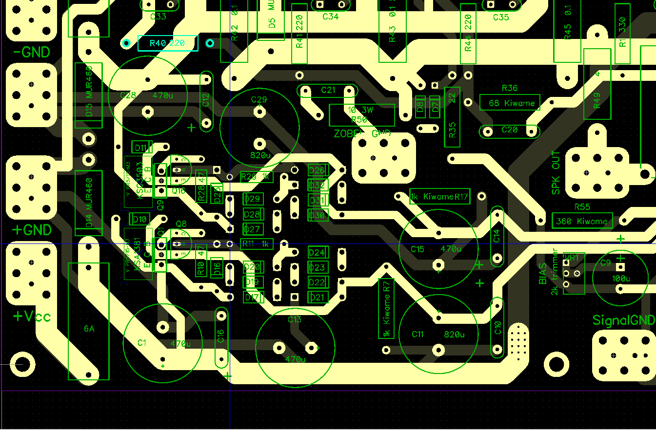

Keantoken's CFP cap multiplier
The Ks are readily available and the 2SA not.
I must decide before ordering the boards because pinouts are reversed.
Also, would you please take a look at the layout.... there are a lot of diodes and I am wondering if it could oscilate.

C29's ground is polluted by C28. C29 ground can be any point before C15 ground, the closer the better. But if C29 ground is after C15 ground, oscillation is much more likely.
The decoupling caps next to your lytics should be around 2.2uF or larger not to reasonate. 5mm caps up to 10uF are available.
It is just my suggestion to prevent the film caps from resonating with the lytics. It has nothing to do with oscillation. No regulator can prevent this. But if you have found some kind of decoupling that you prefer by experience, you don't necessarily need me to justify it.
