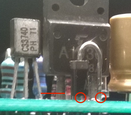

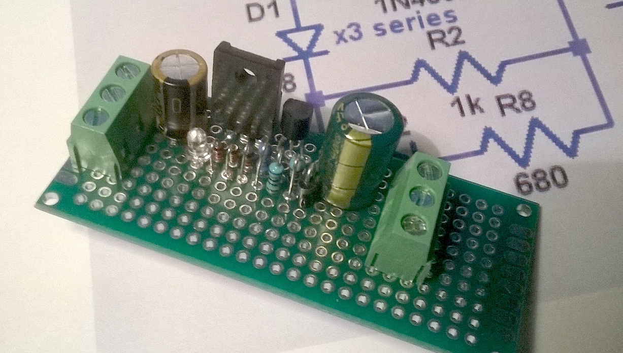

I get the blink but no output... the 1930, looking from front with text, feet down, form left -> is E B C?
Liiittle hard to understand the spec sheet.
Ahhrg - I think it is OK actually - thanks!
So the diode is connected to the 1930 legs rigth behind (red rings). The 337 is connected to the 1930 as the red line. OK?
The OnSemi BC337 is CBE. In the KM the 337 collector goes to the 1930 base. I don't know if the pinout for your BC337 might be different.
I would think not, but I've learned not to make assumptions. It looks the same though:
http://www.jameco.com/Jameco/Products/ProdDS/254810PHILIPS.pdf
