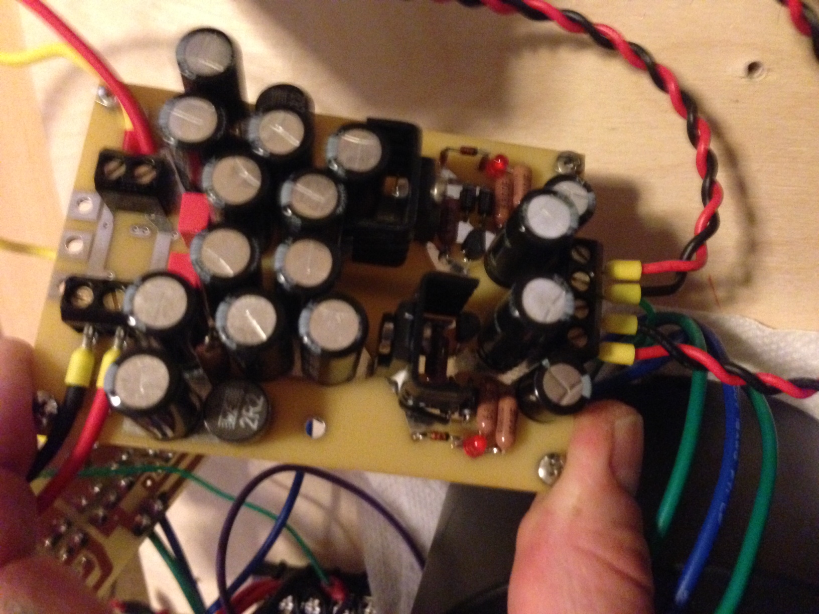

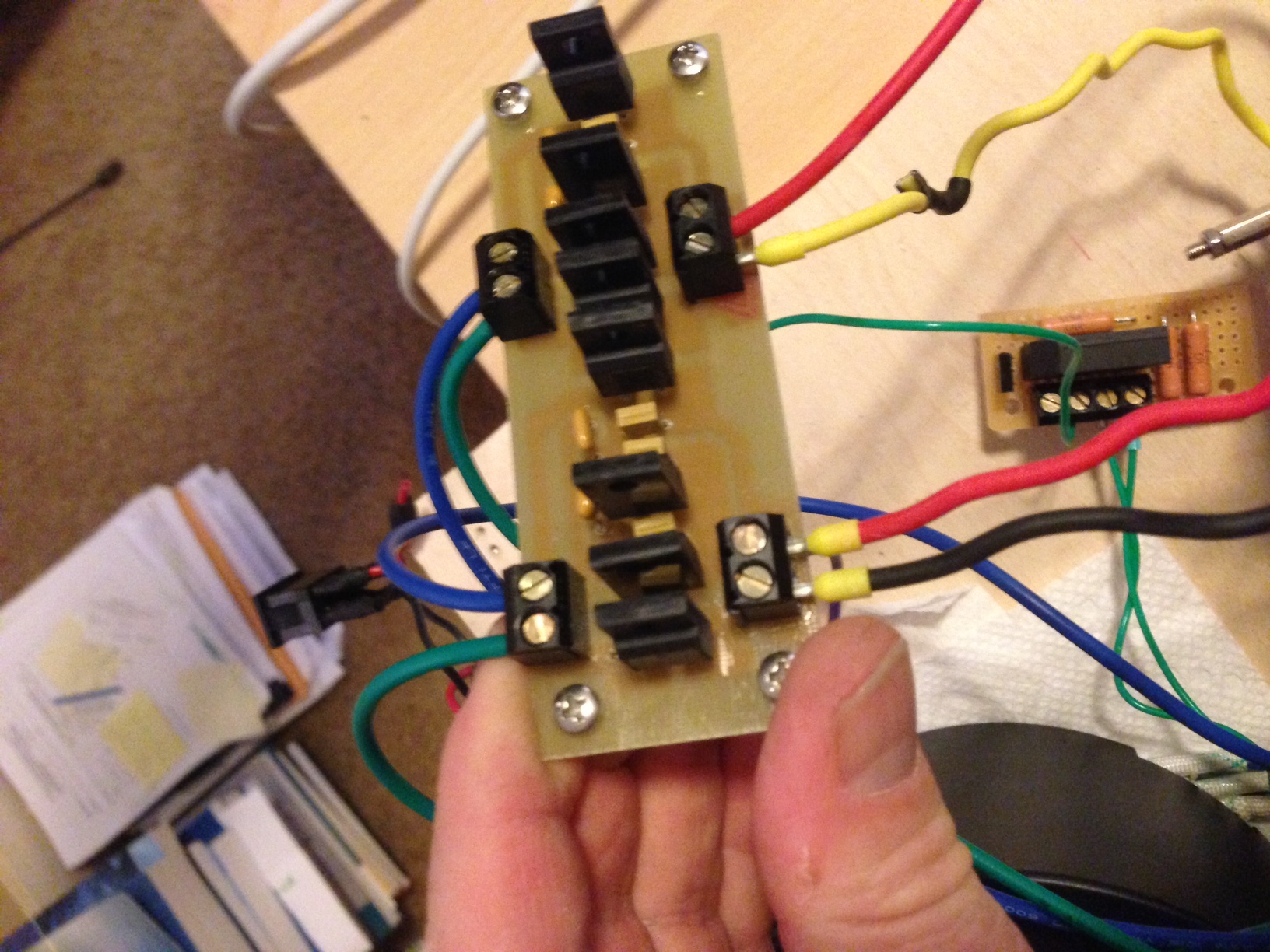

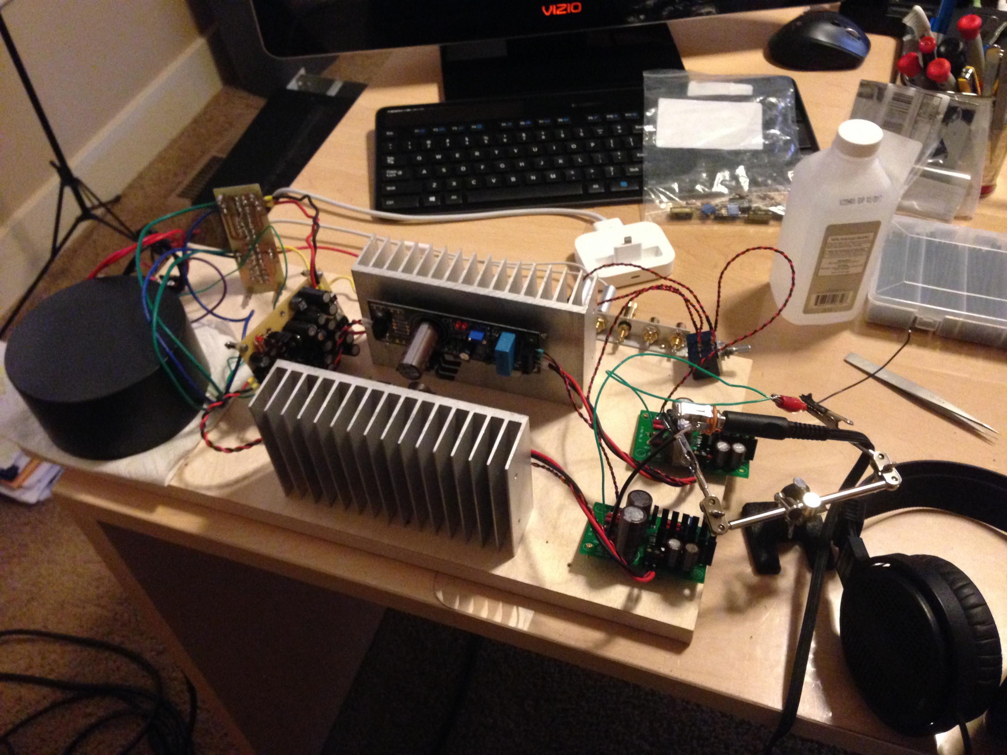

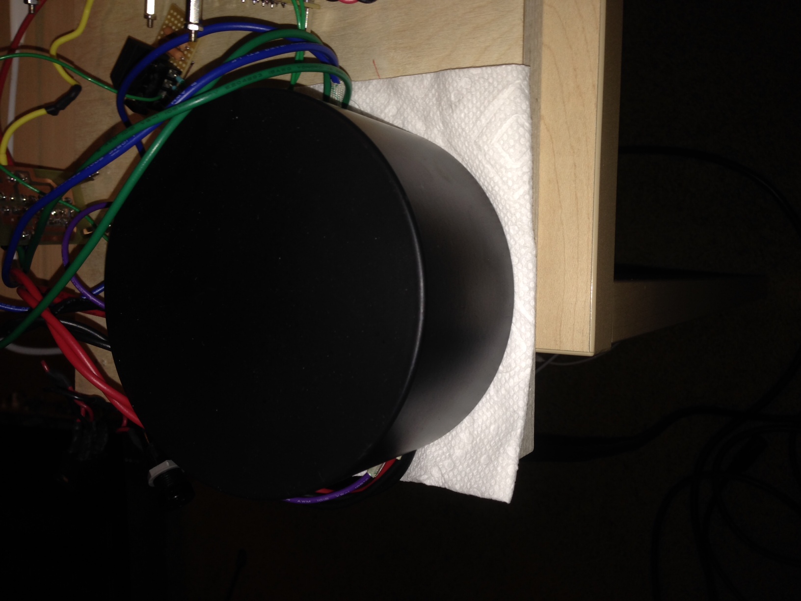

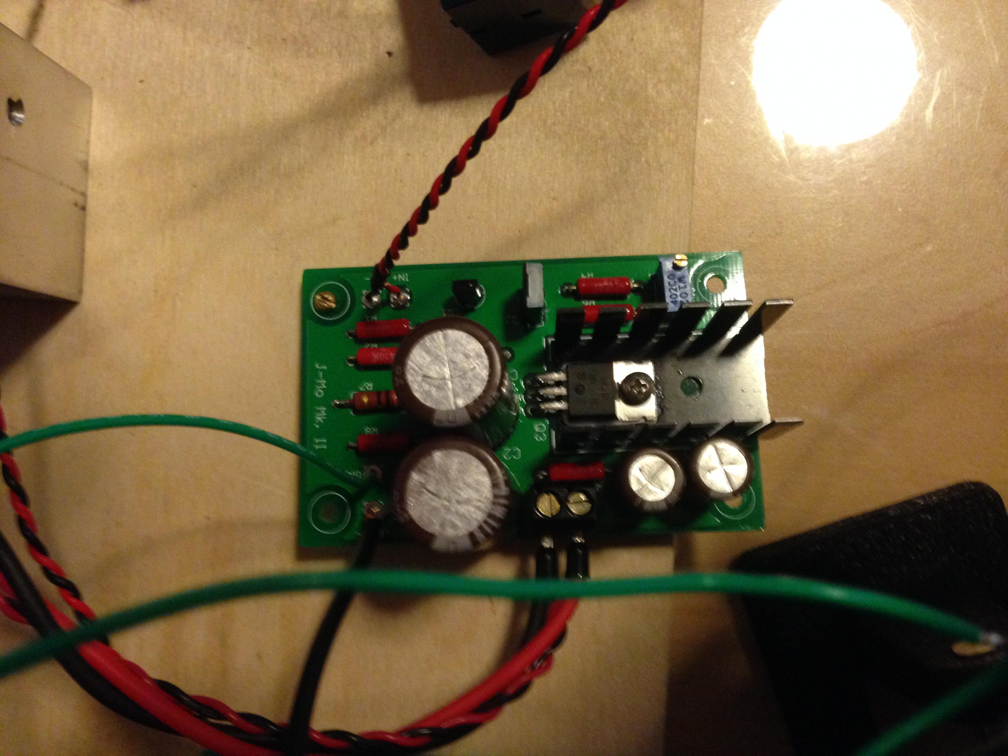

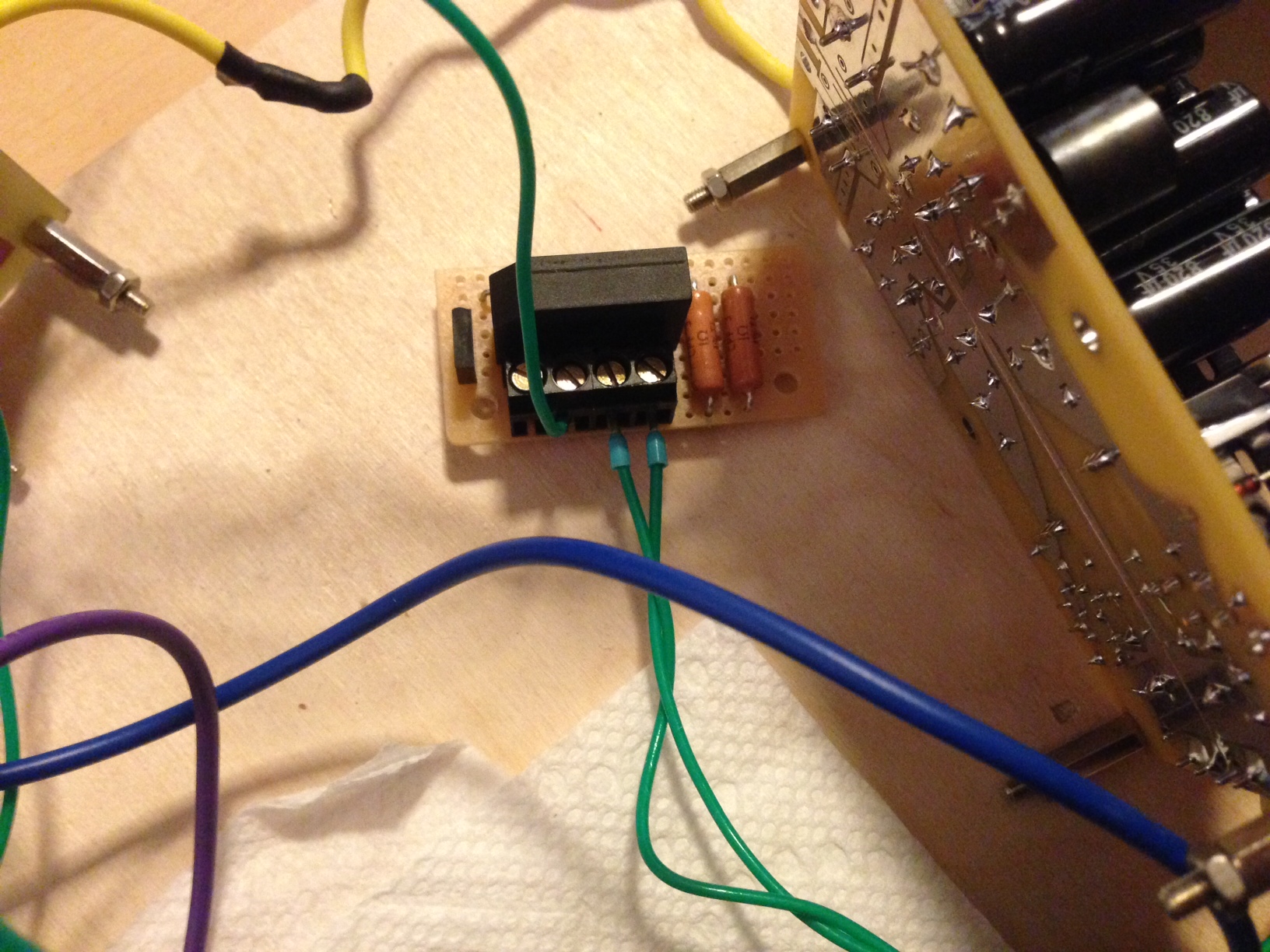

As i stated earlier, i replaced the BC337 this morning. Now both channels measure the same with the exception of the imbalance on one channel. It is small enought that I am proceeding. There is less than 1mV of ripple, so I am assuming all is well in the land of Oz.
I use another KM board for my J-Mo Mk II headphone amplifier.
Excellent results!
About 2V drop and it is feeding Salas BIB. Very clean power!

Sounds good then Buzz, it looks like you are getting the benefits of the Kmultiplier even with the strange result. I would measure ripple again while under load to check if output impedance is okay.
Looks good Alex, I'm glad you like the result.

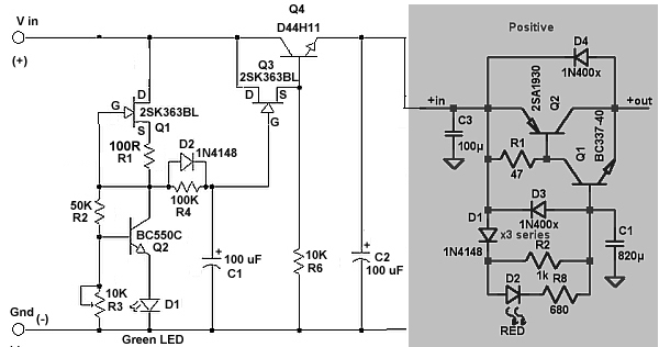

Your schematic will work. There should be at least one lytic near the output of the KM.
I don't know why you would use a 10R+10nF snubber after the KM, there will be no benefit.
Increase R2 only if you want to trim output slightly.
Chip regulators have very large output inductance which will resonate with electrolytics at their output. Some people say this results in bad sound. So it would make sense to try a KM after a chipreg to see if it is an improvement.

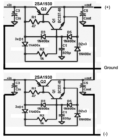

Dear Kean,
I just to make sure if 10R+10nF snubber needed, since you are not recommended so I not use it.
May I series R2 (1K) with trimmer 2K.
Last quotestion.
I would like to build two positive regulator instead of positive regulator and negative regulator.
It is OK for KM with two positive regulator as per schematic below.
