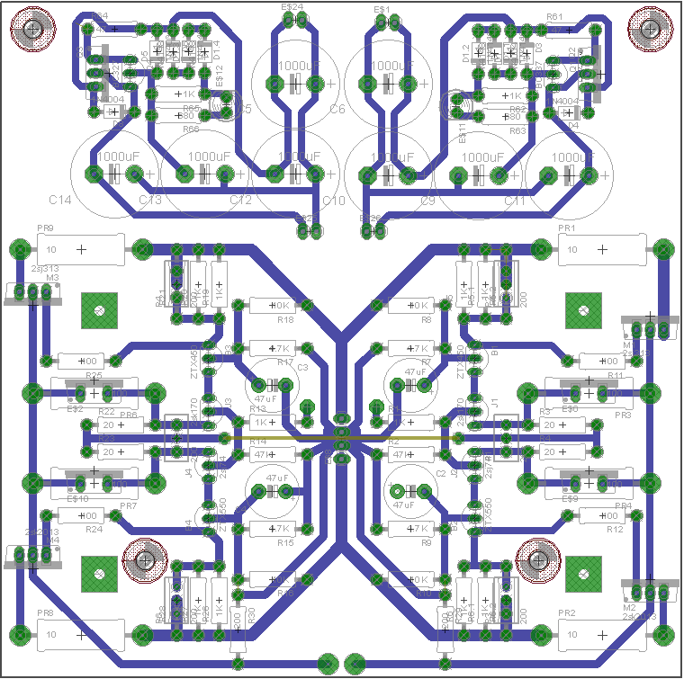

Could someone put eyes on this layout abd see if you spot a problem. I started to solder in the wires from the prereg and the little amount of juice left in the caps exposed what appears to be a short. I cannot find it on the board or the layout, but perhaps I am looking to hard.
Filling up 2000uF might be enough to make a spark, depending on the voltage. Can you measure a short with the ohm meter?
The output caps do not fill immediately when you apply power. They ramp up too slowly to cause a spark. I don't think the spark in itself would indicate a short.
Maybe something got hidden under the caps when soldering and is causing a short? I had that problem when I got a board wet. The water caused a bridge to form through electrolysis.
Coldnt find anything, so ifired it p with reckless abandon. All seems fine, although i would have thought the LED would stay on. It lights up that turns off.

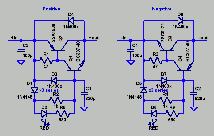

Interesting problem popped up. Not sure how to figure what needs replacing. My positive rail has dropped about 5V. It is the same whether it is loaded or unloaded. The input voltage is correct. Which element have I lost. I will begin probing in anticipation.
For some reason it seems too much current is being drawn through R2. This could be Q2 going open, Q1 damaged through reverse discharge, R1 shorted, C1 becoming leaky, in rough order of probability.
Is there any load? The voltages won't be right if it's not loaded during testing. Can you measure the voltage across all transistor junctions and post?
