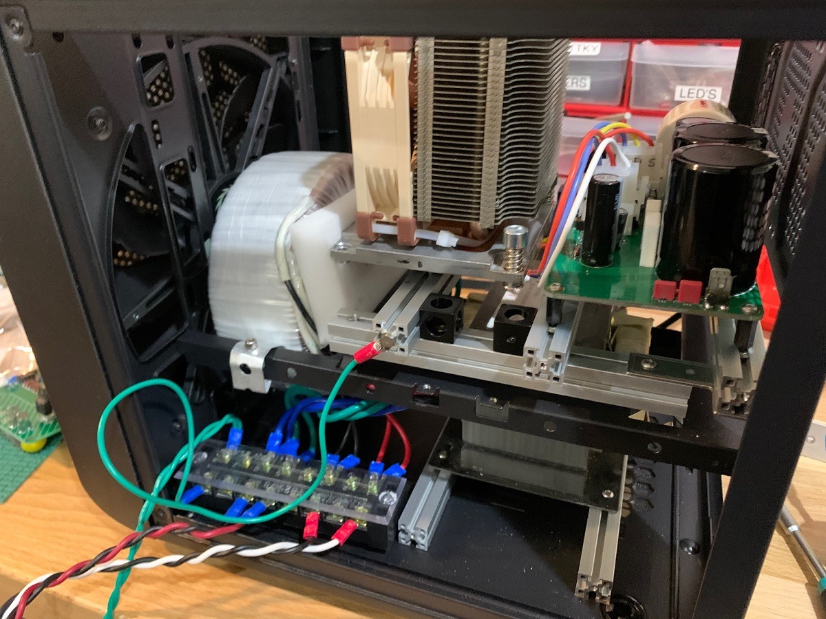

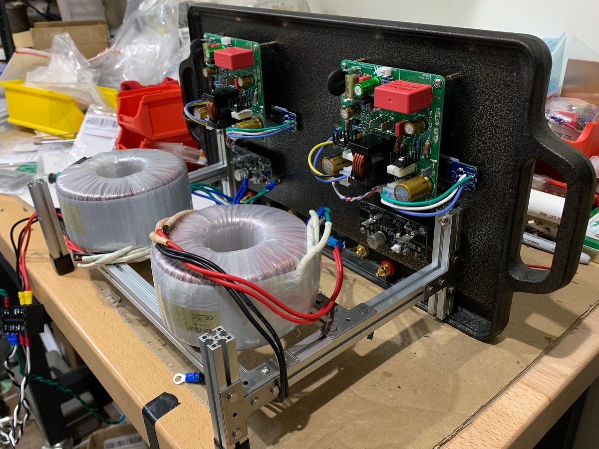

I am extremely curious / interested in this (thread, topic, schematic) amp prospect. I have working 57, 63, 70, 82, 90 volt transformers / power supplies built. Could? consider including this marvelous circuit. I am only building mono amp chassis(s), to maintain greater flexibility.
~ I LOVE THIS circuit, and prior iterations.. concepts ~
I have several amplifier cores already built, these amplifiers frames will work, are oriented, in ways I could easily build / include multiple amp modules, in one chassis for testing. I have been comparing (A - B'ing) MOS-FET, to BJT, and plan to include, already have on hand, Hypex NC400HRX, ICE "500" modules.
While I would have to budget for it... I would love to consider prospect of including the Aurum-x.
I do have several (an unused / matched) set(s) of Exicons, both singles and duals.

Example of concept. I had to actually build it, to model idea(s)
and see if I like it... as a variation of several prior builds...

Fantastic chassis work Ozark HiFi!! I have many projects going that would work perfectly in them, Hehehe!
Fantastic stuff Ozark! Vunce and I have been using Makerbeam T rails on our builds a lot too.
But I have never made an entire frame with all edges from the rails. Your plans look great.

Thank you! I appreciate the comment. Like what you are doing...Fantastic chassis work Ozark HiFi!! I have many projects going that would work perfectly in them, Hehehe!
Thank you! Your images of your build look fantastic...Fantastic stuff Ozark! Vunce and I have been using Makerbeam T rails on our builds a lot too.

like the PCB / amp layout.
I wanted to build "something like" a beefy lab PS.
An imperative, open architecture for easier idea modeling.
Having multiple surfaces for easy (multiple?) heat-sink mounting
*this model also makes it easy to work on from any angle,
and/or to attach (amp as discrete sections in) circuitry.
