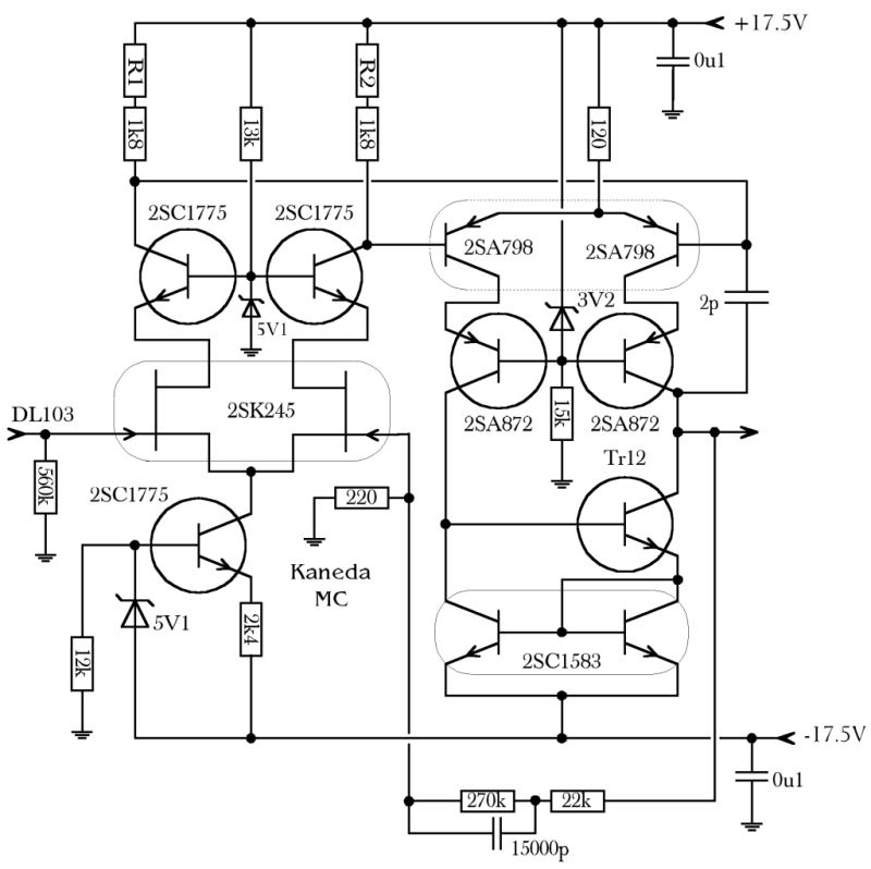

Having no idea of what design L'Audiophile chose to publish and promote as "Kaneda's Preamp #1", I felt that it would be instructive to show the real amplifier schematics for the original Kaneda Preamp #1, pretty much as they were first seen in Musen to Jikken nearly 30 years ago.
The attached file is close to the original drawings in most particulars, but deletes various non-essential features like a channel balance and variable bass-boost.
The accompanying positive and negative voltage regulators are of the series-type, with uPC55A (NEC?) opamps as the error amplifiers. Also note the use of asymmetric power supply rails.
This design almost certainly _cannot_ be built as shown, because
both the 2SA493 and 2SC1000 are long-extinct. It should therefore be regarded as being primarily of historical value, but also reflects a desire on my part to keep the records straight.
regards, jonathan carr
