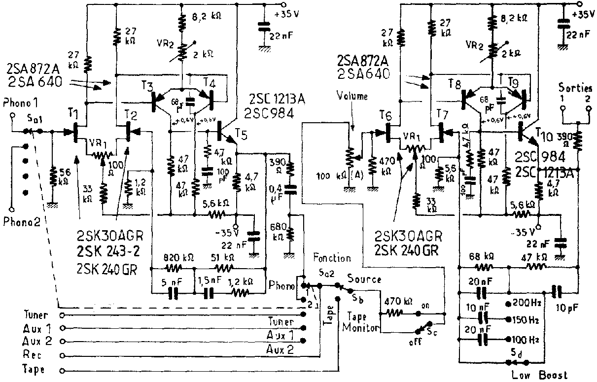

Having no idea of what design L'Audiophile chose to publish and promote as "Kaneda's Preamp #1", I felt that it would be instructive to show the real amplifier schematics for the original Kaneda Preamp #1, pretty much as they were first seen in Musen to Jikken nearly 30 years ago.

This is the one I built, but could not balance the line stage built with discretes instead of monolith Qs. I have been thinking of using the 2SK30 also in the line stage, as I still have a few extra... don't know if it's worth the effort ,though....???

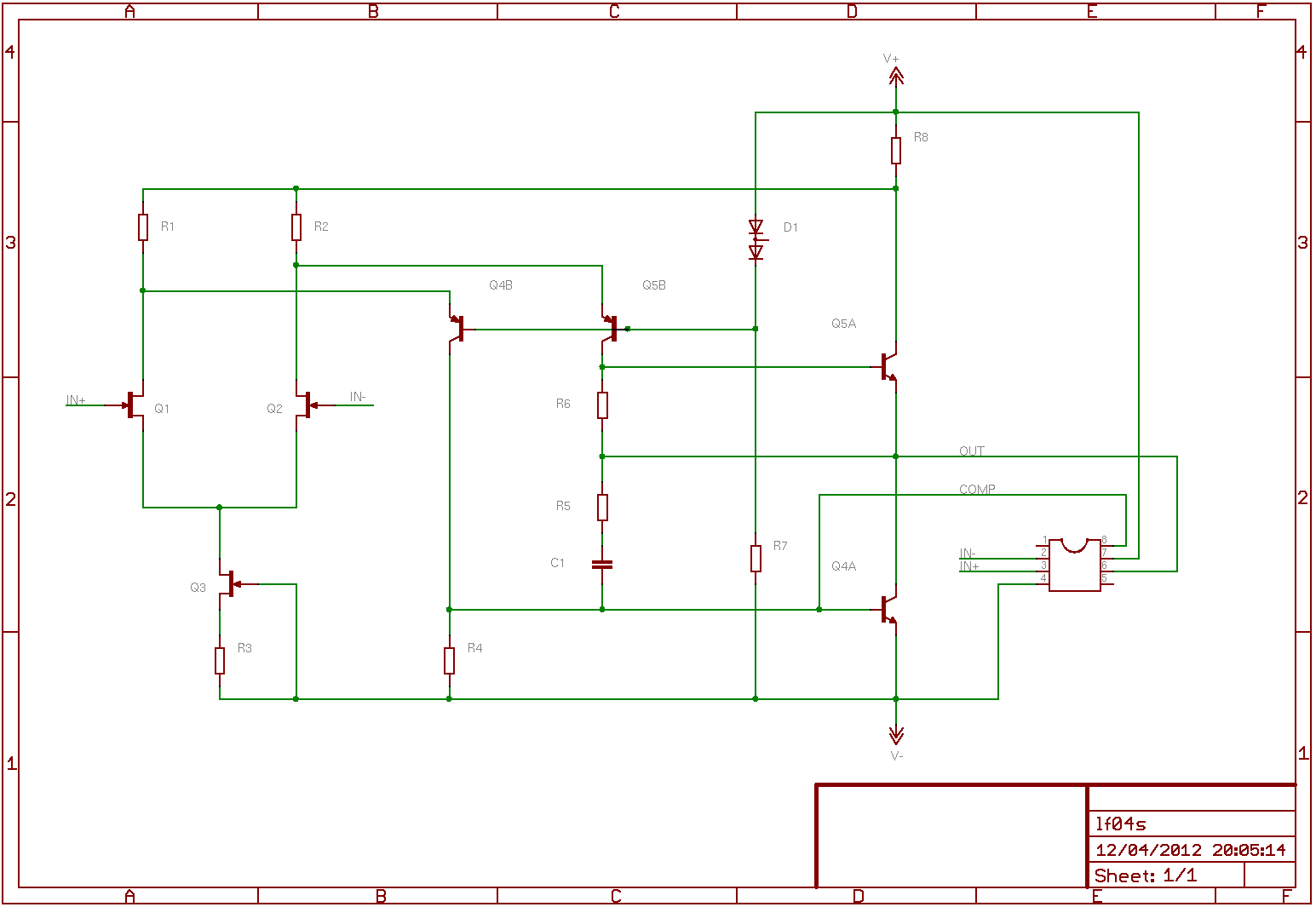

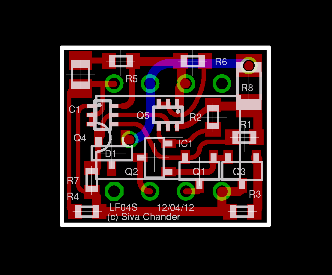

Here's the schematic and layout of a folded Kaneda-style discrete opamp, with currently-available SMD parts. The board is about 12.5mm x 15mm, slightly larger than a stock DIP8 single opamp.
The preliminary parts list (subject to change):
Q1, Q2, Q3: 2sk209
Q4, Q5: BC847BPN dual NPN/PNP
R1, R2: 150R
R3: 470R
R4, R6: 2K
R5: 150R
R7: 33K
R8: 30R
C1: 15pF
D1: BAV99

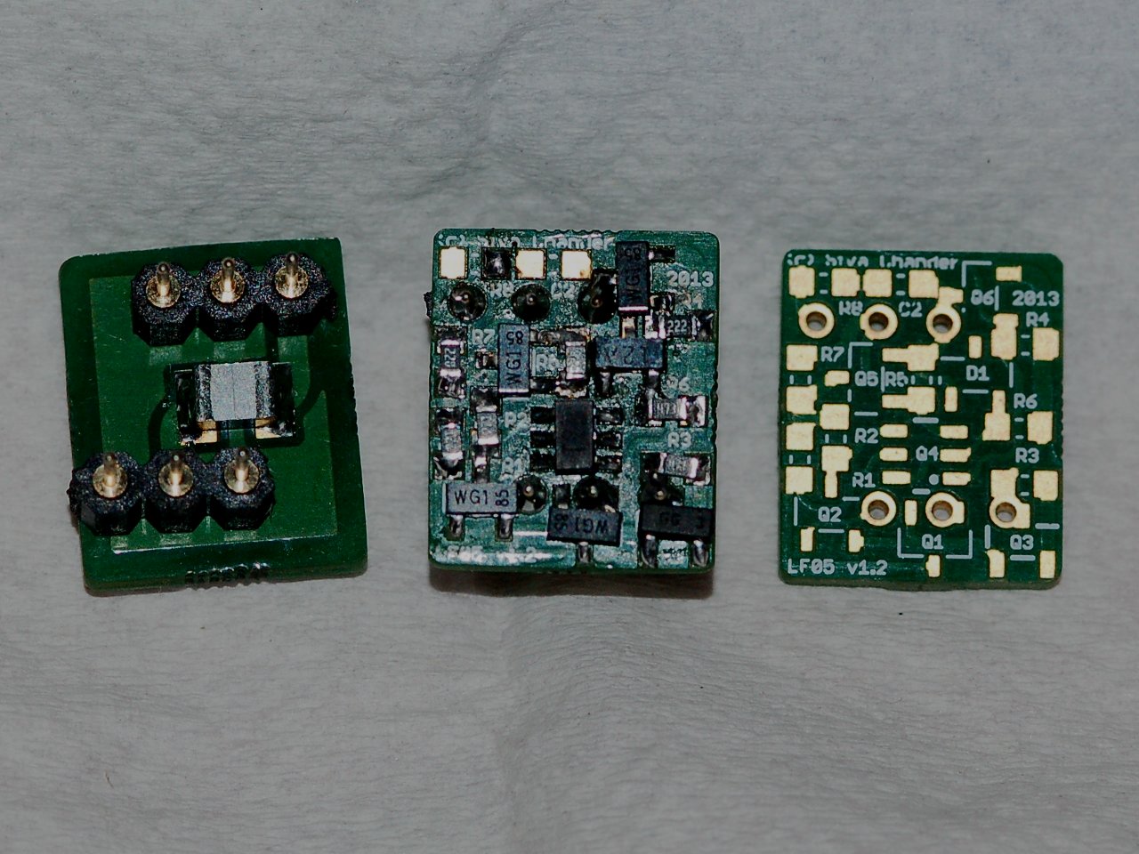

Here's a pic of the first prototype of a folded Kaneda-style Class-A opamp in DIP8, all-SMD components. It uses the same topology as the schematic in post #107, but the LTP is a BJT pair like the BC850c or MMBT4403. The board area has been reduced to about 11mm x 14mm by removing unused pins 1 and 5. A rail-to-rail bypass capacitor in 1210 size is installed on the lower layer.
The first prototype is a proof-of-concept test unit which works fine as is, but changes may happen to the values of actives/passives after experimentation.
The two unpopulated SMD locations at the top left are the Miller compensation network from the output to the compensation node, which is also brought out to pin 8, so it can be externally-compensated - for instance, when used as the opamp module in a Mauro Penasa MyRef power amplifier in place of the default LM318.

Having Q3, Q4 and D1 and the compensation does not qualify it as Kaneda in my opinion.
I would be interested if you try a second experiment with the stuffing of the schema with a resistor long tail.
It's a folded-Kaneda variant, not the original Kaneda with a differential VAS. It's possible to omit Q3 and jumper its source to drain with a zero-ohm resistor, and I'll try that later. However, the THD20 was a bit high in the sim with a pure resistive current source.
However, you're correct - the sonics of the resistive LTP are better than the one with a high-Z CCS, because of the tanh-character of the resistive LTP. That's one of the strengths of the Melcor 1731 discrete opamp - that's broadly a Kaneda with an additional Class-AB output stage.

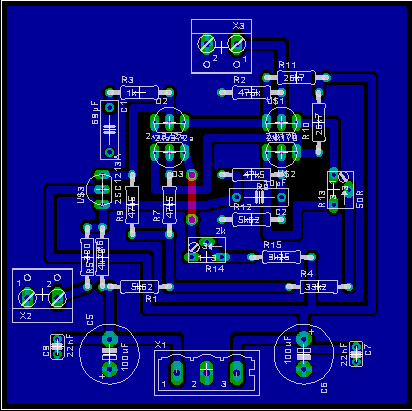

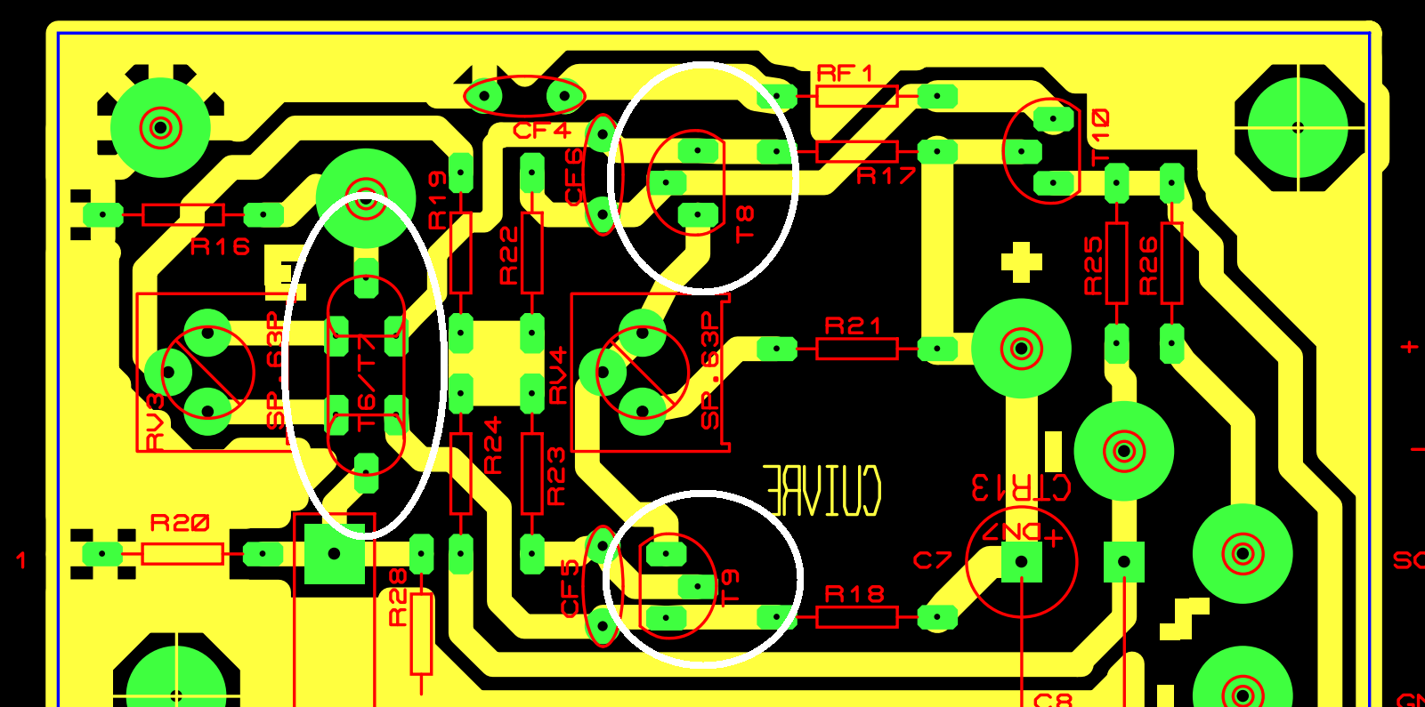

Hello.I am going to build the Kaneda line preamp as shown here in the schematic i attach but i have some questions.
1)Does T6 have to be in thermal contact with T7 and T8 with T9?
2)Any guide about adjusting the two trimmers VR1 and VR2? VR2 is used so as to have 0.6V at T8 and T9 collectors and about zero offset at output?What about VR1?

Answer to no.1 in attached pic.
From Kanéda

I built this preamp.
If you want a regular preamp you only need to use half of it. If you want a preamp with a phono preamp that when you use the whole circuit you posted.
I used for a thermal couple T6 to T7, T8 to T9. I did not build the phono preamp. I used to have the layout, I did some search so I can share it with you I did not found. I built my long time ago at least 13 years ago. I found all the info from a French website.
It is a good preamp but you will have to take your time to select the right components after your taste.

I have no experience with this particular implementation, but it's a very standard topology, so:
1) Yes, it helps a little with the DC offset drift at the output.
2) VR1 is used to adjust the balance of the differential pair in the 1st stage; it has effect on the offset, and also even order distortion. VR2 is to set the standing current for the 2nd stage; it too affect the offset, so the adjustment procedure is interative. I'd suggest VR2 first, then VR1, then back to VR2, and so on.
