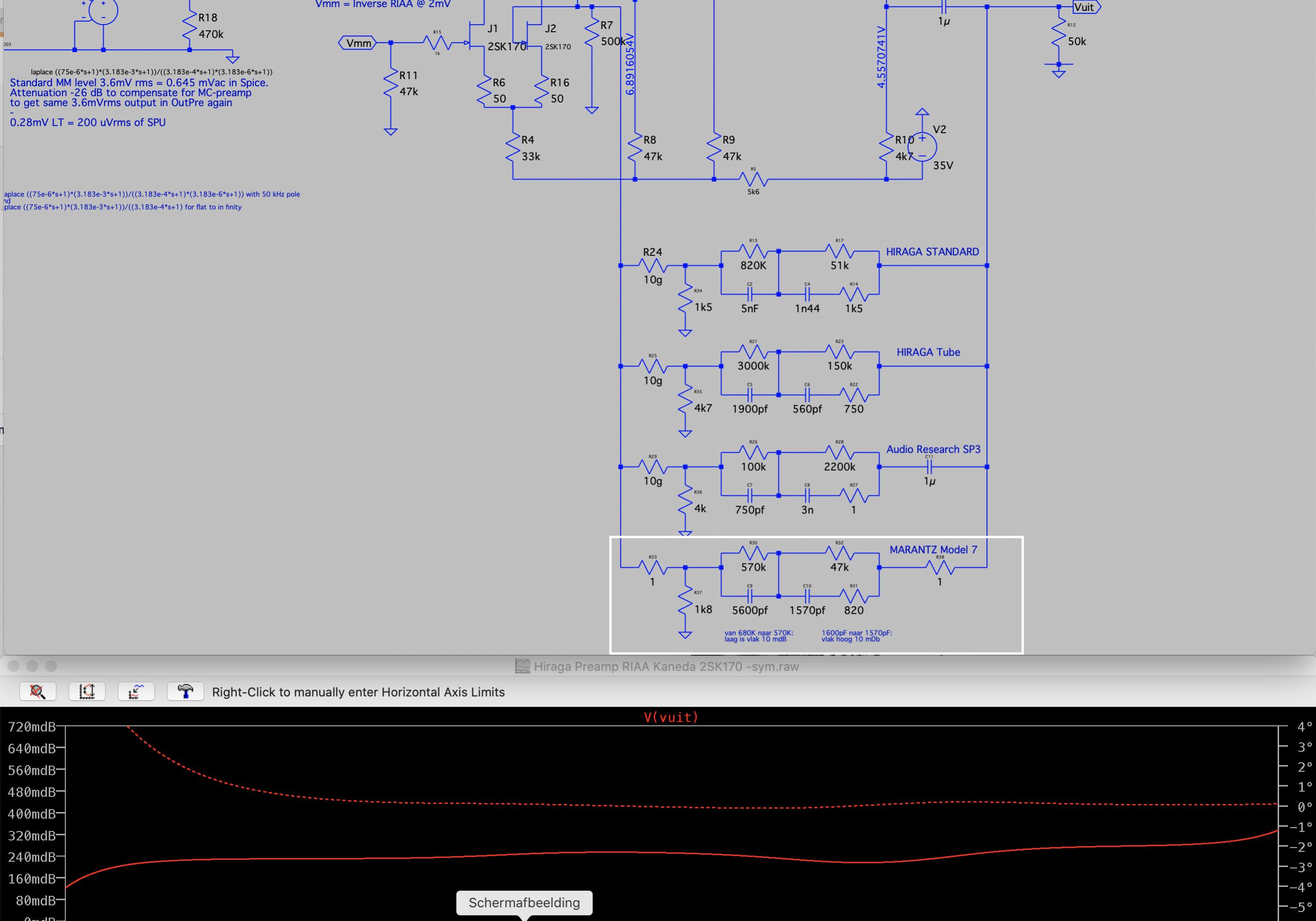

kaneda preamp
Did some sims on the Marantz 7
With a few small live tweaks is is the most flat I have seen for a long time *)
Not bad at all, seems to be an understatement.
*(I must say that H Polak got a version of the EAR even flatter if I remember correc tly).
