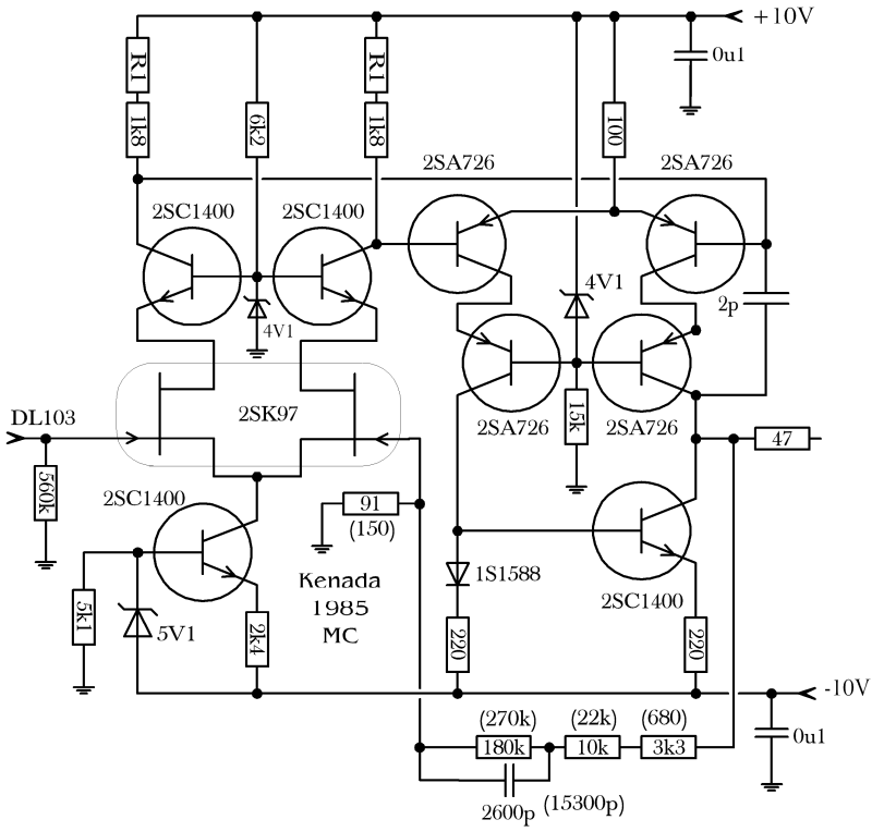

This last one #3 from 1985 RIAA
This last sample, RIAA from 1985,
I think is a very nice amplifier.
Maybe I should try it .... 🙂 😎
It is for MC Moving Coil Pickup,
so I have to modify it. Input Impedance and so.
Anyway, thank you, tvi
I have copied them to my harddisk.
/halo - still some GigaBytes to go .....

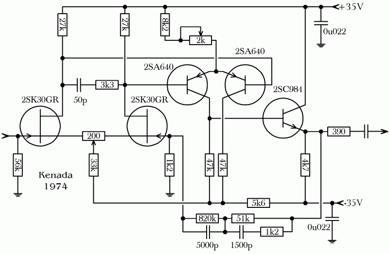

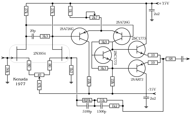

It is interesting to note that none of the three amps have any
decoupling caps except at the rails. There are a number of
places where it migt seem sensible to add a cap, eg. in parallel
with the zener diodes for CCSes and cascodes. Does anybody
know if Kenada was an early anti-capacitor guy or if he just
didn't think it necessary to use more caps?

Christer: Kaneda (not Kenada, BTW) was a stickler for details, and he specified pretty much everything in a circuit that he felt mattered. Semiconductors, circuit boards, capacitors, resistors, batteries, switches, and so on. His favorite resistors were "Skelton" and also the flat-plates by Susumu, while he liked the SE stacked-mica and the V2A, both by Soshin.
I believe that overall he was against electrolytic capacitors, preferring film caps and battery power supplies. It is likely that he was more willing to tolerate the noise of the Zeners than the sound of electrolytic caps.
In recent years, however, you can see that his circuits are clearly designed to be simpler and easier to build. Perhaps Kaneda is becoming more mellow and less picky as he gets older 😉
regards, jonathan carr

Thanks, Jonathan. Yes, I suspected that was the reason, but
it is nice to get facts instead of speculations.
BTW, I had always thought the name was Kaneda, but since it
said Kenada in the schematics, I assumed obvoisly incorrectly,
that this was the correct Spelling.

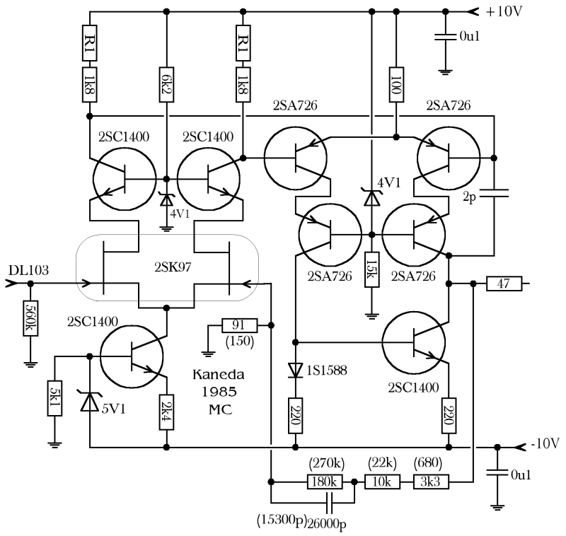

Another error in schematic no.3
besides writing the name Kaneda wrong in schematic no.3, there is another error in the circuit. Have a look at the both alternative active RIAAs EQs. A cap of 1530pF would surely fit better than a 15300pF, wouldn't it ?
regards,
Hartmut
regards,
Hartmut
Re: Another error in schematic no.3
If you raise resistor from 180k to 270k,
you have to lower parallell cap. To keep the RxC at same value.
From 2600p to 1530p.
(Or should it be from 26000p to 15300p, in that case it is 2600p that is wrong)

Yes, something is wrong.hifidaddy said:besides writing the name Kaneda wrong in schematic no.3, there is another error in the circuit. Have a look at the both alternative active RIAAs EQs. A cap of 1530pF would surely fit better than a 15300pF, wouldn't it ?
regards,
Hartmut
halo
Ooops
Fixed it here
