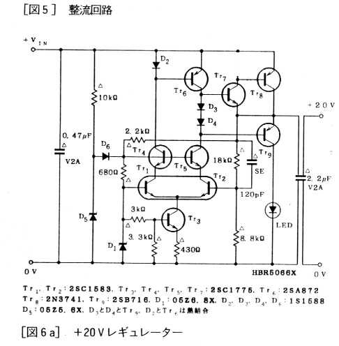

Kaneda 1995 preamp, power supply schematic, negative rail
OK, no further comment necessary ...

This Kaneda 1995 preamp looks AMAZINGLY similar topologically to the Leach JFET preamp from the late 70's (look at this pdf, starting page 9 ) I built the RIAA stage many years ago and was very pleased with the sound, even using the lowly 2N5457 NJFets!

Regarding the Kaneda amplifier circuits, there was another design generation where the active RIAA was driven directly from the collector of the second-stage sans follower. However, a summing current mirror was present under the second-stage differential.
Here (the circuit that Hartmut posted) it looks like Kaneda is trading some measure of simplicity and ease of construction for performance. No cascoding for the input JFET pair, and no attempt to stabilize the current sources feeding the second-stage differential (which has higher gain than the first differential).

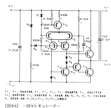

Late Kaneda power amp regulated supply corrected
just got an email from a guy who blew up his regulation built after that schematic, and so I post here a correction.
regards,
Hartmut
