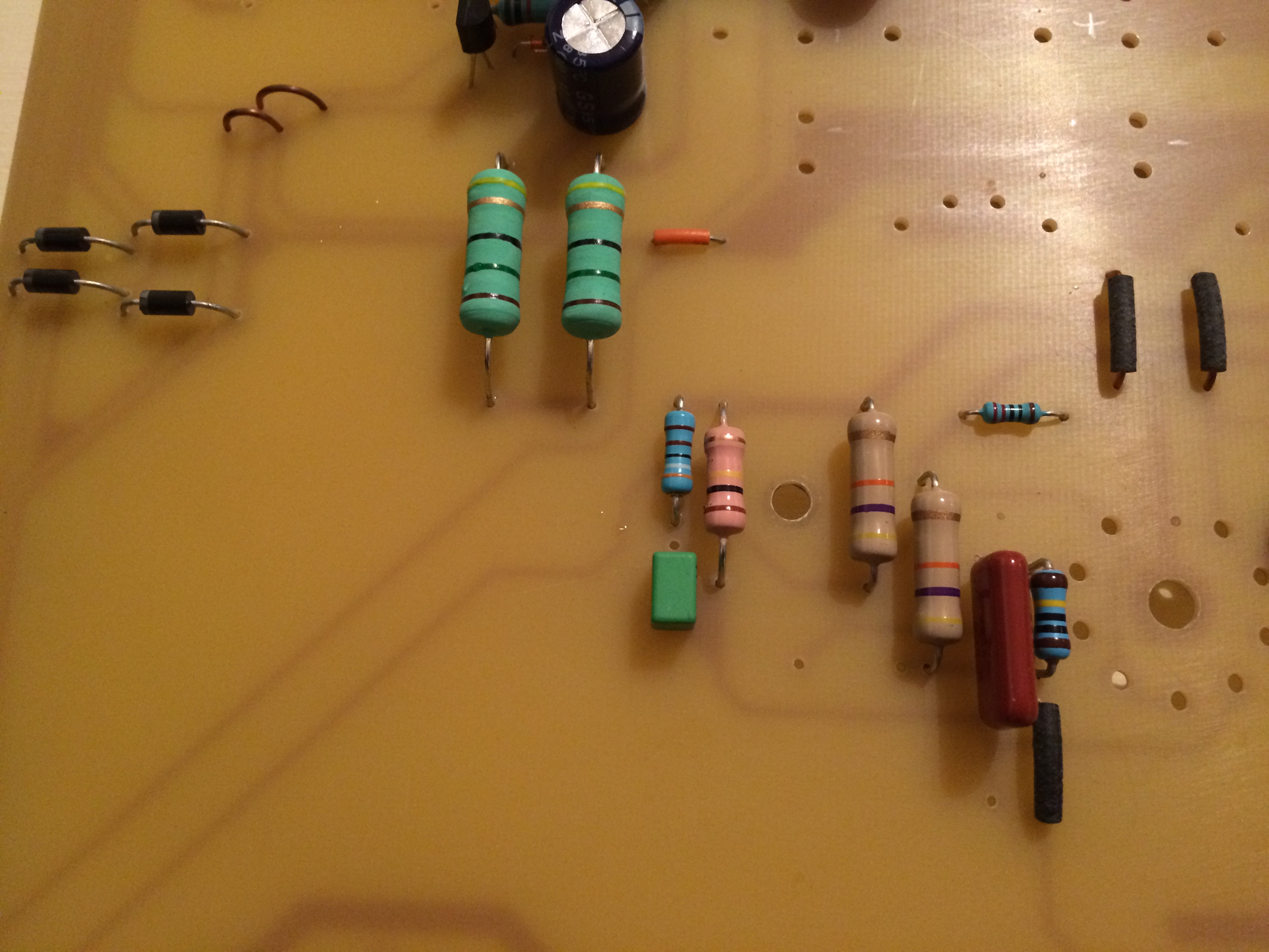

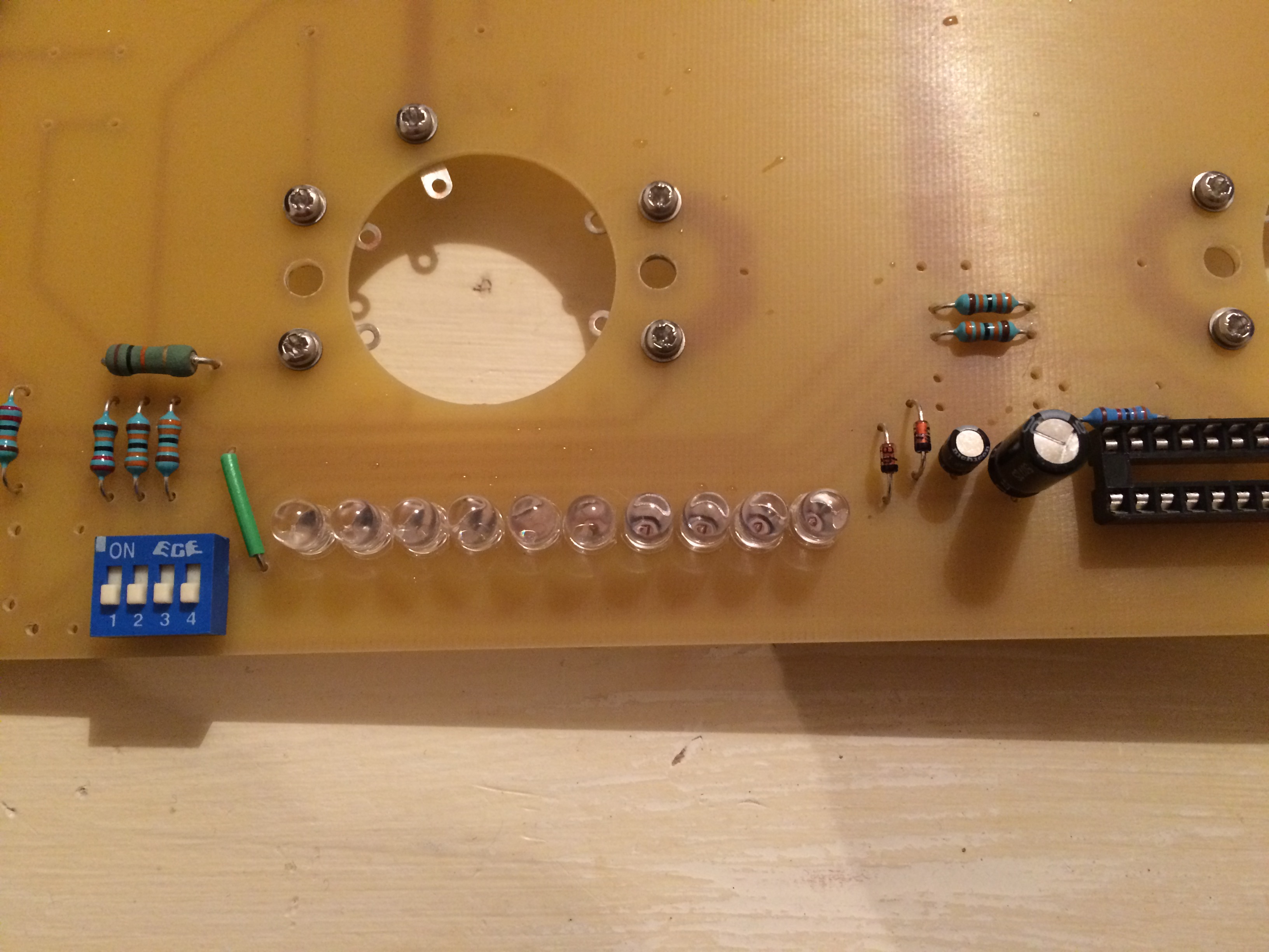

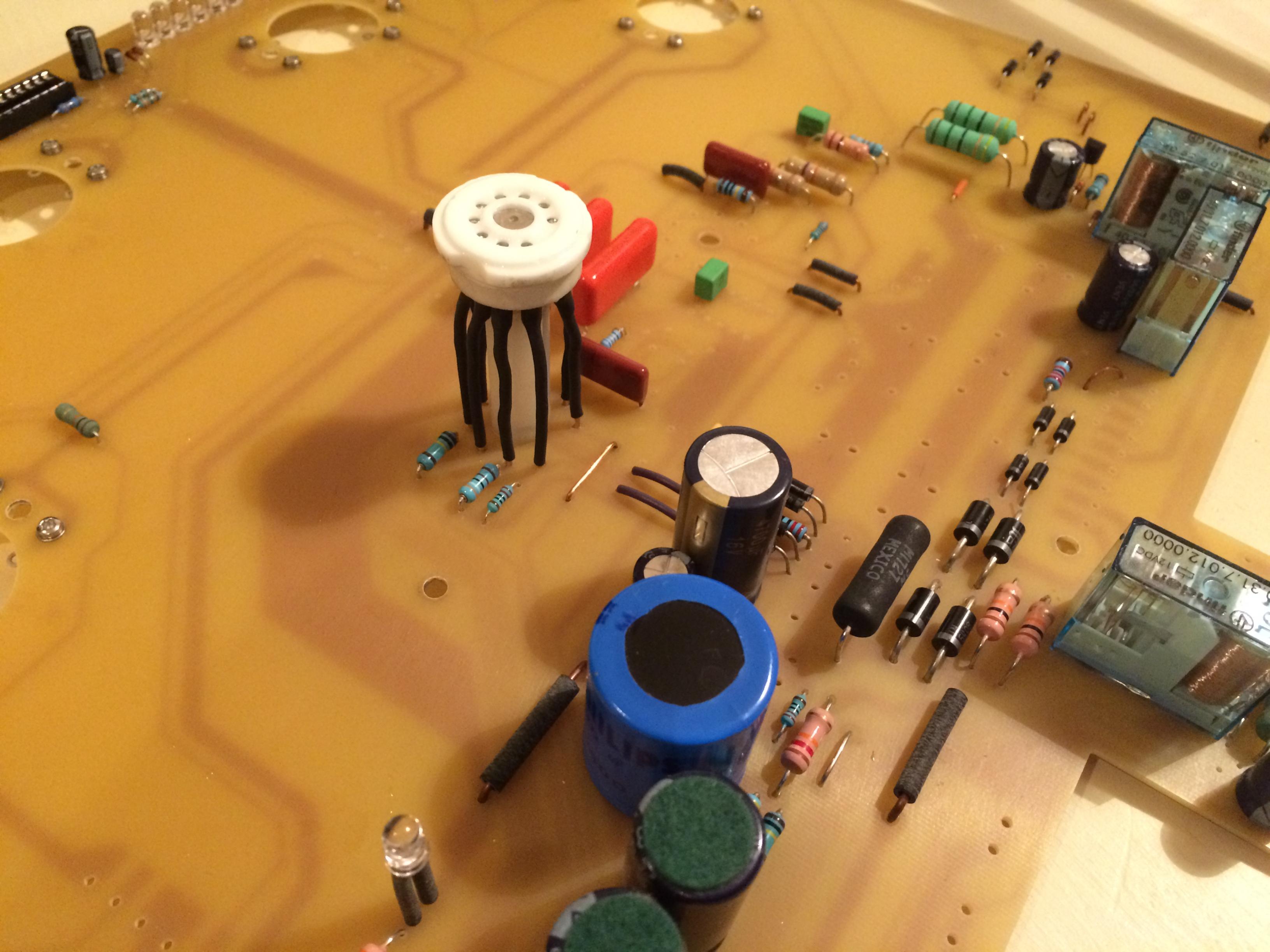

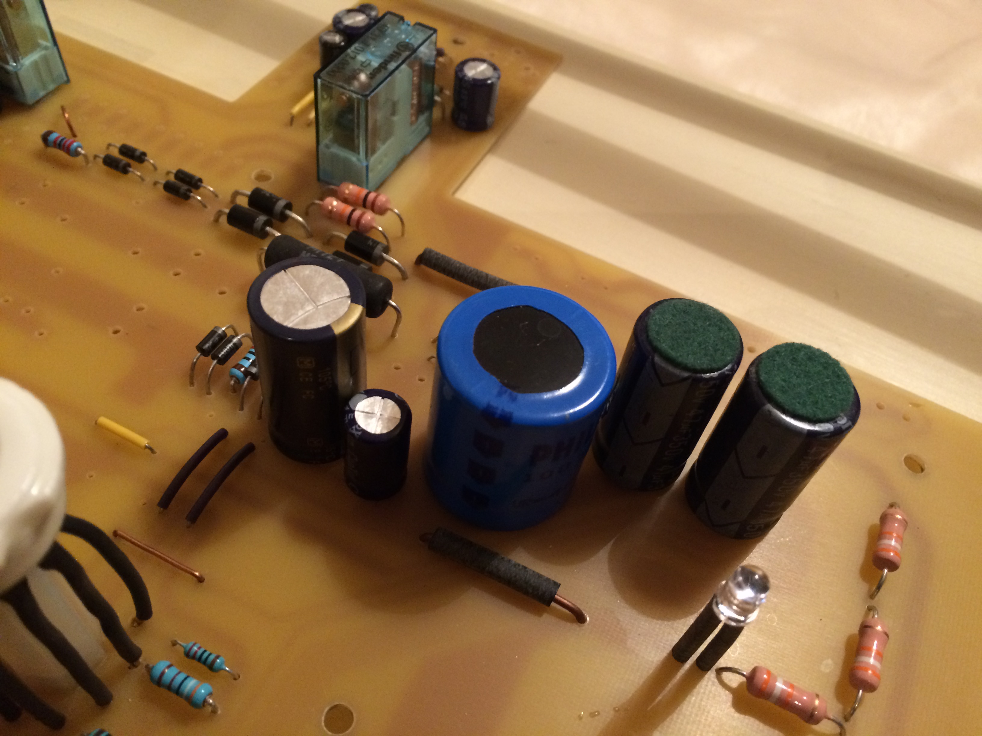

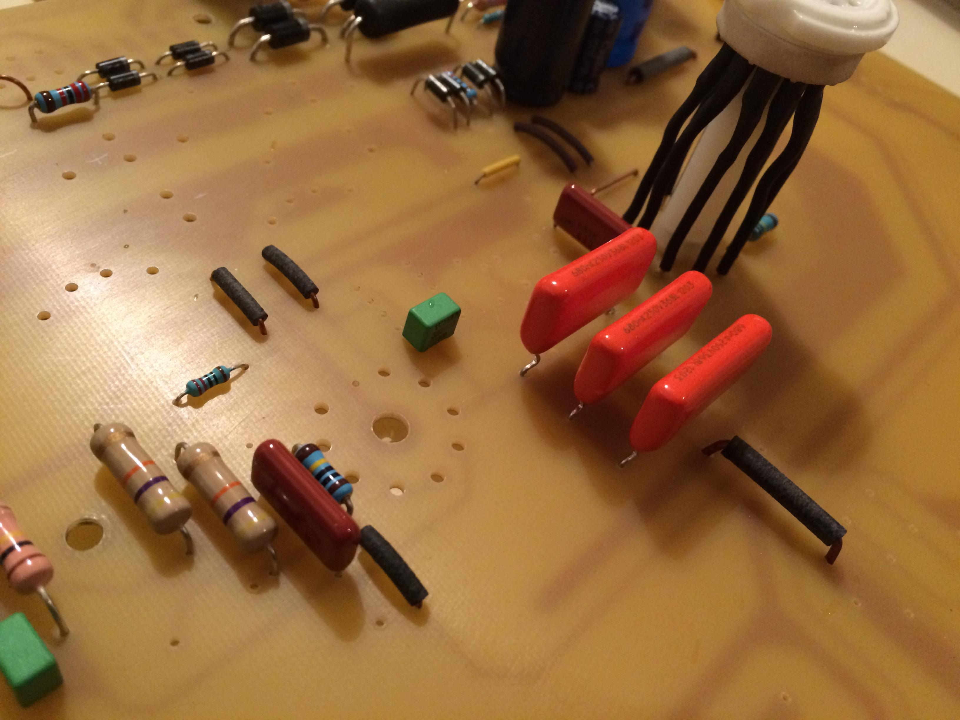

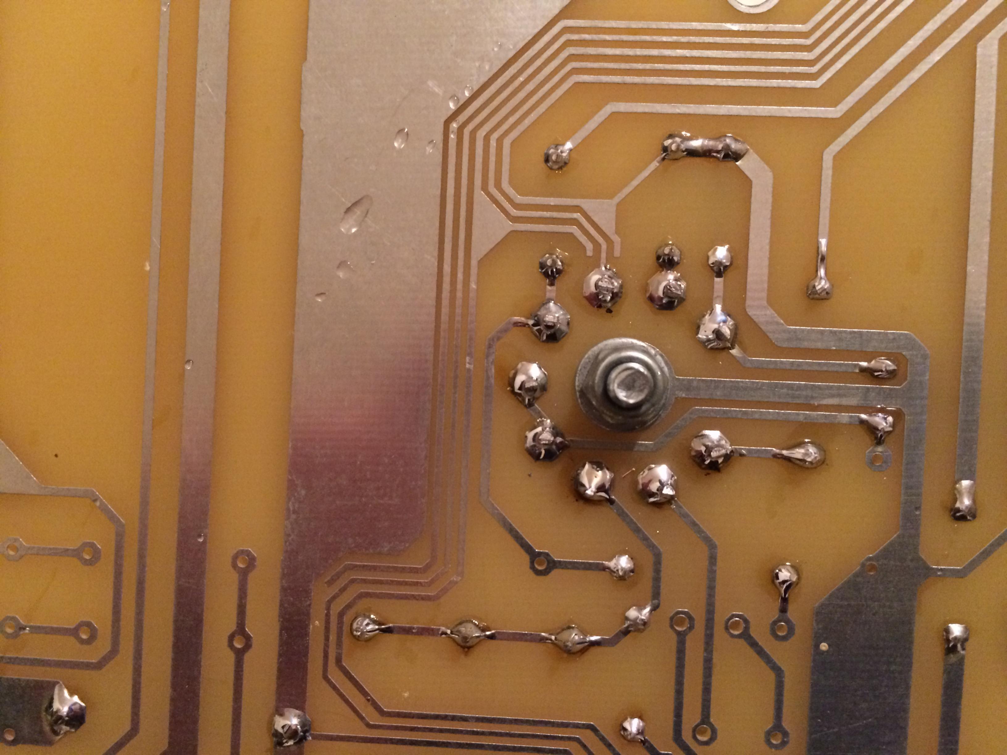

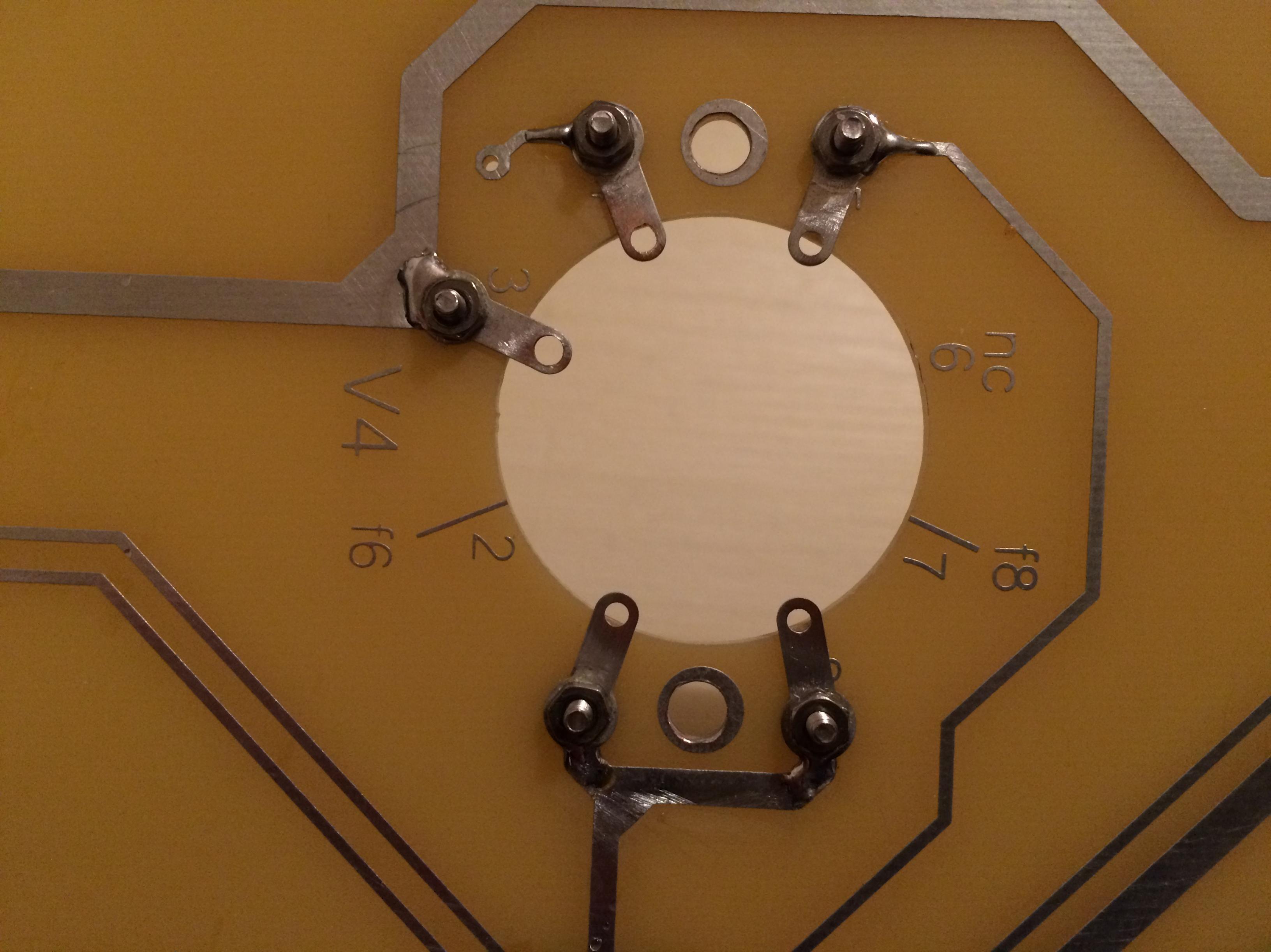

Ok just a few pictures .. this build seems to be taking ages. anyway you will see I have spaced out the pre driver valves as in this version I wanted to put the valves on show. So I will have to suspend the PCB under the main chassis plate. I used braided copper then heat sleeved the conductors .... thoughts hope this will work OK.
Also I have used small bolts with solder tags for the valve terminations so will take more strain off the PCB tracks for ongoing repairs / mods / maintenance for example ... the solder tags are also soldered to the PCB tracks. any way once the amplifier is complete all will make sense .. pictures in the next post
pictures as promised .. must admit the valve extension looks like a jelly fish 🙂

I like the solder tag thing Nick. May be a good idea to get some nickel plated brass washers and put a little grease on the side the tag bolts up to (to stop the solder wicking round to the face the tags bolt to) before sweating them on to the board. Directly bolting tags to a tinned PCB track will cause problems over time. There are proper inserts for this but they are crazy expensive unless you buy in thousands.
