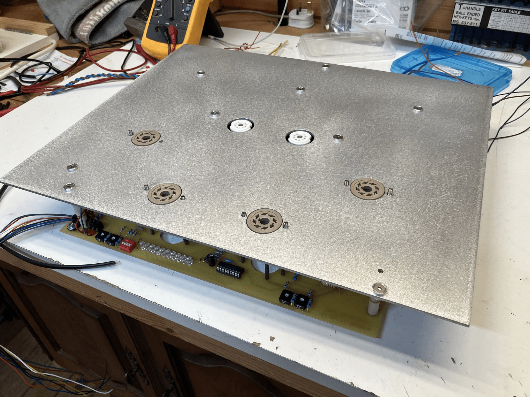

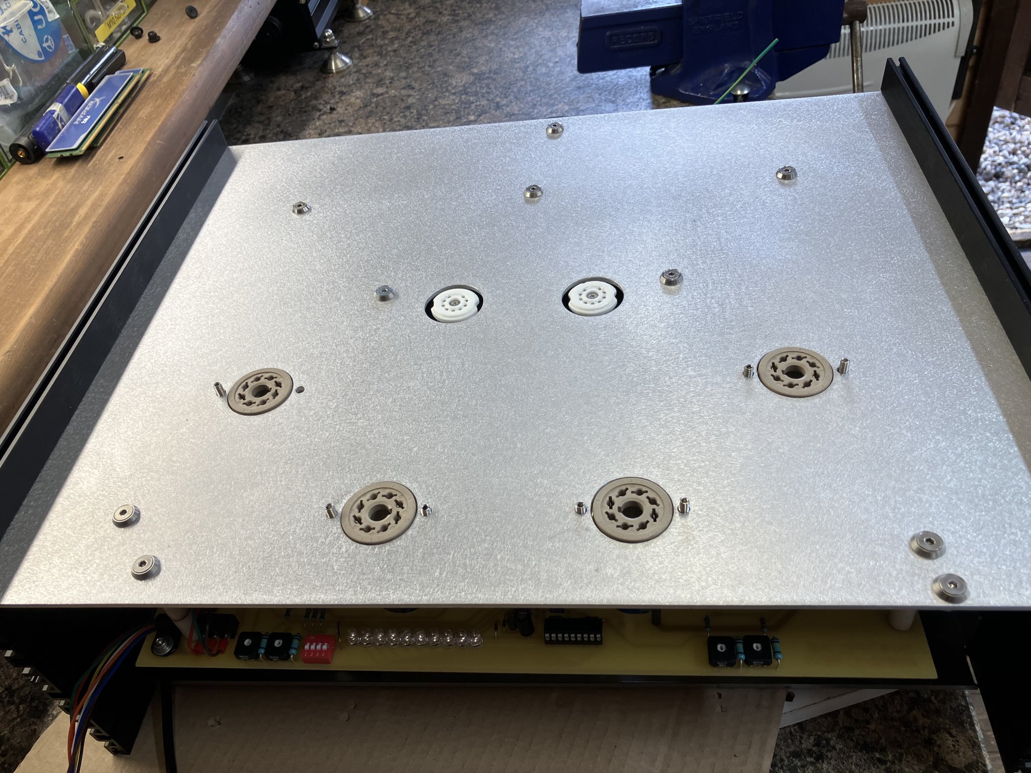

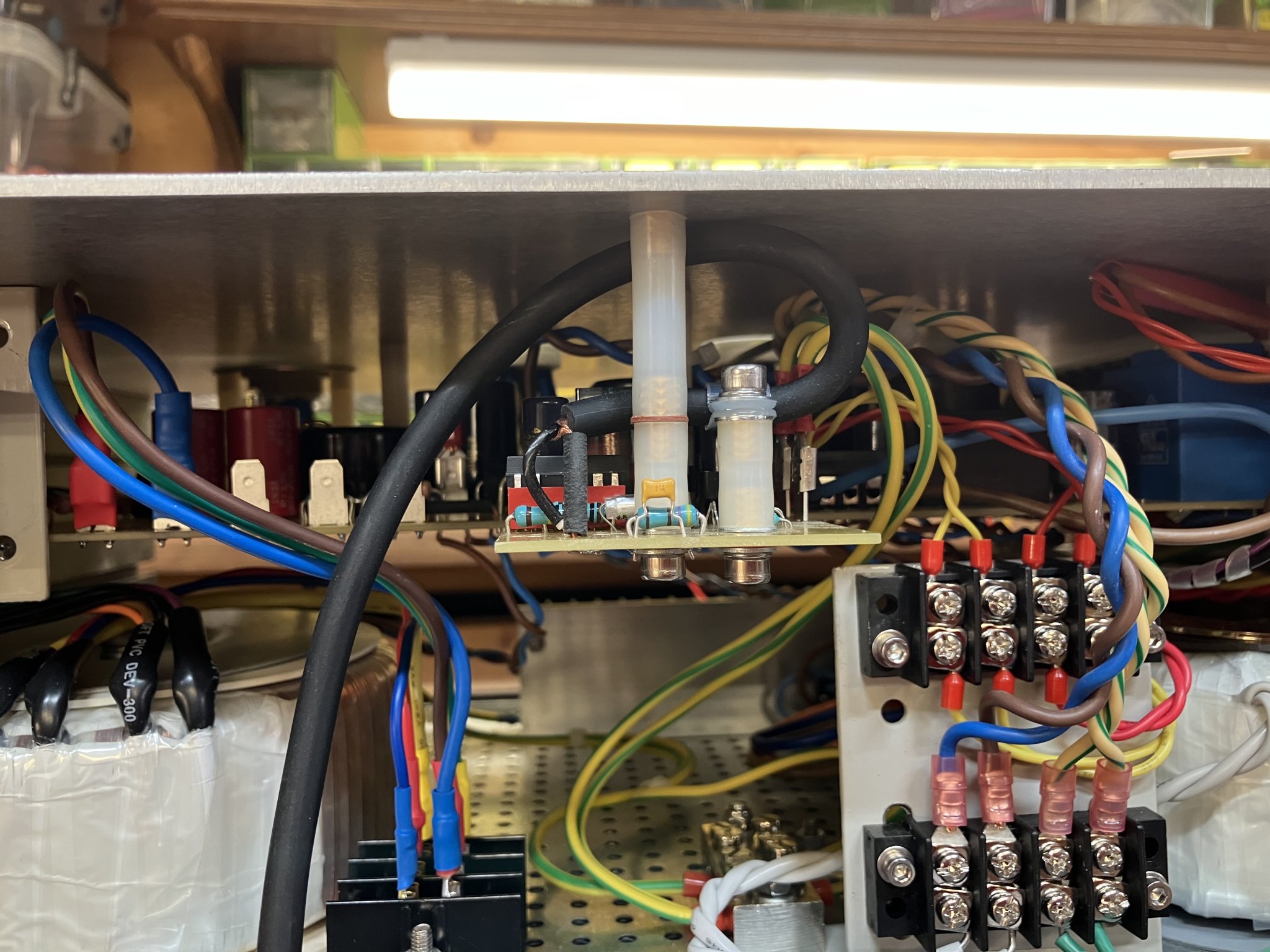

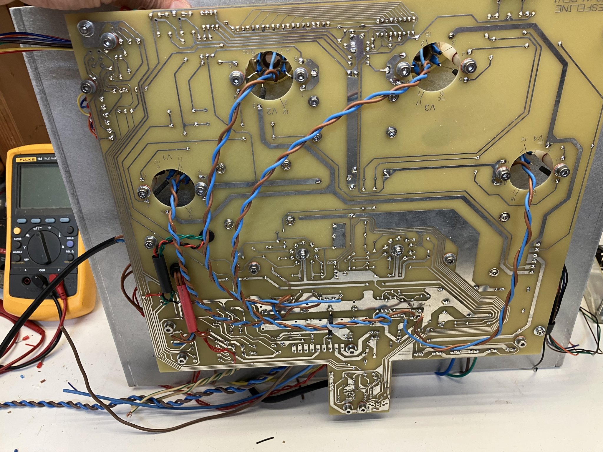

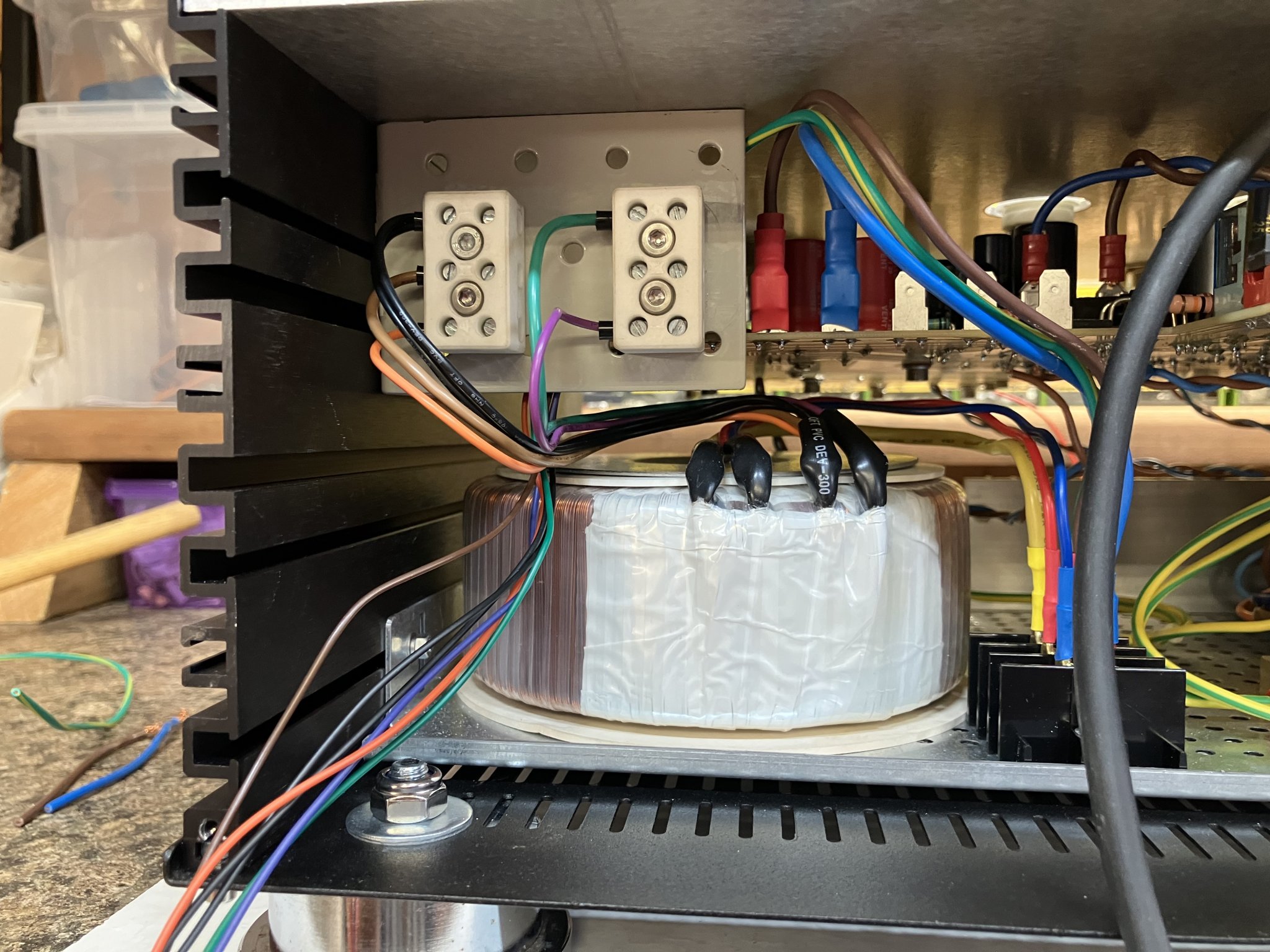

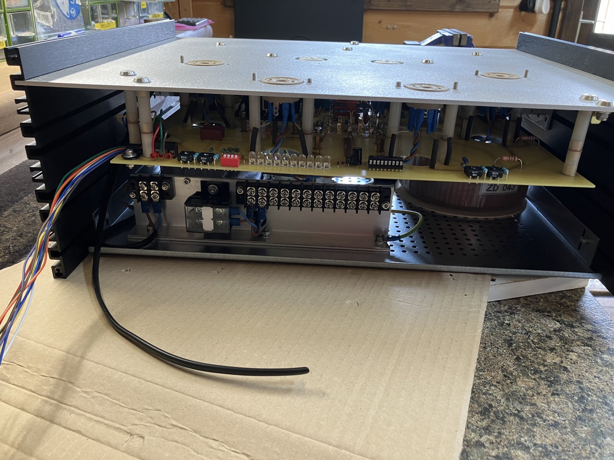

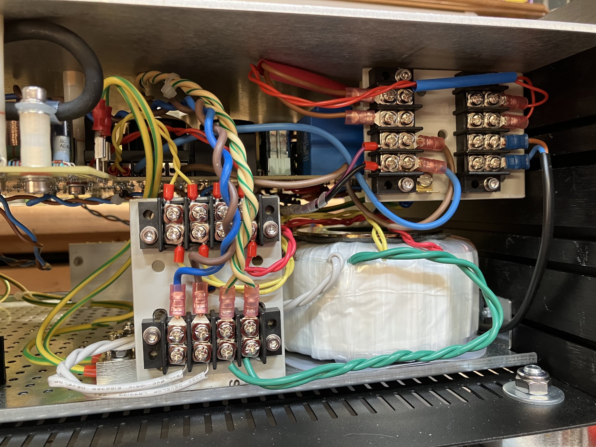

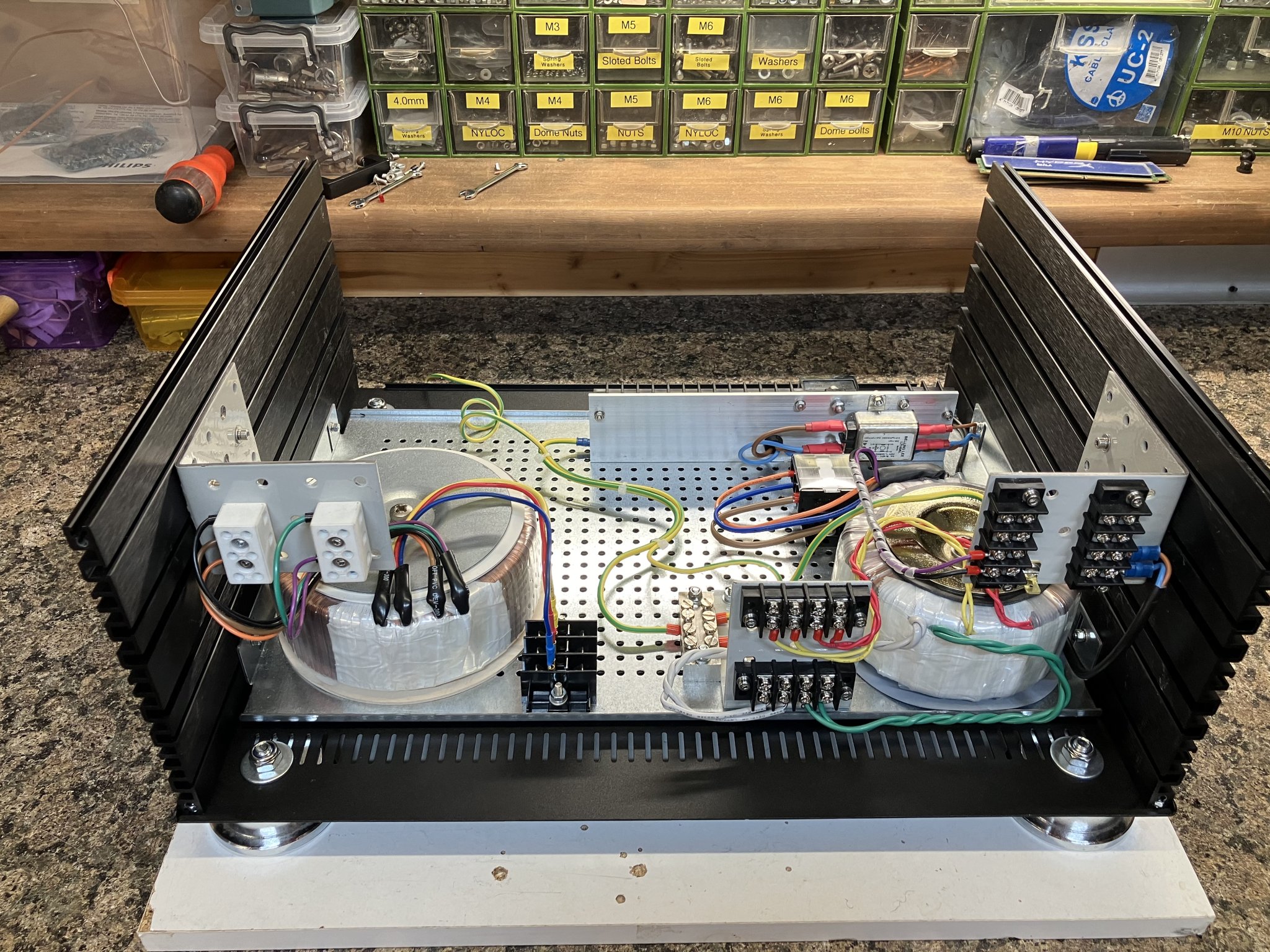

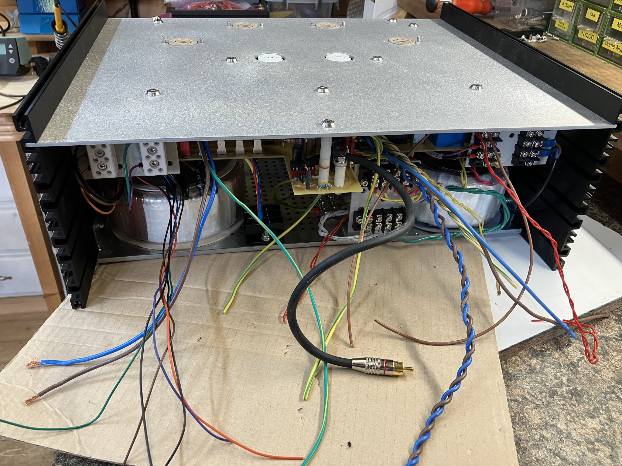

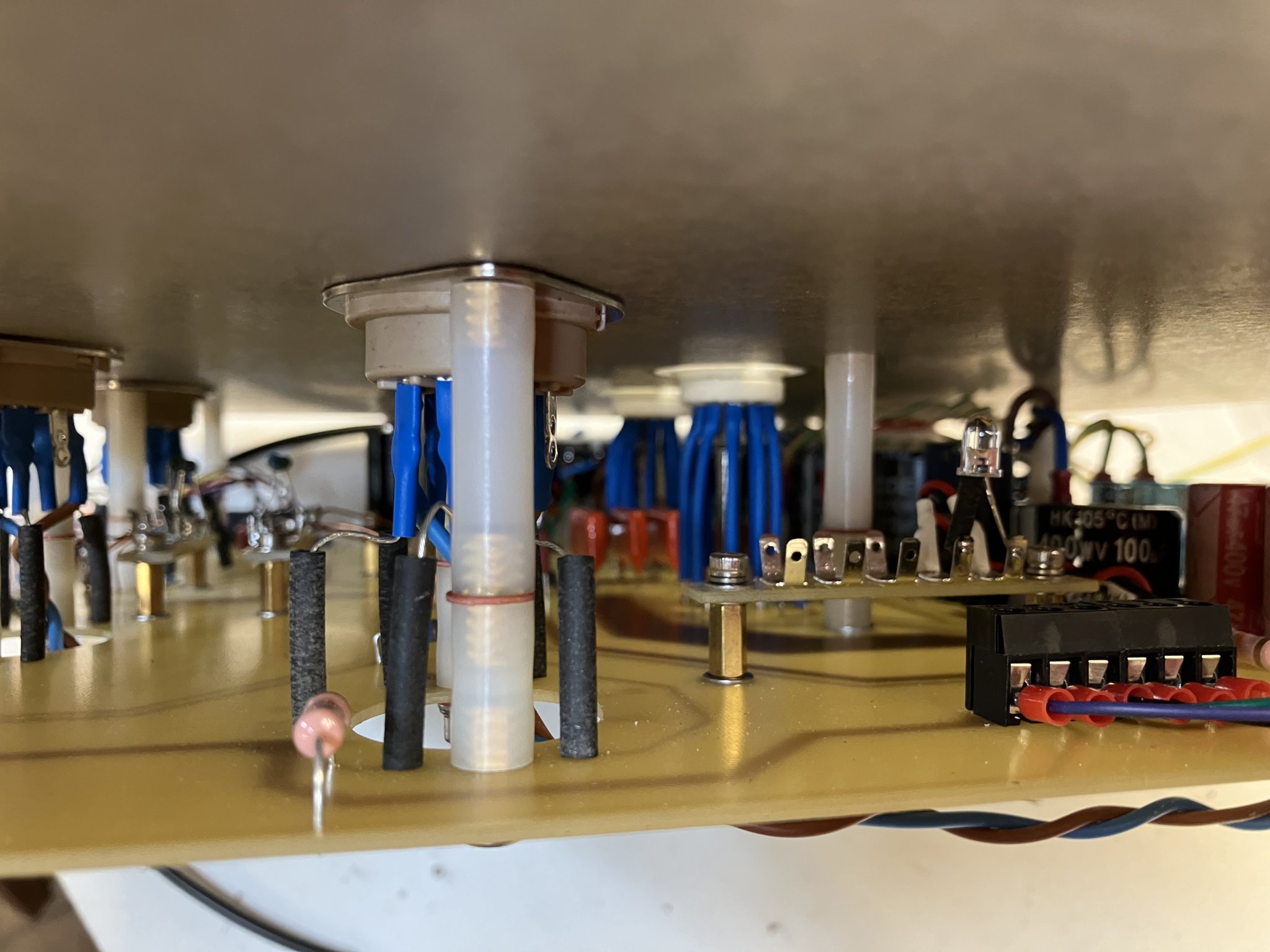

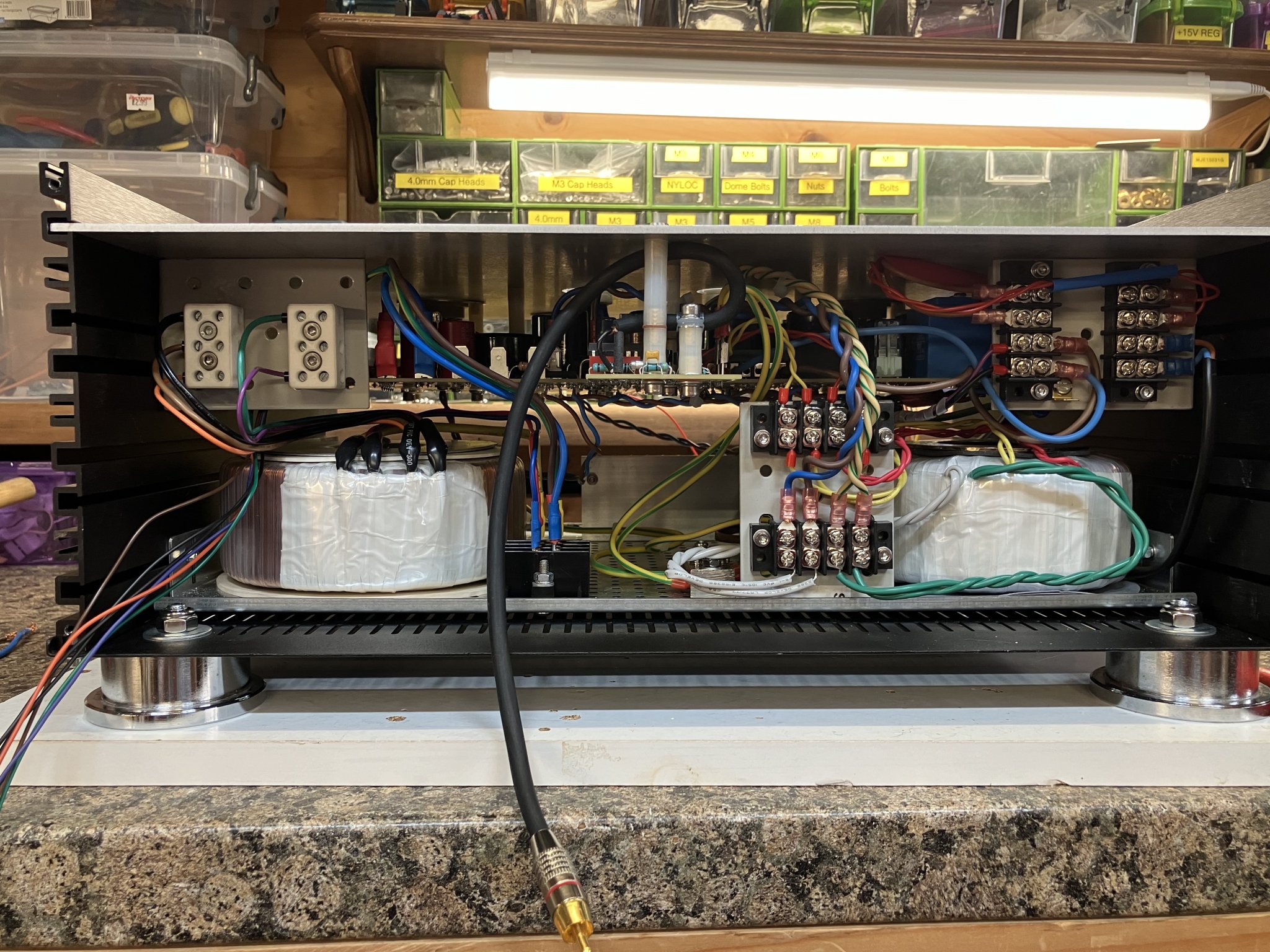

Just mounted the PCB to the top chassis .. this slides into the case as a complete sub assembly.
Reactions: huggygood

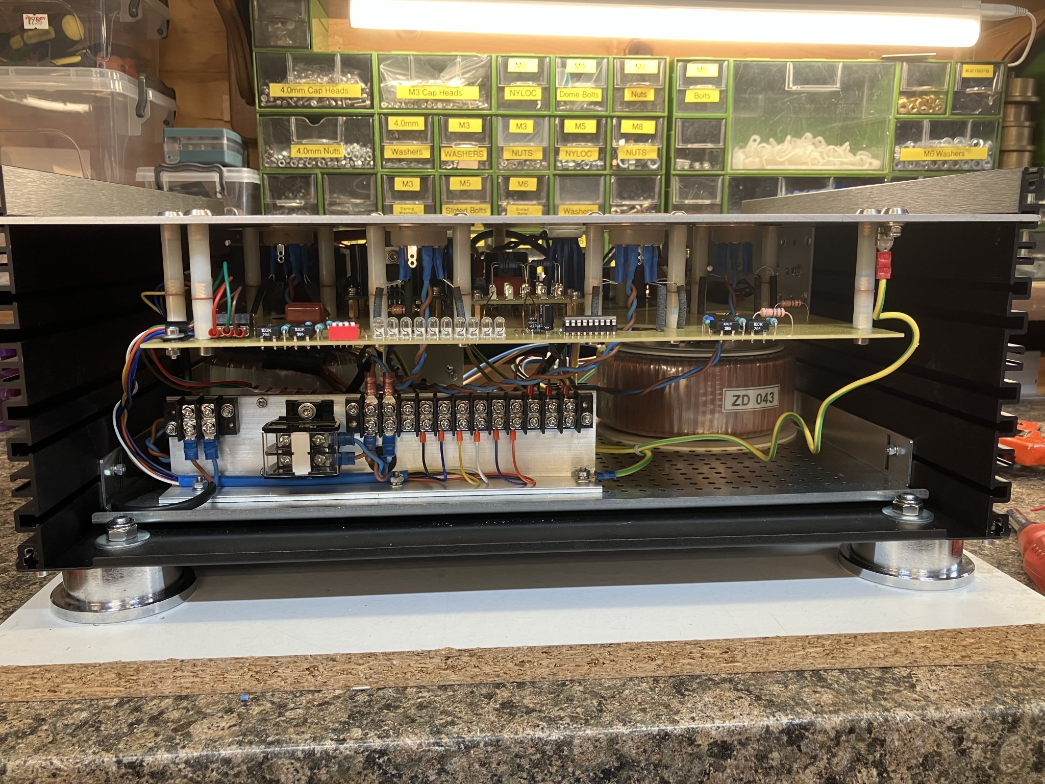

the only disadvantage with my layout is that for any repairs you need to remove the front panel and rear panel then disconnect the various connectors
then you slide the chassis plate out.
This is why I made a test bench first .. so not a problem for me

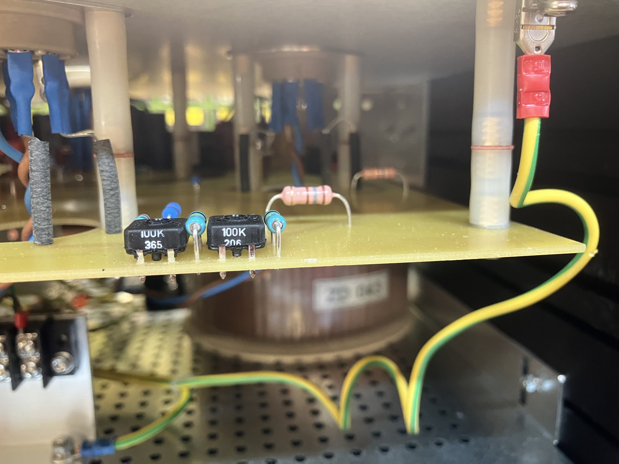

The valve biasing is easy just remove the front panel and the bias potentiometers are accessible. but remember this is the 1st attempt at this layout ..

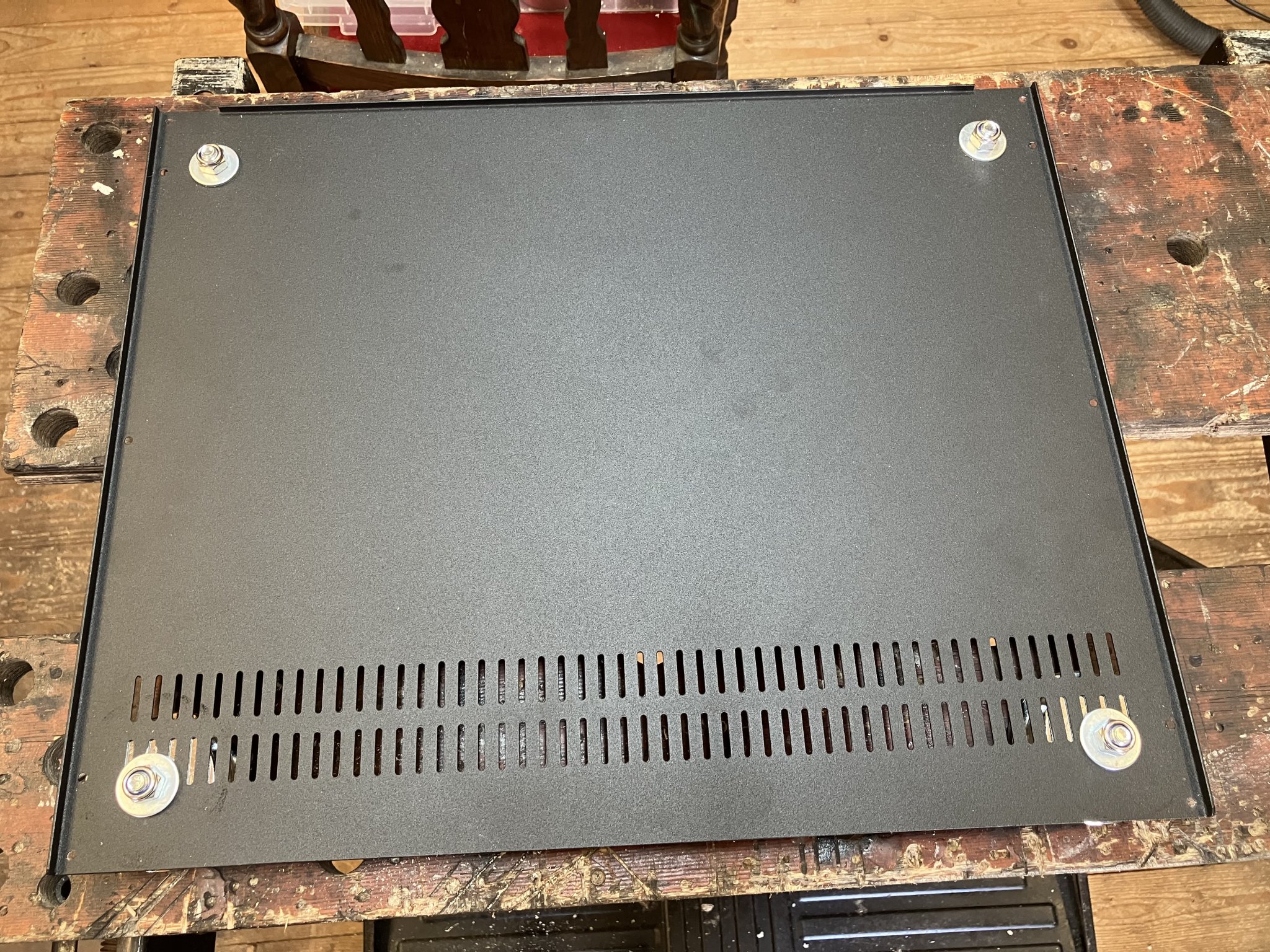

Hello

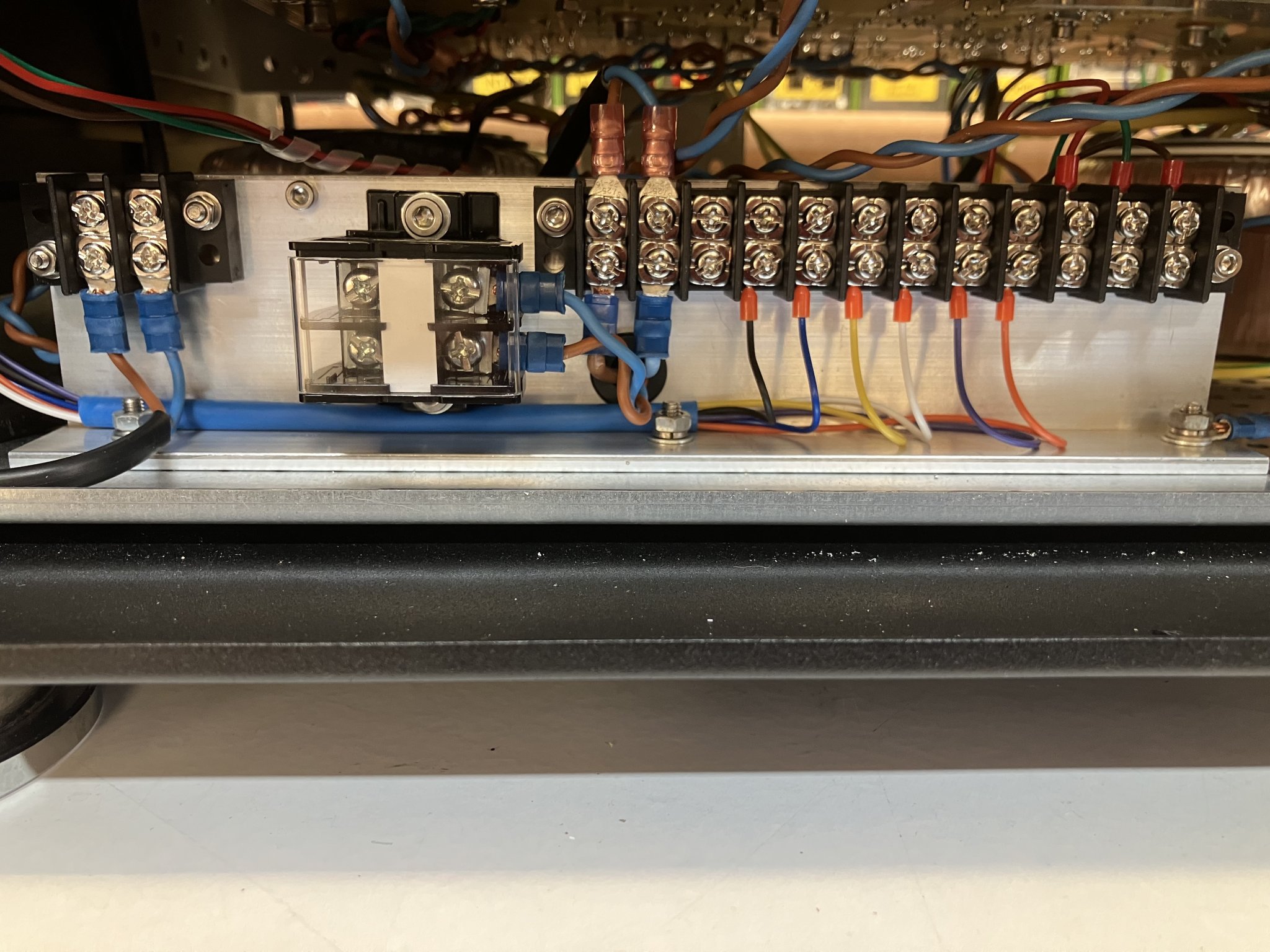

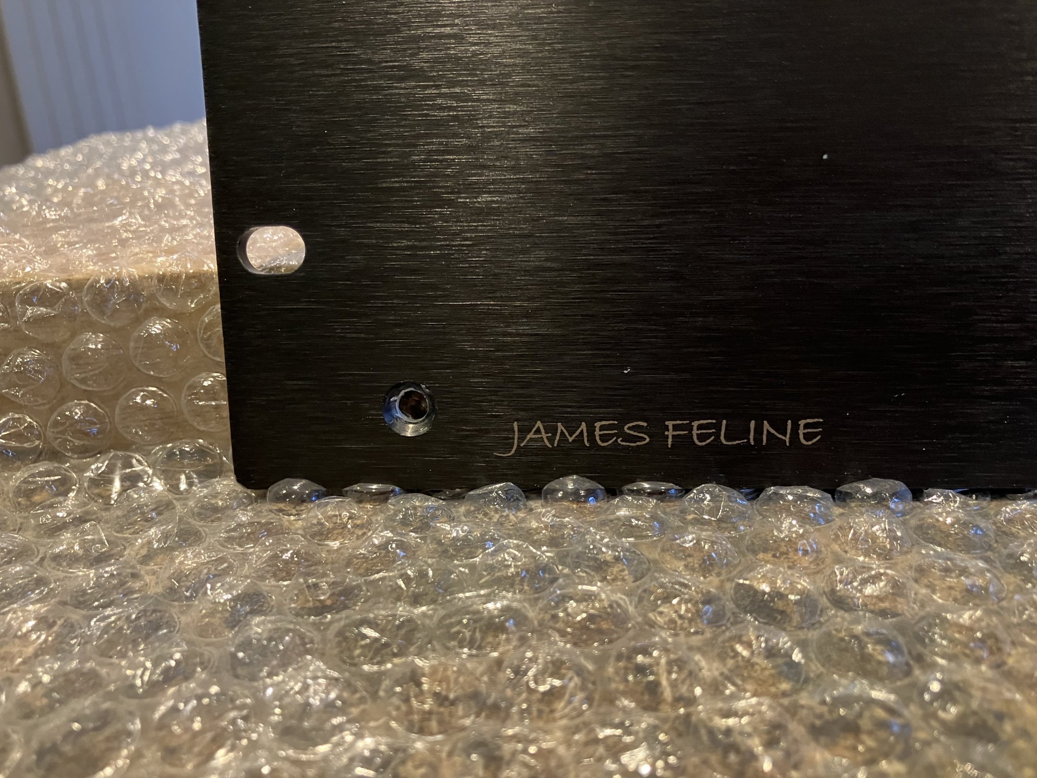

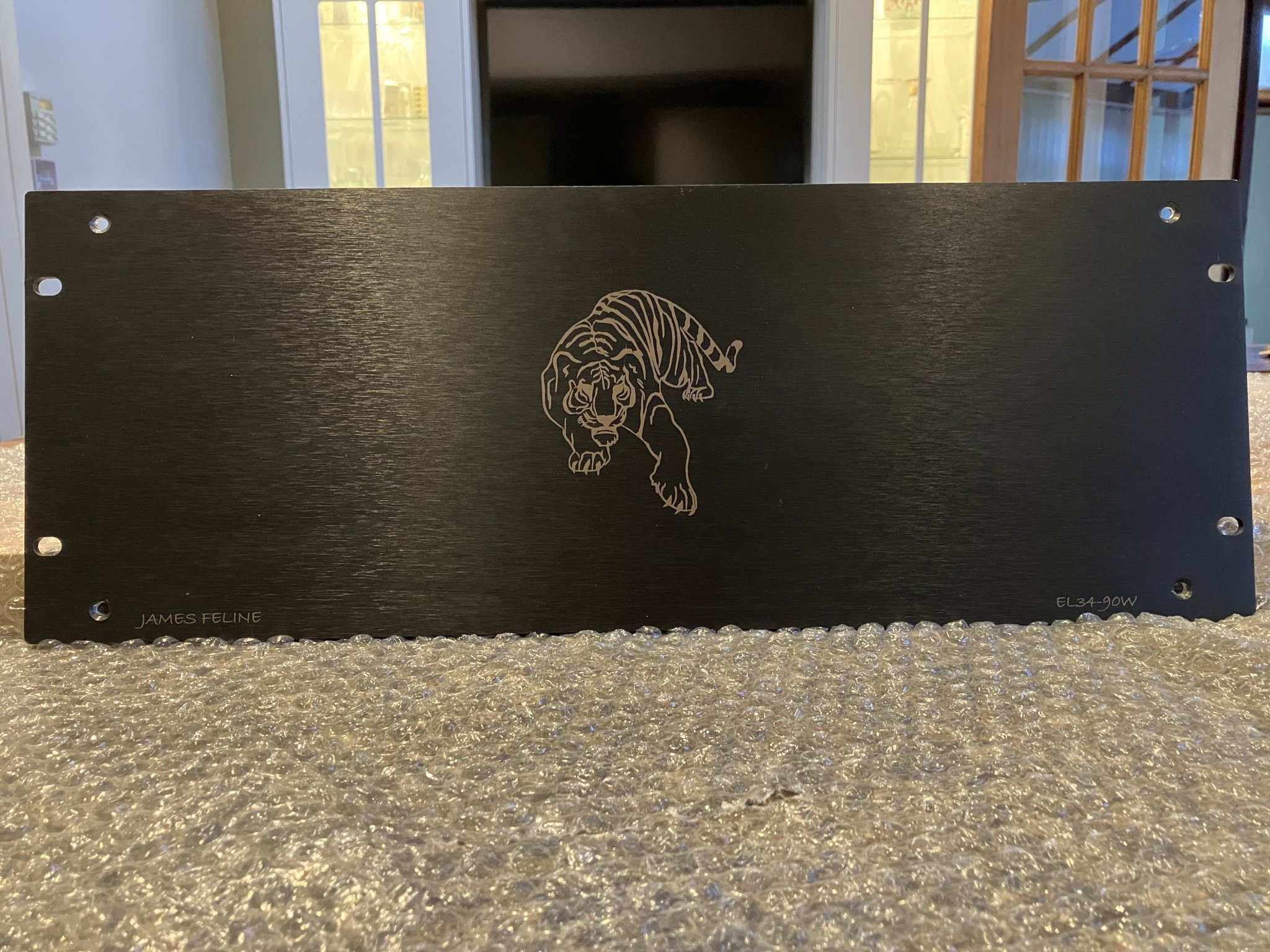

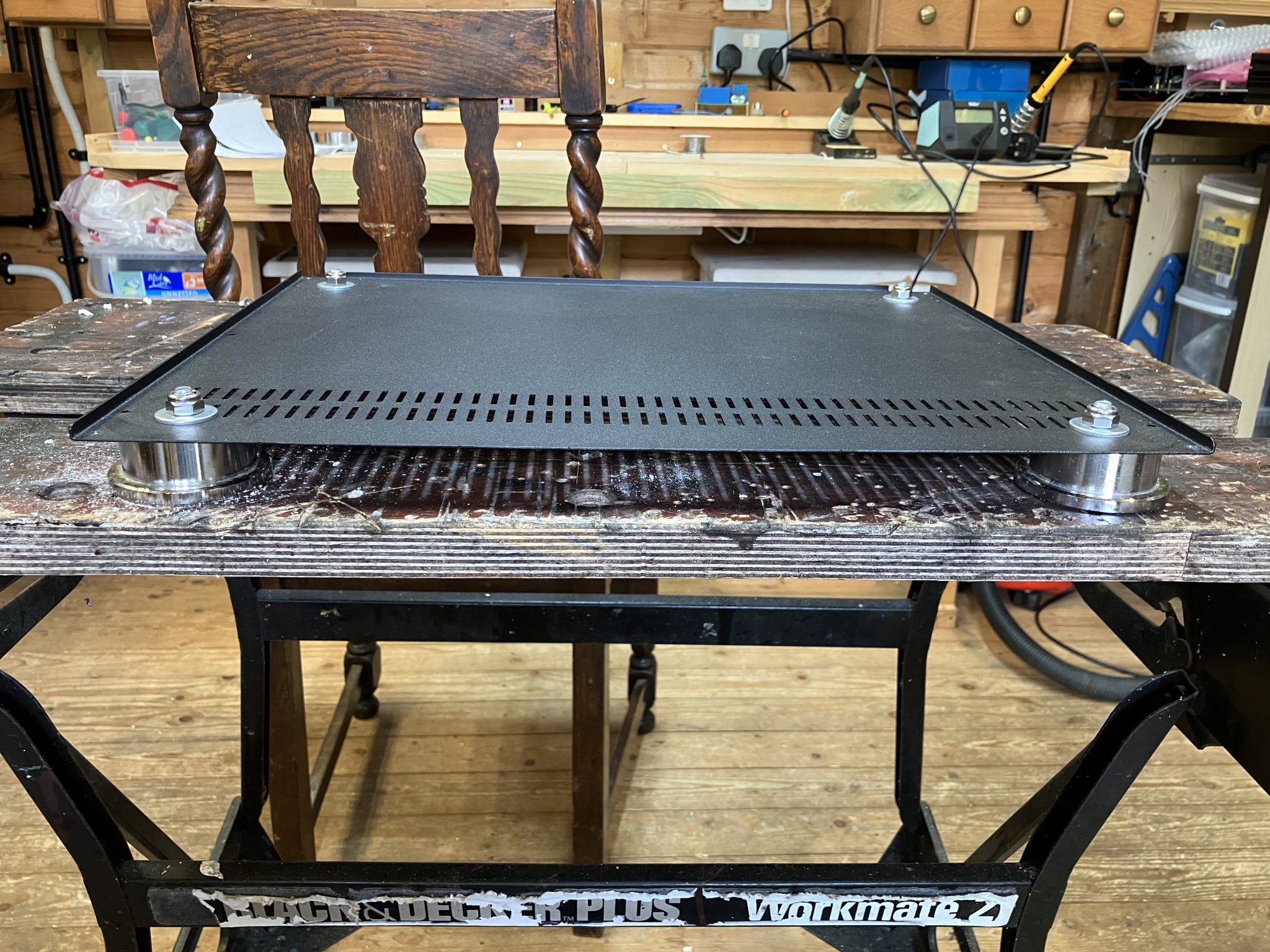

I have mounted the bottom panel last night with the enclosure feet attached .. so far so good
Just wish modushop would make a longer depth of this enclosure 450mm would be nice as the PCB depth is 350mm or a nice DIY valve enclosure with matching valve cage would be nice .. hint hint

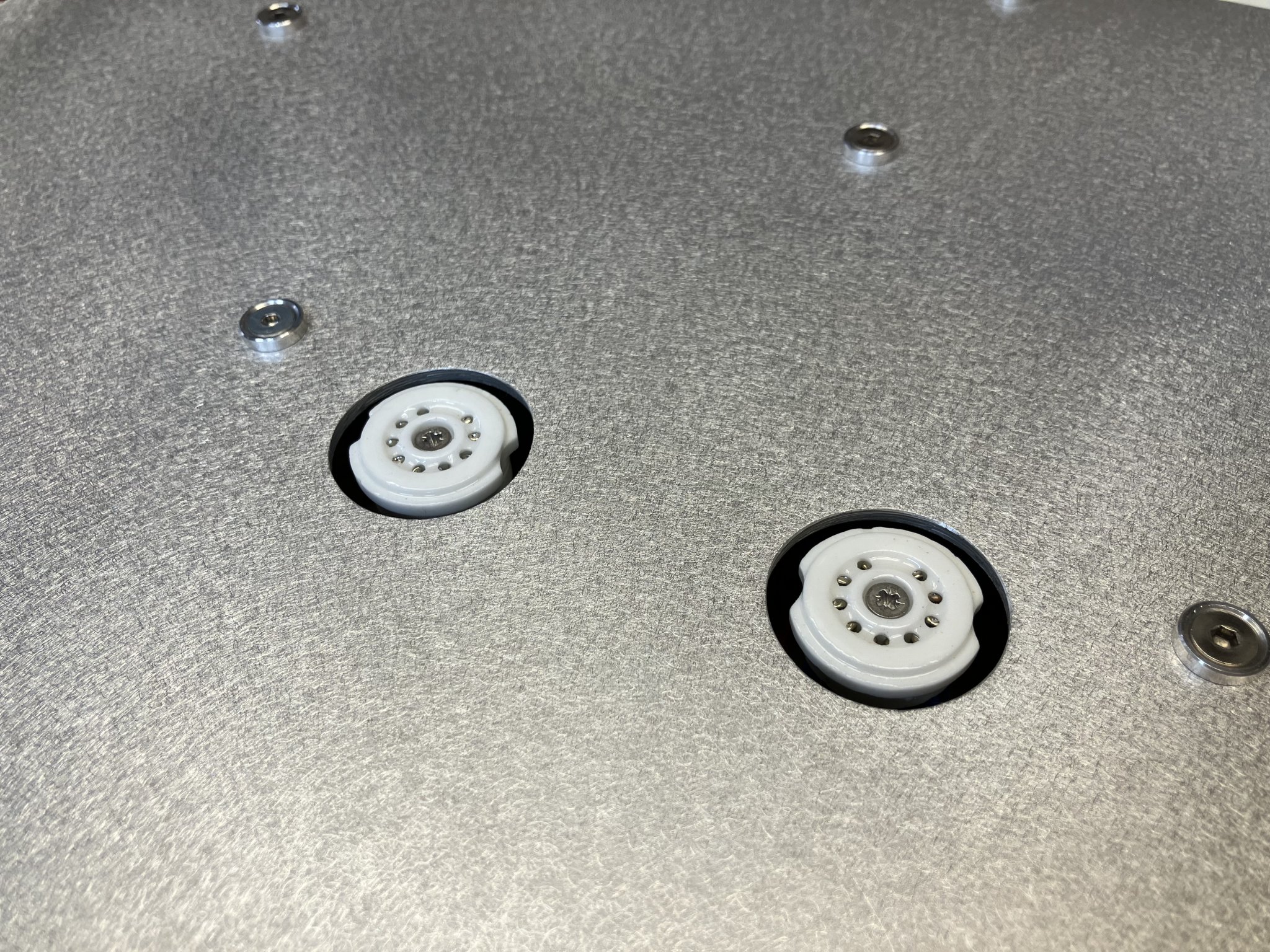

So this is the EL34 version (90w rms and the 1st 15w in class A)
Next I need to add the main power on/off switch and the stand-by pre heat switch ... plus drill the cats eyes out for thr power LEDs
slowly slowy catchy monkey .. hope it all works 🙄
