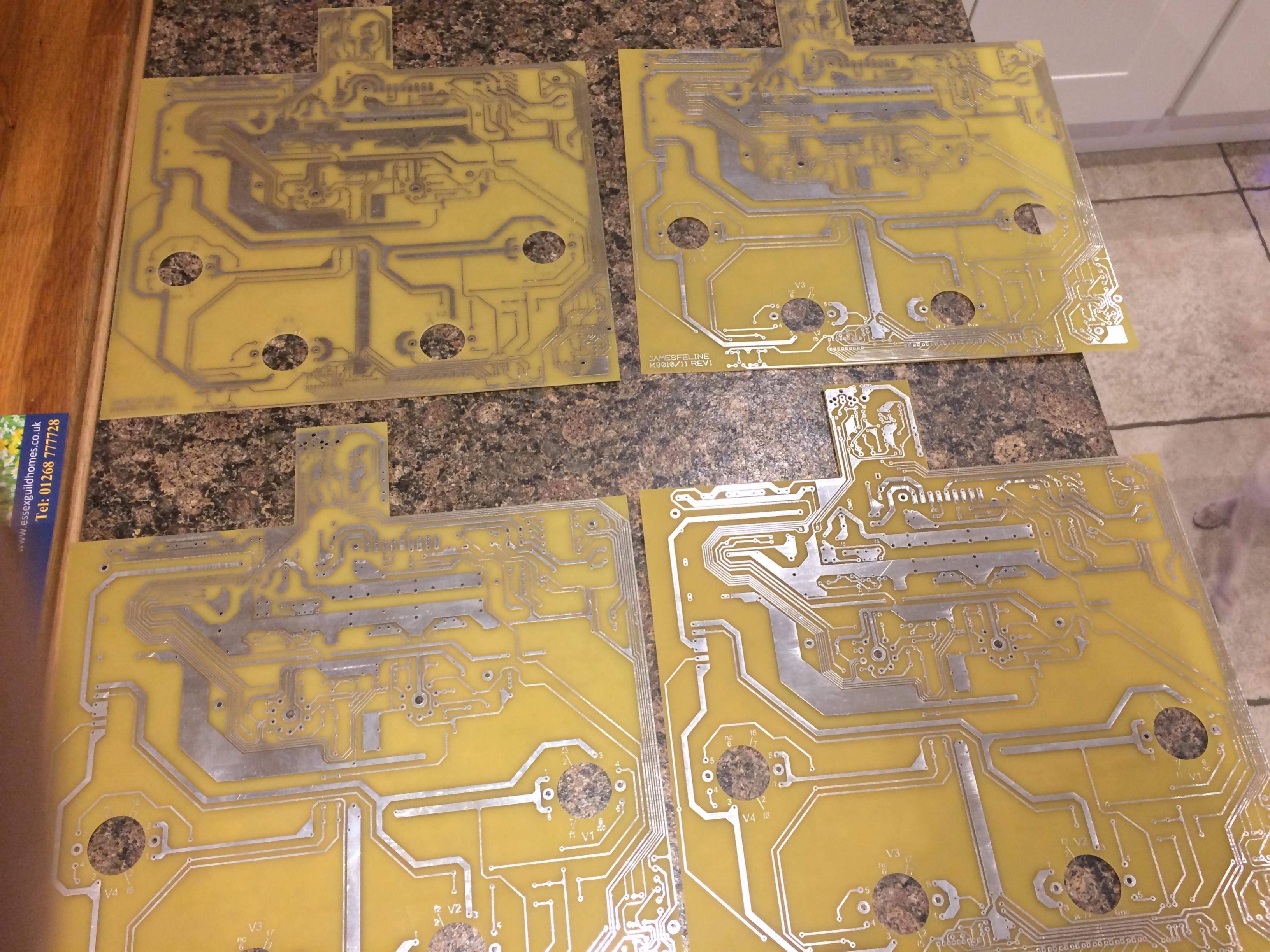

well spotted ... yes you are correct did not think of that, but these will be OK for my next project (watch this space) as can easily extend the cables if needed. The transformers will be terminated local so no issues. But in the next batch will make the cables longer. many thanks for the observation, I have noted this 😉

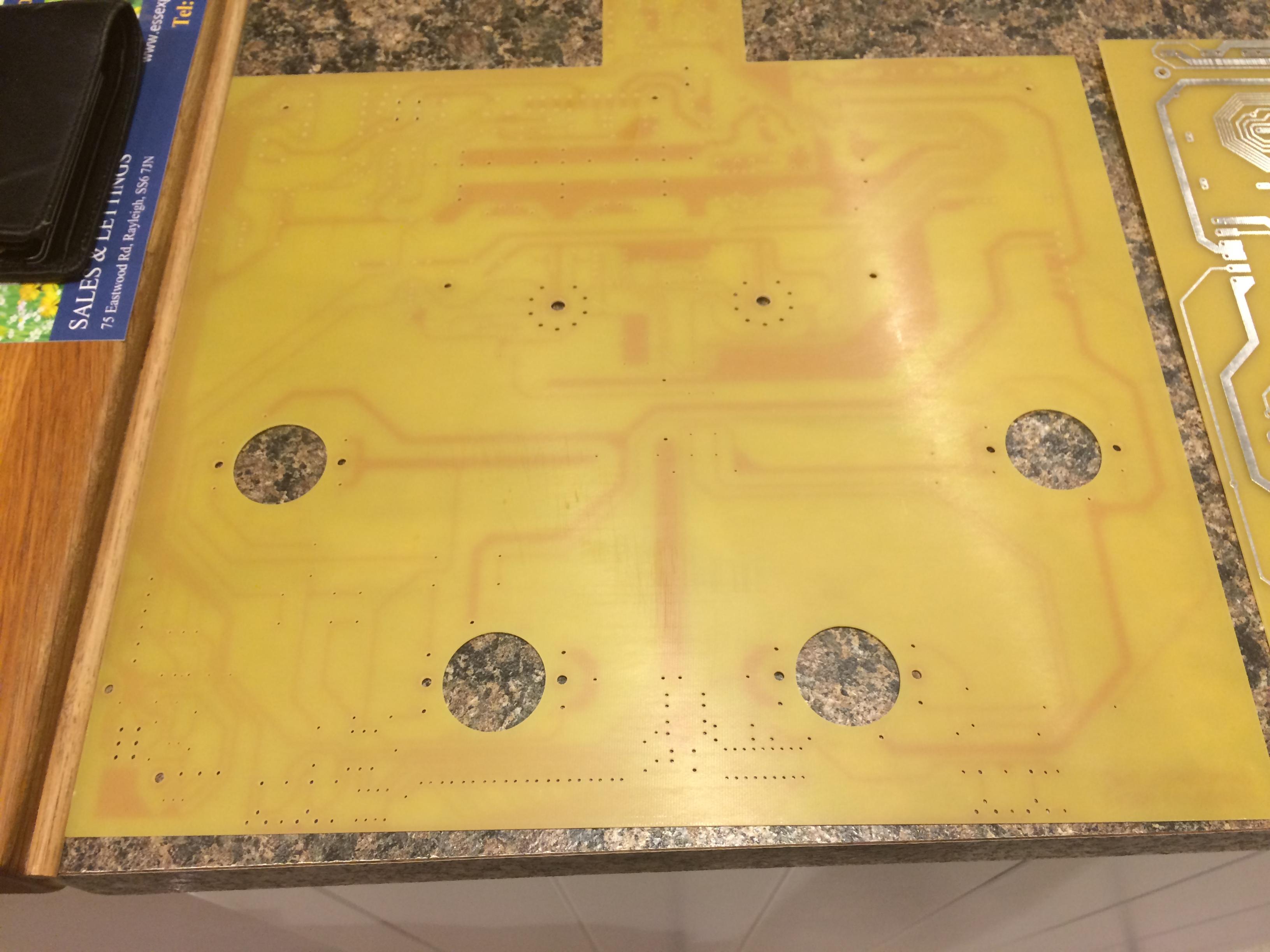

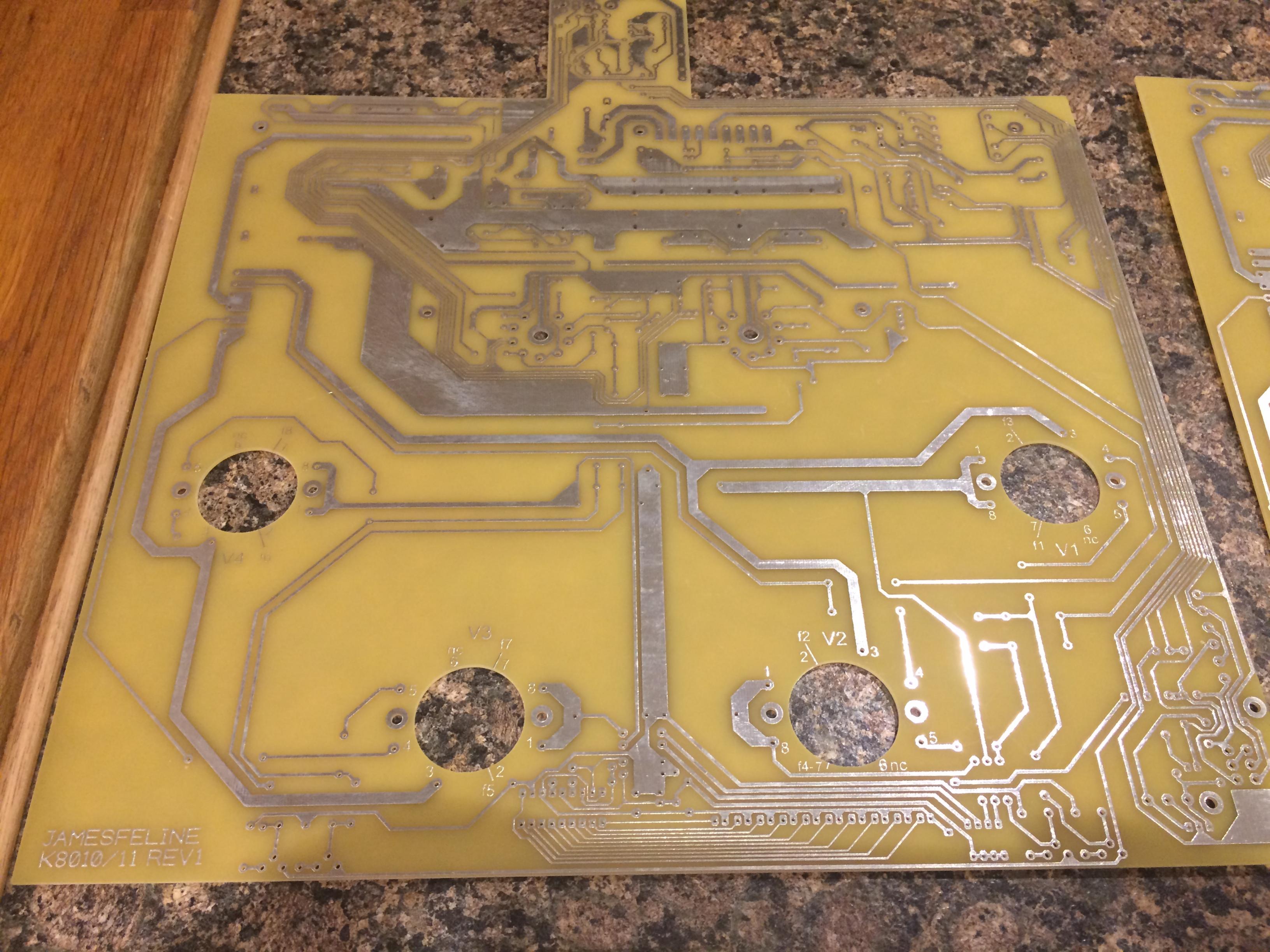

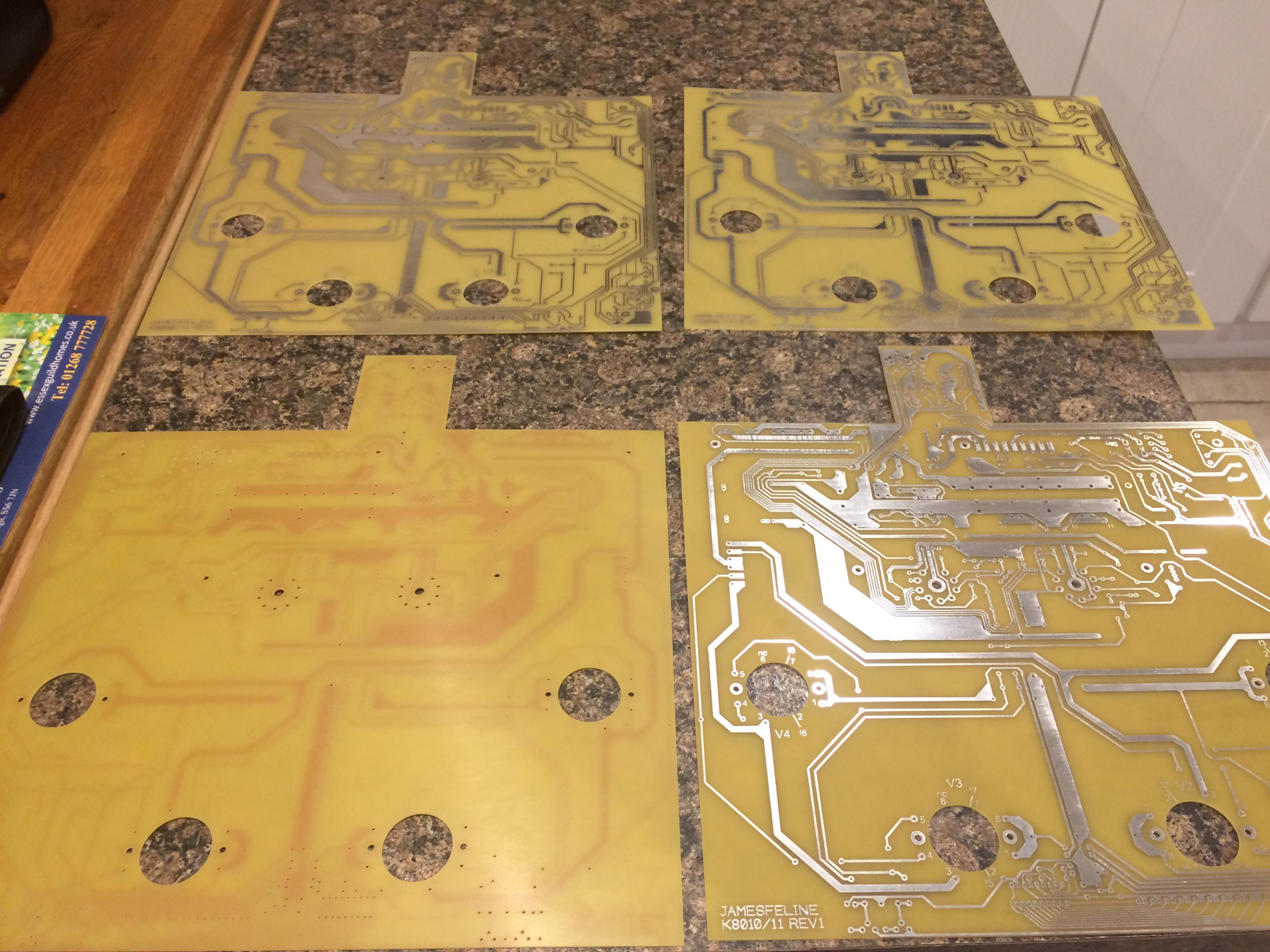

New batch of k8011/10 PCB's just been delivered 🙂

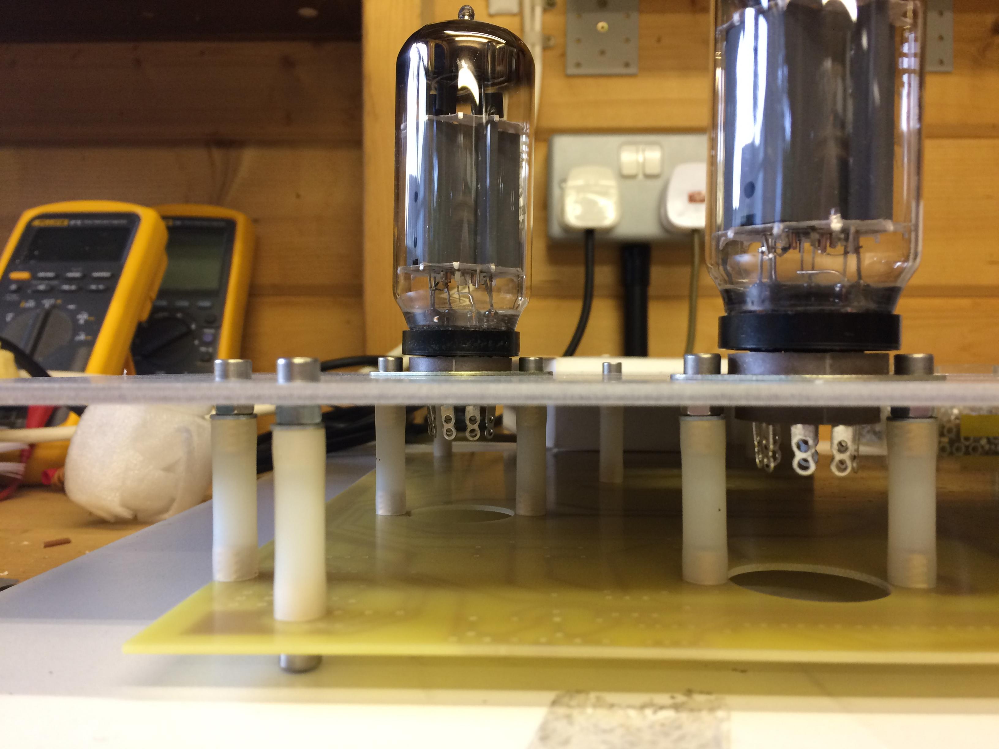

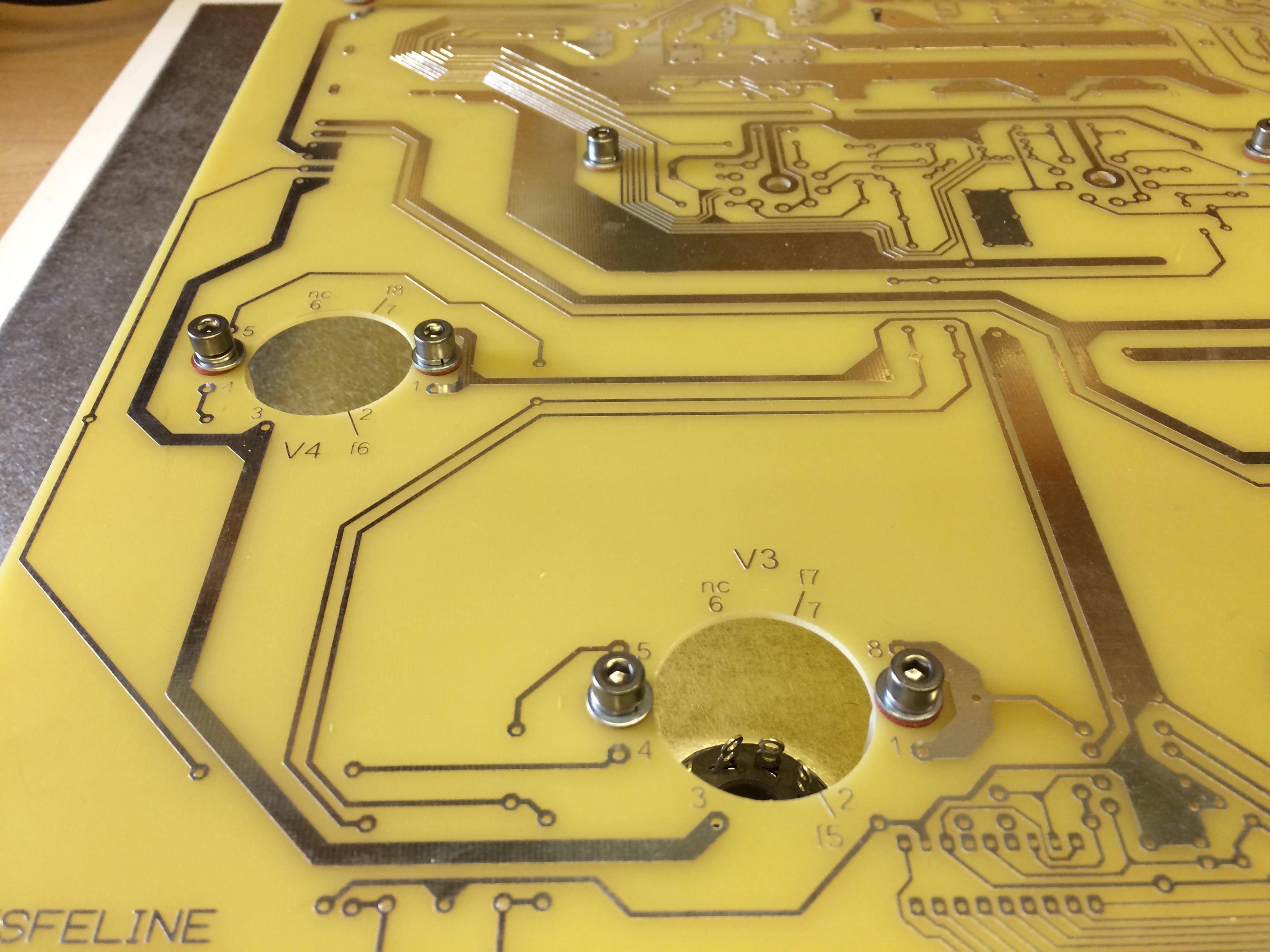

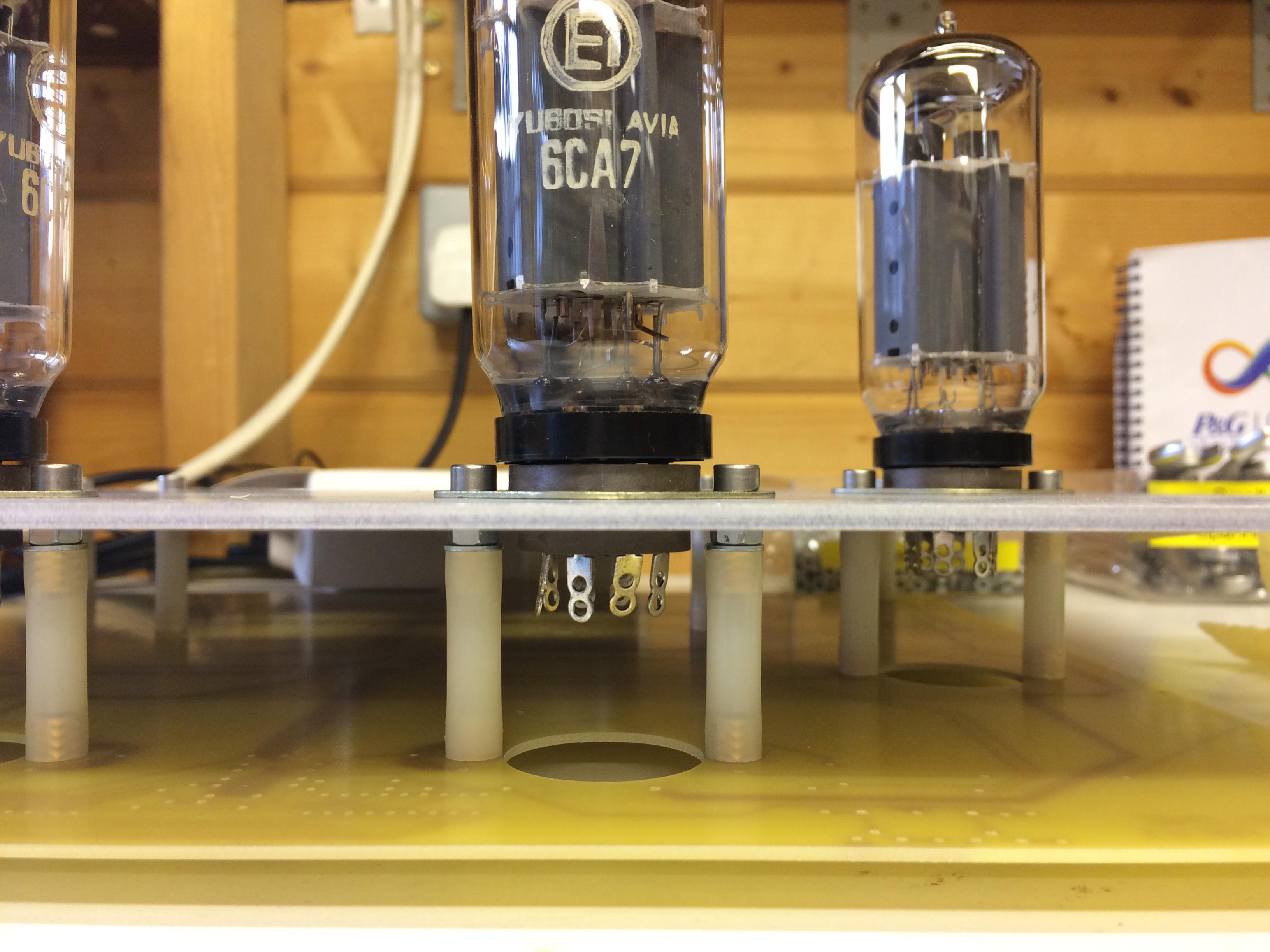

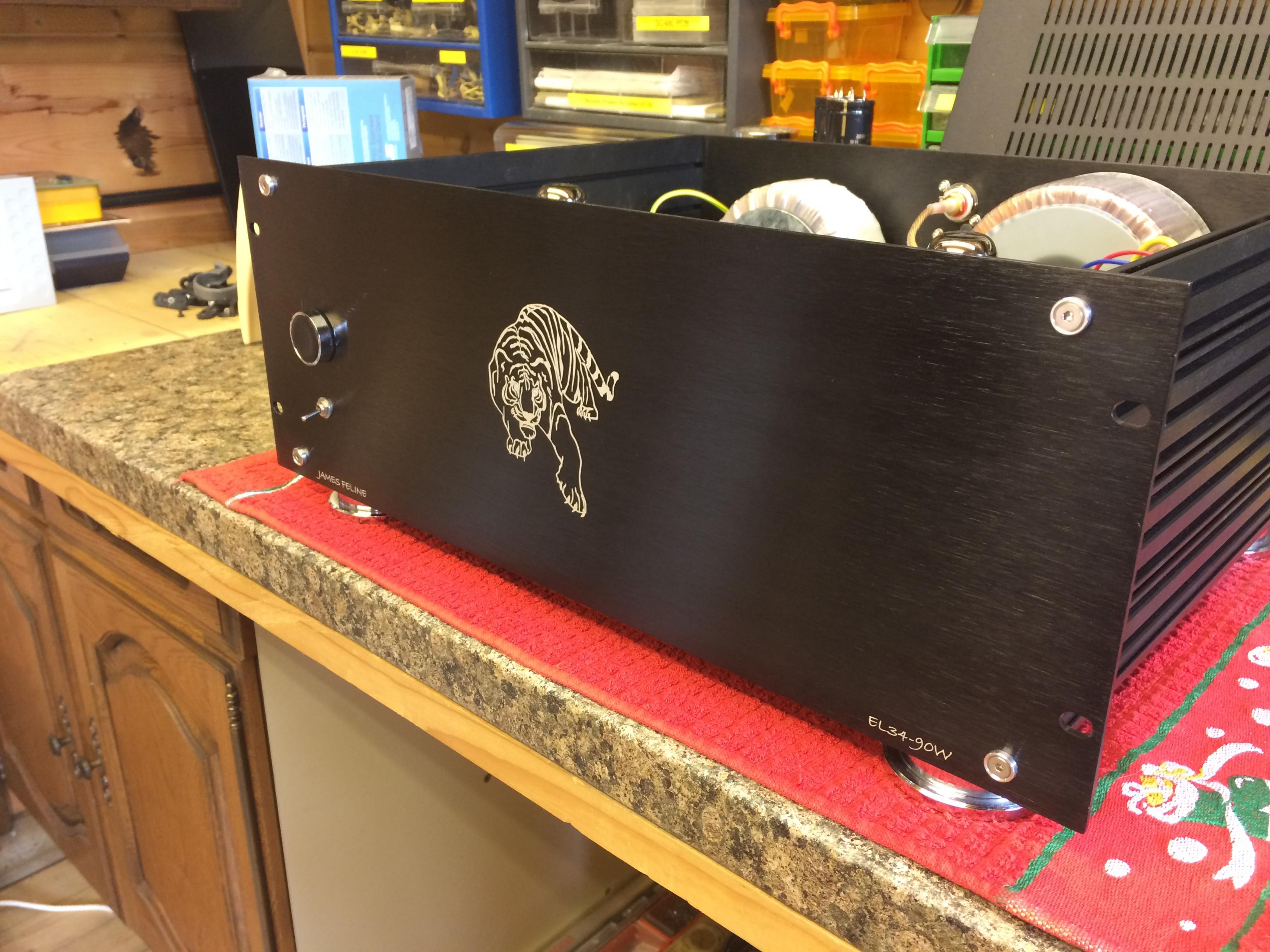

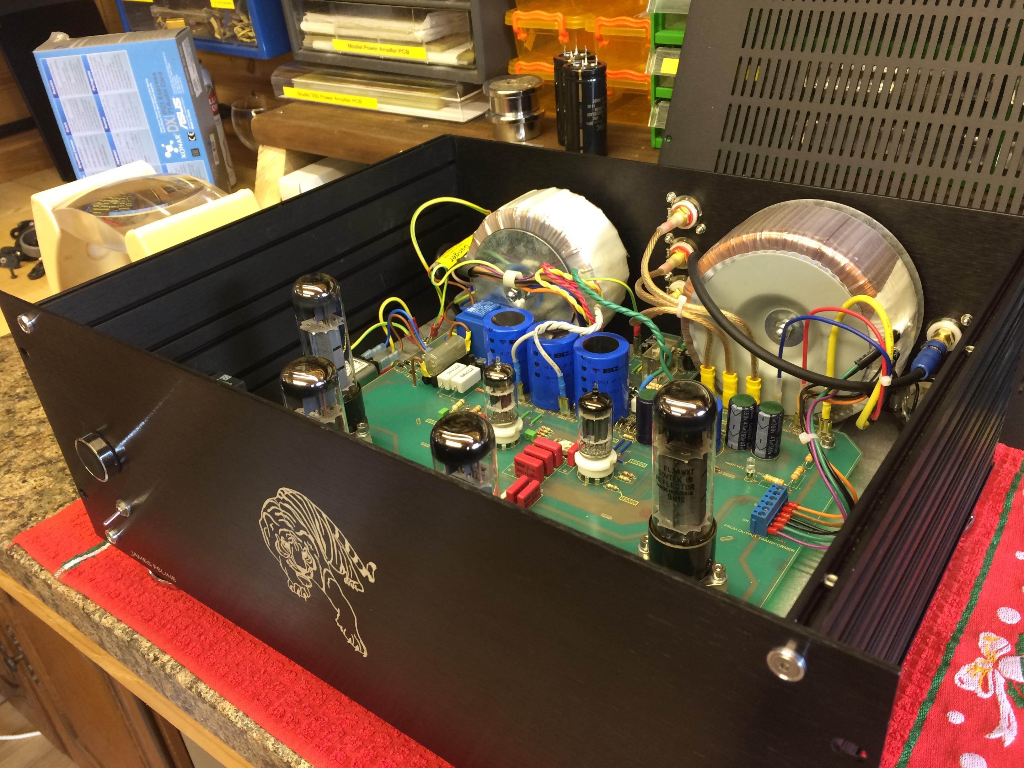

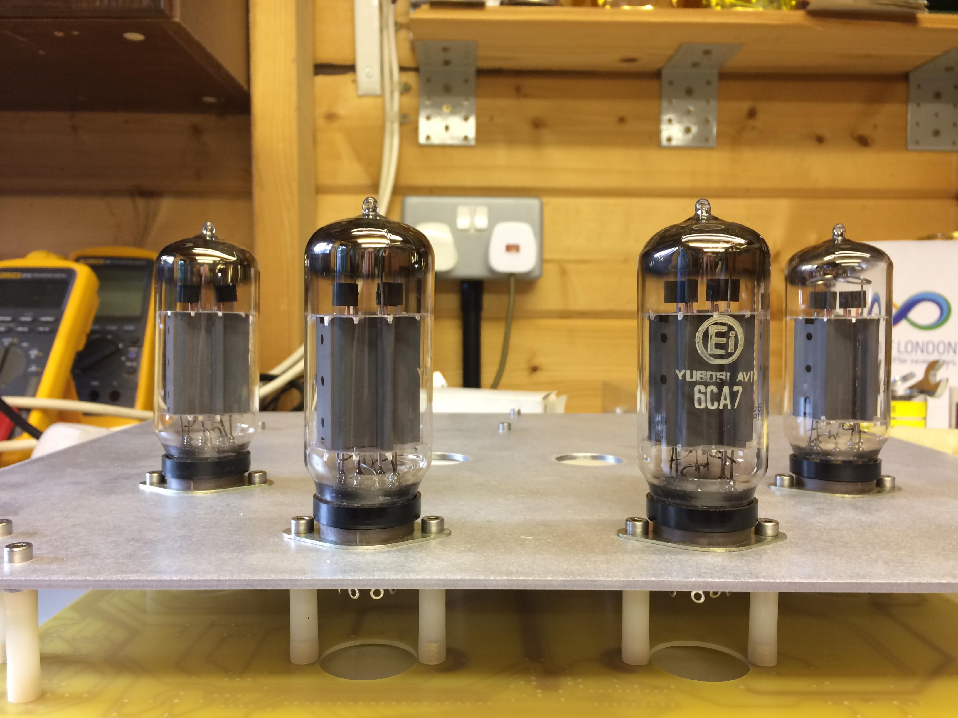

Hello fellow forum members
For some time now I wanted to make a k8011 amplifier with some 6CA7 NOS valves that I have .. also I wanted the valves to be on show safely ... so as you know all my existing valve amplifiers have the tubes fully enclosed .. like the picture attached

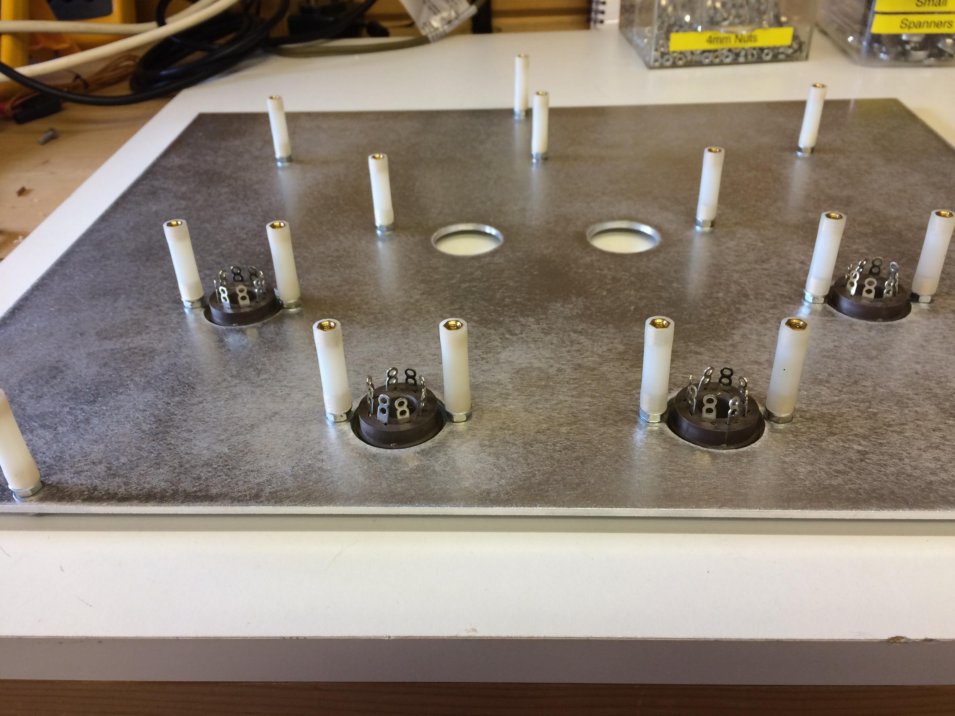

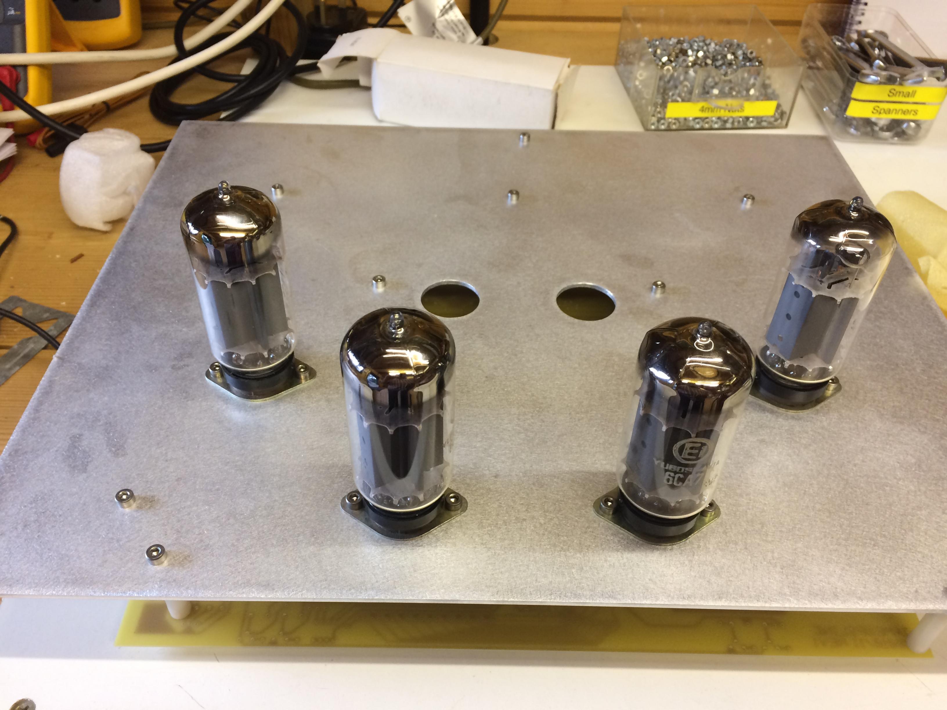

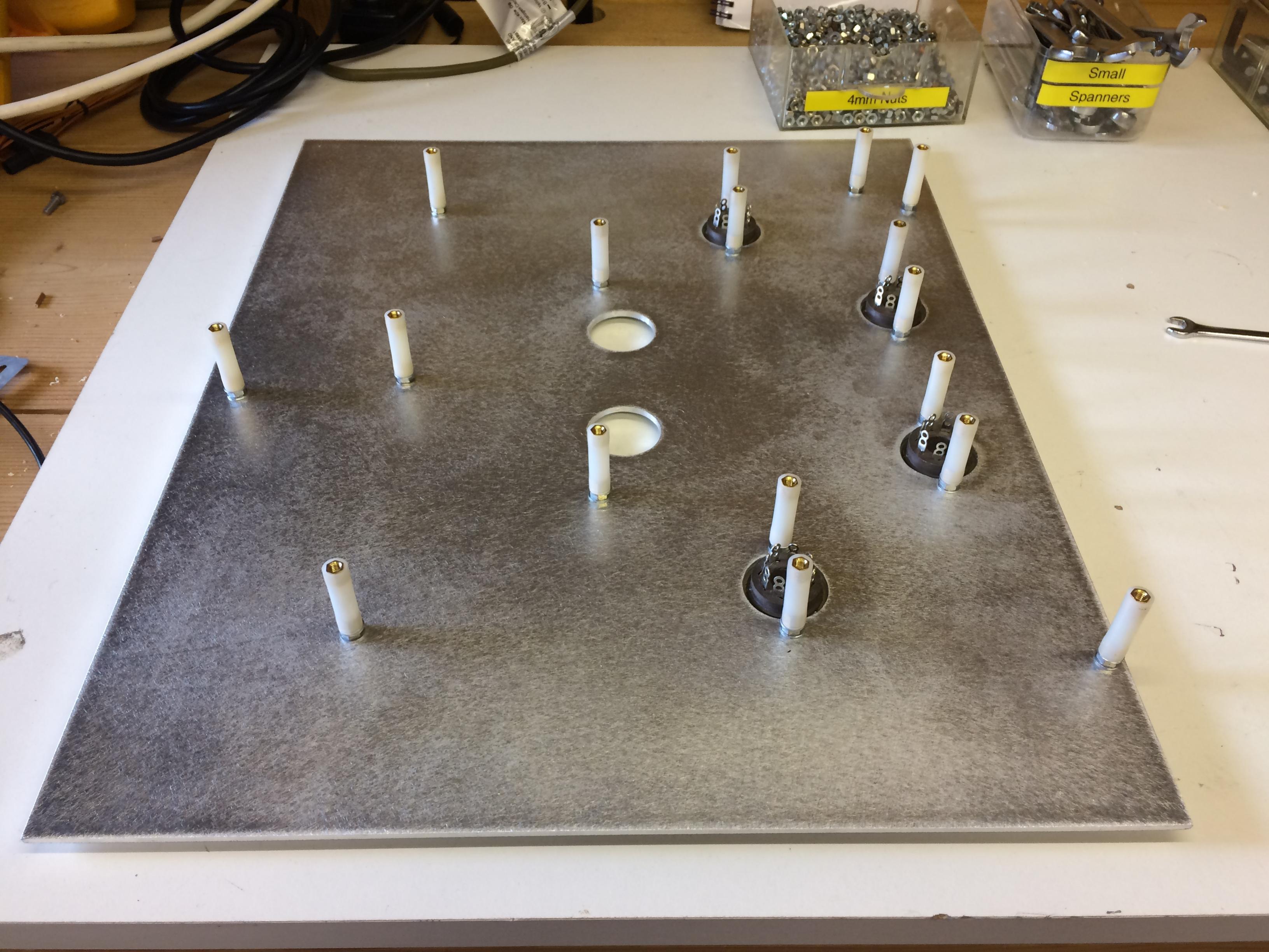

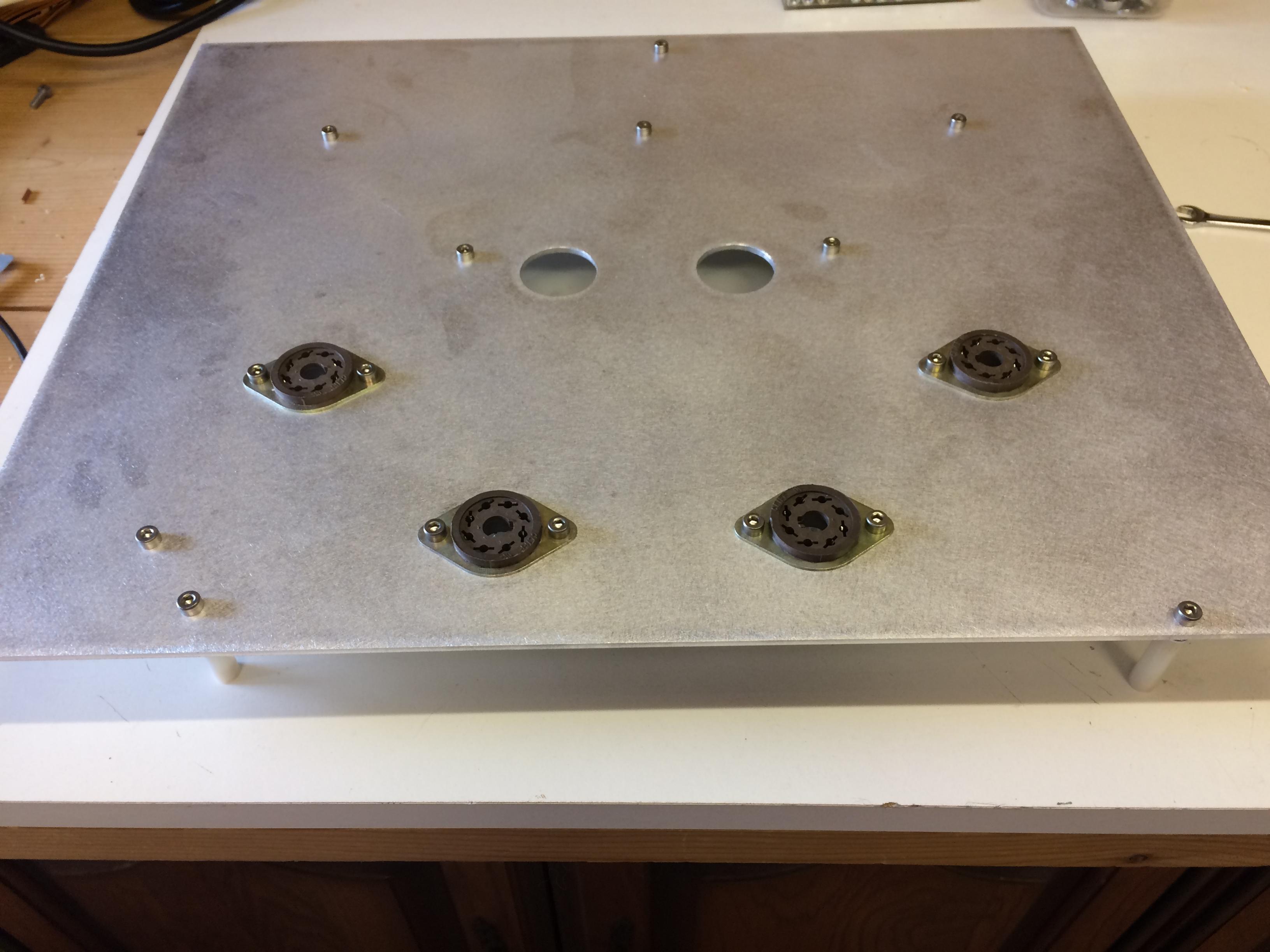

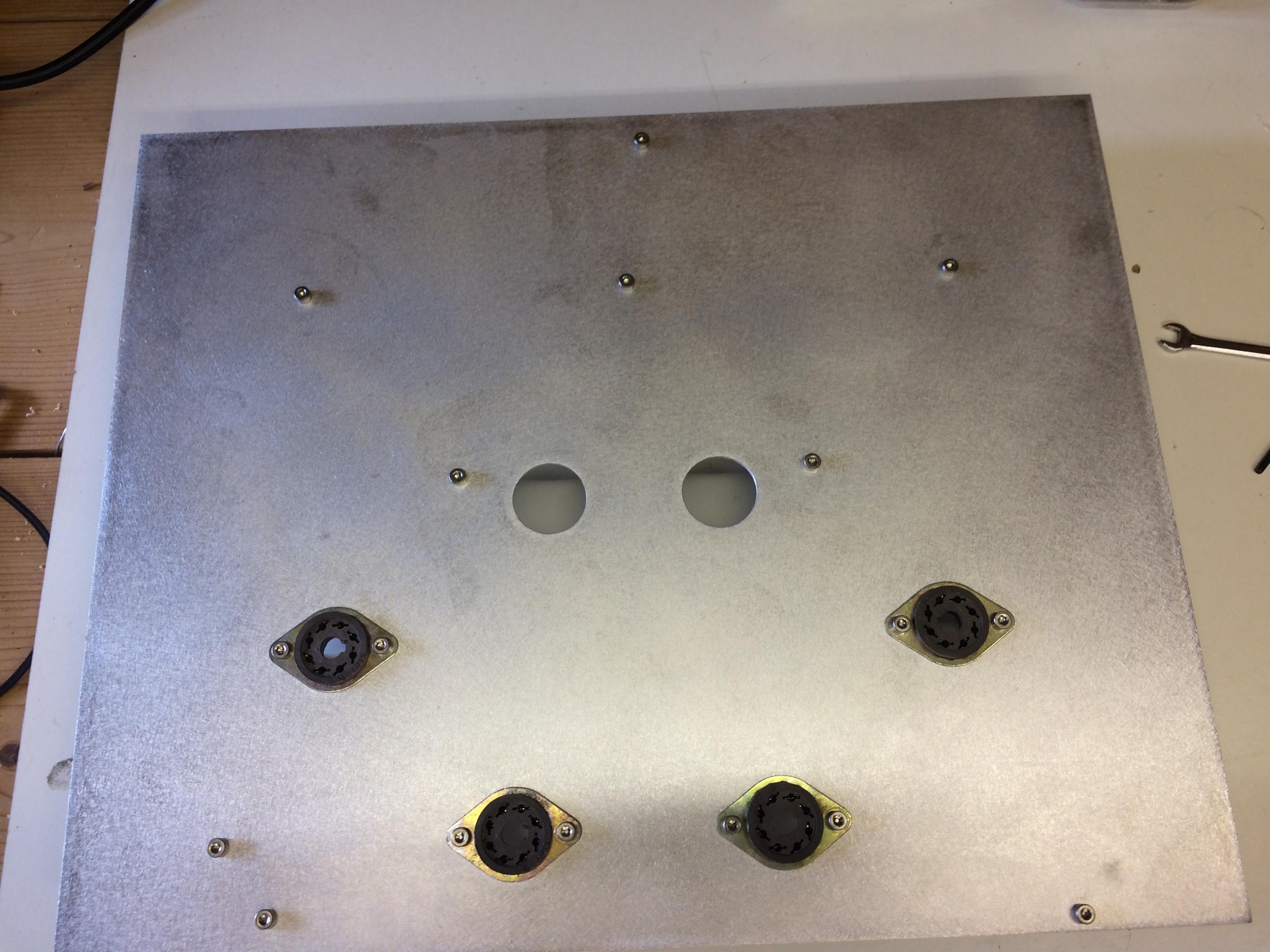

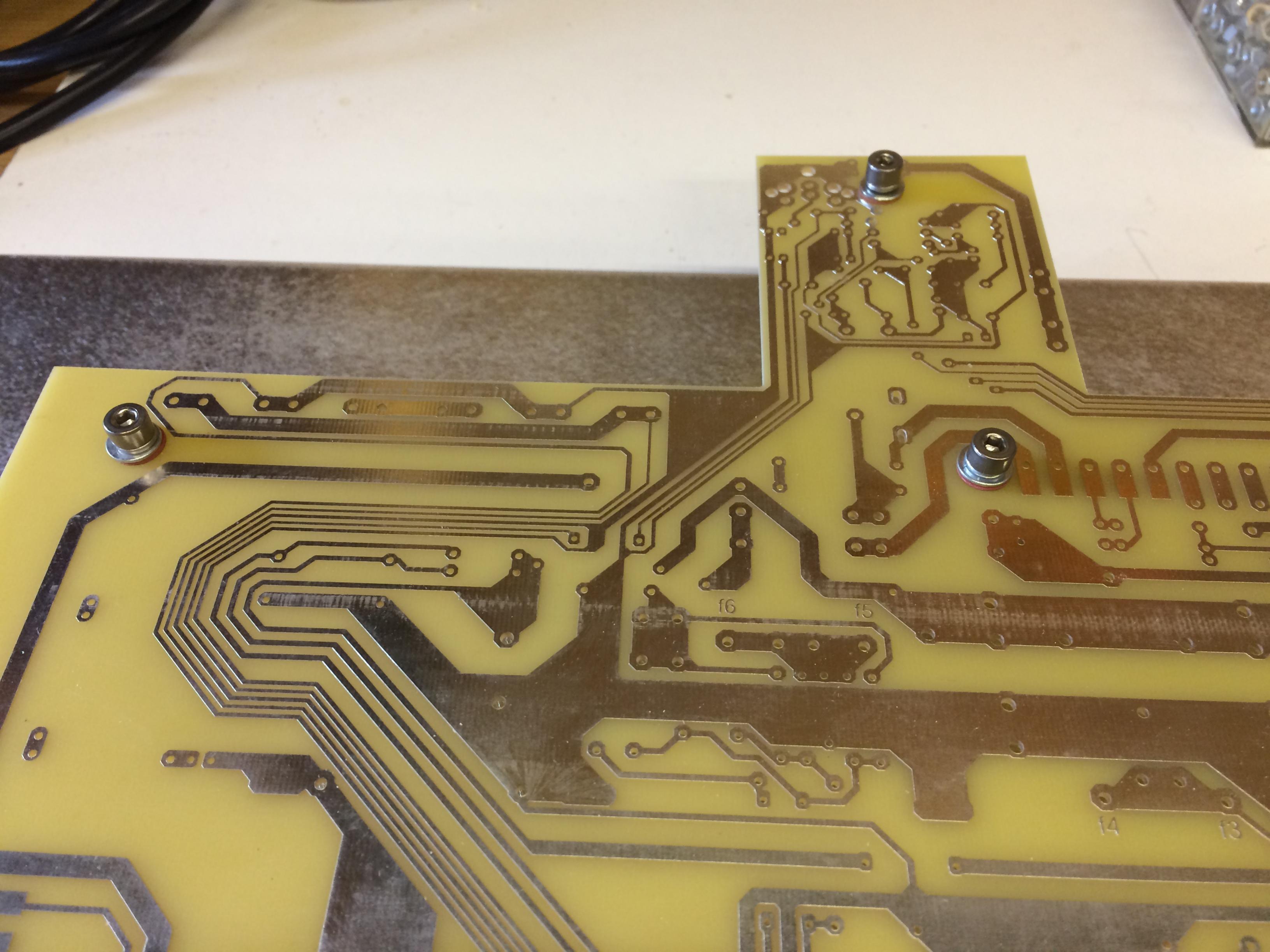

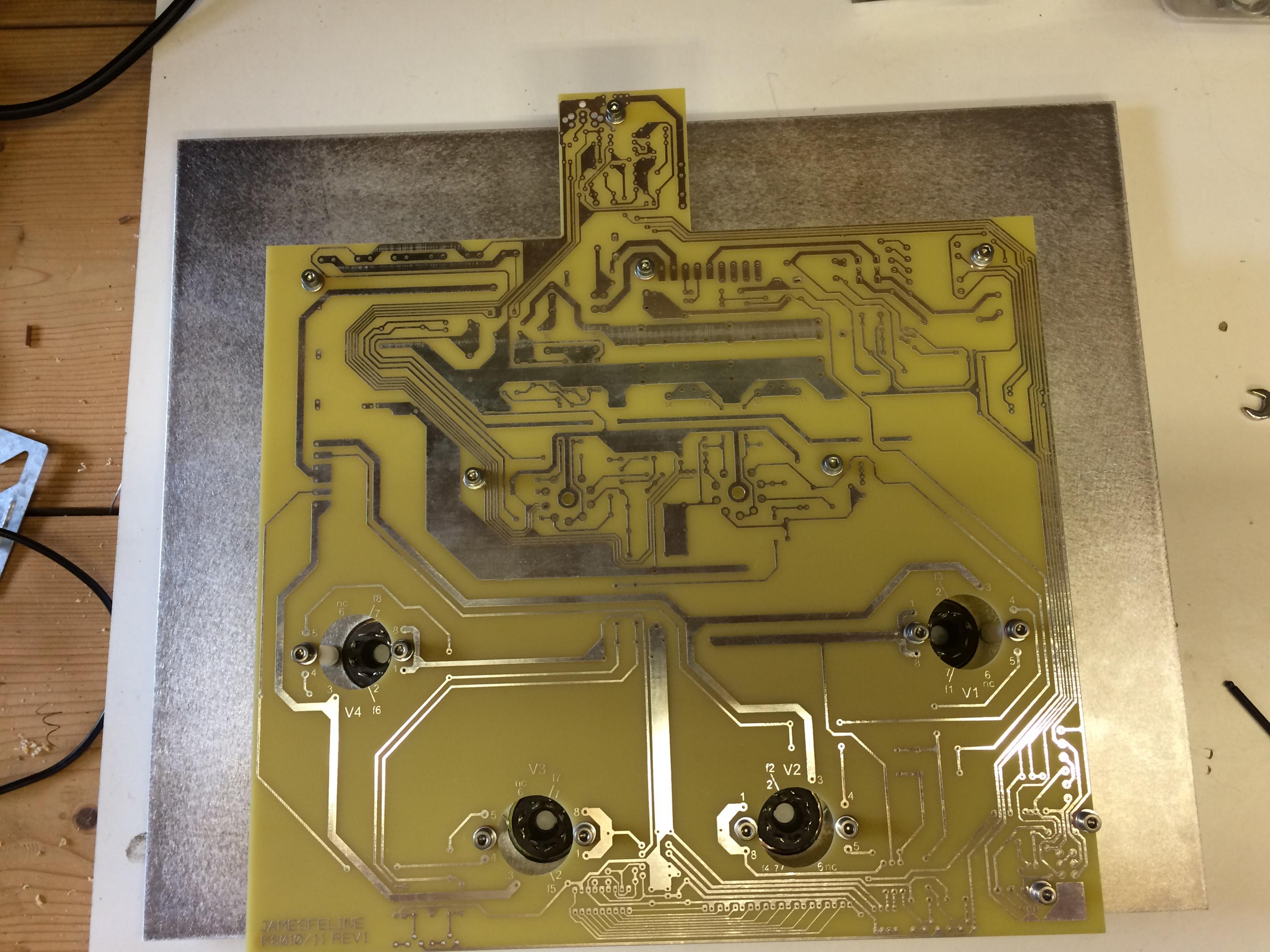

so the next pictures will hopefully speak for themselves as this is work in progress, please feel free to add any constructive ideas on the way through the build process. So currently this is just the internal chassis plate being fabricated .. and the valves will be on show in the completed project, so I am working this as I go along :scratch2:

You are doing great work. Trouble with that is that you are copying an old design that had flaws. Adding a bias servo would be a good idea as your using toroidal output transformers. Maybe forget the input stage design and design your own?
Lovely work but just copying an old design won't bring much comment if any. Make it your own.
Cheers
Matt.
Hi Matt ... good feedback, the design is old but all who listen to it really like it including me .. but I do have some improvements planned.
Like choke supply and some mods to the input and heater supply .. the transformers are now a new design with the output transformers will be by sowter ... some of the component values are now different based on my experiments.
But I enjoy making them .. so that,s the main thing I suppose ... 🙂
