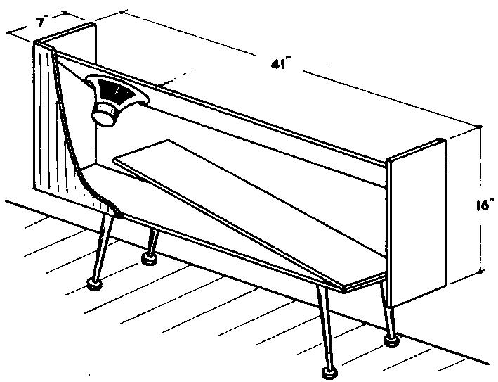

Those Paralines are very similar in many ways to a BIB. If the vent CSA is reduced slightly over the line terminus CSA so they're mildly mass-loaded, that should help prevent HF leakage through the cabinet. Most interesting. Pity they'd take up a fair bit of floor-space as-is, but I think I've got a way around that. The latest plot takes shape...
Scott
Scott,
have found pictures of the BIB design, they are similar in shape, and presumably in effect.
The Paralines were usually stood on end to reduce floor space. The driver is then at a reasonable height.
The triangular TQWP (second post on this thread) was my attempt to update the Paraline technology. That version is not the best implementation. I am tempted to have another go at it. It would need Martin's new worksheets, and the construction method of the Egg, to be worthwhile. The drawback - to my simple mind - is the volume of the cabinet. Can all that air (34 litres) start and stop moving suddenly enough to reproduce large transients.
Is the above nonsense? Would MJK be able to tell us how it does or doesn't? In words without any equations, is how I define "tell".

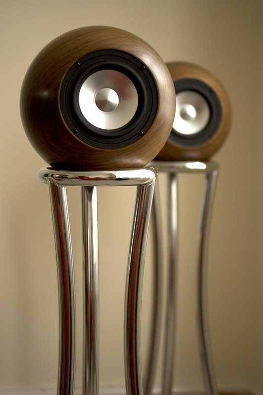

Just noticed your post ! I developed the Highballs - the wooden round enclosures, but I'm not a manufacturer as Colin thought, just a hobbyist trained in product design.
I had the enclosures turned by a production turner out of solid blocks of American Black Walnut, they have walls just over an inch thick.
In answer to your question they sound lovely, detailed, good imaging, but they need support from a sub woofer if you like listening to bass heavy music. Can be bright if partnered with more modern receivers, which in my opinion are mixed deliberately to accentuate treble and bass. Good amplification with a flat response gets the best out of them.
My next cabinet was the Longballs based on a TL design. These don't need any supplementation for bass when listening to music they are fantastic !
Finally my next project is the MLTL 48's...
