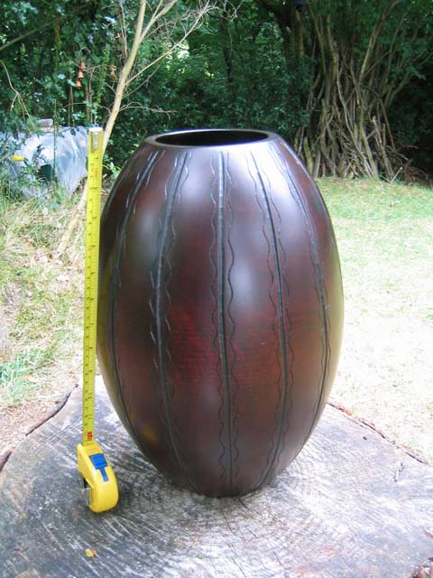

good point - the el pipe-o reference was for general info on the sonotubes rather than anything else.
for wood vases, this is the sort of thing I had in mind. try typing 'mango wood vases' into google. the disadvantage is that you seem to have to order them in batches - unusual group buy anyone?
Pic attached of the pair I have. requires the mouth to be cut down and widened, then a baffle attached. by that stage the volume will be bang on 8 litres.

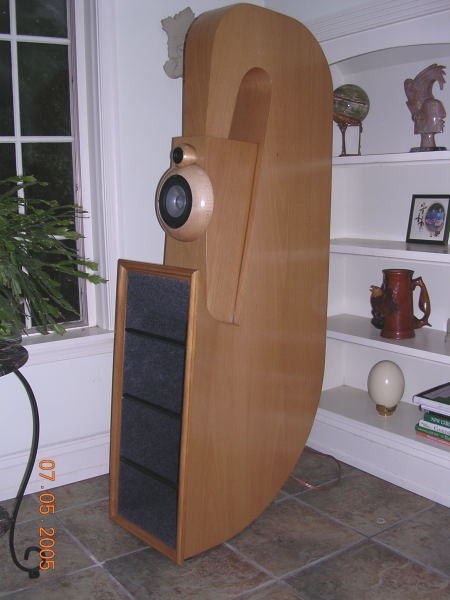

PJN said:This is what I built for my jordans, I used a circular baffle to get the benifits that a sphere gives you for diffraction. I had to make them on a lathe. The sound is excellent, very clear and detailed, it sounds very real.
Very, very impressive. Not sure it gets my dear-lady-wife's approval. Shame.
Wonder If I can put some of it in the cellar? That would solve part of the problem!
Have you been able to measure how deep they go?
Andy
