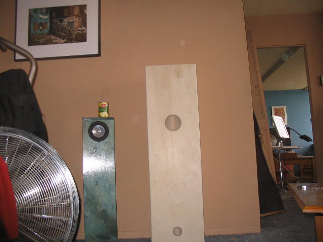

Got my camera to work briefly. The Blue speaker is an Alpha line.
Sounds good with baffle step comp. The other is MLTL triangle taken
off Jordan site. Front baffle extends an additional 4". Interior size the
same. I'm in no rush to finish as I do like the alpha with the equalization.

Colin said:Let us know how they compare when you finish the triangle.
How low does the Alphaline design go?
I don't have a way to measure but as I remember in the AE article F3 was 45hz.
Also the article stated that the Bass coming out the port of shorter pipe was louder
than a big fat pipe....To my ears I think I'm hearing that 45hz loud & clear.

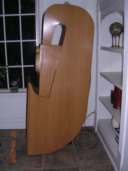

Jordan JX92S with TUBA horn
I need the map of Jordan JX92S with TUBA horn detail,
Can Who give me ! thanks very much!

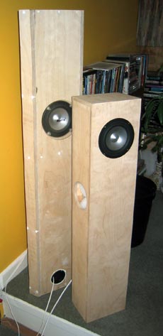

I mentioned earlier in this thread that I had an Auguspurger line on the go for the JX92. I finally finished it over Easter and have had it running for 24 hours. His tables for the coupled cavity TL give a compact line tuned to 70Hz with an overall enclosure volume of around 11 litres. It makes for a compact, floor-stander which tucks away into corners.
The sound isn't too bad. All the JX92 strengths are there, with clear sound, lots of detail and terrific imaging. It doesn't go as deep as the 48" MLTLs. It reaches 60Hz and then tails off. There is plenty of body in what bass there is. In fact, there is a little bit too much body as it sounds 'loud' on voices, which makes me suspect there's a resonance I need to tune out. I've only done a first stuff with the wadding, so no experimentation yet.
I built this out of curiosity more than anything else. It makes a neat box for use with a sub and it doesn't require a stand. I specifically wanted to try something I could shove away in corners and augment with a separate bass. At the moment, they're standing in the middle of the room and I don't feel they require any BSC, though I'll play with that later in the week to see what happens.
Ironically, the cabinet has come out about the same size as the smaller, 31" MLTL, although that needs a stand to get the driver up to ear height.
Pic attached, next to the MLTL.

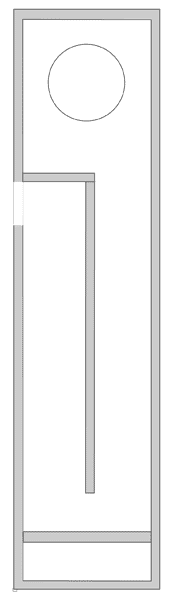

Hi..Do you have a drawing of the inside? Looks neat with the port on the side. You might find these scary with a baffle step..

Colin said:In fact, there is a little bit too much body as it sounds 'loud' on voices, which makes me suspect there's a resonance I need to tune out.
Male voice "boom" or female voice screeching?
Difficult to know whether this is a new species of speaker cabinet, or just a very large port!
Is this the optimal size , or is there a range of possibles for the design?

The design uses alignment tables so you put in the parameters and out pops an optimised design (length, volume and size of coupling cavity. The hole in the side is the line exit, rather than a port as such. I cut it round to fit a piece of trim I can use.
For anyone interested, the details are:
line length - 37.8"
line tuned to 90Hz
f3 = 72Hz
Vp = 11.32 litres
Cavity is recommended as one third total volume, so cavity is 3.8L, line is 7.6L. I've allowed an extra 0.4L in the cavity for the driver volume. Area of line works out at 12.18 ins^2.
Other dimensions you can adjust to suit - if you want a wider cabinet, for instance.
My only doubt about my build is that I took the line length to mean the overall length of the line part of the enclosure, with the cavity sitting on top of that. Arguably that has given a total line length of 48" but on the other hand it means the line cross-section stays smaller and there's a clearer demarcation between line and cavity.
The slight shout is most evident on male speaking voices and I think I need to adjust the filling in the cavity, which is probably too light. I'm also comparing to the triangular MLTLs, which has no reflective internal surfaces, whereas this box is rectangular.
There are also alignment tables for a tapered line (no cavity) and off-set design (driver roughly 1/5 down a narrower line). Previous experiment with an offset line didn't work too well (not enough space behind the drivers so the sound was very thin) but the tapered one looks promising and gives a slightly smaller cabinet.
