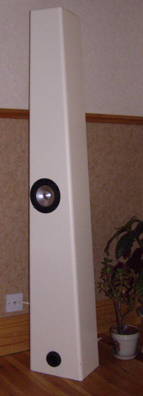

The first is the "obvious" MLTQWP from M J King's excellent calculations. It is rather "shouty" - too many sharp peaks in the response, and made from 18mm MDF.

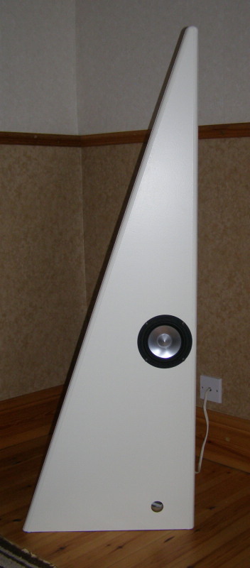

The next is from MJK's calculations again - this time an extreme version of the MLTQWP format. The bass is big and low, not too badly controlled, but the top end is not well served by the large front face. Triangular is a very good baffle shape. Smooth "step" transition because of the huge number of different distances to an edge.

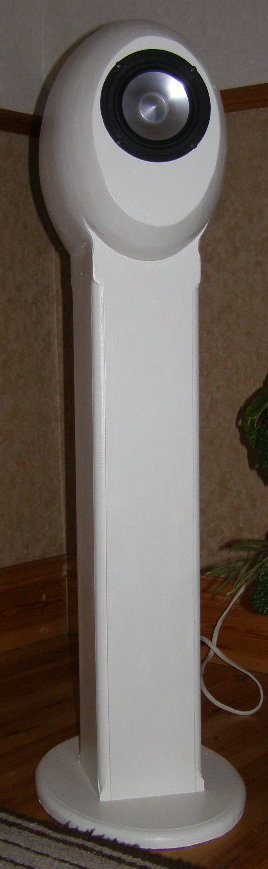

The KEF egg surround speakers were favourably commented on by my dear-lady-wife, so an egg design was produced.
One of the problems of the previous cabinets was that there was too much bass for the room (nominally 15' x 12' x 9'). The slight lift just before roll-off was hitting a room resonance and.... BOOMING.
This design is in a cabinet of about 8 litres as recommended. The port is a piece of plastic waste with internal diameter of 50mm, and length 250mm. This size is calculated as correct by various web-site offerings (I am very grateful to all of them).
The cabinet is made from 18mm chipboard. I became frustrated and bored with trying to get a perfect shape and perfect finish, so did a reasonable job and put on a few coats of paint.
How it sounds is more important. No microphone/sound card yet, so SigJenny (http://www.natch.co.uk/) and a pair of ears must suffice.
Meaningful sound output level starts at note 1 C (32Hz). At 7 D (2500Hz) there is an unpleasant peak. this coincides with the peak predicted by The Edge (http://www.tolvan.com/edge), but to my ears is more pronounced than that. Continuing up the scale produces a series of small peaks until something (my ears or the soundcard) fail at about 13kHz.
With BSD correction optimised it sounds good. Top end very detailed - as you would expect from this driver, bass moderately well controlled, goes well down to give a good impression of the fundamental at a believable level. It can shake the floor.

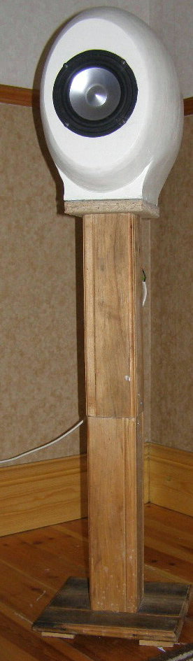

The success of the first Egg made the next decision easier - it was the candidate to be cloned. In the spirit of DIY experiment, it is made of MDF. It also has an integral stand, and looks a bit silly. It has a 38mm diameter port, 150mm long.
It too starts at 34Hz. After reading a Port Tuning thread (http://www.diyaudio.com/forums/showthread.php?s=&threadid=96481), I explored the subject. This narrow port is blowing plenty of air around - I can feel the draft on my face 250mm away. Similar peak at about 2500Hz.
Despite the differences, these two perform much the same; even so stereo imaging is not completely secure.

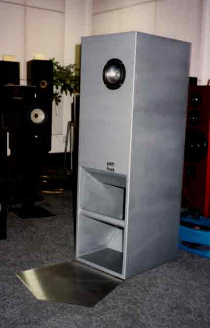

Horst,
not forgotten; my dear-lady-wife is not enthusiastic about something quite so large.
I have wanted to build a horn for a long time, the Tuba tempted me at one time, but ...
The graphs look good, and the transient response is excellent, so maybe I shall build them if I move to a house where they would look better.
Andy

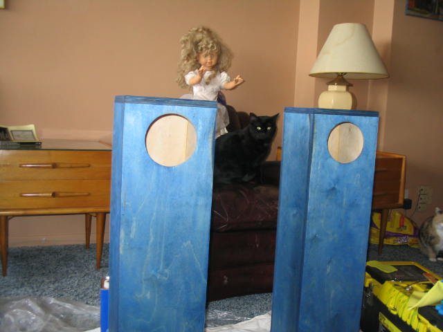

RAndyB said:
Colin,
I recall your triangular MLTL design. Did you post a picture of them finished?
Ha ha, still gloriously unfinished in appearance. Partly because I can't bring myself to dismantle and finish. I also think I made a couple of compromises with them so am waiting for the fine weather again to work up a second pair.
Come on, global warming, hurry up.

What don't you like about what you did? I have mine ready for the finish & mounting. It has a 36 cm baffle. The speakers use 19mm baltic birch. It has two ? braces, one just below the driver another about 1/3 up from bottom.
Lucius
I built mine before the sizes were on the Jordan site and got the cross sectional area of the triangle slightly out. It's not by much but as I think I can build and finish better next time, these remain in 'prototype' status.
I have another set of enclosures for the JX92 - based on the Augspurger TL tables - which are nearly finished. Using them will encourage me to redo the triangles.

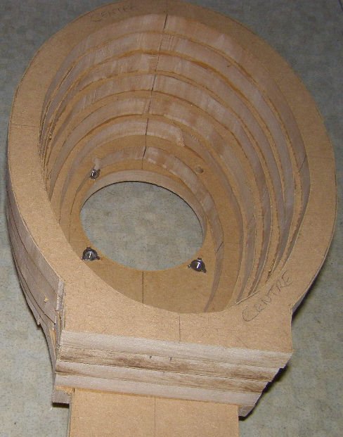

Colin,
whilst doing a mind-numbingly boring domestic DIY task, I thought of making a cylindrical TL. No bracing needed, because no panels. Just (!) cut lots of rings and glue them together, then do an outcrop at the top to mount the driver, similarly something for the port.
Wonder what baffle step compensation would be required.
Andy

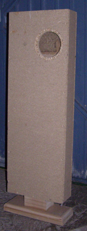

Drats! I can't get my camera to download pics of finished alpha & the new MLTL.
Inside dimensions of the alpha are 7" x 7" x 32". I think the plans are on Planet 10's
site. They seem to play low enough. Untill I trouble shoot or just shoot my camera here's
a pic takem last summer during the finishing.
Lucius
External sizes are similar to the Augusperger line I've built. What LF do they go to?
Andy - if going for a cylinder, have a look at using cardboard tubes. Paper manufacturers have offcuts of the cylinders used in the centre of the large rolls. Very robust, up to six foot lengths and available with internal diameters of around 4"-8". Easier to get than the fabled Sonotubes and, best of all, usually free. (Schools gobble 'em up for art projects and the manufacturers just chuck 'em anyway.)
Cardboard tubes had crossed my mind. I have one lurking somewhere with the end of a roll of newsprint round it. Presumably, getting the right internal diameter is the main hurdle. Must search for problems such as transparency, and for workable solutions.
Andy
