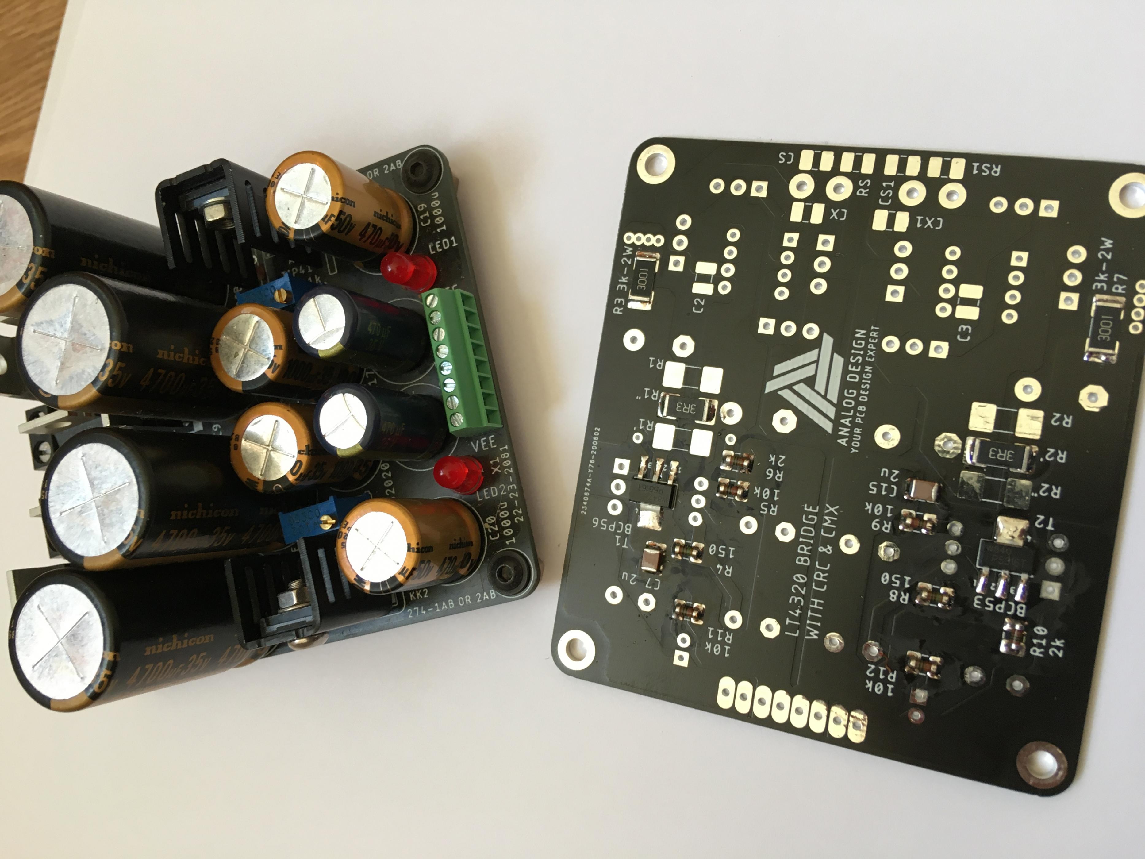

I am interested in this pcb. A couple of days ago I have seen it on PC way site offered for purchase.Yes, its a 15mm pitch alright, plus now I have put some options for 5mm and 10mm just in case someone wants to use something else.
you can order boards yourself. attached are the gerbs and stuffing guide , also pdfs in case someone wants to etch at home.
Let me know if you have any problems with boardhouse with these gerbers, I can clarify / use older method. I have now moved over to eagle 9.0.0, pcbway didnt like those 9.0.0 gerbers initially. Now its settled with them 😉.
Top plane is a ground plane thats only connected at output.
regards
Prasi
edit: logos are on the bottom silk, so don't affect the functionality or beauty of top silk😀

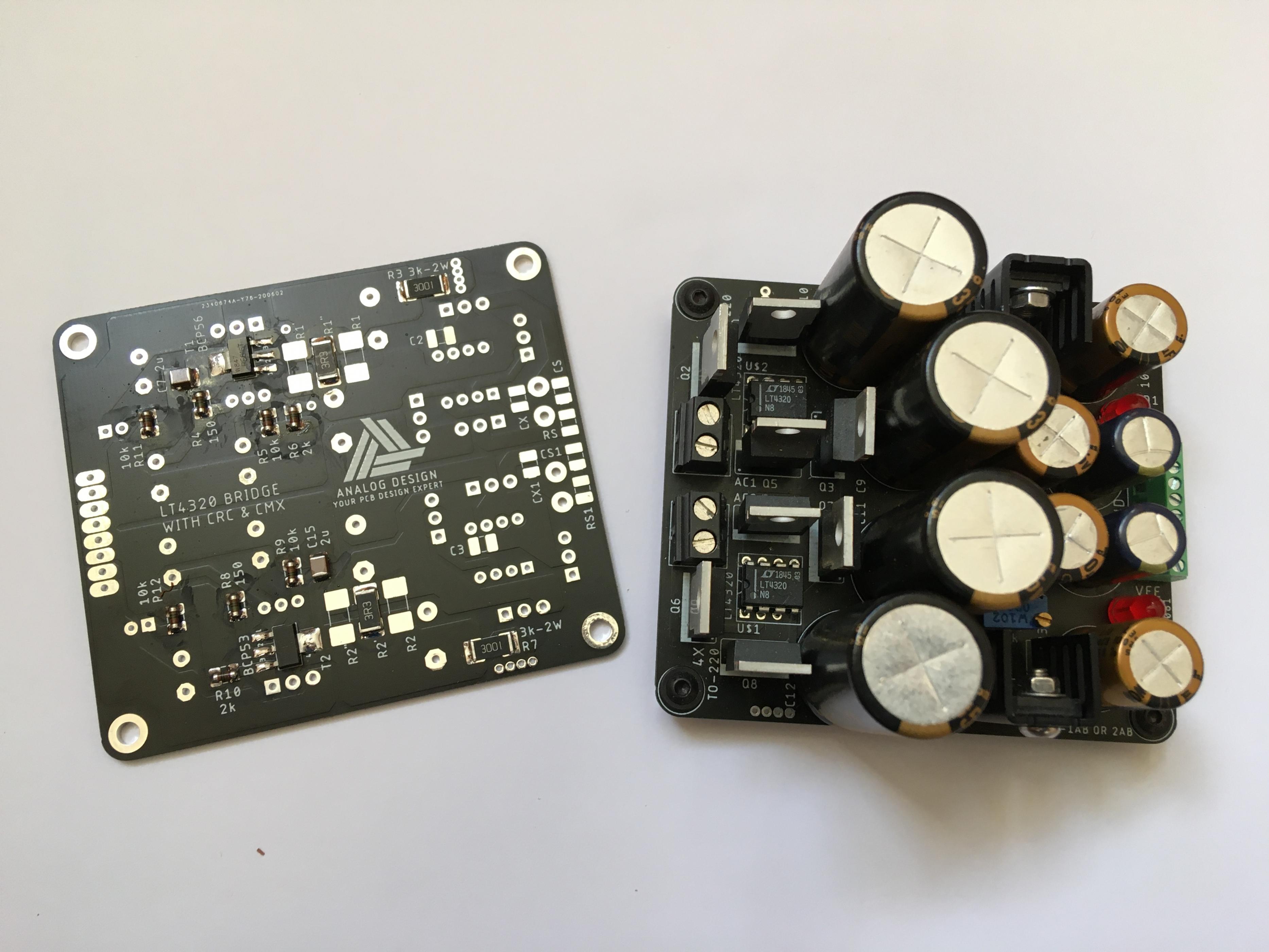

Here is additional info.
Can somebody say whether that board is the most recent or there is a new version available elsewhere?
the one on PCBway is with on board rectifiers.
The quoted post is without rectifiers. (external chasis mount rectifiers)
both are good.
both are good.

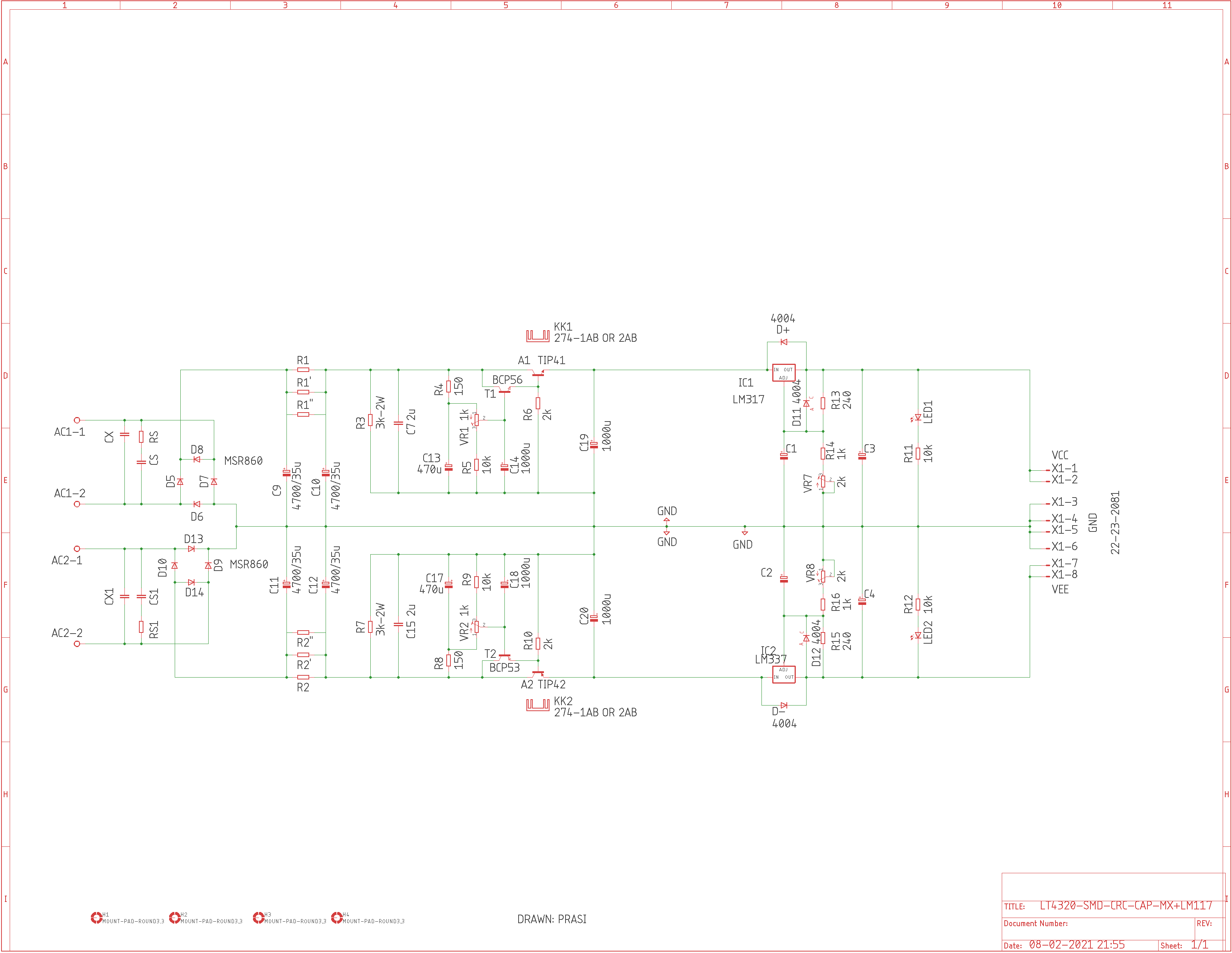

Prasi is kindly helping me design a CRC->MX PCB with an adjustable regulator circuit on the end, quite simply a tracking pre-reg circuit with the MX as pre regulator and the LMXX7 adjustable section on the output.
My question is - in the schematic attached below, is there any need for the original VR1 & VR2 1K trimmers? Can these be replaced by fixed resistor or just omit all together.
Normally, the 1K trimmers only adjust by a volt or so to fine tune the rails. Maybe this will still be useful.
Thinking about it - the MX section can be trimmed first before VR7 & 8 are installed, then install the other trimmers for final voltage adjustment but having four expensive trimmers seems a bit much.
It would be nice to remove VR1 & 2 entirely.

re: post #814 schematic
It's surprising that you've chosen diodes (MSR860) which are only available in thru-hole packages, while at the same time using bipolar transistors (BCP53, BCP56) which are only available in surface mount packages. Since the big electrolytic capacitors are definitely going to be thru-hole, and so are the discrete power transistors + heatsinks, there's no question: you WILL have several thru hole parts on the board. Given that, why also select the surface mounted BCP53? Does it have characteristics & properties that are simply unavailable in thru hole parts?
Curiously, R1-double-prime and R2-double-prime do not have "solder dots" on that schematic. Is this anything to be concerned about?
Vunce and Mark, thank you for the replies boys.
Vunce - good to know, that's what I wanted, we'll leave them in. Yes, hopefully a nice PSU, this was born out of a previous design Prasi did. See below.
Good idea on the redundant pads.
Mark - the MSR860's were just used by Prasi to construct the circuit, I may ask for D041 parts but initially this was born out of an idea I had to incorporate the LT4320 bridge with the SMD MX circuit, I wanted a higher power version of the mini SMD board on here. See pics below.
The circuit is LT4320->CRC->MX which works fantastically, lovely supply with very low dropout. Unfortunately the built supply in the pic cost around £70! Waaayyy too expensive. But a nice design.
So I wanted the mid power SMD design with a more reasonable bridge and more adjustability. The BCP transistors were inherited from the SMD design but uprated to SOT223-3 packages.
Not sure about the R1/R2 solder dots, will inform Prasi.

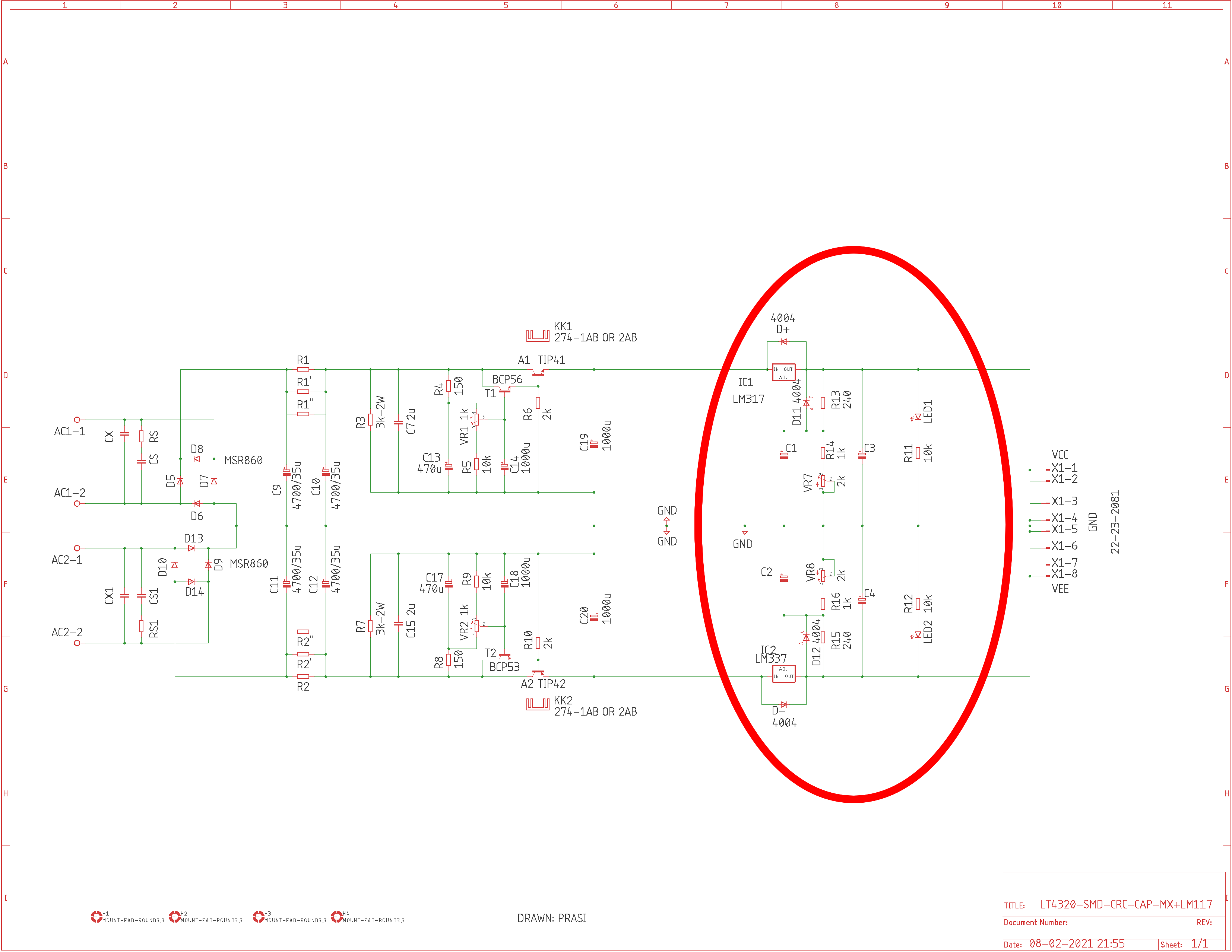

I'm looking for a -+12V and -+5V dual rail PS and I really like the "Nice 4 cap Mx on 100mm square PCB by Prasi" in the first post *but* I want to have tight regulation (I'm feeding dac chips).
There are a million different designs in this thread so if I missed the one fitting my needs I apologize 🙂
I was wondering if I could just 'paste' the LMXX7 regulator part from passive420's design in post 814 on the output of Prasi's design. (see attached pic)
There's some discussion here about if adding a regulator after the Cx is a good idea and I didn't see a real answer to this.
This, Simple Cap-Mx Regulated Low-Noise PSU, looks good but like I mentioned, I also need negative rails.

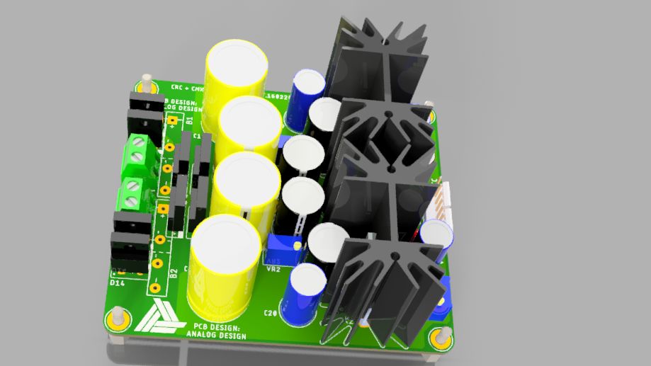

Cool Jazz, the boards with extra LM reg section have been ordered, I'll let you have a couple when they arrive.
They have option for the SMD LT4320 bridge PCB's as well as TO-220 diodes. These will be excellent supplies I think.
Awesome work by Prasi.
