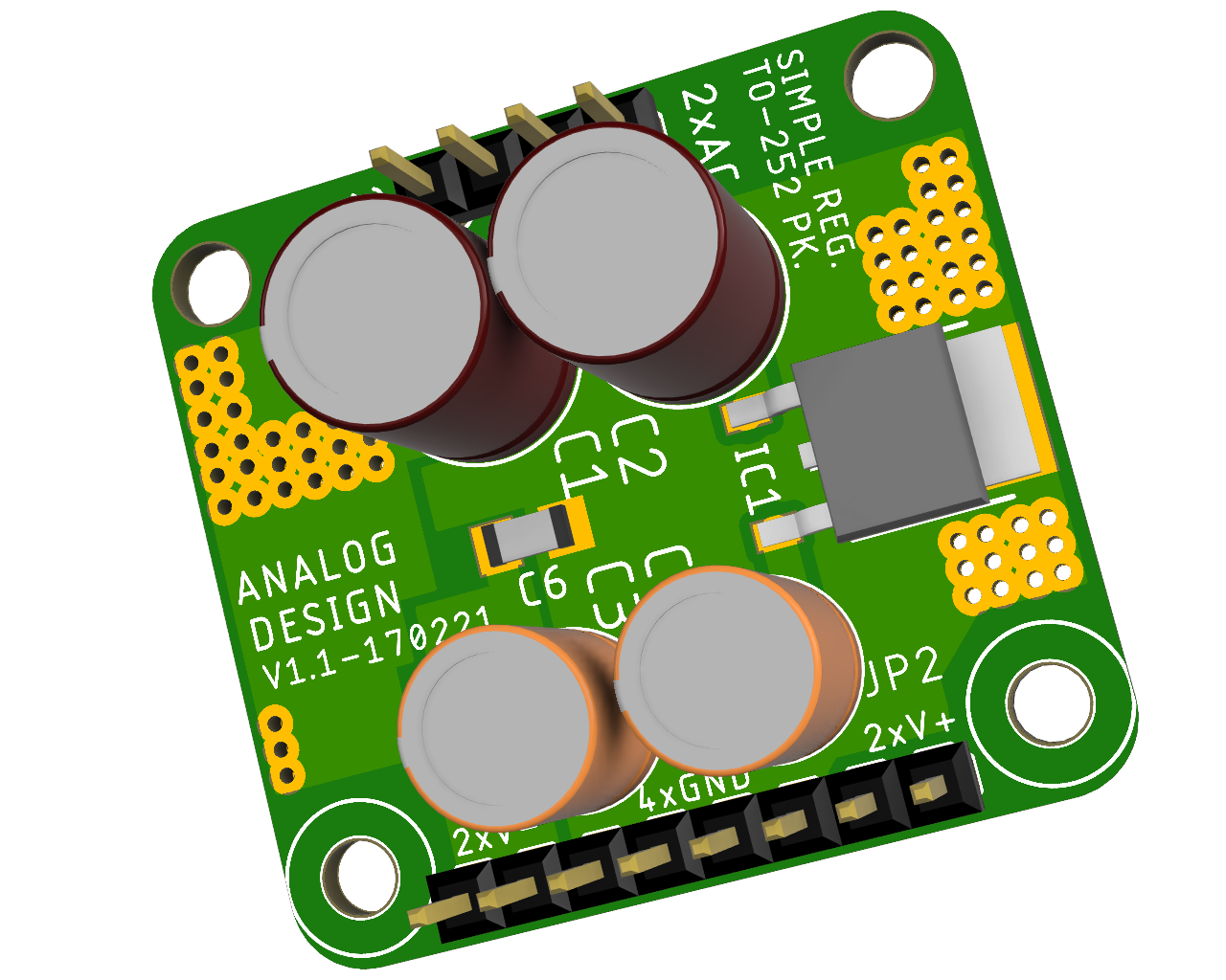

For dual 5V supplies , Prasi designed some nice little SMD boards with 500mA 78XX/79XX regs. All in one with bridge rectifiers. I wanted these to run a Muses volume and buffer boards direct from an AC winding.
Around 30 x 30mm

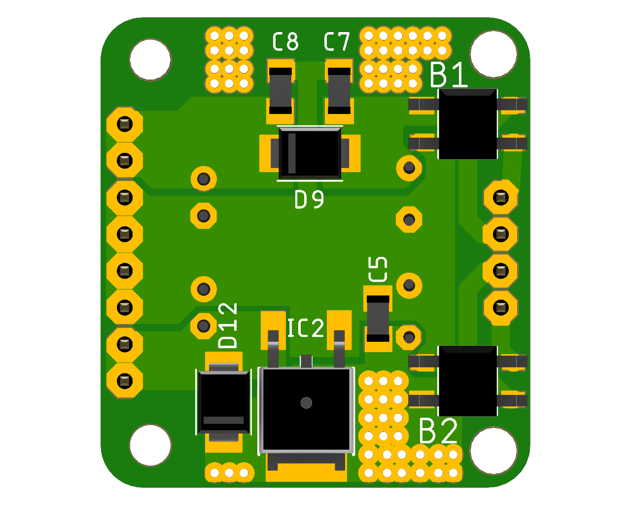

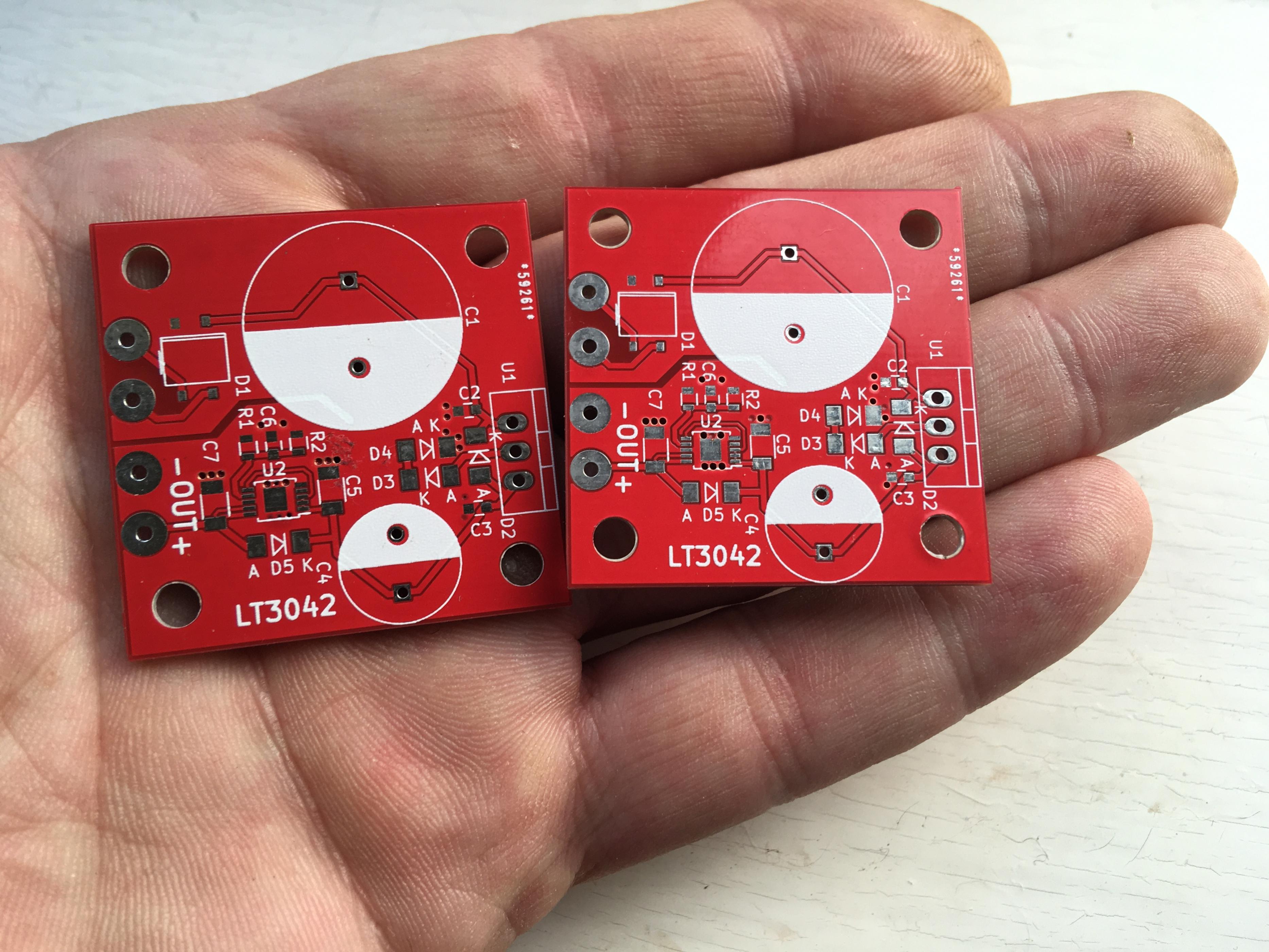

Cool jazz, i have you covered for the 5V USB supply, these little SMD LT3042 supply boards are spare, they are 35 x 35mm and 200mA output.
Schematic is to the datasheet. I'll send a couple with the other boards soon.

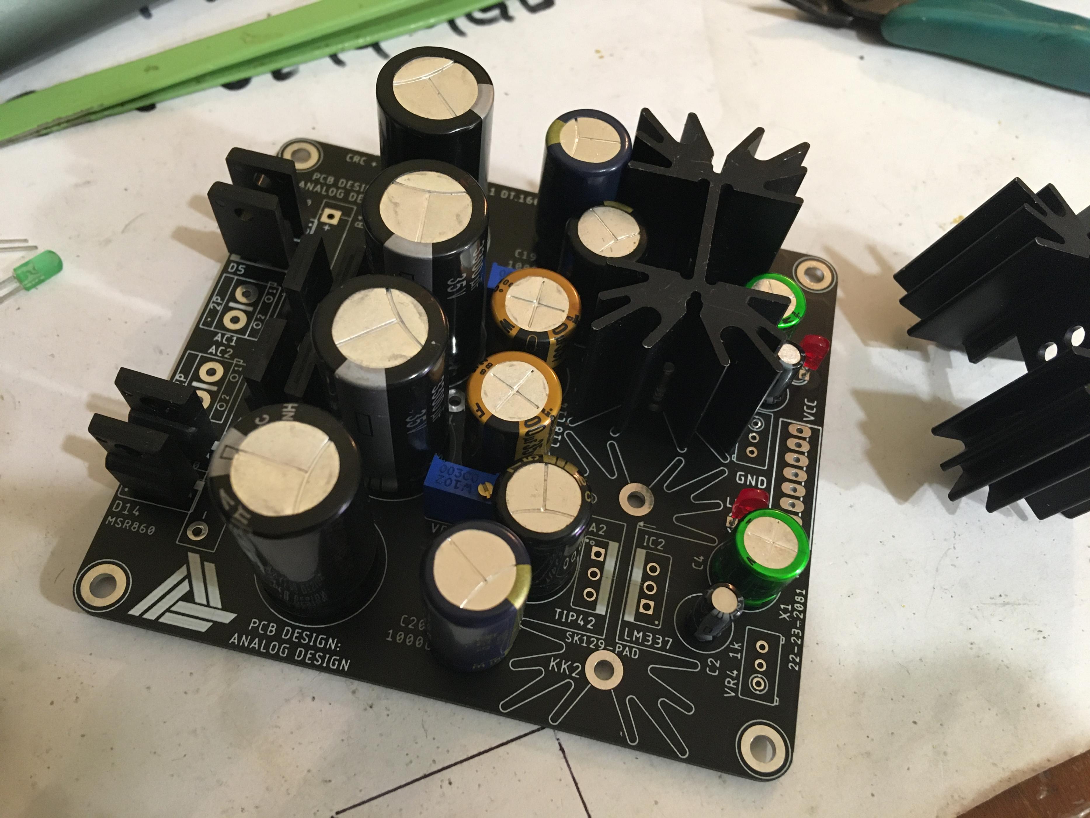

The new boards with regulators after the MX section are here. These now have option for TO-220 diodes or LT4320 SMD bridge PCB's. All resistors are SMD under PCB.
I think the procedure for these will be to build and trim the MX section first, then fit regs and finish adjustment. Retrospectively thinking, some test points for the MX section would be good.

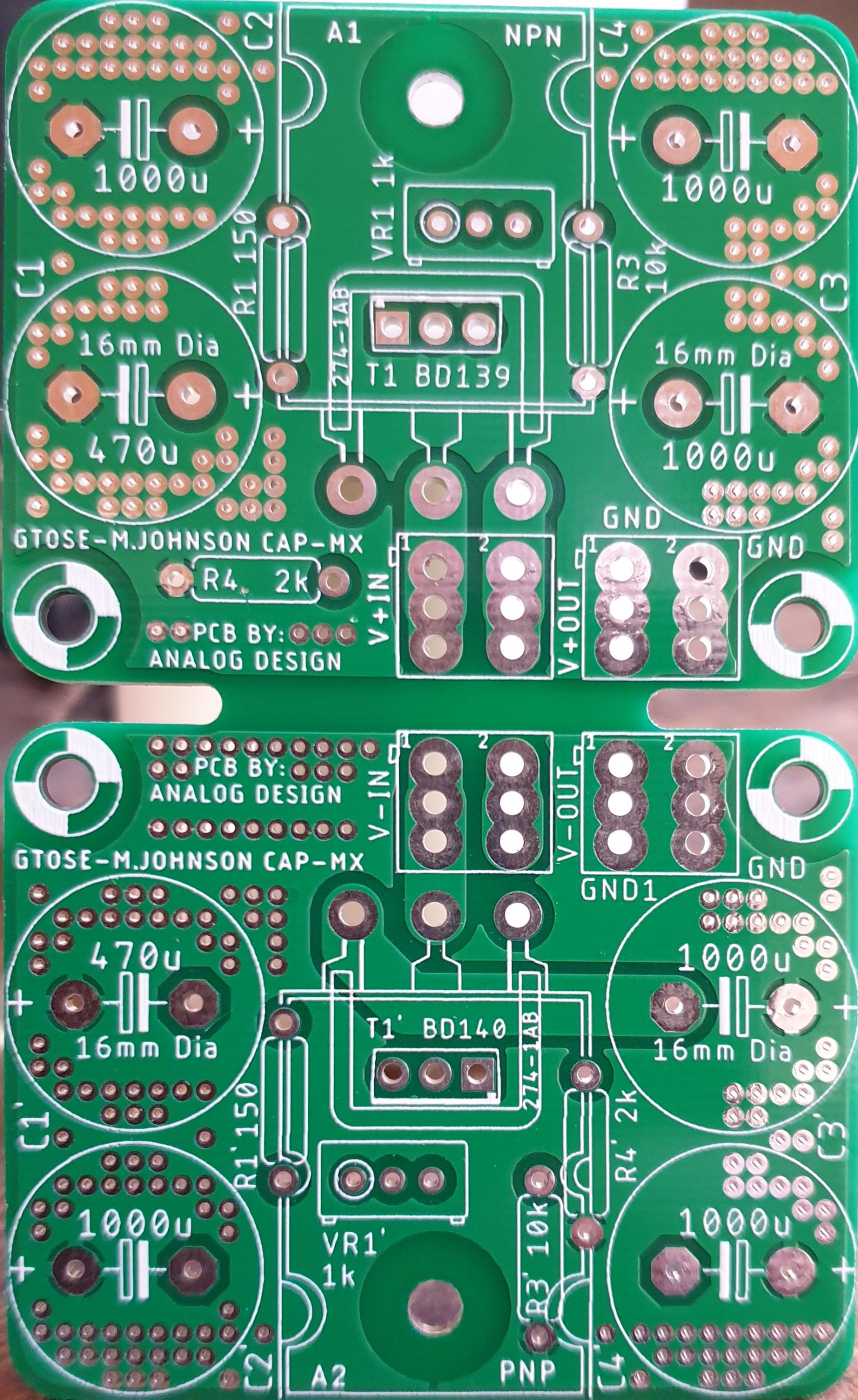

Hi guys.
I've been trying to find these boards on various threads but to no avail so I hope you don't mind my asking here. Seems to be the place!
I got this board off a member here ( hello Rich!) and was wanting to read up a bit about it. I've sussed out the A1 and A2. Can I just stuff this board as per the silkscreen values?
I see most capmx on here have 10 to 30mF whereas this has a lot less.
What is the voltage drop from this board? Can someone link me to the process for setting the VR? What does this do exactly. I think I've read it adjusts the voltage drop and therefore the ripple reduction.? Or nothing like that at all.

Hi James, sorry should have given you more info, but your basically right.
This PCB is designed to go on the end of any rectified CRC supply - or between the caps for C->MX->C. You'll need a bit of filtering before these.
Stuff the board to the values - C2 1000uF is the multiplier cap with T1, so most important (can be higher uF), C1 sets the startup time with R4, the other two 1000uF are output caps so can be larger value.
T1 can be any BJT with pinout, TIP41/42, MJE ETC... higher hfe gain is better

I set the trimmers at around half the range to be safe, making sure both rails are balanced. Generally they are very stable. You will find they only have around 2V adjustment range.
I had one with around 4mV ripple and another around 7mV, only measured with DVM.

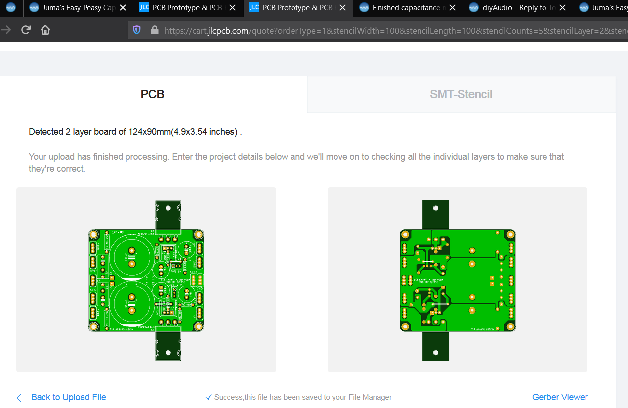

Not sure why you are having so many problems. I just went to post #512, downloaded the file there, and submitted to JLCPCB - and it accepted it no problem. The Gerber viewer shows the board correctly. I also uploaded it to Online Gerber Viewer and checked there and it works too.
So here is the link to the tested Gerber file: https://www.diyaudio.com/forums/att...plier-cap-mx-gtose-mjohnson_r1_2018-08-31-zip
You might try renaming the extension of the drill file from .txt to .drd and place in same directory - this is done in the attached file below and it works well in Gerber viewer.
I just uploaded the exact gerber file from your link to JLCPCB and it looks like the output transistors are being included as part of the PCB outline. JLCPCB is getting confused about the board outline and is including the output transistors as part of the outline and increasing the detected board size. It is detecting 124x90mm(4.9x3.54 inches).
I have enclosed a screen shot.

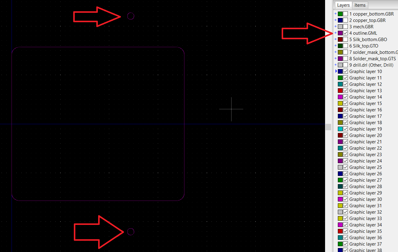

I just loaded the Gerber files in the KiCad gerber viewer and it does appear that the board is smaller than what JLCPCB is detecting. The output transistors along with two drill holes appear as part of the PCB area and then the PCB outline.
Any chance that the originator can upload a fixed version with the correct PCB outline in the edge cuts?
Edit: I have attached an image of the errors in the outline layer where you can see the outline extending beyond the PCB dimensions.
