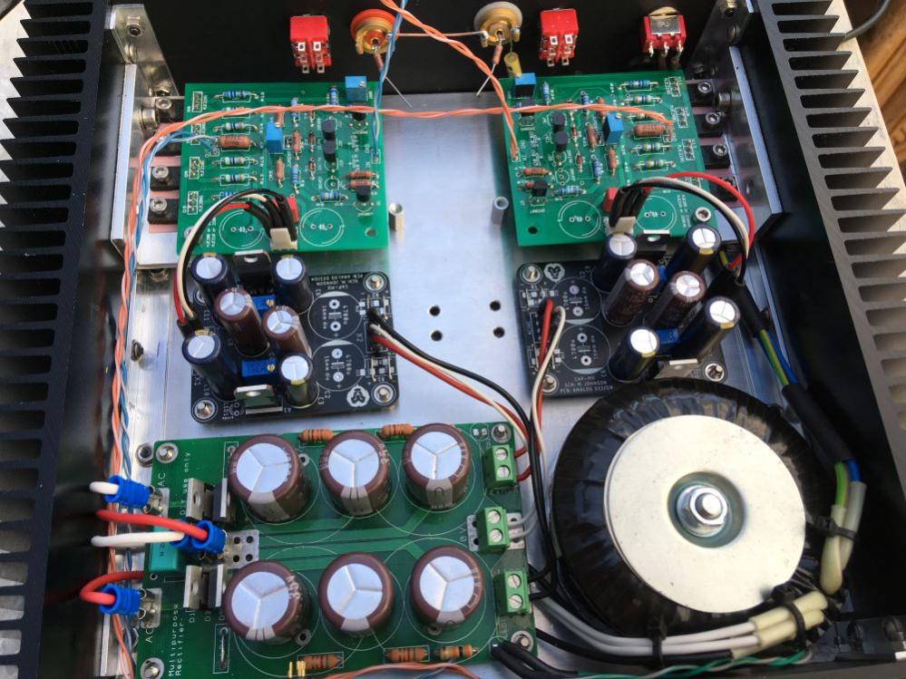

Here is a project that is using the SMD CapMX boards, A Marsh Head Amp.
The CRCRC rectifier board has been in a few jobs so it was nice to make it useful as it has decent fast/soft recovery diodes. I realise that we can make our own discreet bridge on the small MX boards with four small axial rectifiers, will try that sometime with the snubber circuit.
I have some questions -
Do I really need much extra rail decoupling on the Marsh boards when the MX modules have 1000uF on the output and are very close? Maybe simple 4.7uF films or such would suffice or just 100uF elco's.
Does the MX like a bit of impedance on the load, would a low impedance circuit make it unstable?
There is an MX board in my Whammy and the TIP41/42 seem to get hotter than I would imagine for the few volts that are dissipated, so I think the Whammy circuit is a bit low impedance for the MX. Maybe some R on the rail outputs would help.

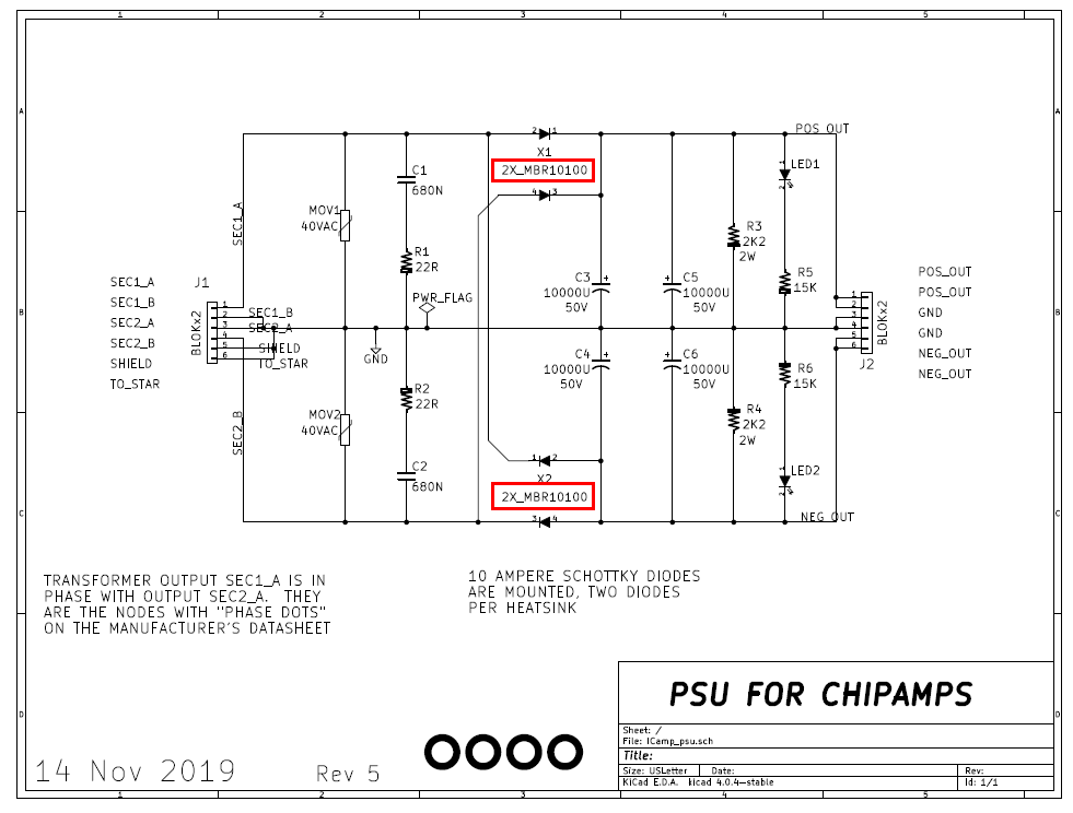

They do however give an extra half a volt of DC at no extra cost. If you're squandering away DC volts through the use of capacitance multipliers etc., it might be a welcome little boost.
Also as discussed in the PSU for Chipamps thread, thermal imaging shows that Schottkys run significantly cooler than standard diodes and WAY cooler than high-Vf soft recovery diodes. Why? Power = volts x amps ; and Schottkys drop significantly less volts. If the electrolytic capacitors are nearby, this reduction in heat dissipation & heat emission, lengthens capacitor life. What's not to like?
