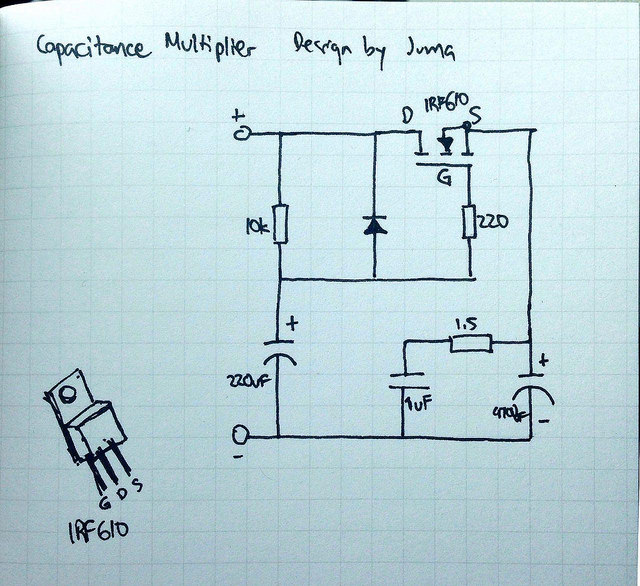

I've been thinking about using this cap multiplier along with a rail splitter to get a bipolar supply from a single SMPS and boost converter.
There are a couple of variations of the splitter here: Virtual Ground (A Regulated Rail Splitter)
My question is this: would it be better to split first and then have both +ve and -ve cap multipliers (plus CRC), or cap multiplier / CRC first followed by the splitter?
I had to use two SMPS - I don’t think you can do it with a single SMPS. Not sure how a rail splitter works. For a Class A amp the dissipation at 4 or 5 amps is kind of high - 20w. The high current draw on the DC-DC step up also seems to make it noisier. You can check out my attempt here:

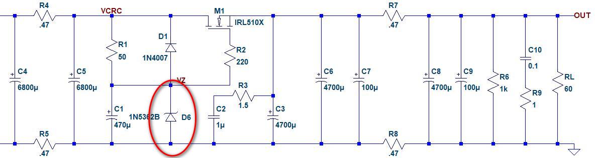

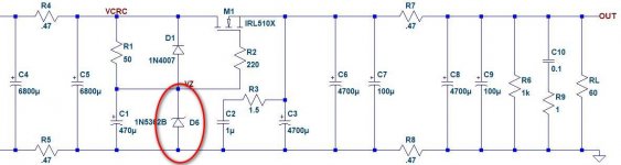

For Class A or Class AB, does the dynamic current jumps a lot when play a symphony of great dynamics? I sim Cap Mx in LTSpice, for a 60r load (say 400mA) to 30r load (say 1A), the output voltage goes down 3V without zener.
What about using higher rail voltages? Sure, you could implement higher rail voltages to the point where the rail voltage ripple is so far above the output waveform peaks that it doesn’t matter, but as output power levels increase you will encounter the exact same thing, so this won’t work.
The Cap multiplier circuit is a voltage follower filter that reduces ripple, output impedance, etc but goes up/down according to current demand of the application and the supply design.
By adding that Zenner to the base of the transistor (1N5862, 28volt, 5 watts?!) you've fixed the voltage of the output of the pass transistor (IRL510x) so it has been converted to a simple regulator and the voltage across the pass transistor and the incoming transformer/diode supply has to be increased to allow for dips in supply created by current variations.
Then you have added another C-R-C with 2 x 0.47R in series that defeats all the best properties of the follower/regulator but consumes lots of components - it may even sound okay but why do it this way in the first place

Adding a bypass will slightly improve C9 but is dependent on the particular properties of that C9 - usually, you'd increase the whole C-Mx by using better base voltage control, some feedback mechanism, etc, etc but it isn't then a simple Cap multiplier circuit
There are plenty of more highly developed Cap multiplier filters around to investigate both low and high current use - have a look at the K-multiplier site for some good explanations about filter operating techniques.
