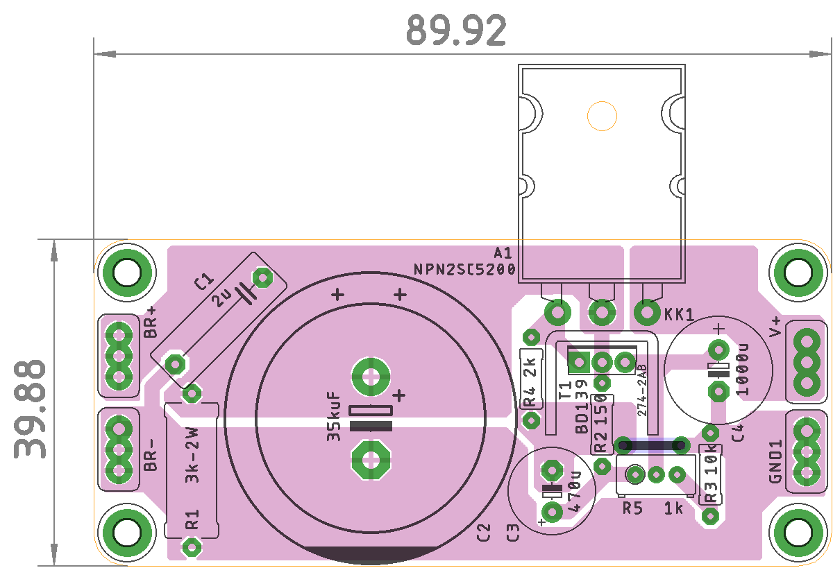

here is my attempt, single sided. Same as yours, but referenced the grounds to o/p. :)
regards

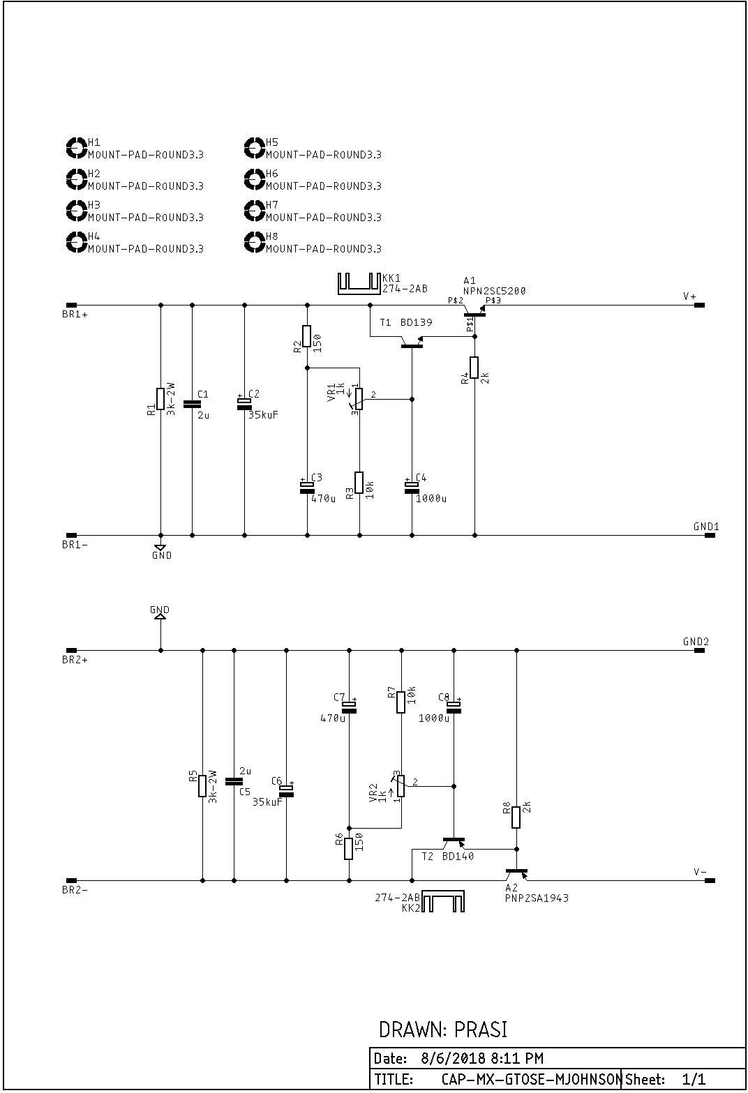

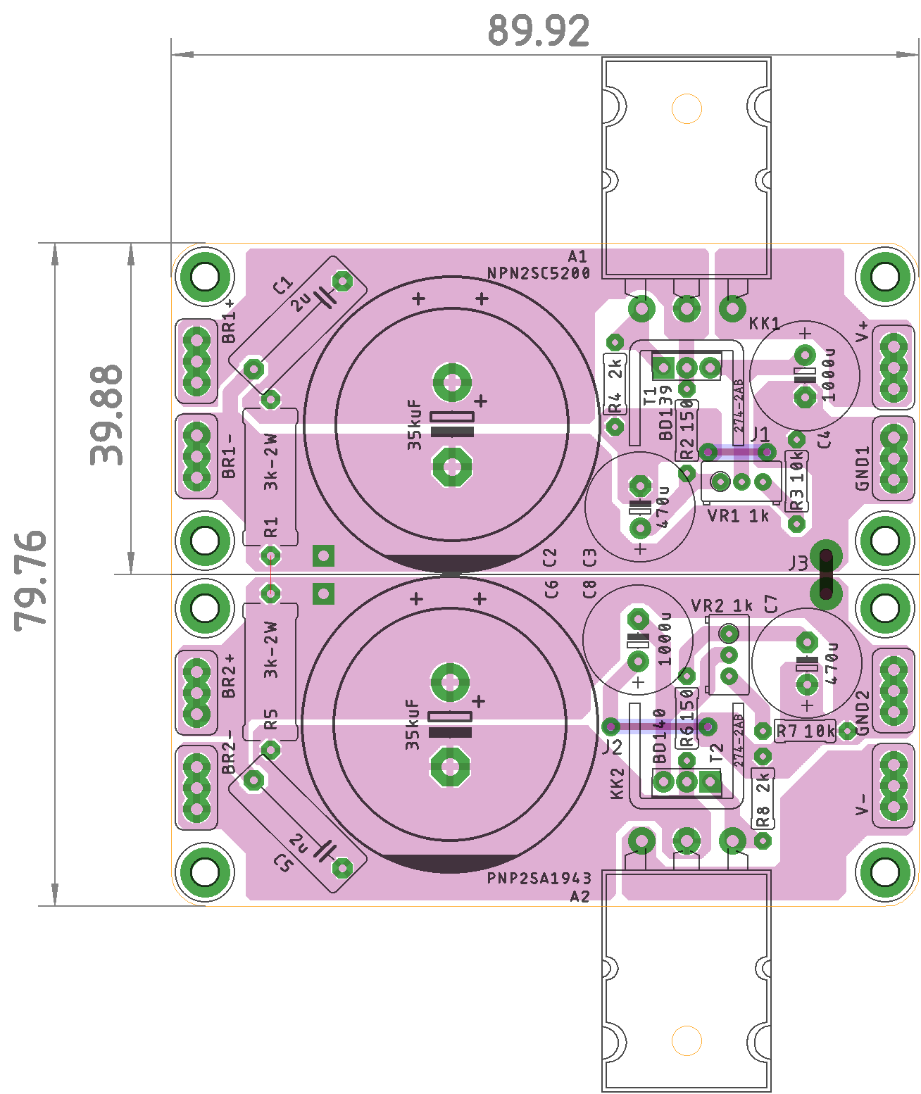

Here is the dual rail version with negative rail with PNP devices. Can someone take a look and suggest changes?
Rail grounds are separated. J3 can be used to connect gnds of + and - rails at the o/p. J1, J2 better jumpered from the bottom or use insulated wire.
If required, PCB can be cut right down the middle, to use + or the - rail :D
regards
Prasi

Great layout as usual Prasi! I’m guessing it took you an order of magnitude less time to compete than me, very impressive :). The layout of the transistors with an extra heatsink makes for nice and clean routing.
What do you mean by this? Does this refer to how the ground plane is routed vs mine?
I did not investigate a dual rail version of this since I am looking to place this after a single rail SMPS and have very limited space to work with in my MoFo build. I think next steps I’ll send out my layout for fabrication and see what happens!

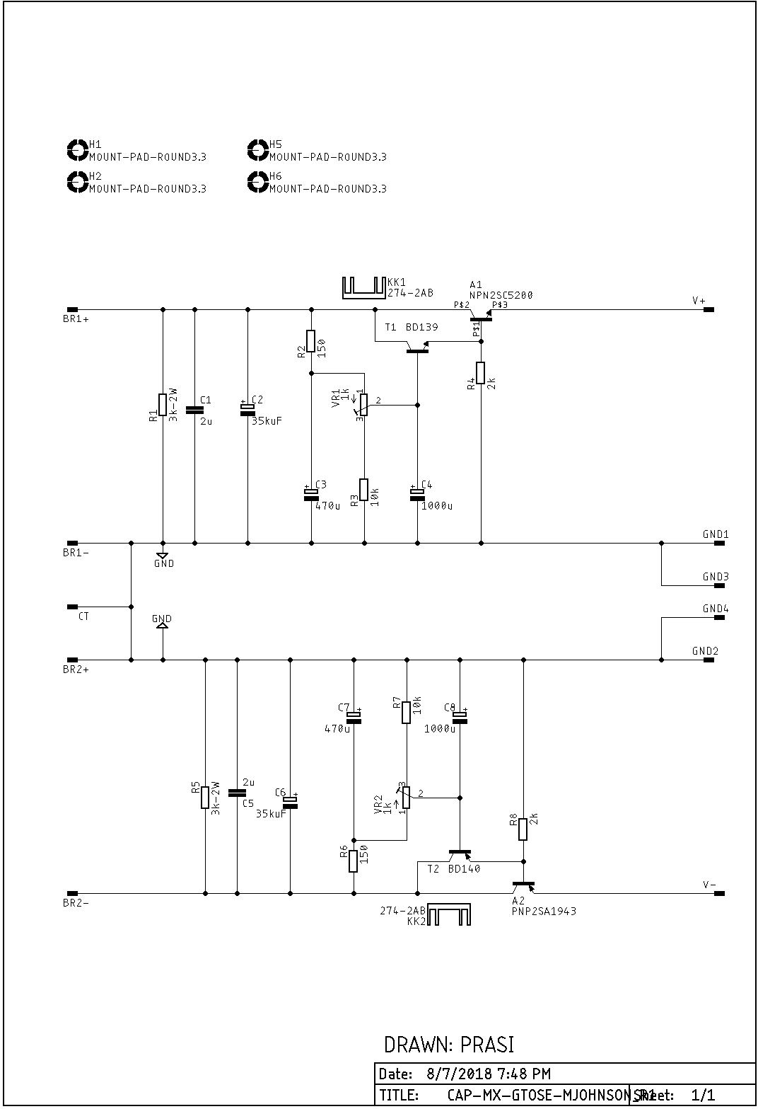

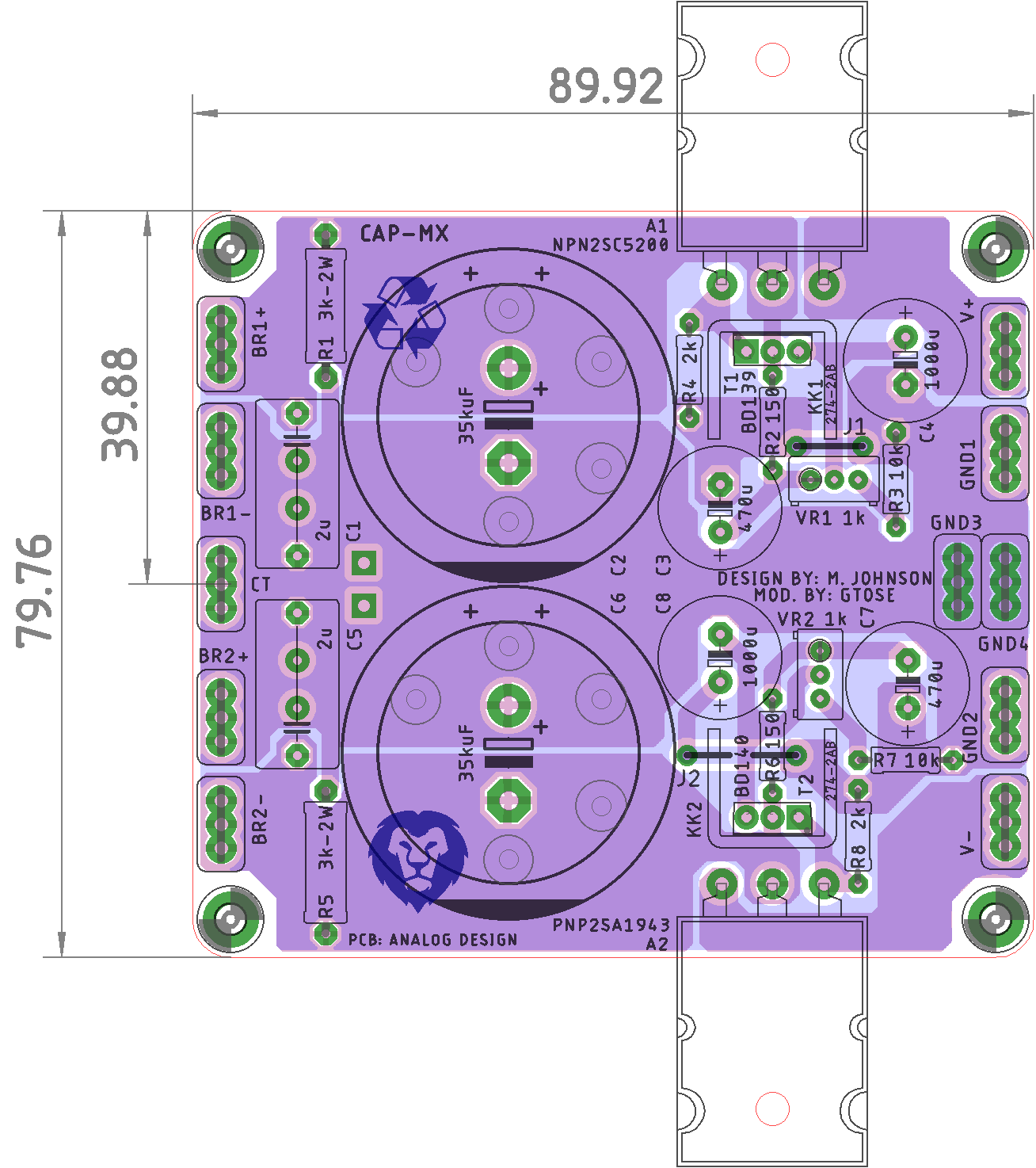

I will merge the grounds of +/- rails and send you the gerbers. let me know if you have any specific component package for C1.

Thanks for doing this and what you have is fine - I will make it fit. I typically use 15mm pitch MKT radial so I think looks close to what you have there. If you have any plans on making boards yourself I can buy them from you. But I probably have upcoming PCB orders in the works and this is a good “add-on” order once you have shipping covered.
Yes, its a 15mm pitch alright, plus now I have put some options for 5mm and 10mm just in case someone wants to use something else.
you can order boards yourself. attached are the gerbs and stuffing guide , also pdfs in case someone wants to etch at home.
Let me know if you have any problems with boardhouse with these gerbers, I can clarify / use older method. I have now moved over to eagle 9.0.0, pcbway didnt like those 9.0.0 gerbers initially. Now its settled with them ;).
Top plane is a ground plane thats only connected at output.

edit: logos are on the bottom silk, so don't affect the functionality or beauty of top silk:D
