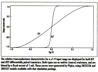

john curl said:Where does the third harmonic come from in a differential pair? Why doesn't someone do something useful and show us.![]()
Come on John, symetrical compressive non-linearity is all odds.
Think of squashing the top and bottom of a sine wave symetrically until it becomes a square wave.
I know you realize that. 🙂
It is only a question of scale (or FFT BW), with higher resolution there are always both odd and even harmonics, that were probably hidden in noise in older measurements. Real device transfer function is not ideal.

Scott, anyone can do it graphically, but can you do it mathematically?
Why is it when two components, presumed to have only second harmonic, when differentially put in series together, create 3'rd harmonic in surprisingly large amounts?
You must be teasing us 😀 . How about difference between transfer function of single device and LTP pair?

john curl said:Want to break it down? You know, derive it?
John,
http://rfic.eecs.berkeley.edu/~niknejad/ee142/pdf/lect7.pdf
I hope this is what you are looking for, any further questions?
john curl said:Scott, anyone can do it graphically, but can you do it mathematically?
Let's see it for FET's, closed form now, no cheating. The Taylor series expansion for long tailed pairs has been published ad nauseum. From Walt's graph there I'd guess we would start with AX - BX**3 and go from there. This is sort of intuitive stuff, take a square law non-linearity and flip it on the other side of the axis and take the Taylor series. And please, I don't mean to insult anyone who has to think about it for a while, that's what learning is all about.
Procedure of math derivation is well illustrated in the link that syn08 gave here, thanks, Ovidiu.
