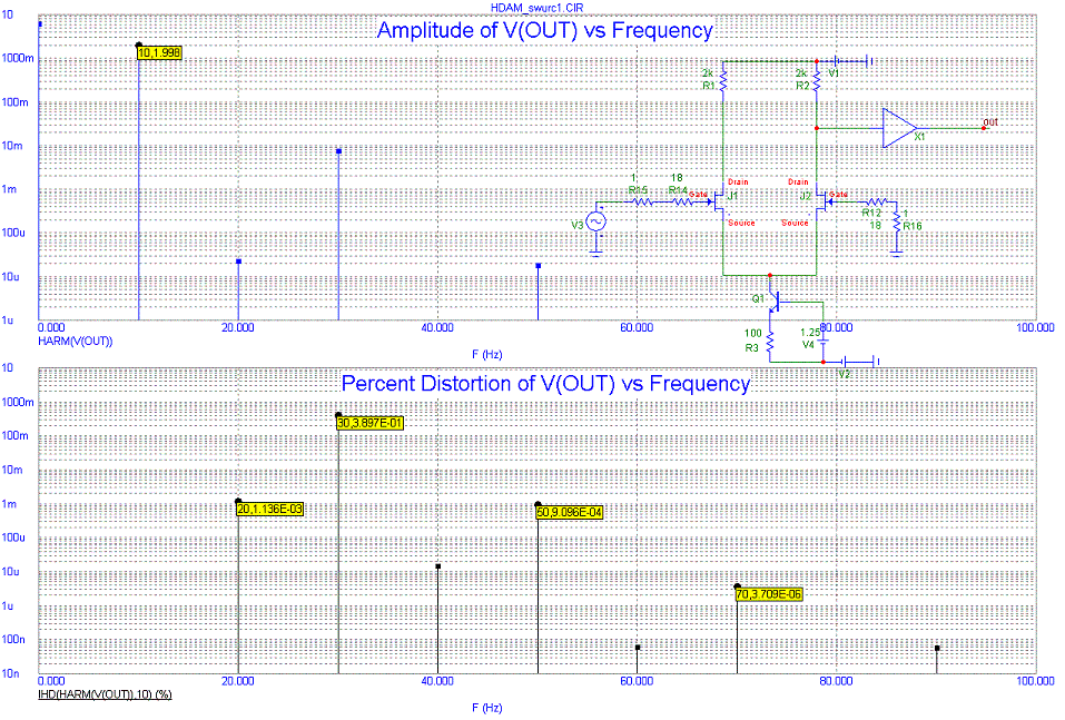

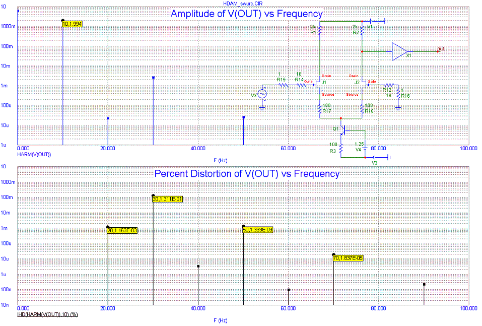

And the local feedback makes the same, look at two examples:
The problem here is that you have two things happening at once,
the device variation in gain due to current fluctuation and
simultaneously the variation in gain due to voltage fluctuation.
What does your sim show if you apply a cascode to those
devices, holding the Vce constant, and then apply feedback?

Nelson that's why I posted that simple experiment. Applying feedback around otherwise infinite dynamic range ideal sources (with pure third order nonlinearity) creates the higher harmonics. Trying real devices obfuscates the matter somewhat. Personally I feel this is a curiosity when applied to real amplifiers, especially modern ones. I think Baxandall was working with unusually low gain common source FET amplifiers like the ones you would find in a 70's microphone.
