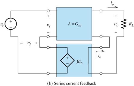

b) It's much simpler if you look at degeneration as [local] series (input) current (output) NFB. The base amp gain is transconductance and the equivalent circuit is shown in the attachment. You would of course recognize the qualitative model above (voltage drop that oposes Vi, yada-yada-yada) but now we can directly write the amp gain as a function of the gain loop, etc... as in http://www.ece.mtu.edu/faculty/goel/EE-4232/Feedback.pdf

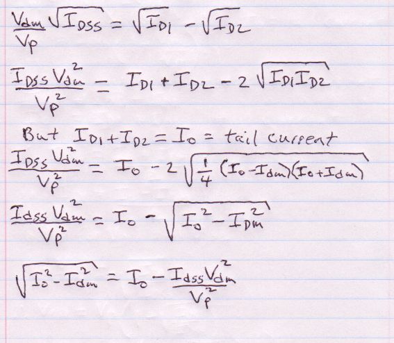

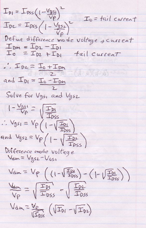

I'm part way there. Can somebody check my math? Here is page 1.
You're on the right track, these days I would use a crutch like Mathcad or Matlab to do explicit symbolic answers. They don't miss those factors of two or the square root of PI.
