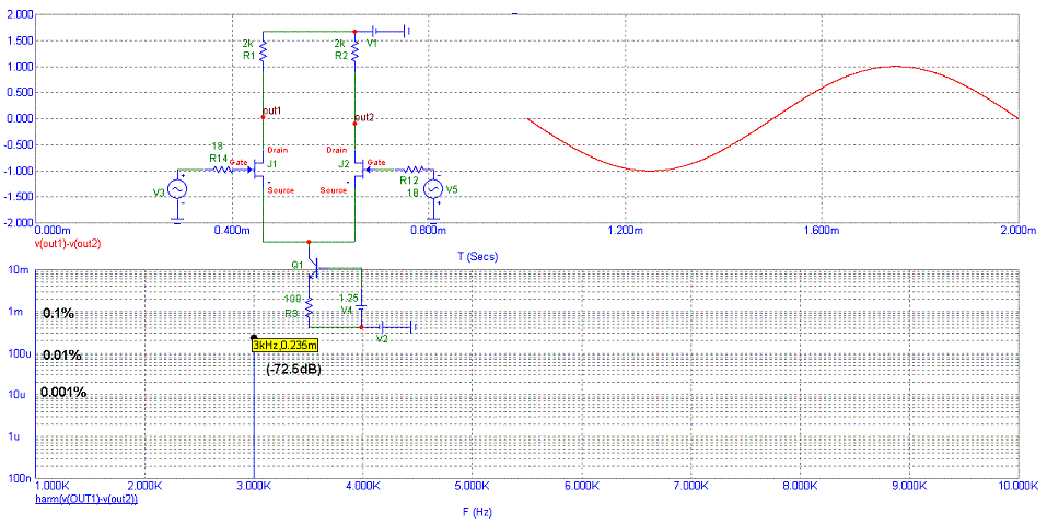

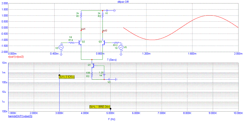

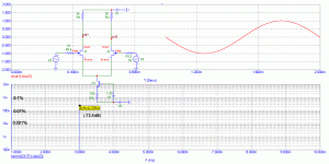

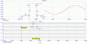

Transfer function resulting from symmetry of any non-linear functions must in principle introduce odd order harmonic distortion; no so-called exact, in fact quasi-exact equations are needed.
True diffpair see image, only odd.

What PMA has measured is what we would expect from a calculated measurement.
Distortion depends on amplitude, as everyone here knows, rises for higher Vout, but remains in odd components only, for true diff pair (diff in, diff out).

John, all along I thought you talking about the fact that a single ended bipolar was an exponential and therefore had evens and odds already (and the evens were cancelled). This actually has nothing to do directly with the spectral content of a diff pair transfer function.
john curl said:Let's stick to 3'rd at first. (this is like herding cats, you know like: class, CLASS!)![]()
I think Dave Fullagar first showed that crosscoupled bi-polar diff pairs with an area ratio of about 4 (Barrie Gilbert derived the exact area ratio) has identically ZERO third order distortion over a small but useful range. Unfortunately discrete designers can't readily make use of that.
