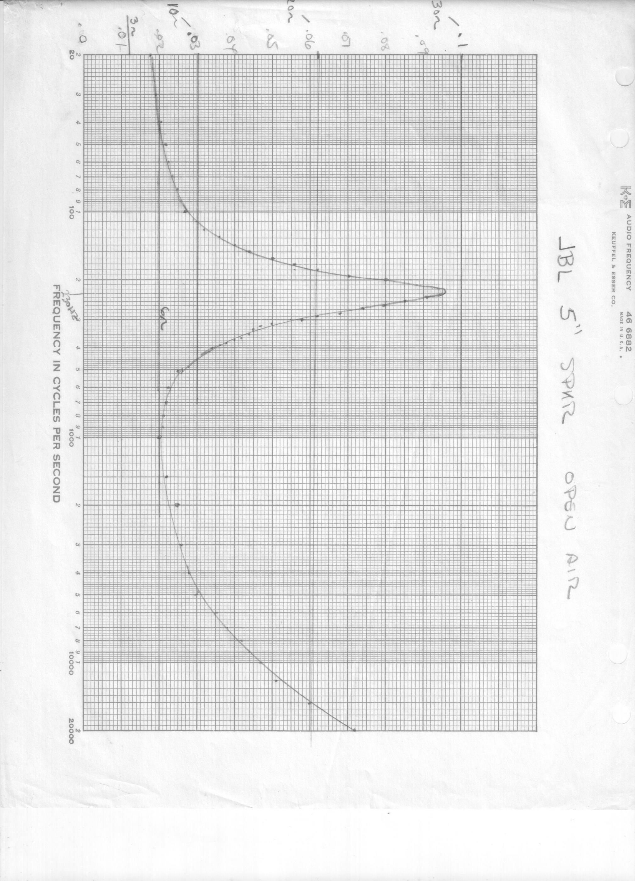

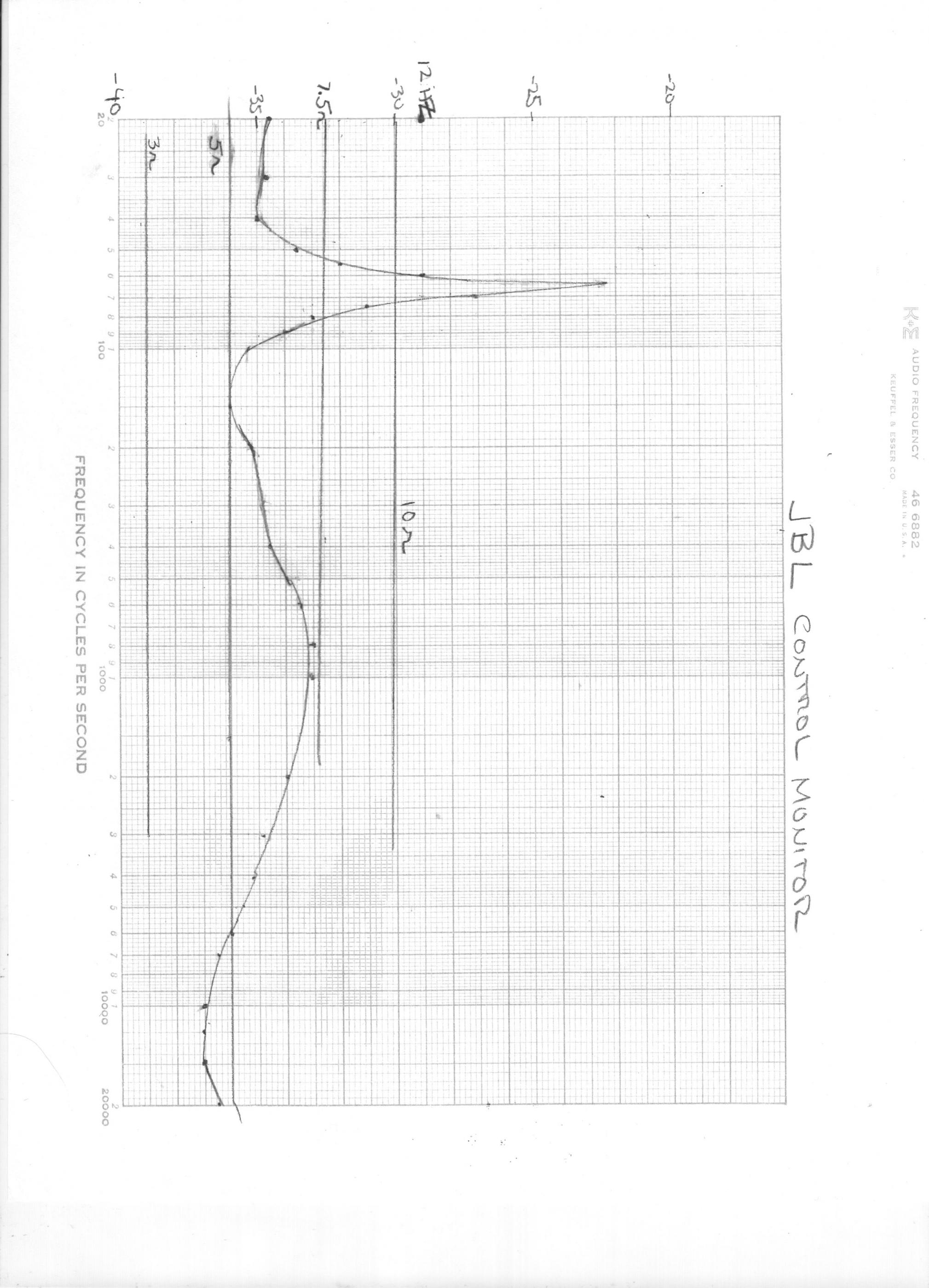

Markw4, you make more of it than it should be. First, it is relatively easy to measure the impedance curve of a loudspeaker, AND it can be explained as resistance, a low frequency resonance, and inductance (at high frequencies). Of course what we measure is a combination of the bulk resistance of the voice coil with a back EMF generated by the movement of the speaker that is acting as a generator which increases the impedance measurement at some frequencies. If anyone really wants to know more about the effects between the speaker and the amp, then study IIM distortion that was significantly researched in the late 1970's and early 1980's. Matti Otala usually was part of these research papers, but there were others as well.
Markw4, I did not mean to imply that YOU often make audio comparisons when high on something, but I was generalizing that MANY here do. It really can make a cheap, relatively lousy system sound pretty good! LSD is the best. On it, I could not tell 'Live from Memorex!' That is why I always do my evaluations both drug and alcohol free. I need to hear the problems, if I am to attempt to fix them.

Right, John. I get that back emf makes the net voltage higher while current is still about the same, so impedance looks higher. But, that doesn't make the back EMF into an impedance. Its the changing voltage part of the equation.

Markw4, you make more of it than it should be. First, it is relatively easy to measure the impedance curve of a loudspeaker, AND it can be explained as resistance, a low frequency resonance, and inductance (at high frequencies). Of course what we measure is a combination of the bulk resistance of the voice coil with a back EMF generated by the movement of the speaker that is acting as a generator which increases the impedance measurement at some frequencies.... If anyone really wants to know more about the effects between the speaker and the amp, then study IIM distortion that was significantly researched in the late 1970's and early 1980's. Matti Otala usually was part of these research papers, but there were others as well.
There you go Mark, this is not that difficult to understand, maybe just a bit harder to explain. It is not even a claim.
