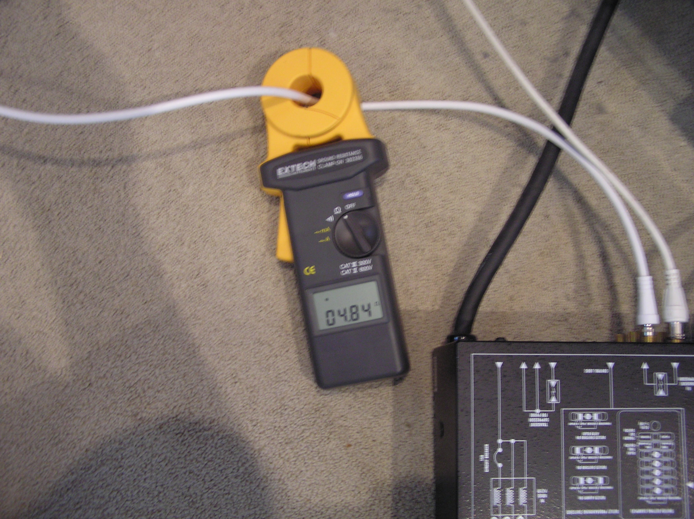

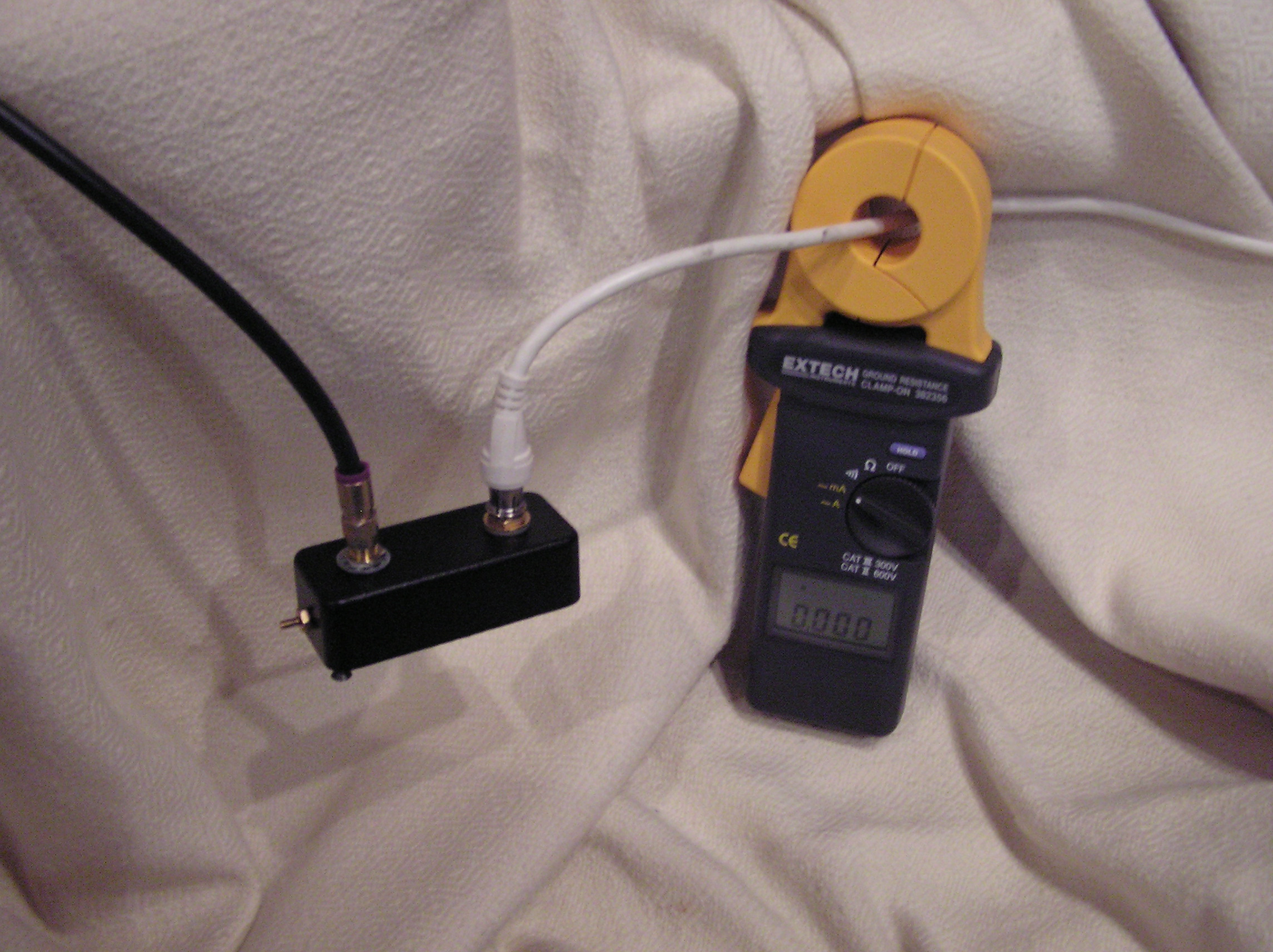

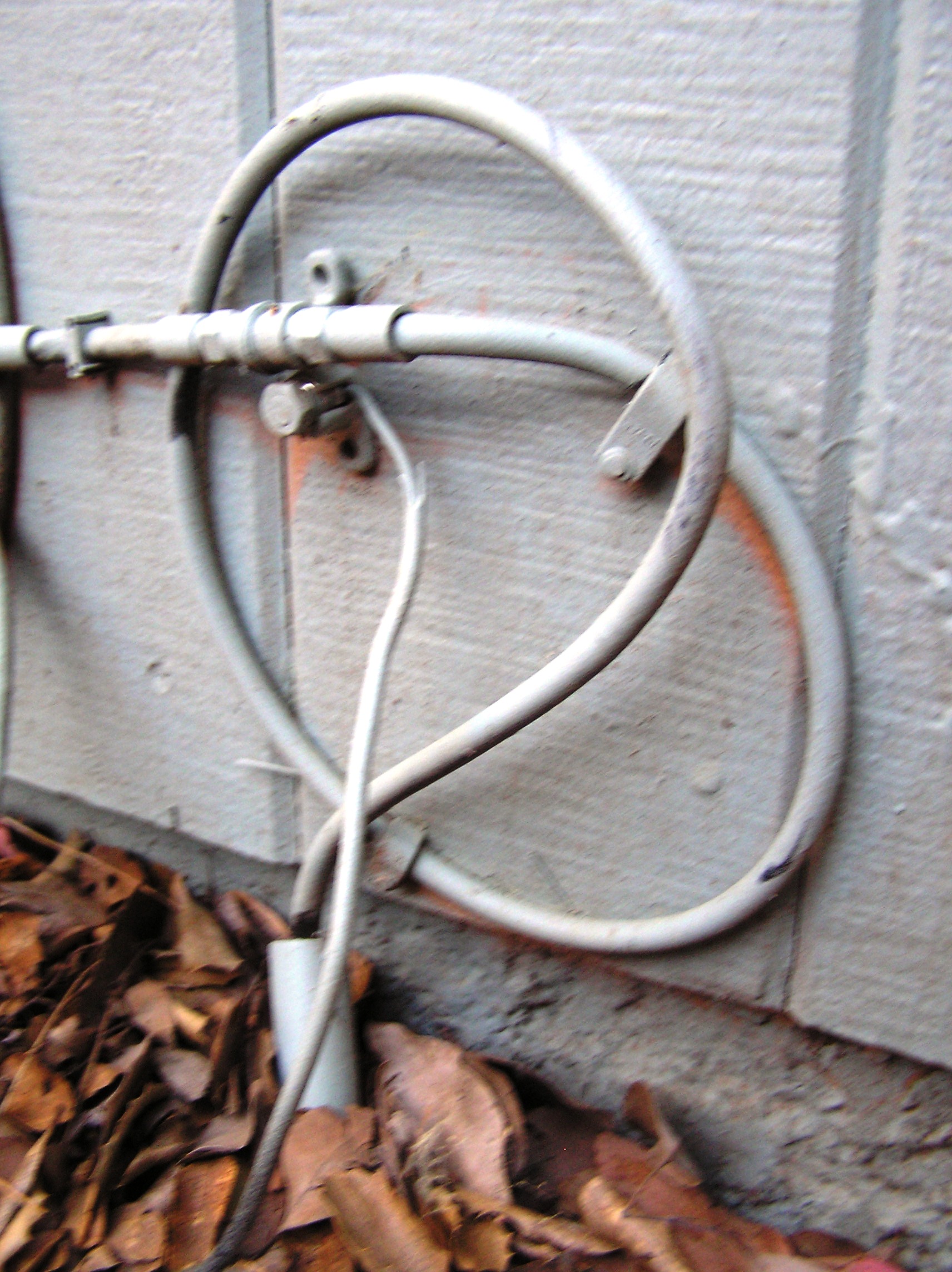

Ground coupled noise (direct or field-coupled) is always a problem. More so for those who have an audio and video system together.
In most existing homes, the grounds are not at a single point. Only recently built home have required the grounds from Telco, CATV and power all be done at one point.
For example here is the CATV grounded at its' point of entry.... the power ground is at the ac panle on the other end of this building.
When the audio system grounding thru ac power line back to the ac panel is not connected to catv gear... no ground differences are there but as soon as you connect the catv cable and its other ground point... the potential difference between grounds causes ac current to flow thru A-V system and components. This not only can cause 'hum' but noise and video artifacts.
In this case, one solution might be to break the ground of 50/60Hz direct connection and isolate it....., Blocking 50/60Hz but allowing desired signal unattenuated thru.
