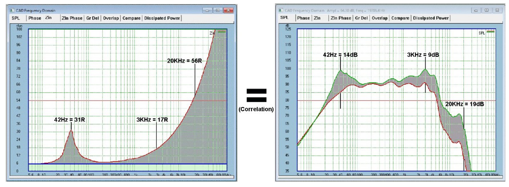

Back EMF can't directly be impedance because as you know, EMF, Electromotive Force is measured in units of Volts, and impedance is measured in (complex) Ohms. In physics, this is part of what is referred to as dimensional analysis. Part of doing any math problem in physics is making sure that the units come out right.
Indeed you are right, the EMF can indeed be measure in Volts, don't for a moment think I do not know that, indeed I cannot count the times I have said that it is a voltage source. A microphone is a voltage source.
But I just don't think you have connected the dots and if you had, then you would see that indeed it has an opposing force on the current produced by the amplifier. If you think in that way, measure the total impedance of a driver at a selected frequency, then measure the DC resistance of the voice coil. Subtract that from the total impedance and the remainder is the back-EMF impedance of the driver at that frequency. So that voltage generator will cause the current from the amplifier and you now have it's equivalent impedance. Trust me on this, it is what it is - and now also been recognised by others.
So indeed it is the EMF that constricts current, indeed while explaining this to a knowledgeable friend, he saw it as an anti-force, or a force that is 180 degrees out of phase. Interesting way of looking at it, one that had not occurred to me.
The beauty here is its simplicity, that we can, as a load on the amplifier as a voltage source, consider that the impedance is seen is in two parts. Only the voltage and current that causes heat to be dissipated in the voice coil. You should know this, right? But in fact it is the current that causes motion of the coil in the gap. That motion causes a motional impedance, then you have the inductive back-EMF, the point is that these are in series and hence current is impeded - so there you have it. Or think of it this way, it is current that gets impeded, not the voltage. An impedance measurement and graph of a driver, Ohm on the left X axis and frequency on the lateral Y axis, this is what the driver does to the current, not the voltage. Hence the impedance above the Re DC resistance is the back-EMF impedance. And you can definitely put an Ohm value.
Does this now make better sense?
Please trust me on this, there is sound (ahem) proof of this, see the attachment when a driver, where the change in dBSPL can be predicted by the degree of current being impeded and using the value "Total Z minus Re." and hence this back-EMF impedance is for real and can be used mathematically to coincide with change in current and hence dBSPL variations.

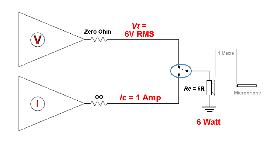

Please note that 6R here represents the Re of the driver and there is an equivalence between voltage and current if that 6R is purely resistive. Any change in dBSPL is caused by the back-EMF impedance. This equivalence test has already been peer reviewed, yet not publically published in a paper yet. The numbers do not fail.
